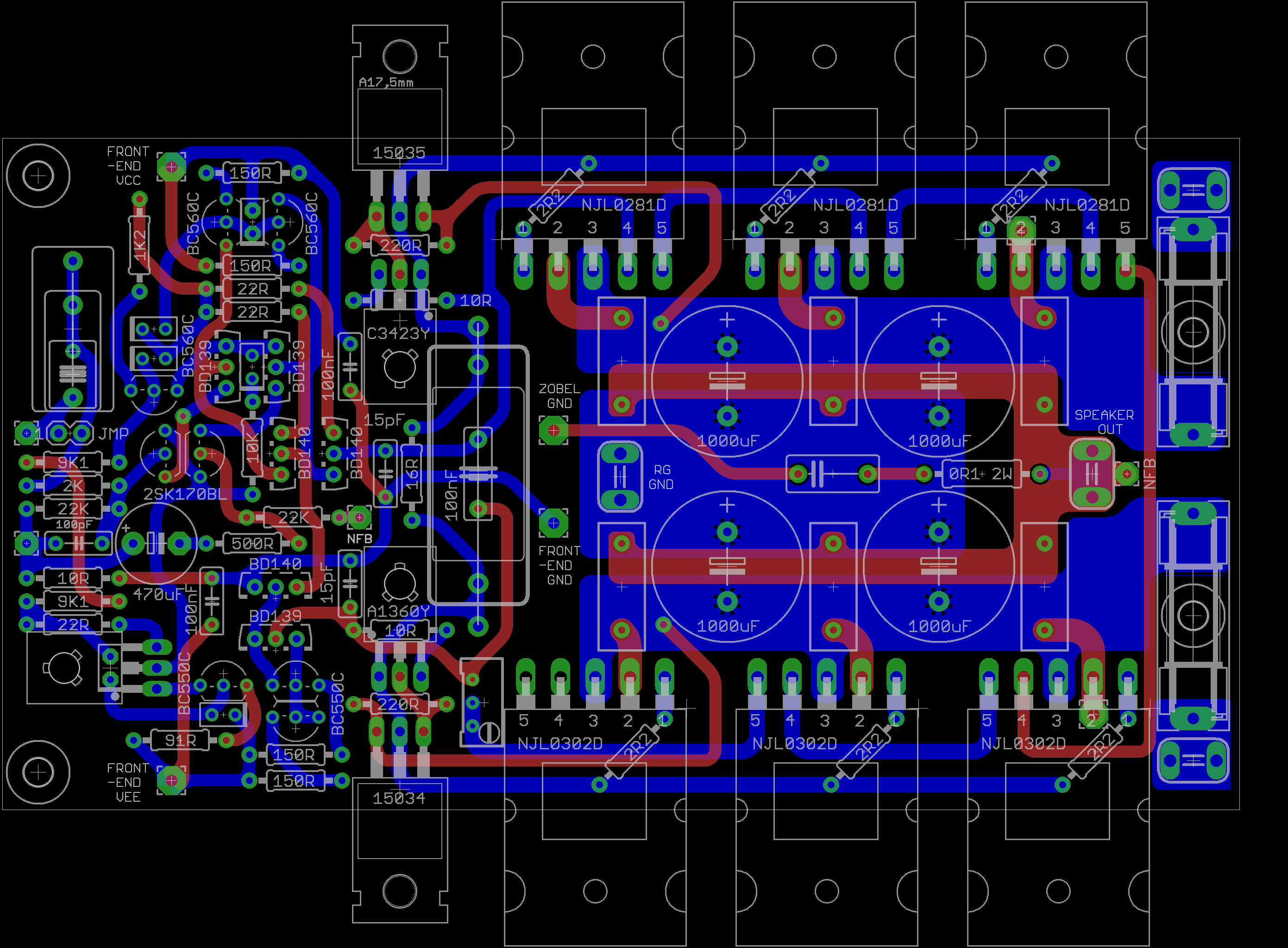

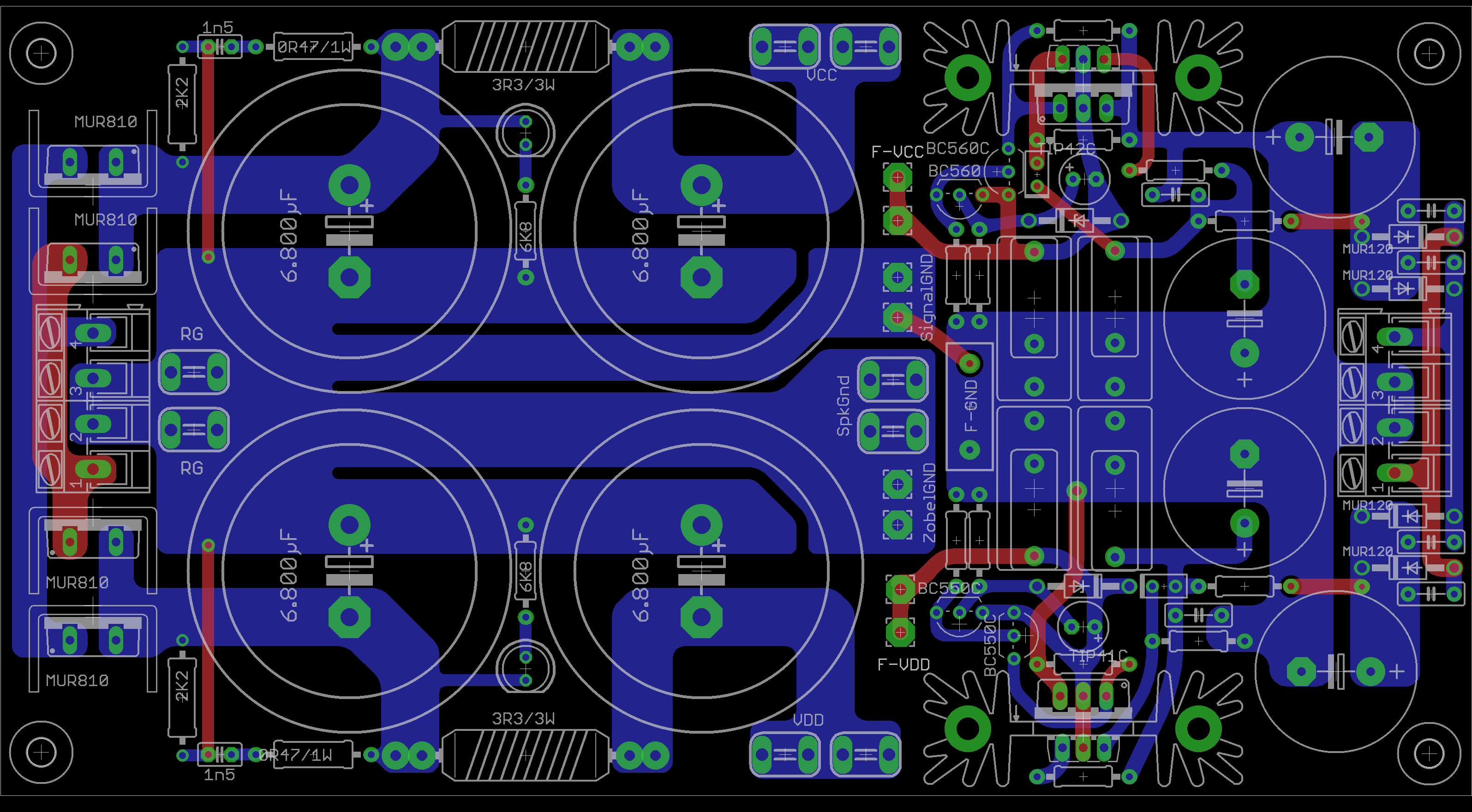

Current progress
Here is a quick peek to how the AMP PCB WILL basically look like. I believe this will be the final version for this AMP PCB. I asked Rudi to take care of the 2SK170 while I am working on the PSU PCB, basically thanks to zdr who pointed out this 2SK170 issue!
I am still working on the SPU part, the attached snapshot should also give an idea of how the PSU PCB shall look like. Actually, aligning components correctly took longer than I expected for this PCB.
After reading thru Self's and Cordel's books, I believe this is the correct way of doing GND:
- Signal (Both books discussed it).
- Speaker/Zobel GND (described in Dr. Self, chapter 18).
- RG (described in Dr. Self, chapter 18) used to connect decoupling caps on AMP PCB to PSU, this GND connection should be in the RG area, rather than the Speaker/Zobel or signal GND.
If you examine both PCBs, you will notice this has been applied.
regards
metal

Metal and Rudi,
Is it possible to use plated trough pads for the output trannies?This way we can solder them at the silkscreen.If already done,sorry for the question.
Rudi and Metal,
Nice job till now ... keep up!
Q: Your plan is to use only one power supply for both channels? I do not recommend that.
What's the point in making large power supply lines, grater than speaker lines? Both should have the same current capabilities 😉

I need this PSU to be versatile, this is why you see more than one spade and pad where you expect only one, it will not only be dedicated for this amplifier. So thick lines were used, also larger caps supported.
Having a shunt-reg is a plus on the same PSU PCB, really nice.
I quite like the idea of using the power supply for another project. How hard is it to change the voltage for the frontend?

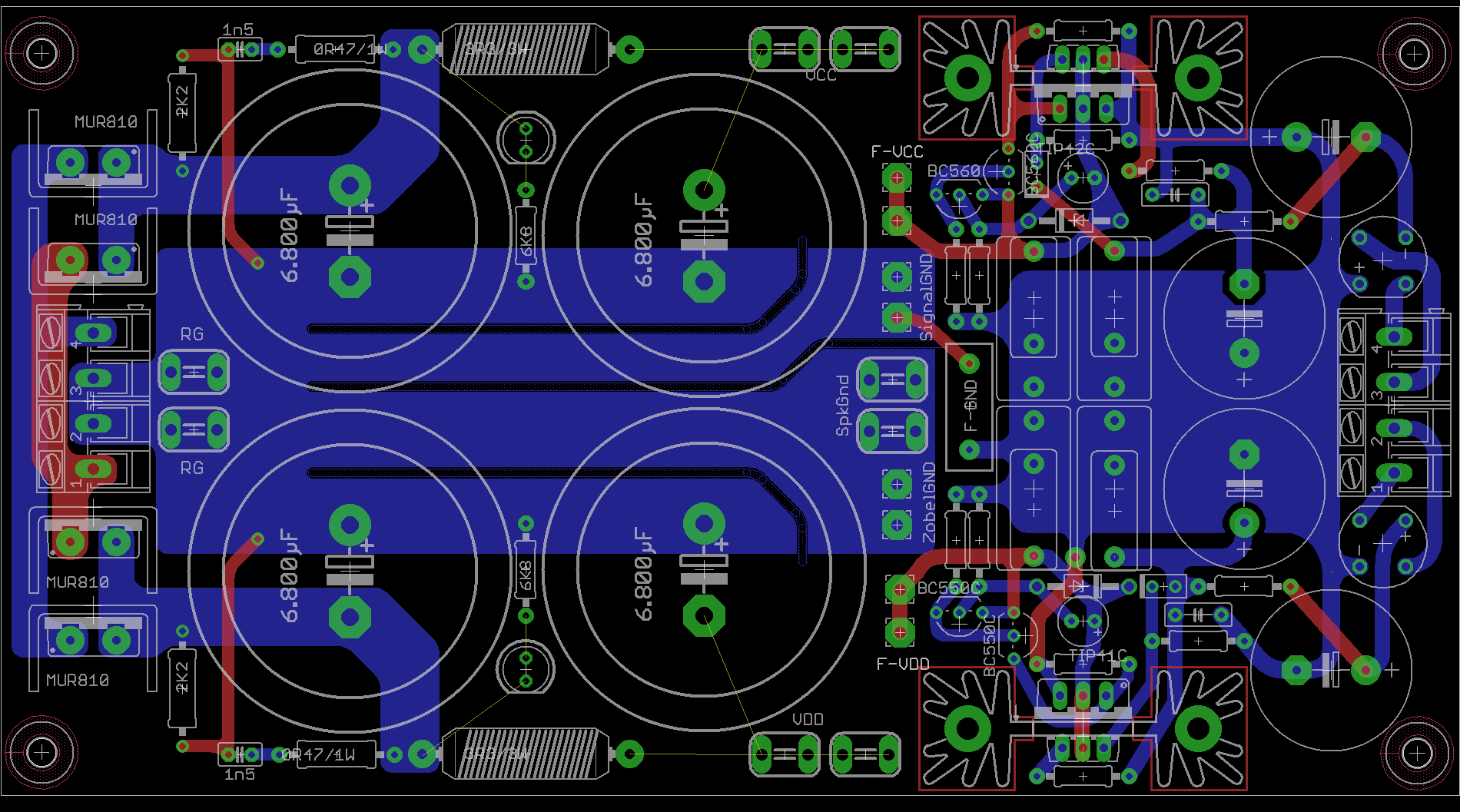

Good news
Finally, the amplifier PCB is finished, no more changes will be carried out (I hope!)
Still there are few things I have to finish on the PSU PCB after Rudi and I talk about them, and then we are done!
I hope that these PCBs find their way into DIYers hearts🙄

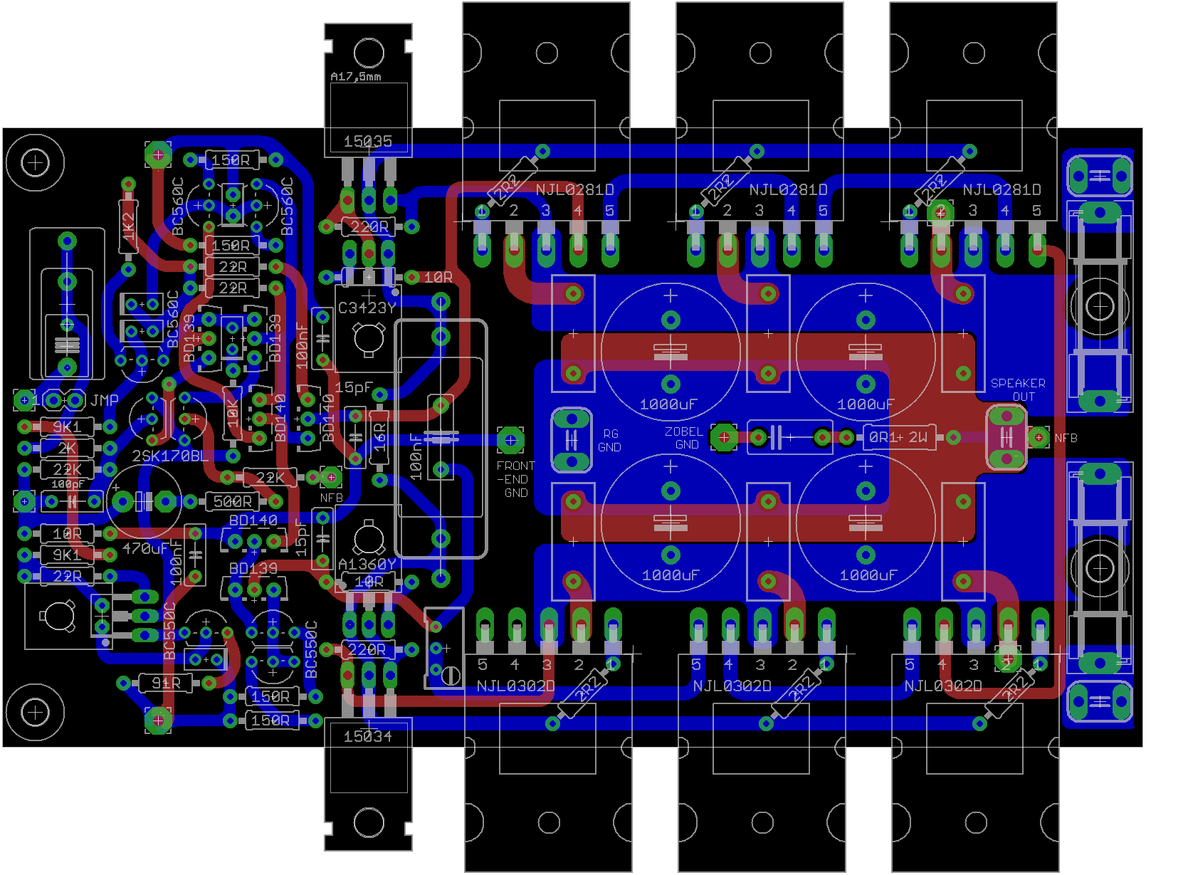

Gentlemen,
METAL and I finished the layout of both the AMP- and the PSU - PCB and we are currently inspecting the GERBER files
that result from the EAGLE - .brd files.
http://www.abload.de/img/fc-amp-gerbvmhlpr.png
I checked the underlying schematics twice, compared it with ZDR's schematics and with Mihai's Spice - file:
I am very sure that the wiring is correct.
How shall we go on now?
Mihai suggested to prototype the PCBs before offering them to the community.
The minimum number of PCBs that I can order in the aimed quality is 10.
The price for an AMP PCB (size: 136 x 74mm) is 14.50€ then; the price for a PSU PCB (size: 162 x 87mm) is 15.50€.
Do you think that prototyping is necessary?
If so: will there be 4 of you (besides me) who are willing to evaluate METAL's and my version of Mihai's amplifier and buy 2 pcs of each PCB?
What colour should the PCBs have? Red, green or blue soldermask colour with white silkscreen or do you want something special for this AMP?
Black and white or white and Black?
Best regards - Rudi_Ratlos
