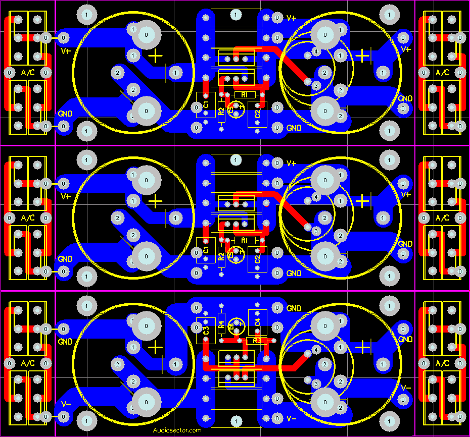

Gentlemen,
the longer I think about it, the more I feel content with the decision that METAL and I have taken:
1) not to add any PSU ingredient on Mihai's RMI FC-100 AMP PCB at all
2) but offer you the best PSU you can think about as a separate PCB
This is what I am talking about:
http://www.abload.de/img/topviewfgzpu.png
A PSU PCB, containing the backend PSU on the left side, with 2 full-bridge rectifiers, with heatsinks provided, C - R/L - C filter,
supporting caps of 35mm diameter, LED indicators, bleeder-resistors, ..., and - on the right side of the PCB: Mihai's shunt-regulator.
This PSU-PCB is dedicated to Mihai's AMP. It is very flexible: you can use one PSU-PCB and one / one transformer to provide power
to both the backend- and frontend-sections of each channel or you can build a dual-mono design with two / two transformers
for the backend / frontend power or ...
And: you do not have to worry about STARGROUND any more.
STARGROUND will be in any case the 4 pin connector block (run 1 or 2 wires to the AMP-PCBs GND plane, 1 or 2 wires to the Speaker-Return)
in the middle of the PSU-PCB.
The implementation of this PSU-PCB for Mihai's AMP will still take several hours.
METAL and I want to offer you the best PSU available for this AMP.
Is there anything that I have overseen? Please tell me.
This will be my cooling fundament (400 x 170 mm) for Mihai's AMP.
http://www.abload.de/img/joe002nlbrm.jpg
I think that it will do its job.
Best regards - Rudi_Ratlos

I connected Zobel's cap GND pin directly to the GND spade in the middle (red track), the same goes for the front-end's GND (also red track).
The bottom layer GND plane (blue plane) is for the 4 power caps now, note that I isolated Zobel's cap GND pin from the GND plane there. The speaker GND will be taken from the main PSU unit. I hope I am done with the GND thingy.
You might also notice that I moved the little cap beneath the largest cap to have good space for the GND spade so it will be the only component to be soldered beneath the PCB. In general, I wanted to have reasonable space for each spade, this is the main idea; at the same time have correct connections for the GND and NFB take-point. The image is large enough to enable members to comment. It is very important for me to hear your comments at this stage.
I am 2" close to finish the PCB, but still I need to know what the length of the European and American popular fuses is, I will only consider two lengths. I am willing to use a fuse holder like the one shown below, this will make both parties happier and fulfill all members wishes.
The main caps will still have a charging current return through the ground spade back to the PS board, and this will be shared with the signal ground back to your star ground on the PS board. This is negating the advantage of a dual bridge.
It would be better to have the star ground on board, and not share that ground with charging currents. It would be beneficial to keep the main caps' grounds separate until the star point on the board. There remains a large distance between the ground return and each power supply input, making for a large loop area for these charging currents. If the grounds for each polarity of cap were brought out separately to the right side of the board, next to their paired polarity input spade, it would eliminate both of these issues. Of course, keeping the grounds of each polarity of cap separate on the main PS board would benefit the dual bridges, also.
Any "ground" spades on the right side of the board would not be true grounds, but returns to the separate windings of the transformer (assuming dual bridges). If a single bridge is used, each "ground" spade would return to the transformer center tap. The ground spade on the board should be the star ground, and signal ground. There should be a resistor connection between the signal ground on board, to the PS ground(s) on board.

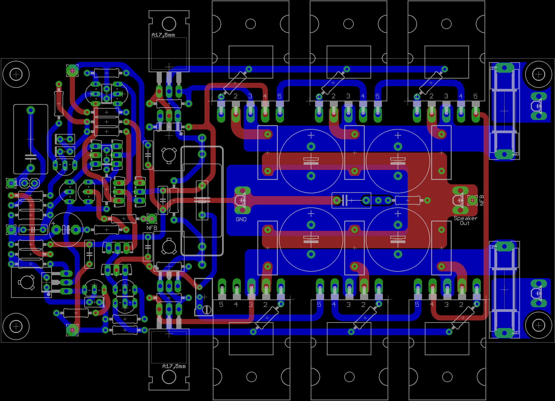

Gentlemen,
while I am waiting for Santa Claus to climb down the chimney, I like and show you a picture of METAL's and my progress:
http://www.abload.de/img/both_1m7j9e.png
We will offer you these 2 PCBs:
1) the PSU (on the bottom of the picture; its size is: 170 x 85mm)
2) the AMP (on top of it; its size is 143 x 73mm)
The PSU includes:
1) the backend PSU
2) the frontend PSU (Mihai's shunt regulator)
We still have to settle upon several questions:
1) Where to combine the Backend-Power(VCC and VDD) - GND planes? On the AMP PCB, on the PSU PCB?
2) Where / how to connect the Backend-Power - GND to the Frontend-Power GND? On the AMP PCB, on the PSU PCB?
3) Where to connect Speaker's Return? To the AMP PCB, to the PSU PCB?
4) Where / how to connect the different GND-planes to the Power Earth / Safety - STARGROUND?
When these questions are answered, we are done.
I wish you all a happy Christmas - Rudi_Ratlos
Do you happen to have a schematic of the PSU?
BTW, excellent job. I'm very much looking forward to having these boards in my hands!
/Mason
