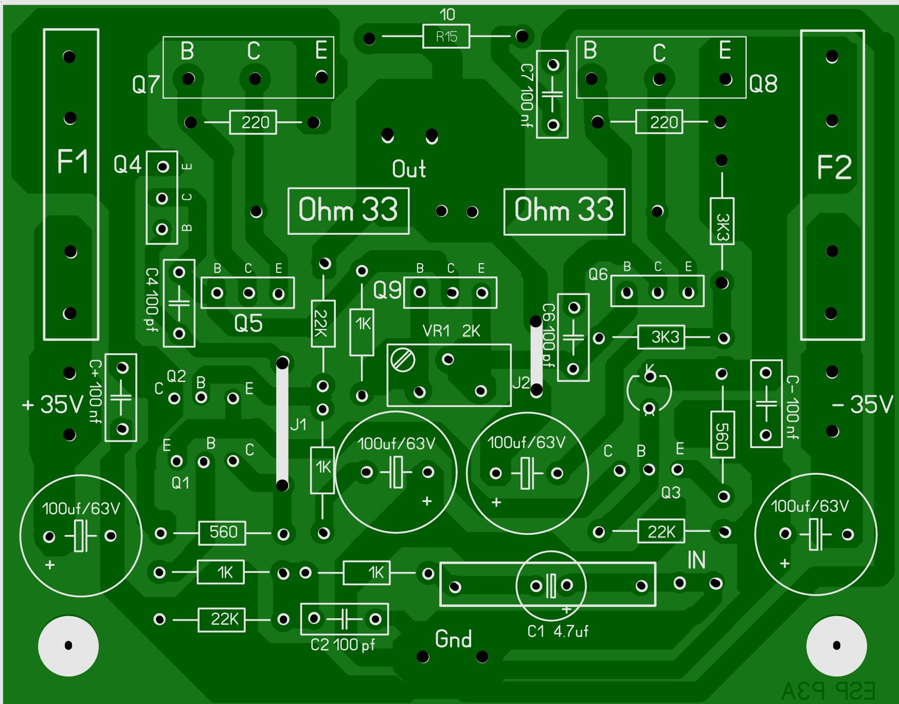

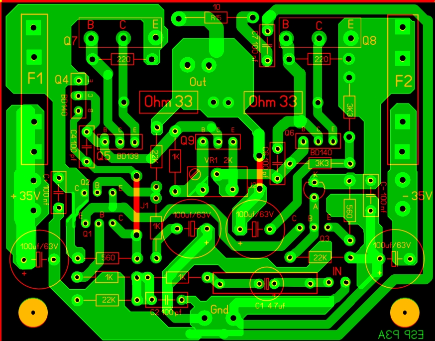

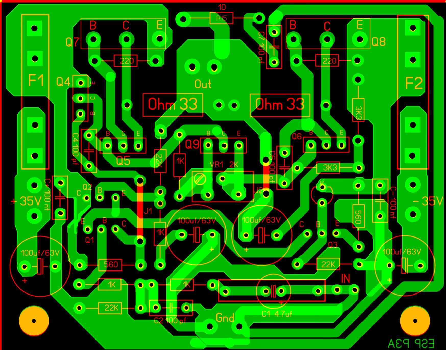

Here is Alex mm sir P3A PCB from post #90, with some correction such as D1 polarity, Some capacitors polarity, Q9 is BC 546, not BD139.as per Orignal schematics of Rod Elliott sir.Is R15 & C7 Connection is right, I think C7 is connected op through r15.Please look and give any suggestion.

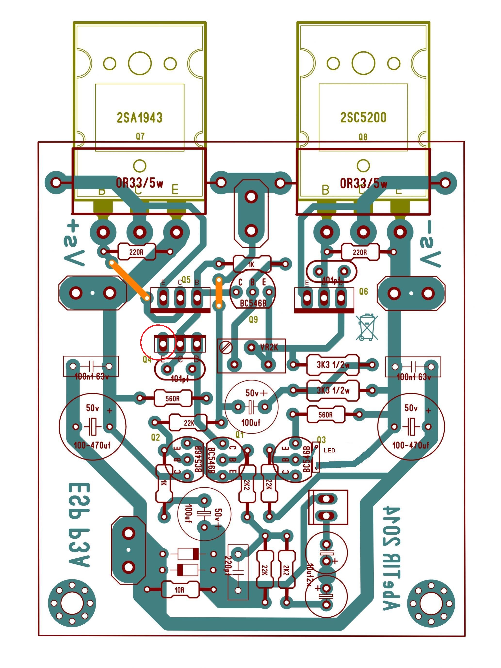

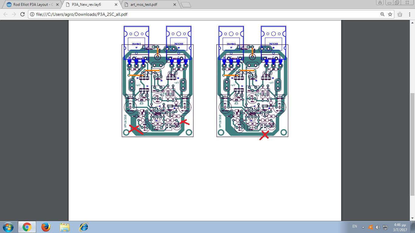

Hey Prasi, I'm sure it's been fixed by now but I noticed a missing trace on your pcb layout. I circled it in red. Ok, just noticed that red wasn't the best color. It's the BD transistor.
Hey man, that beautiful layout is from Abetir (De Ocampo).😉
regards
Prasi
Sorry, my bad. I like the layout though.

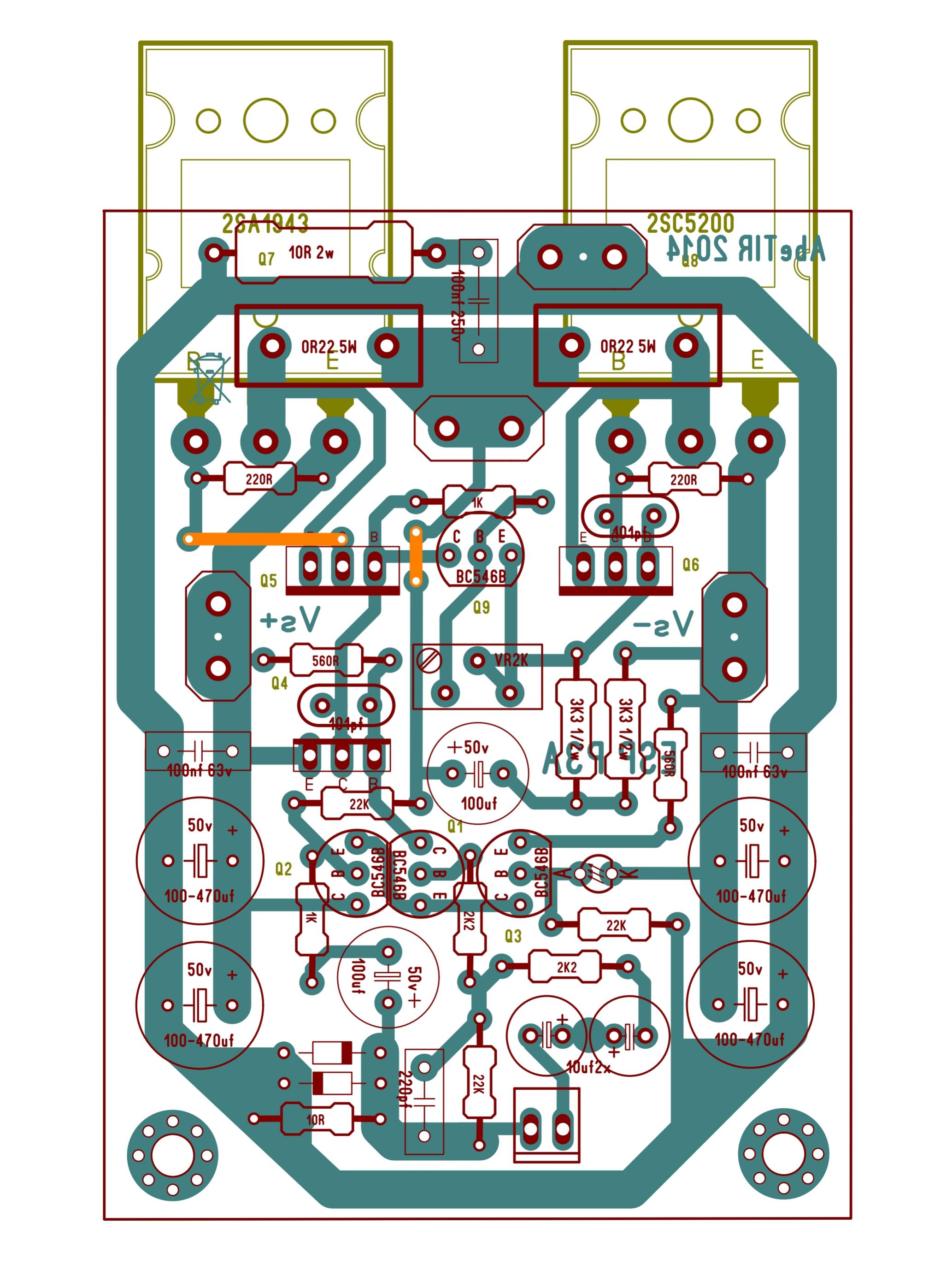

Ripcord,
I think you got an older lay out, attached was the correct pdf built by me and Nikosokey.

Hello Albert,
Nice layout. One/two suggestions if I may.
1. You could move Q4 a little upwards towards Q5. One would then be able to mount all Q4, Q5, Q9, Q6 on a single piece of aluminium plate.
2. emitter resistors could be moved little towards the center so that there is not even a remote possibility that soldered resistor leads (not cut properly) do not short the base on 5200 or emitter on 1943. looking again, may be this is not that important.
ofcourse these are just mechanical related suggestions.
regards
Prasi
Hello
Here is I made some minor changes on Alexmm P3A PCB.Corrected led polarity.Please have a look and correct me if any mistake.
Sorry Input was short, Attach below is corrected.

Have you heard about "ground loop" problems?
You have one big ground loop on your layouts.
Even if the board seams to work ok, still break it, because it's just looks bad.
I am not sure why have you go all the way down in front of the input with that ground trace, you do not need it, from the 22k resistor on the right, to the 10 Ohm resistor on the left, you can eliminate the entire ground trace, and thus, eliminate the ground loop, and also it would look better.
like this?
