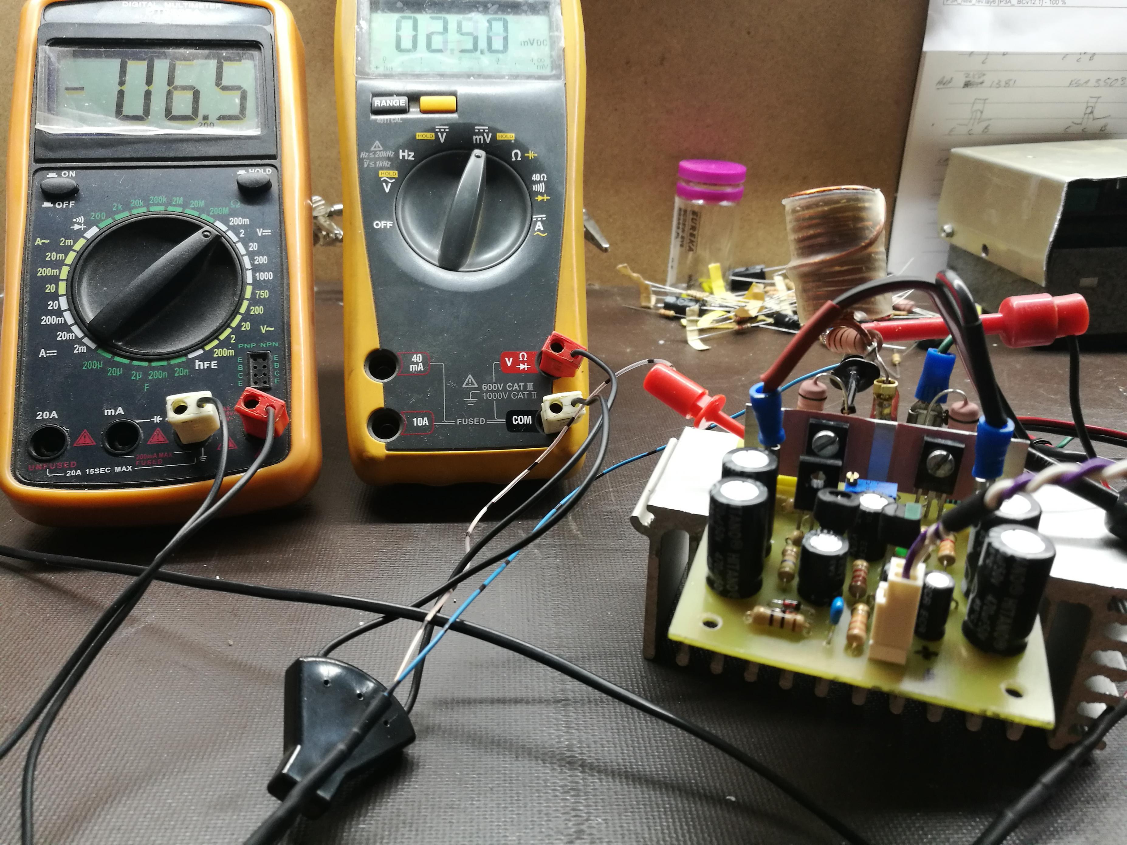

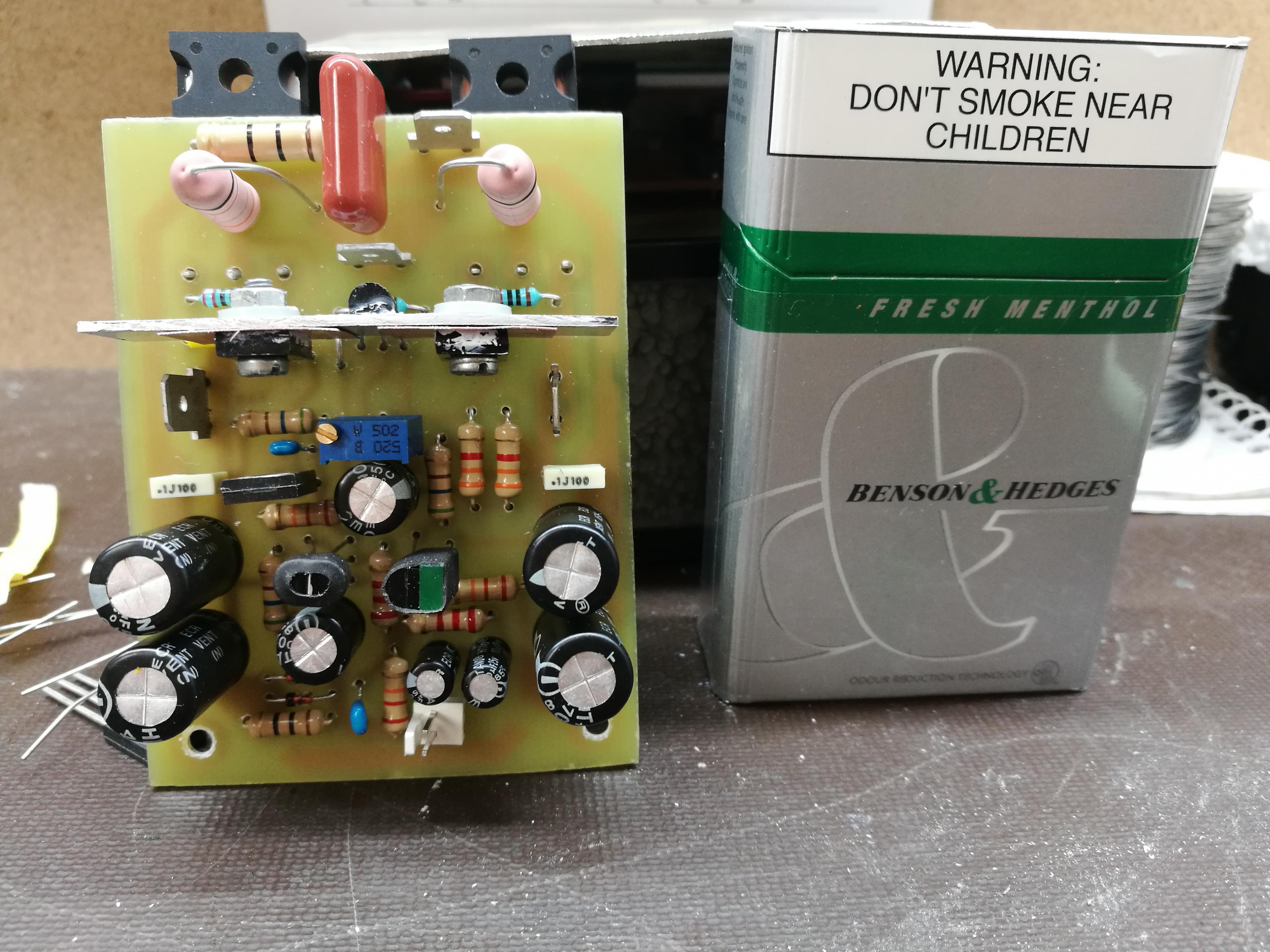

I have used BD35/36C as outputs. BC546 and BD139/140. Sakis I have read somewhere that the led must be close to the transistor and on the pbc that I have used they are next to each other, that's why I thermo coupled them. If its wrong is easy to remove the heatshrink.
