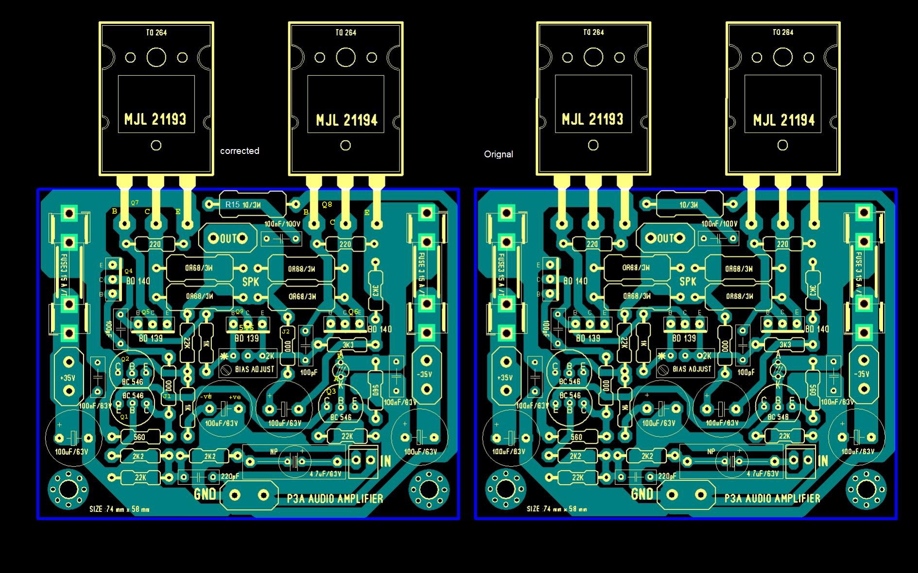

Alex mm PCB corrected
Hello DIYers
Here is Alex mm sir P3A PCB from post #90, with some correction such as D1 polarity, Some capacitors polarity, Q9 is BC 546, not BD139.as per Orignal schematics of Rod Elliott sir.Is R15 & C7 Connection is right, I think C7 is connected op through r15.Please look and give any suggestion.
