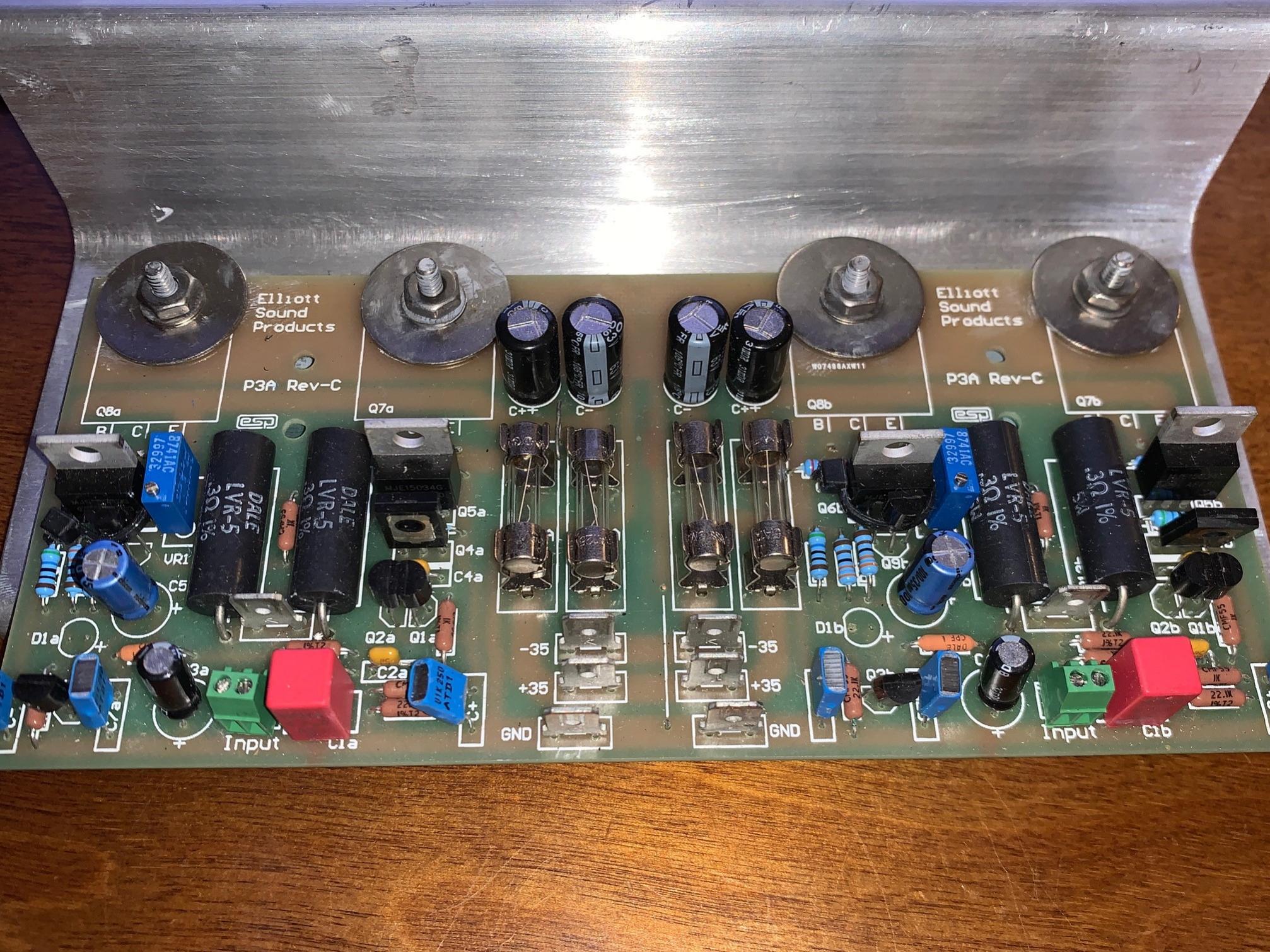

I also checked offers of up to 30 pairs for as little as 90 cents US (for each transistor). That seems like less than the manufacturer's production cost. The photos look genuine but what you receive may not be.
the picture, duh...

uh, try to sleep well 🙂
the picture, duh...
Yes, it is correct, but bear in mind that if you are going to power it at +/- 42v; q4 will heat up and a heatsink will be necessary for it, since it is polarized in class A, said transistor from rest (without input signal) gets hot, I remember that we did tests in the school laboratory, and that transistor without heatsink to inject a signal, it burned
with +/- 35v it would not heat, but anyway, in my design I left it far away to mount a separate heatsink.
