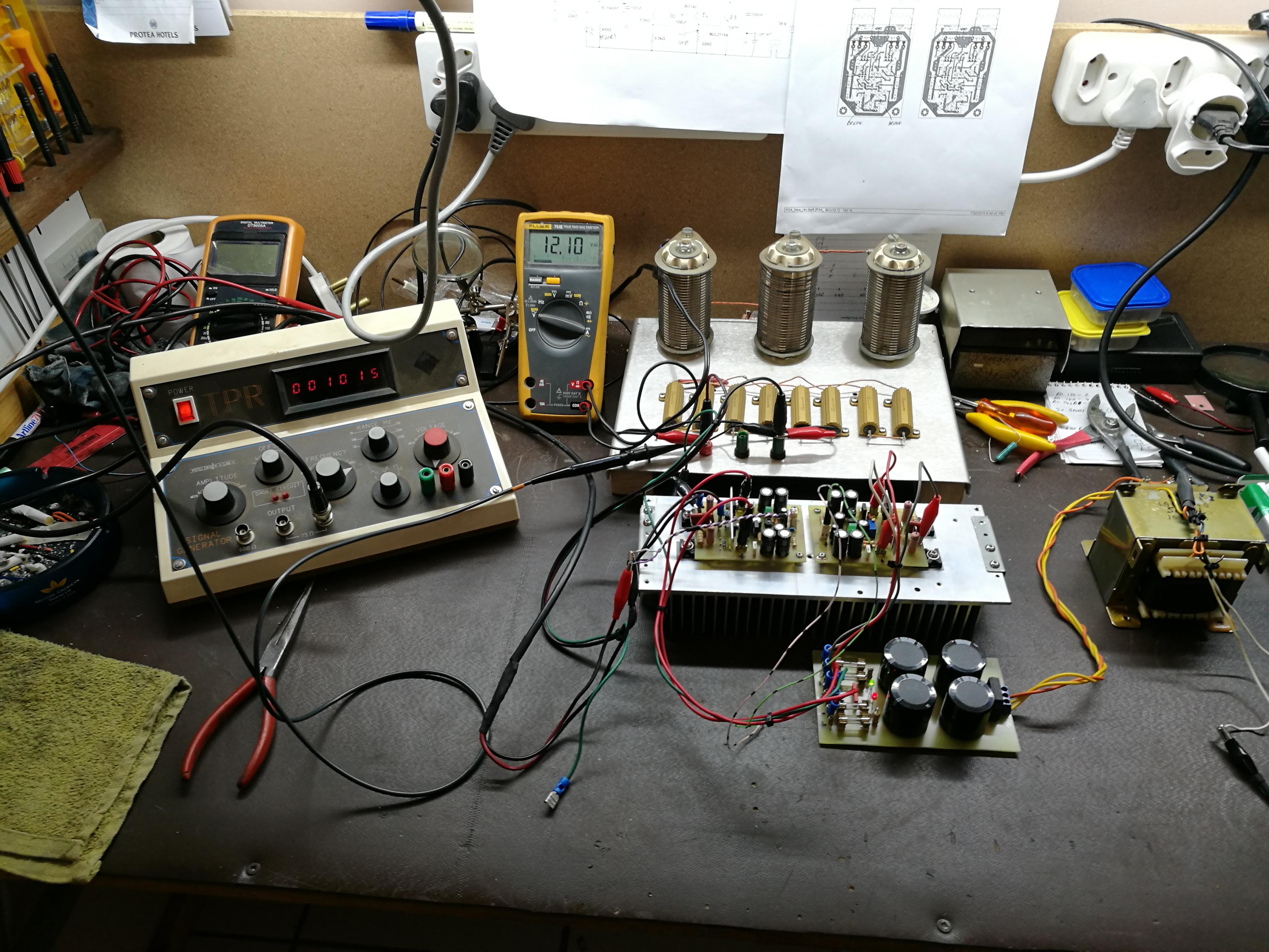

Finished the other board and installed 1nf compensation caps i.s.o 100pf. The 101 and 104 looked so similar in the workshop . When I put it on the scope I found that the sine wave did not look good, triangle looked bad and square wave looked like a triangle. On inspection I found the fault, but I did not listen to the amp on a speaker. Now I wonder, would you have heard something was wrong without having the board on a scope ? Lots of people build without testing afterwards on a scope, would they know If there were a problem ?. I saw on the scope when I touched the input that the output went insane high.
With a critical error like using a compensation capacitor that is 10X the correct value, you can't expect the amplifier to work properly at all. Playing audio through the amplifier would be no less obvious in showing you that something big is wrong but of course, we need visual aids when we don't have enough experience with the device to recognize what a likely cause is.
Question: Did you recognize just what was wrong when the oscilloscope trace seemed so wrong?
I suspect that you probably still had to look for the cause, just as we would by listening.
I like using 'scopes and analysing faults for the fun of it and I admit to making some bad mistakes when replacing components myself. I've used a scope to confirm a fix but it didn't pinpoint the fault location.
I once bought an amplifier from a guy who was a retired engineer and assumed it was fine. Long story short, it made wierd motorboating noises and on return, the guy looked inside, found a stray wire and simply cut it, closed up and connected it to his audio system to demonstrate - It sounded just great. He apologised for not being more careful with removing an experimental circuit. It has been working for me and others I loan it to, for 12 years now.
Ian, there were no problem setting the bias and DC offset were 12mv, so I did not expect something wrong, only that I got 6mv ac on the output with shorted input, after fixing that dc offset is 4mv and ac is 0mv. When touching the input wires with the wrong components I saw the scope go mad and then I suspected oscillation and something wrong.

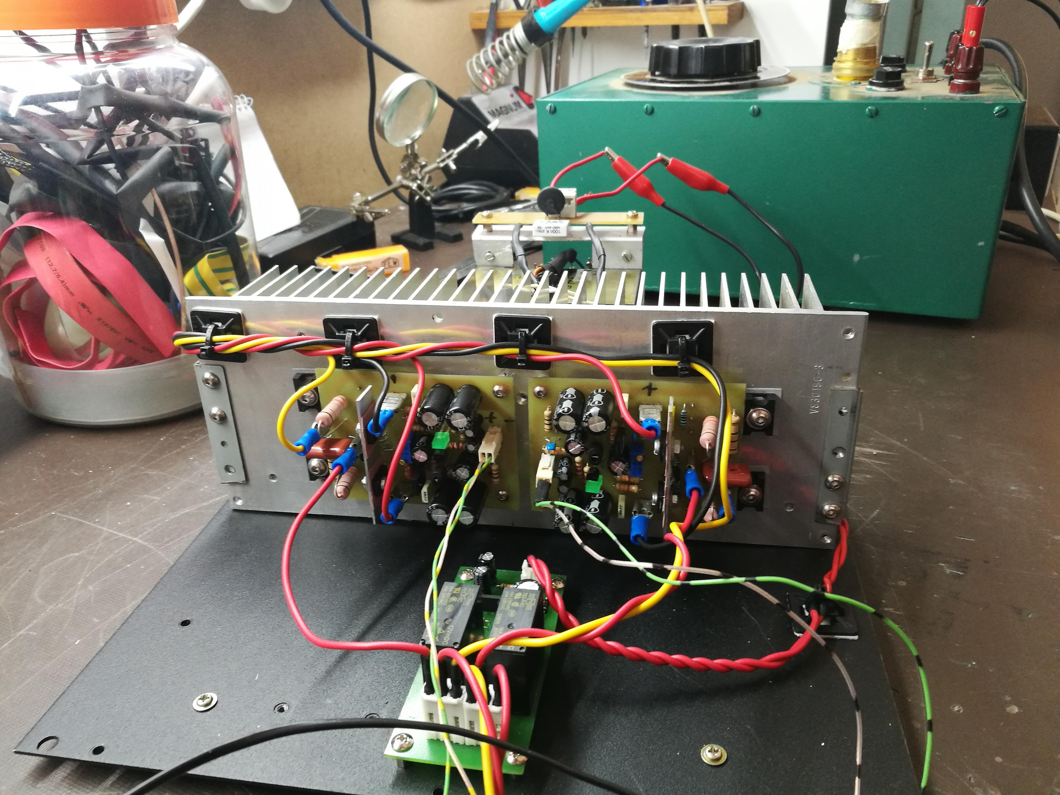

Gooday all,
I see that the negative rail clips a little before the positive rail. Sine and square waves looks good. Is this a known problem?
I recall that -ve clipping level varied a few percent between different builds of older P3A versions but just how much different are your clipping voltages?
As P3A has a bootstrapped capacitor VAS, the actual negative signal peak voltage can depend on the supply voltage, voltage divider R9, R10 and C5. It's also possible to have the output of the VAS overshoot the rail voltage by adjusting that voltage divider enough, as it is in Mosfet applications where a higher drive than the rail voltage is necessary to get efficient use of the power supply.
I can't recall how much the actual negative clipping level is affected by the peak voltage level, but it may be worth adjusting the divider a little and retesting. Rod discusses the bootstrap design in the P3A and amplifier design articles but doesn't give any rules or clue to altering it in this way.

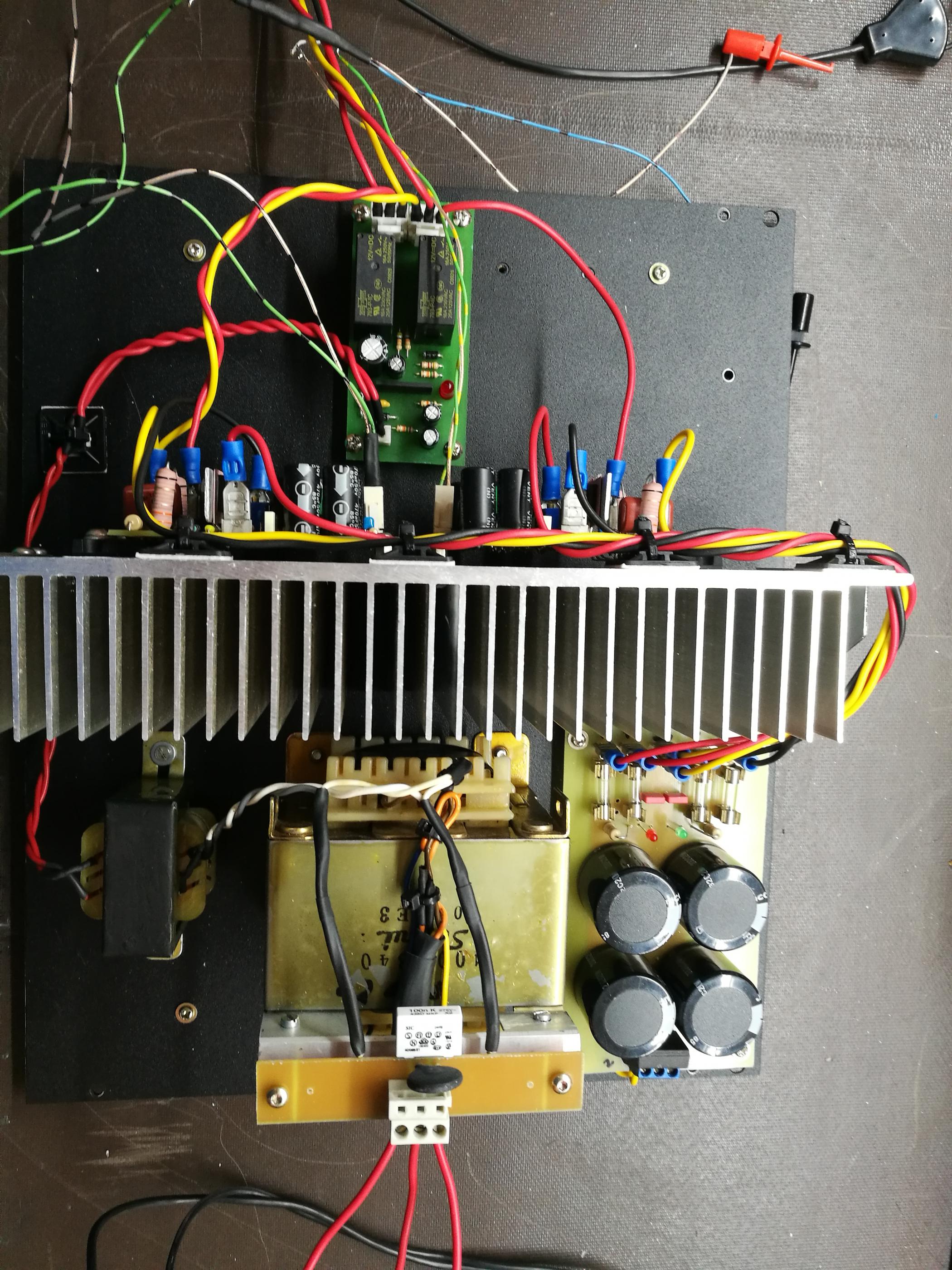

Finished with the electronic side, now to build into a nice Zebra wood chassis with oldskool Sifam round VU meters. Very happy with the sound as well !!🙂

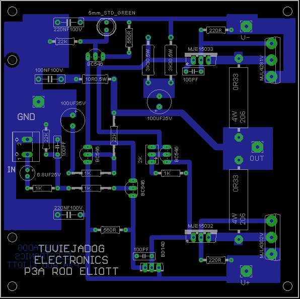

Hi everyone, I hope you are well, I attached my P3A design, I did it in size 100mm * 100mm since the heatsink (zd 2k model) makes me force the power transistors to be placed at that distance, the bd140 I left it in that position since it has a heatsink when using it in a voltage higher than 35 volts, and the PCB manufacturers (in China, some) have the offer of up to 2 sides for 5 dollars or less for this maximum size, personally, I like it the design achieved since I had no bridge left, although the fuses are absent, I would be placing them after the source capacitors.

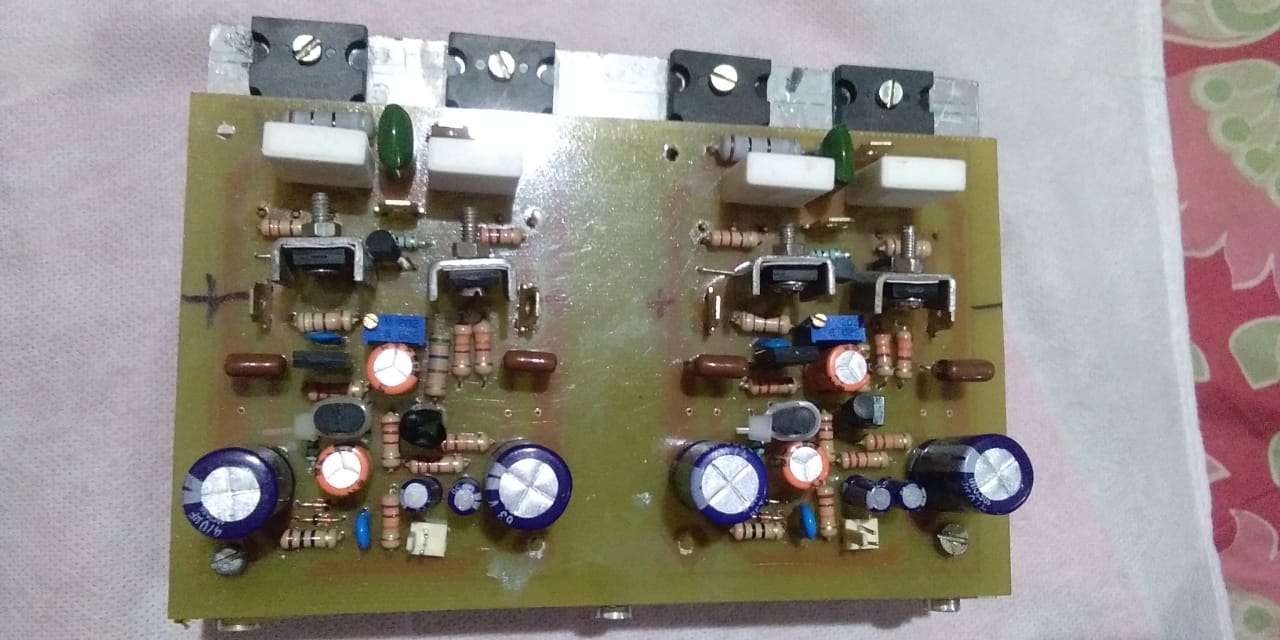

Hi sir

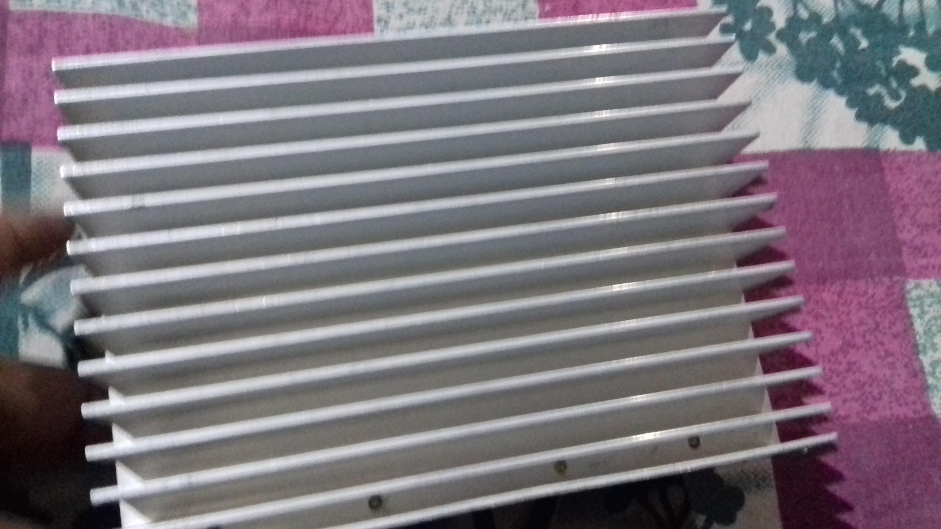

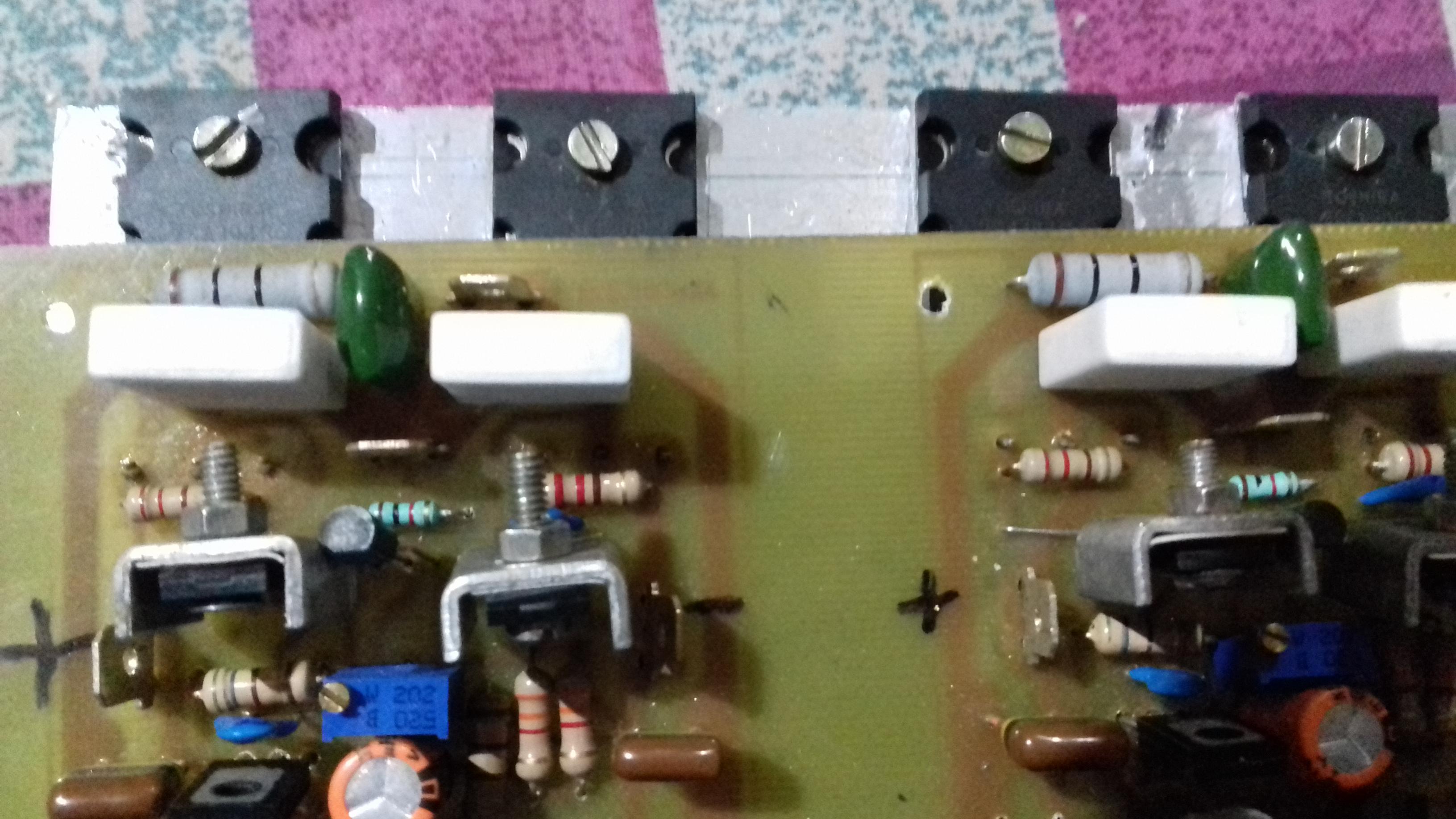

I completed two channel .power supply is 30..0..30 volts AC @3Ampre .sound is good but my output transistors become hot within two three minutes.I used heavy heatsink also.please suggest remedy.thanks
Masood, I cannot see the heatsink but you seem to have attached the transistors directly to a strip of metal that does not seem perfectly flat and I cannot see any insulators or thermal grease to aid heat transfer. This is important for proper assembly of all power semiconductors with their heatsinks.
Perhaps I just can't see these details in your pic but you need to be specific and use correct heatsink materials to make the assembly work correctly at a safe working temperature. Is the metal sheet I can see the heatsink? Is it aluminium? Just how big is the heatsink and what fins does it have?
Even at just +/-30V DC supply, there will be a lot more heat with the recommended 70mA bias current than a more usual 15 mA bias setting that might normally be used with this CFP type of output stage.
To have both amplifiers coupled to a single heatsink, you need a heatsink rated ated at about 0.8 K/W or twice that if you use 2 separate heatsinks. All mating surfaces need to be perfectly flat and smooth, and a continuous film of white thermal grease should be applied to both sides of a thin mica washer sandwiched correctly between the power transistors and the heatsink. The single mounting bolt is not really adequate to apply sufficient even pressure to rubber pad (silpad) type washers and I suggest you use very thin mica instead, for best results.
As indication of a suitable size heatsink, a P3A I checked about 1 year ago was fitted a heavy piece of extrusion that had 15 fins and was 40MM thick, 75 mm high and 175 mm wide. With 70 mA bias current through both channels and 35V power supplies, the temperature settled at 52C on a day that was 28C. Even that feels quite hot to touch.
You could of course, just adjust the bias to a more normal current of just 10-15 mA (each amplifier) though that probably won't sound as good as the recommended setting.
The amplifier will forgive most of the mistakes you made on the pcb design and play music after
point is that most amplifier will play with a bad pcb
if the target though is better stability and higher sound quality then you need to observe and study some pcb rules when it comes to audio applications.
