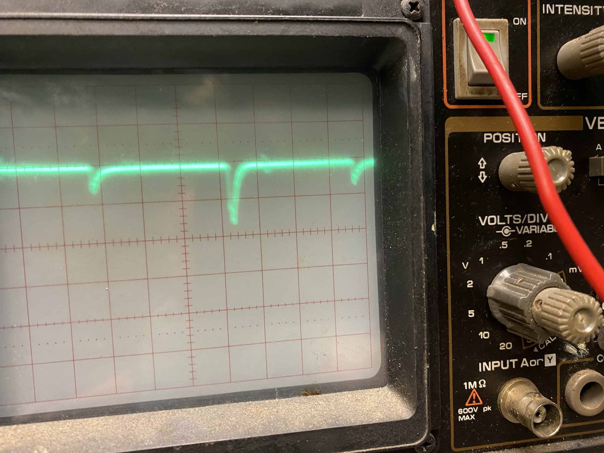

I'd desolder and lift the center leg of the rectifiers and check the drive signals with no rail voltage.
If I remove the output board from the amp . The whining goes away from the transformer and the outputs remain cold . I’m wondering if one of the ic’s is defective . I guess I’m gonna have to order new ic’s again and see if that fixes the issues .

If I solder the output board back in disconnect the rectifiers do I need to do anything else to check the drive in the outputs ?

Confirm that there is no voltage on the source leg of the FETs.
Connect the scope ground to the source leg. then recheck.
I’m gonna have to order new ic’s for the output board . No change in drive signals . Also the amp will power up and after 3 secs go into thermal protection and repeat the cycle . If I remove the board the amp remains on and idles fine
