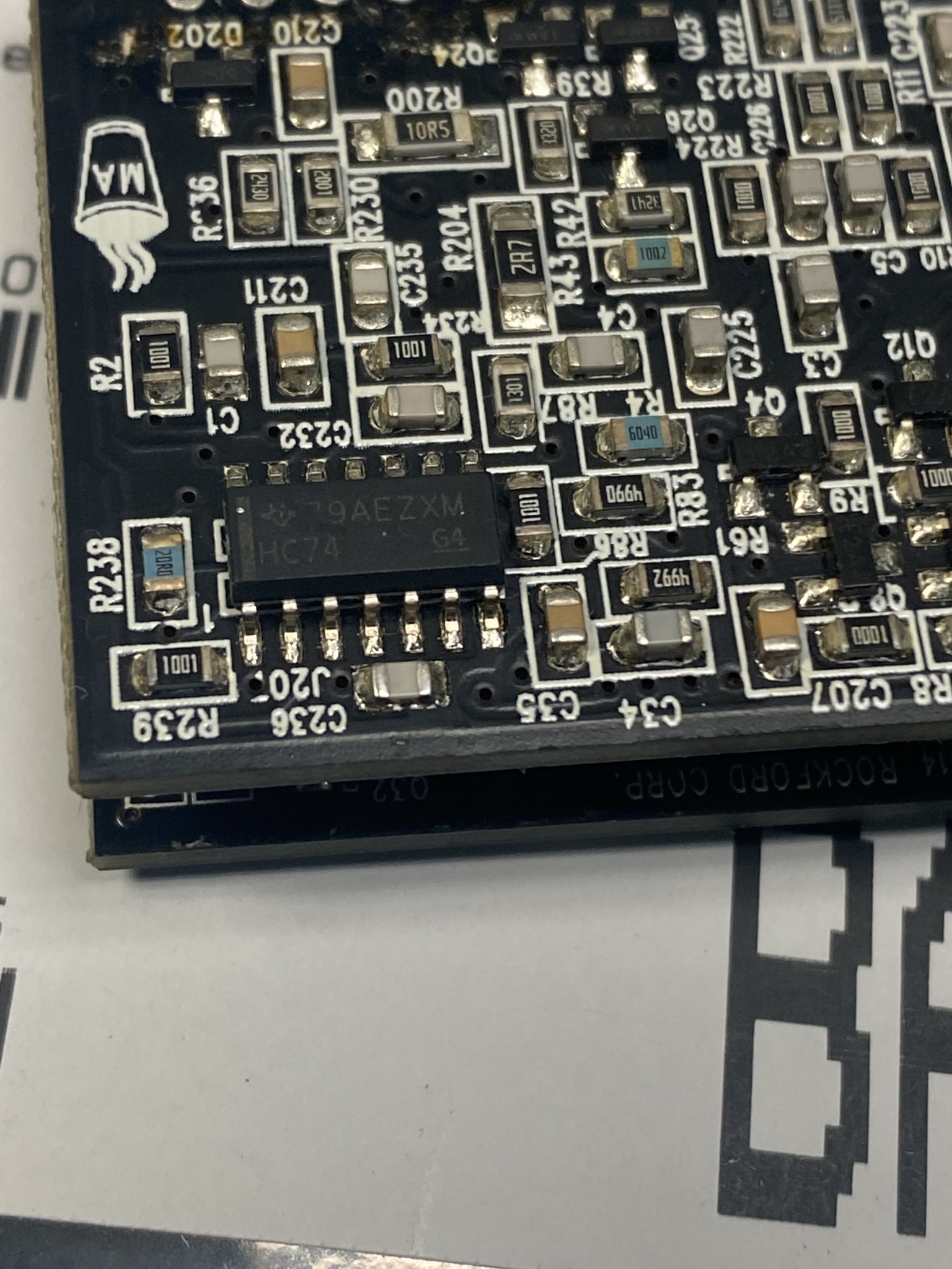

There are 2 of these ic’s on the board and also a LM13700 along with several lm833

I've never seen the LM13700 fail in this amp and was VERY rare to fail on other amps. I've see the 74HC74 fail but not many times.
Virtually every failed IC that I've found on these boards was found thermally. I'd freeze the ICs with canned air and power the amp up. If you see one that defrosts very quickly, it's likely defective.

Ok I’ll admit I messed up when I installed one of the new ic’s the 74hc I installed backwards . I took it back off the board . What’s the likeliness it’s defective now ?
