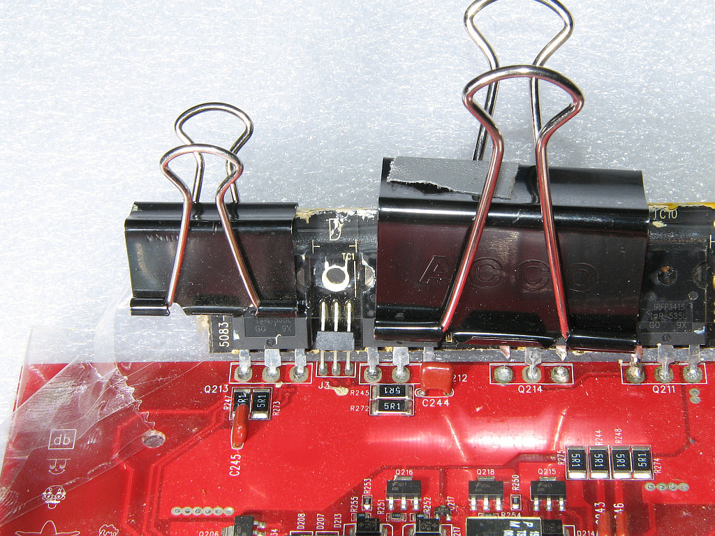

To get the jumper soldered back to the insulator, you'll need to use the torch. Use a black binder type paper clip (see attached for an example) to hold the output transistor in place.

This is simply an example of the types of clips and the placement. This amp was being repaired and was simply convenient to use. The tape (difficult to see) is being used to keep the heatsink compound at bay. You would NOT have tape applied when heating the insulator.
