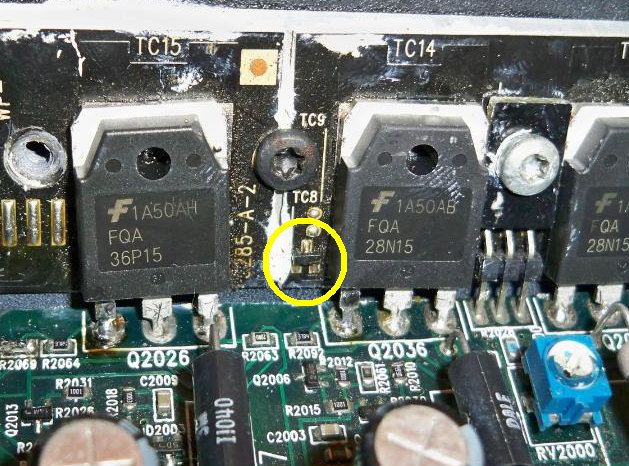

Can you post some high resolution photos showing the entire set of MEHSA insulators for the defective channel?
i could not get my pics to show on thread. you should be able to view them via this link.
Pictures by grandam88 - Photobucket
For Q2036, make sure that you don't read anything near 0 ohms between the three legs of the transistor and the the three legs of the 3-legged jumper to the right of the transistor. Check all combinations.
Also confirm that you have three 0 ohm connections between the terminals of the surface mount transistor just to the left of Q2036 and the 3-legged jumper. none of these should be shorted together. Confirm that none are.
It's possible. Sometimes the insulating coating gets damaged and the new transistors short to those traces.
on the the q2036 i got nothing all good readings but on one leg got an OL and couldn't get a reading.
on the second test, testing for ohms to surface mount transistor, i got readings in the m ohm range. that's if the link i posted is the surface mount transistor.
please confirm i am testing the right component.
100_0878-1.jpg picture by grandam88 - Photobucket
