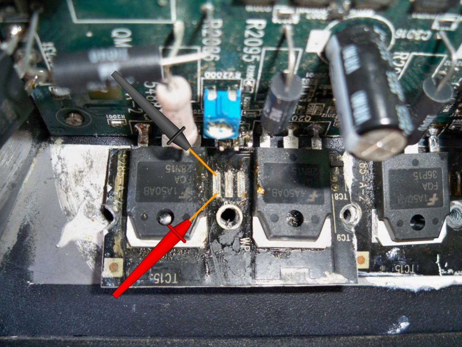

i went back and remeasured and noticed i do get readings on all configurations. but it seems to change readings when i switch probes from positive on mosfet, and neg on jumper, to negative on mosfet and positive on jumper.
so yes all readings are in mega ohms range. also did notice under that specific jumper, it appears there is only solder on one of the contacts for the mesha board out of three total.

There must be one connection between each of the SMD transistor's terminals (transistor circled in the photo) and one of the terminals of the jumper. If there isn't, that's a problem.
The jumper MUST be soldered to the MEHSA insulator.

the jumpers aren't soldered to the insulators right now, they are held on with the screws with the plate that pushes down the pins to touch the contacts on the mehsa boards.
the thing i noticed is out of the 3 contacts on the mesha board i looked @, only one seeed to have solder on it. like the solder is gone.

so should i "add" solder back to the contacts, or physically solder them to the mehsa boards?

Yes. You'll have to remove the board from the sink to do it. When soldering them down, make sure that the same angle it be when clamped down. When you get the board back in the sink, push the insulator against the heatsink and heat each leg of the jumper to relieve the tension on the legs.

While it's away from the insulator, confirm that you have a direct connection (~0 ohms) between one of the terminals on the SMD transistor and one of the solder pads (on the insulator) for the jumper.
Also confirm that you have no connection (all OL) between all jumper pads on the insulator and the terminals on Q2036. Check all combinations possible.

on the terminals of smd transistor and solder pads i have OL. all combination's.
on solder pads to q2036 i have all OL all combination's.
but on solder pads to back of mesha boards i have readings in m ohm range.
i have tried to solder the legs to solder pads for about 20 mins, they wont stick no matter what. then something came off looked kind of like a "leg" of something or maybe the "protector" between mesha board and solder of solder pads. i dunno.

is there some kind of protective barrier between the solder pads and the mesha board? cause i have noticed when i measure from solder pad to back of mesha i get an ohm reading on damaged board, where as on another board, i don't get any ohm readings.
also when measuring from solder pad to surface mounted transistor, i don't get any ohm reading, where as on undamaged board i get a reading to the surface mounted transistor.

this turning "white" was on the insulator. i cleaned it repeatedly, not it coming out to where i can see the metal. but i feel this is the front of the mesha board. not getting ohm readings from pads to surface mounted transistor. i have a feeling i damaged it somehow. here the pic of its current state.
They appear to be OK. Measure the resistance from the top of each solder pad to the bottom of each solder pad. All should read ~0 ohms.
If they do, confirm the connections to the SMD transistor. Compare the readings to the jumper and SMD transistor for the other channel.

as far as the ohm readings, i measured the other one without soldered legs to mesha got all OL on all configurations to the transistor. i got OL on all measurements to transistor from solder pads to transistor on the previous one with non soldered jumpers. i have noticed the jumpers on other channel are soldered. on readings from top to bottom of solder pad all read OL.

when i do as described in picture i get .4 ohm. but i touched my probes together and get .4. so yes i get OL when i do that test.
Houston, we have a problem.
If you meter probes are in free air, not touching anything, what does the meter read?
