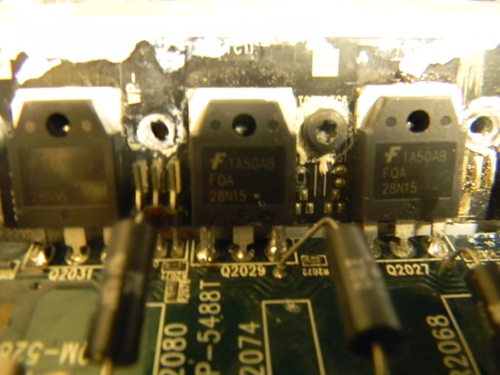

yeah this insulator only holds 2 output fets, probably making it even harder to find.

alright, i let the amp run for about 20 minutes. no temps above 100 degrees. i am using a infrared hand held thermometer. the hottest item was a lm317t @ 95-100 degrees.
Were the MEHSA insulators clamped to the heatsink?
Did the power supply end of the heatsink get warmer than the audio end of the heatsink?
mehsa boards were screwed down to heatsink.
the power supply side heatsink reached about 100F, the output side didn't get any hotter than about 80 degrees.

You'll need to order a substitute bias transistor. The 512-KSC945CGTA from Mouser should work. Order a few extras.
If you don't have any heatsink compound, order some when you order the transistors.

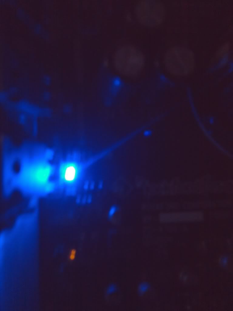

also i have a VERY VERY faint protect light. dunno what it is, but amp is working, so i don't think it in protect.
its the orange light in the photo
The dim amber LED is common for the Rockford amps that use the protection circuits like the ones used in your amp. If it illuminates for a fault, it will be much brighter.
