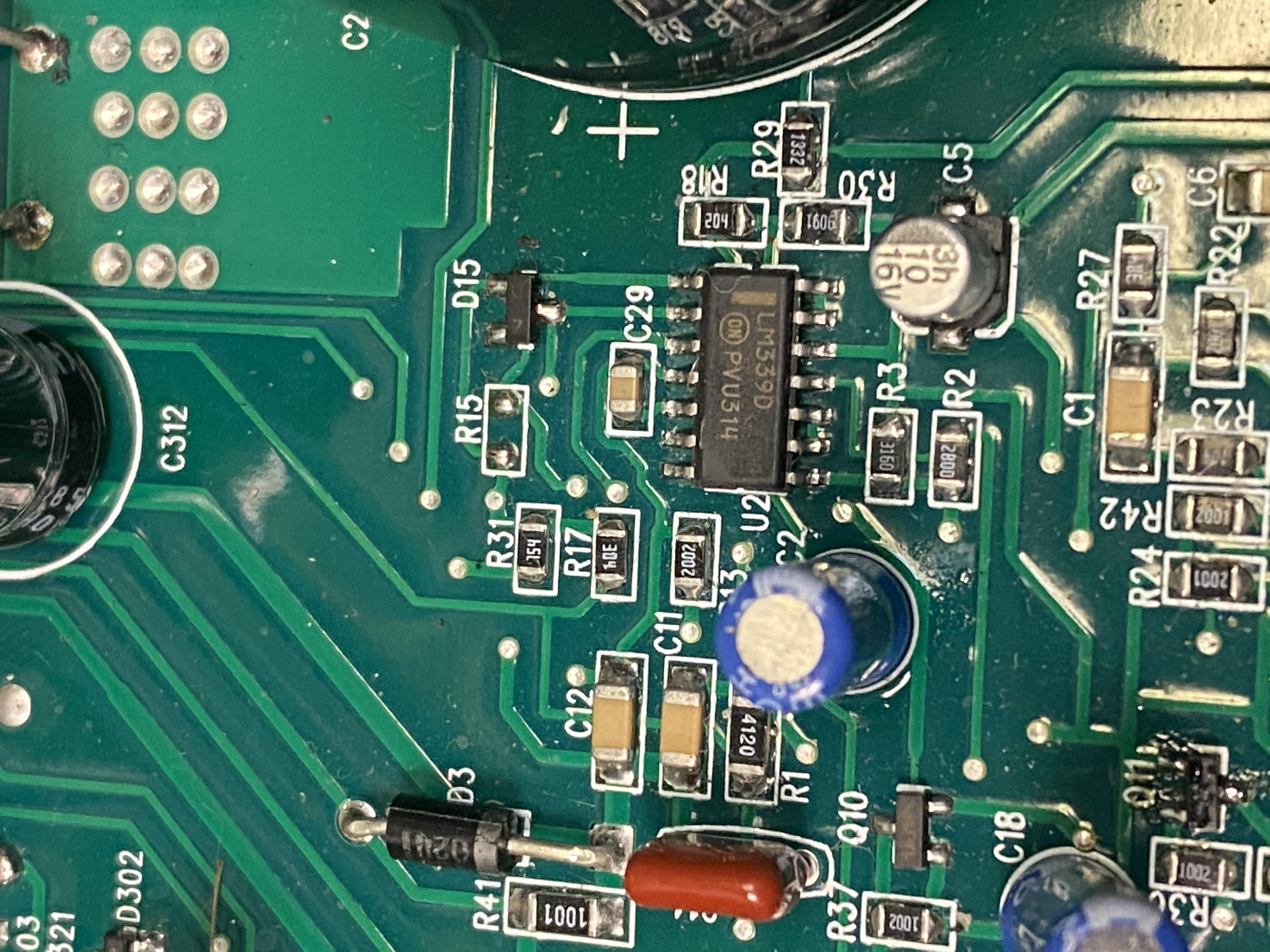

Yes .
But now the amp won’t even power up I don’t get this amp .
Here is what I get on the 494
Pin 1:0.00
Pin 2:4.80
Pin 3:0.04
Pin 4:4.91
Pin 5:1.48
Pin 6:3.37
Pin 7:0.00
Pin 8:13.20
Pin 9:0.00
Pin 10:0.00
Pin 11:13.20
Pin 12:13.20
Pin 13:4.96
Pin 14:4.96
Pin 15:4.96
Pin 16:0.00

Pin 1:0.00
Pin 2:0.00
Pin 3:13.20
Pin 4:0.13
Pin 5:1.94
Pin 6:4.96
Pin 7:0.53
Pin 8:4.34
Pin 9:4.96
Pin 10:4.96
Pin 11:8.23
Pin 12:0.00
Pin 13:0.05
Pin 14:0.00
Pin 2:0.00
Pin 3:13.20
Pin 4:0.13
Pin 5:1.94
Pin 6:4.96
Pin 7:0.53
Pin 8:4.34
Pin 9:4.96
Pin 10:4.96
Pin 11:8.23
Pin 12:0.00
Pin 13:0.05
Pin 14:0.00
Pin 12 of the 339 is directly connected to ground in the amp
Pin 6 connects to R29 13.3k ohm resistor then to R330 9.09k then to ground
I have an 800a2 board here same layout as this amp .
Pin 6 isn’t directly connected to ground either
The 800a2 is bird number PC2038-G
