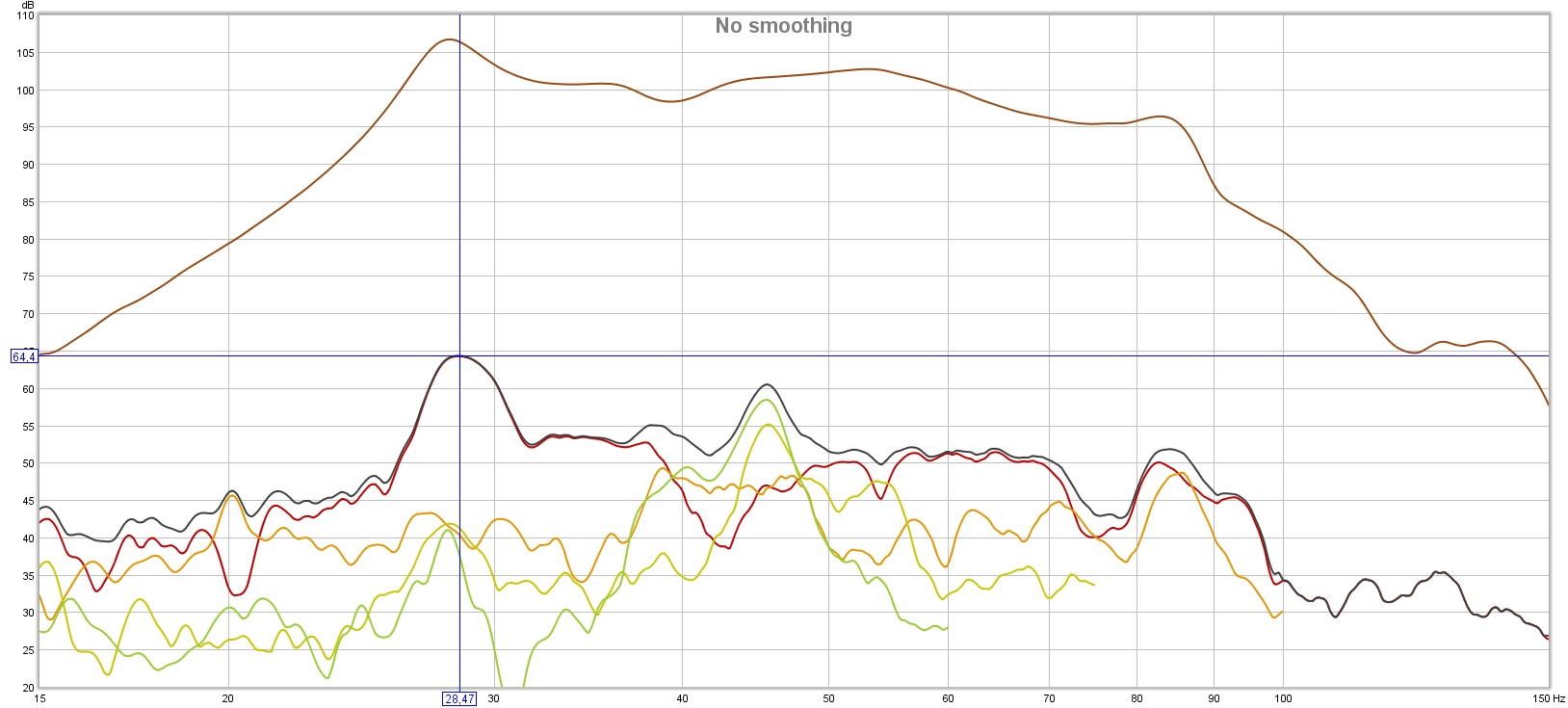

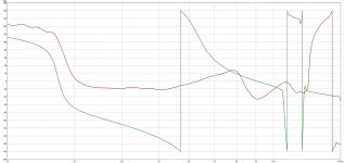

Some more measurements. GD and Phase is taken from the near port measurement I made indoors in my living room (picture of setup a few posts up)
Distortion is taken from the near windshield measurement I made in the car. I am impressed by the low amounts of distortion considering the nature of the driver. It is a pure spl-comp driver without any shorting rings on the pole piece of any other distortion lowering mechanism. The high order bandpass function really filters out a lot of distortion.
Both Phase and Group Delay is much better in real life then what Hornresp predicts.

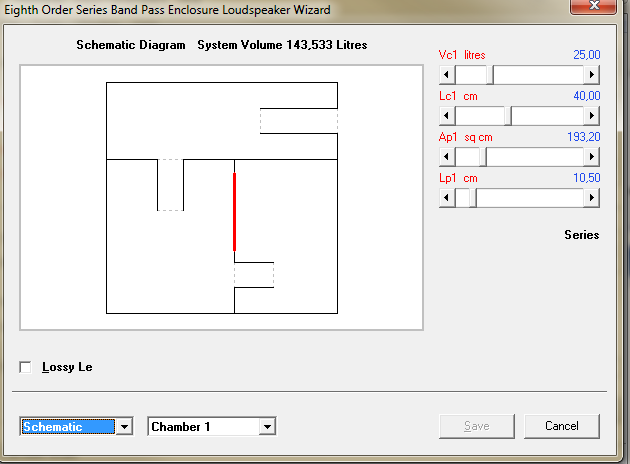

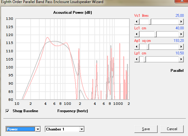

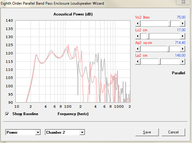

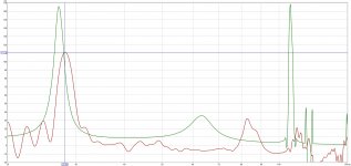

Serie BP 8th can now be done in hornresp !

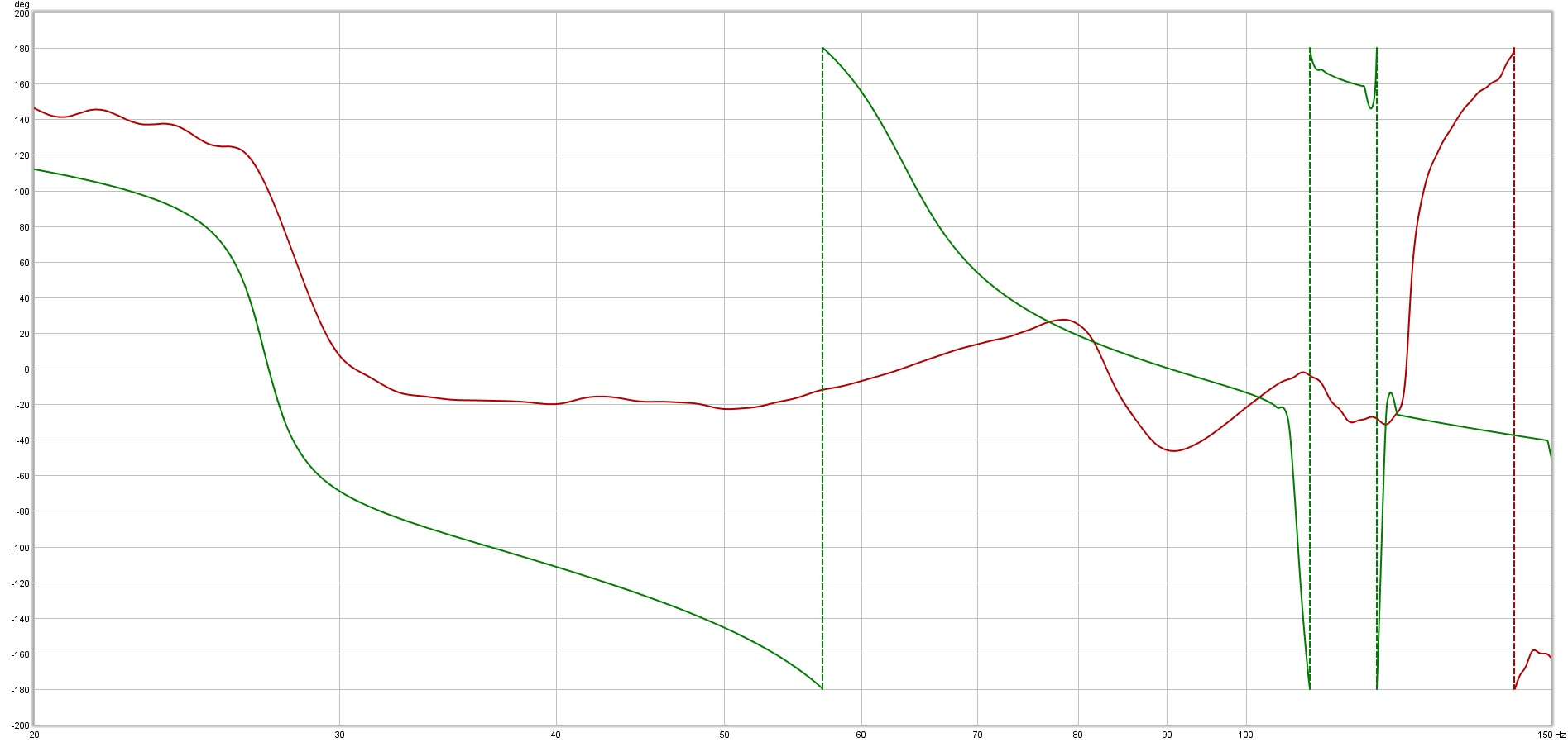

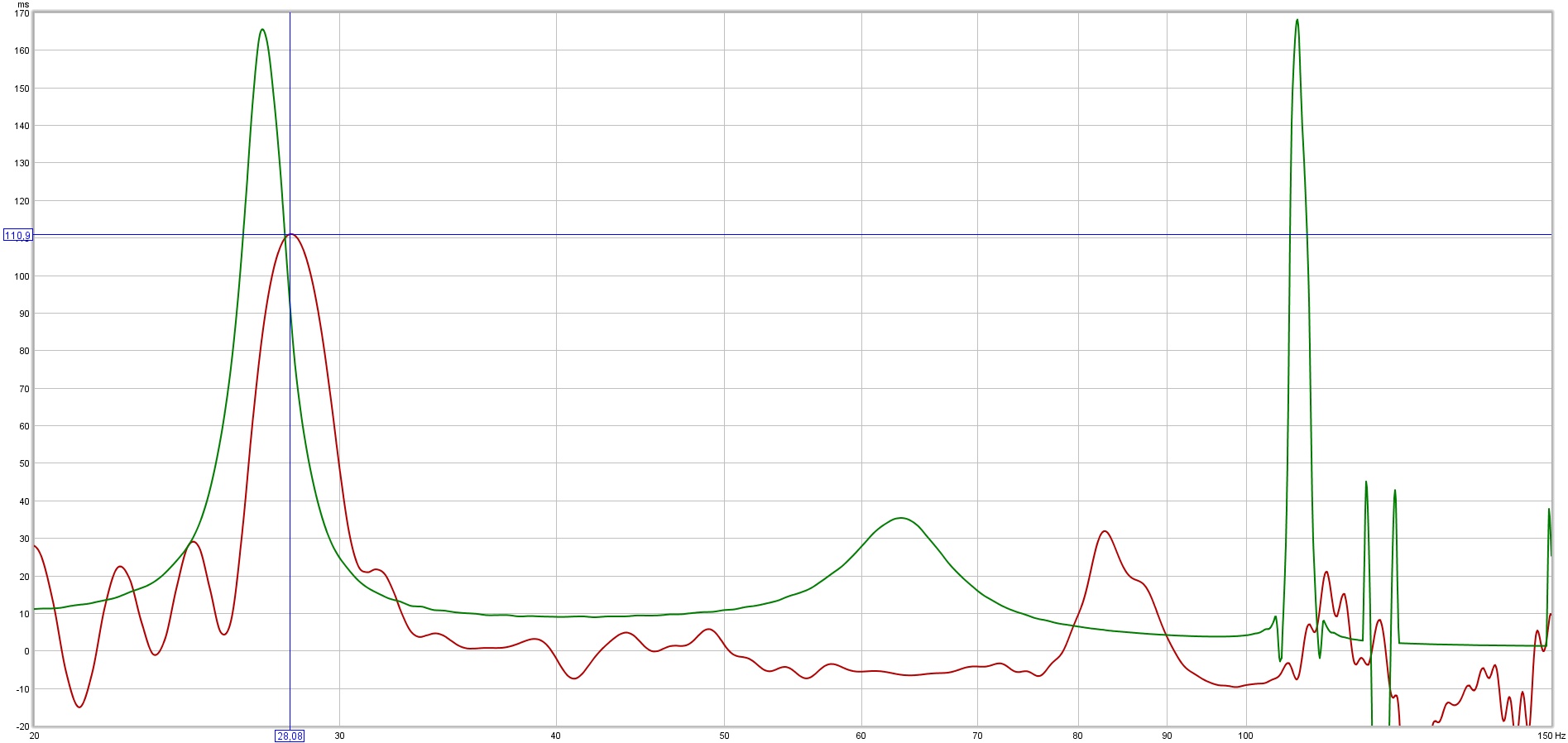

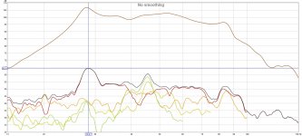

Simming with my own driver parameters in picture 3, i tweak for curve like the grey one and not the red, phase and filtering wise. Really interesting topology.
It allow more damping as show in picture 4, compared to red curve of parralel 8th.
Thank Circlomanen for showing us this !

I have been exploring series tuned quarter wave based 8th order BP for a few years now. ROAR and HROAR is the fruit of this work. Finally I have a much improved tool to simulate and explore them in the theoretical domain.
Thanks papasteak for asking David McBean for this feature in Hornresp!!!

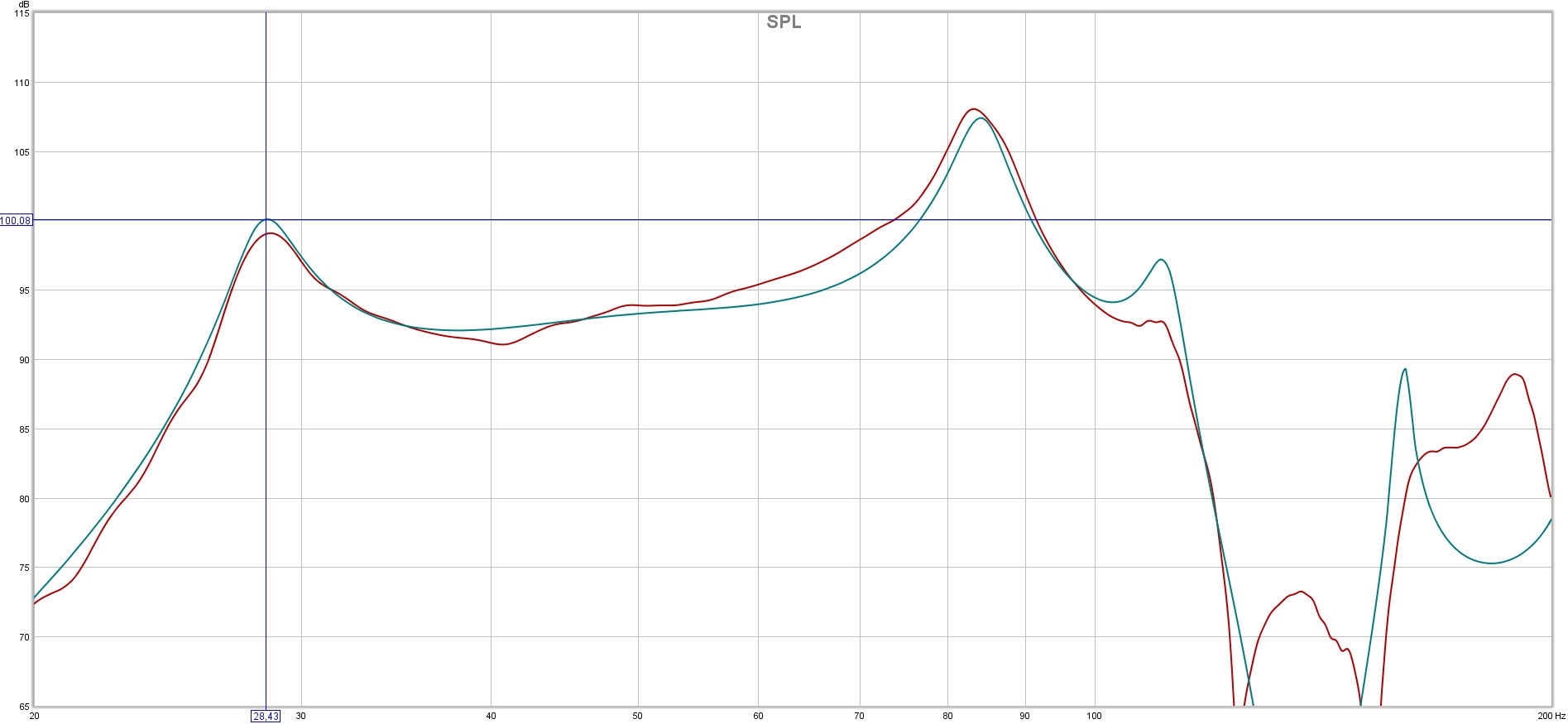

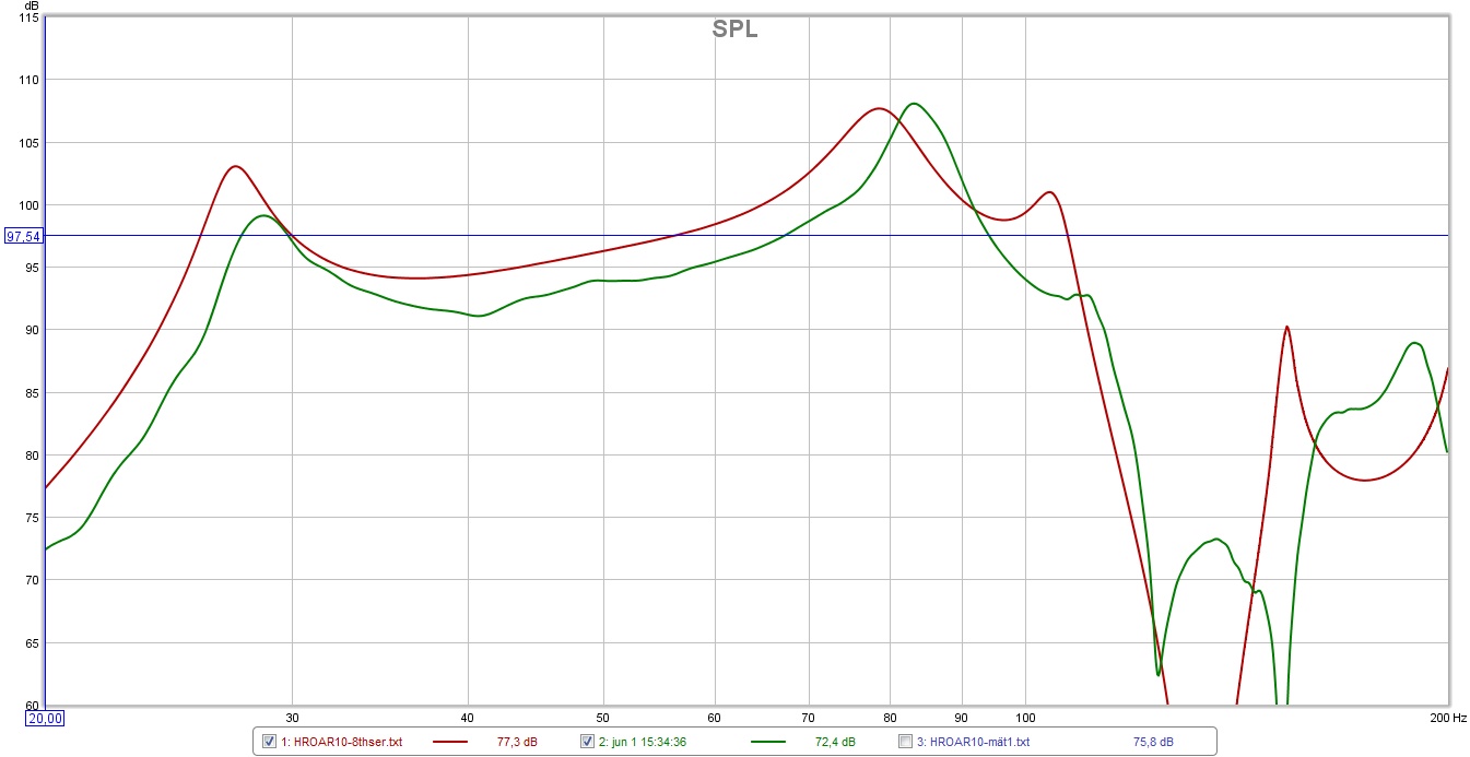

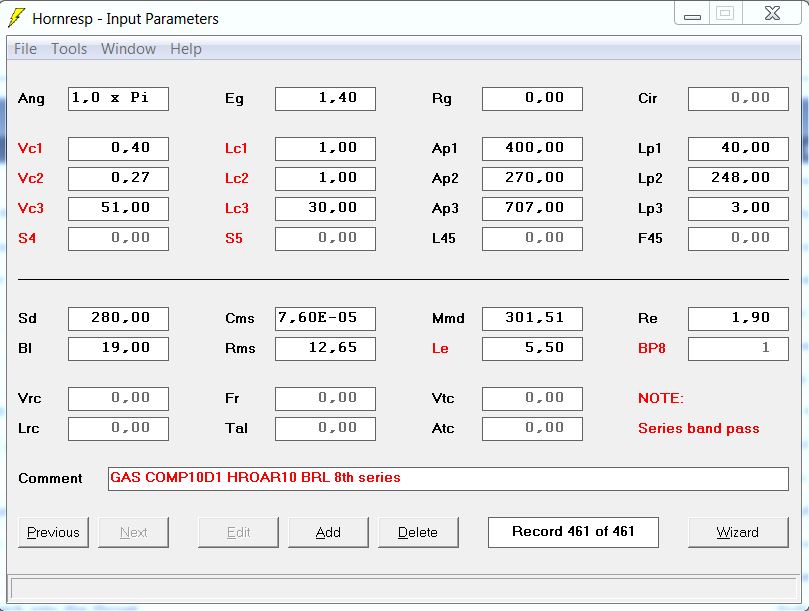

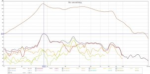

Increasing the Le and lowering the Bl slightly, and a more careful measurement of the actual length and cross section area of the HROAR10 gave this correlation between Hornresp and REW+Umik measurements.
You really can´t expect better correlation between sim and measurement then this.

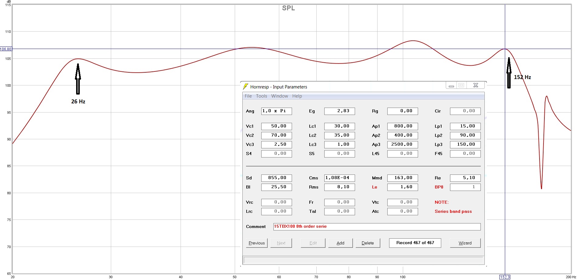

I have been playing around with this new series tuned 8th order BP function in Hornresp and I am impressed by the simulated response that is possible to get.
Here is a single B&C 15TBX100 in a 8th order BP. 26 - 152 Hz is almost 3 octaves of usable bandwidth!!!
Only 13 m/s port velocity at xmax for the driver. Much less from the large quarter wave front resonator.

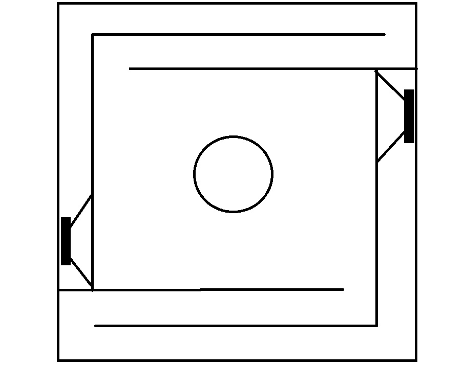

This is one reasonable simple layout of a two driver version. Much more complex then the single driver version, but it gets a more symmetrical loading of the front chamber instead, which should be a good thing. Since there is only straight non expanding sections, it should be a very simple and fast build despite the increased number of parts.
No Hornresp sim of this layout at the moment. It is a work in progress and I am not done evaluating the first single driver version yet.
Are you thinking of a enclosure for 8" drivers or larger? 🙂
I have been simulating and sketching many different variations of the HROAR these last weeks. But I don't have the means to build any symmetrical dual driver HROAR at the moment. 8th order enclosures often become quite big for the chosen driver. I have become quite selective and fastidious when it comes to driver selection. Even though my GAS Alpha10D2 works perfectly fine in my HROAR, there is a whole other level of pure overwhelming brute power and impressive dynamics and punsch in low Qts and high Bl drivers like the GAS Comp12D or the Comp10D1 which we built with in the last car sub in this thread. I would guess that the same applies for drivers like the B&C 18IPAL or 15DS115 too.

I can always simulate and sketch something if you have some drivers and want to build a HROAR. All the dual driver symmetrical layouts I have been simulating needs some measuring (REW) and DSP to flatten the spl response. The long section between the tapped pipe and the Helmholtz front resonator exaggerates the tapped pipe fundamental quarter wave resonance into a quite pronounced peak. See the response of the last build in this thread for an example of this.

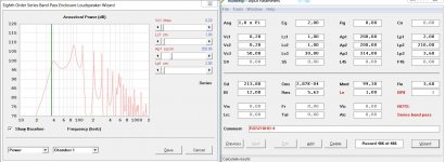

The Dayton Audio RSS210HO-4 seems to be reasonable suitable for a small compact HROAR-8 design. I have not made any drawing yet. This is just a first feasibility test in Hornresp, and I have not optimized it much.
Small drivers tend to get more pronounced peaks in the response graph, but this is not something I worry much about. DSP is cheap and room acoustics is usually much worse.
