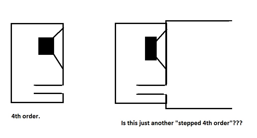

Would you consider both to be 4th order enclosures?
A BR with a large front resonator should be called "stepped 4th order" if you call my ROAR or HROAR a "Stepped tapped horn" or "stepped 6th order".
Because you add a third chamber. The large front resonator is a third tuned chamber.
How is the last section not a tuned extra chamber?
The last section LOOKS like a stepped positive expansion from S3 to S4.
If there was a port in/or after S4/S5, then the model looks like a true TH8 or TQWP8.
However, you are correct. You added a tuned 3rd chamber (which is also the port) to the TQWP that turns the enclosure into a TQWP8. My apologies!

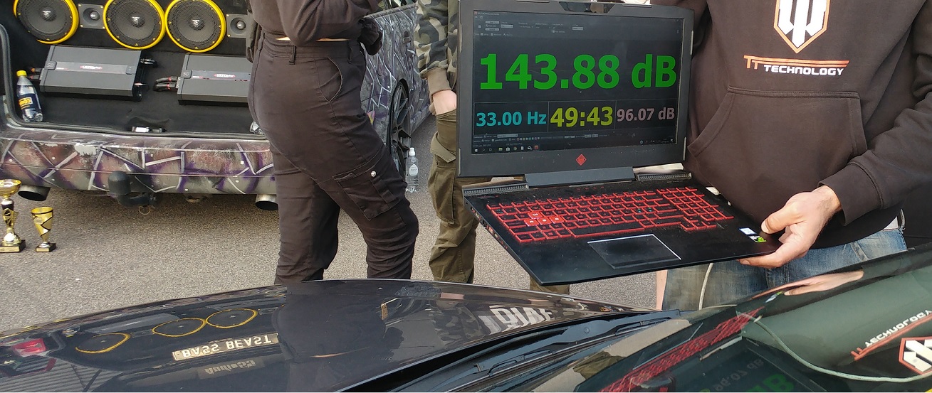

The large car audio HROAR10 was tested yesterday. With the two 1 ohm voice-coils in parallel and the 3500 watt amp pushed until the 200 Ampere fuse blew he got 143,88 dB @ 33 Hz. This after playing very very loud for several hours while demoing this HROAR10 for people. The magnet was so hot that it burnt your fingers if you touched it. I guess 150 dB is not far of with a cool driver and a larger amp. The driver never did more then +- 10 mm cone excursion even with his 3500 watt amp driven to clipping.
Very impressive!

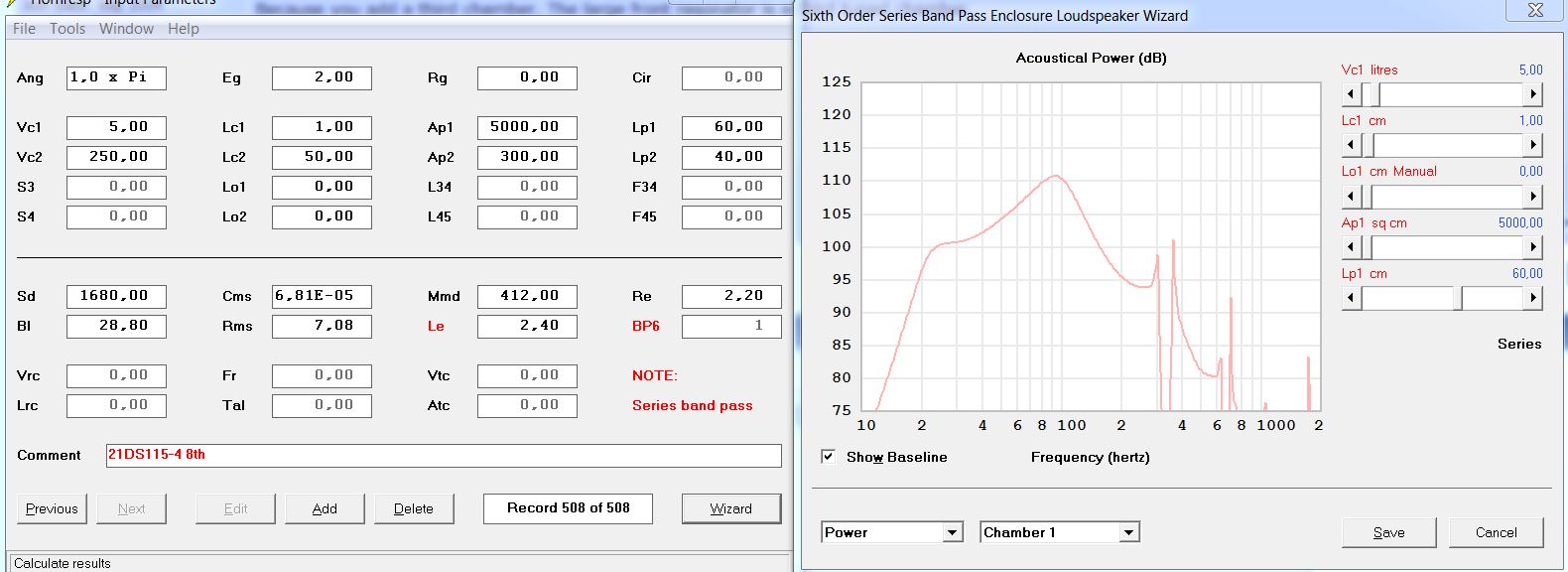

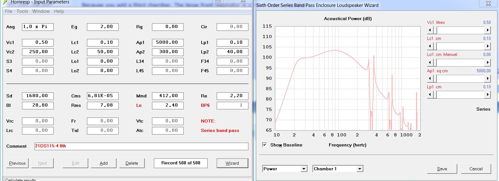

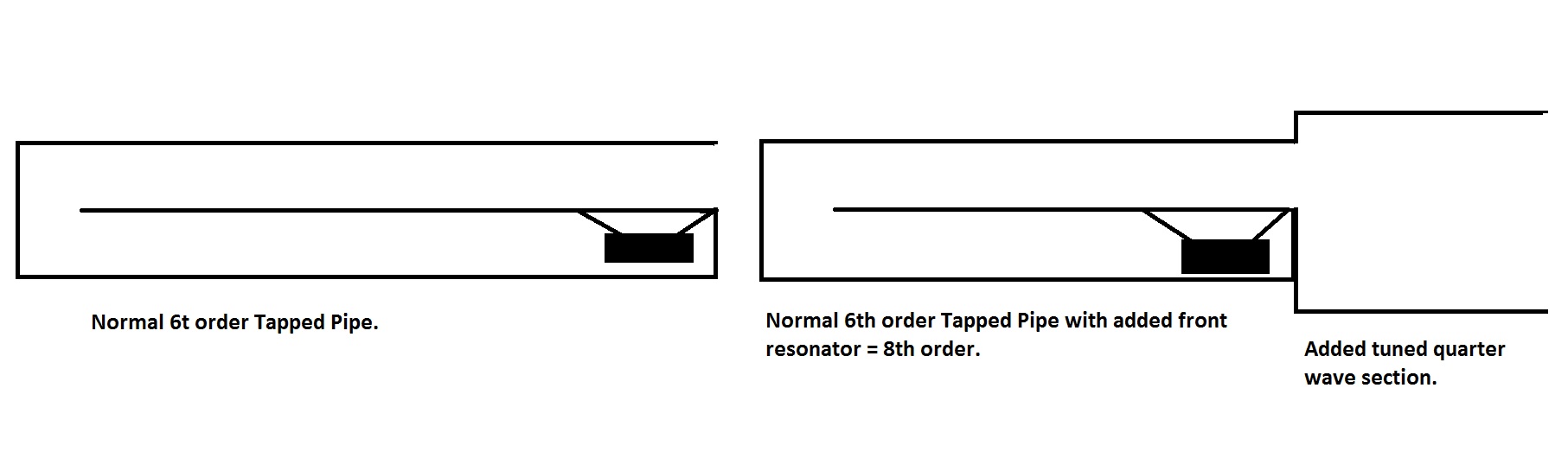

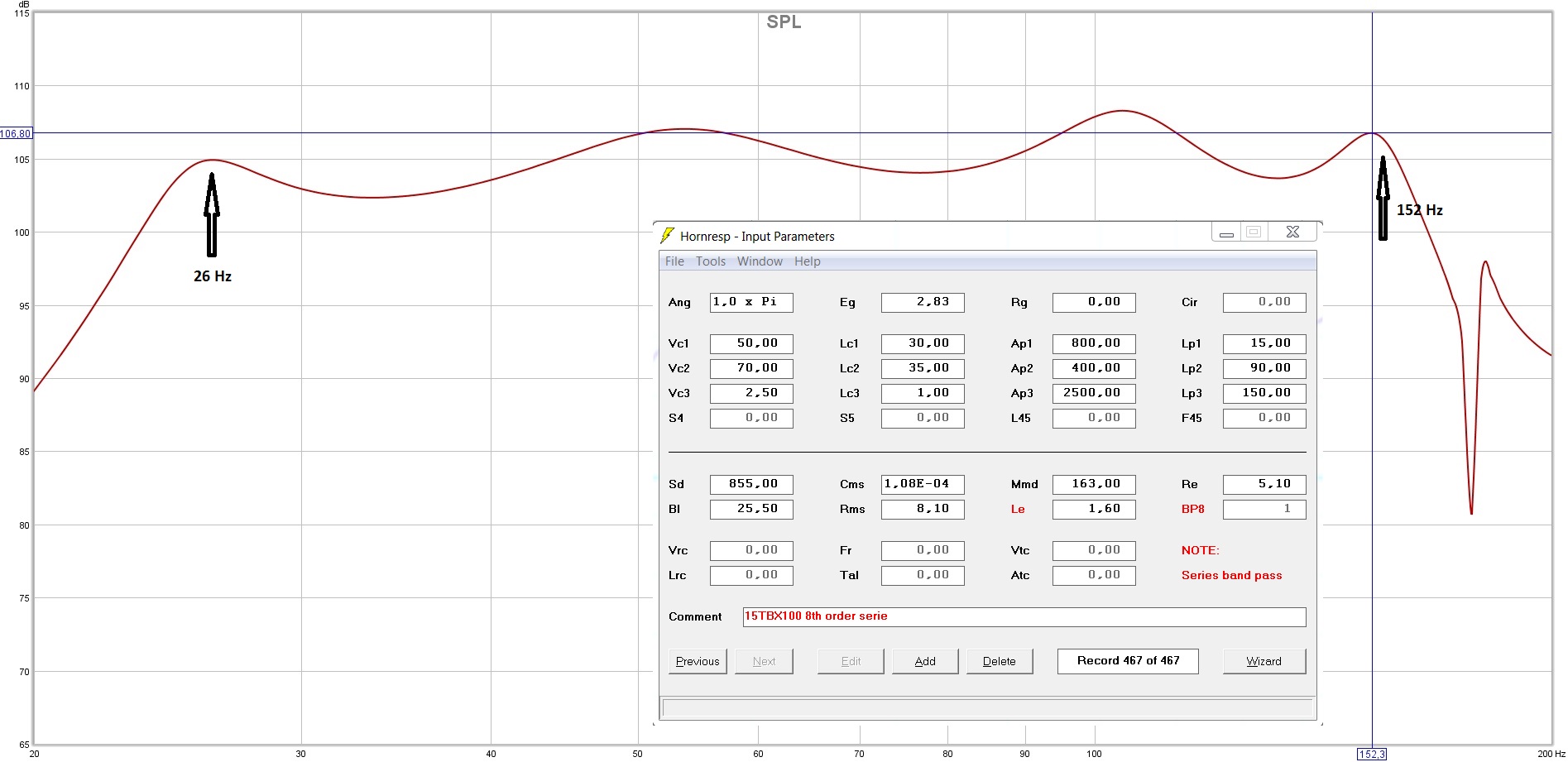

I have been playing around with this new series tuned 8th order BP function in Hornresp and I am impressed by the simulated response that is possible to get.
Here is a single B&C 15TBX100 in a 8th order BP. 26 - 152 Hz is almost 3 octaves of usable bandwidth!!!
Only 13 m/s port velocity at xmax for the driver. Much less from the large quarter wave front resonator.
How big would this enclosure be? i don't understand exactly how to calculate it.
right now, I have two THAM15 equipped with B&C 15TBX100. I was planning to build a ROAR15 to compare them. Now, this simulation looks very promising, especially because of the extended low end. but the corresponding enclosure surely would be a lot bigger than the roar15, isn't it?

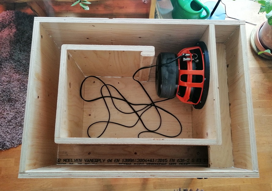

Another HROAR build

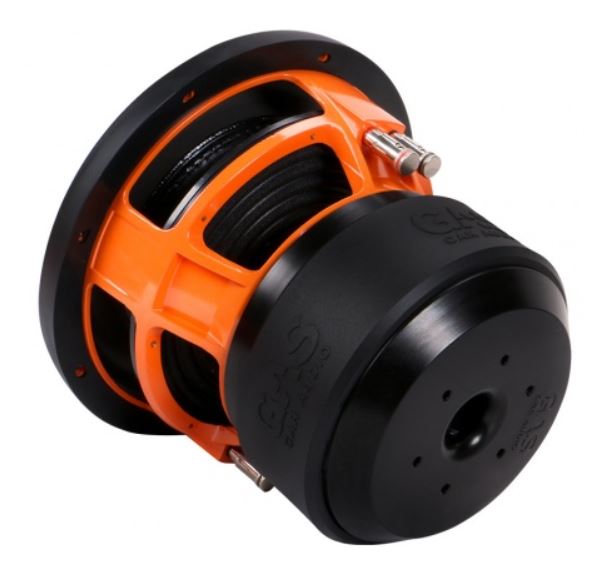

Another car audio bass driver HROAR build. It is very suitable for home theater and Hifi use as well - if the rather tactile, physical and powerful reproduction of bass is not a problem for neighbors, family or pets.

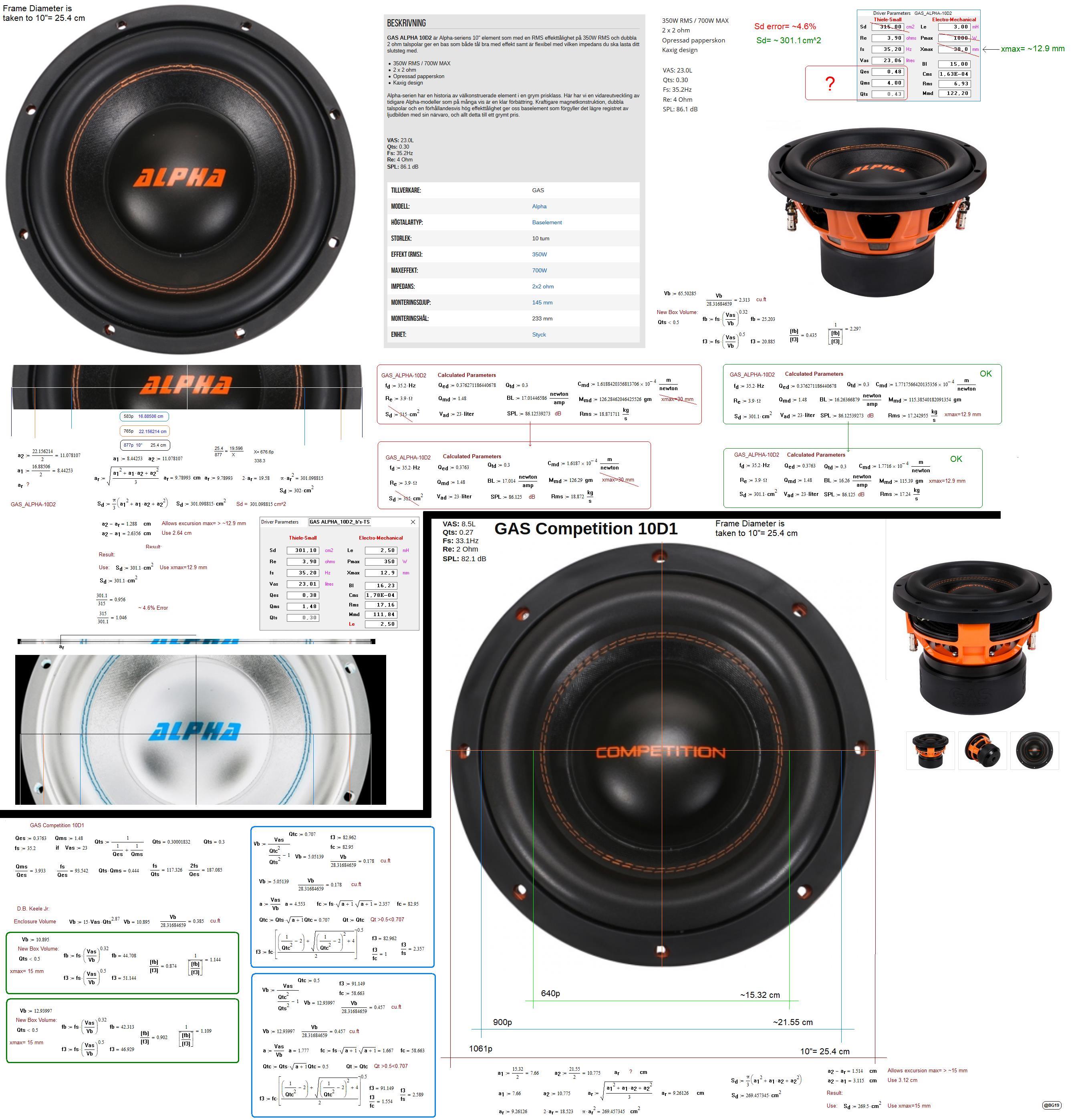

GAS has a new series of bass drivers, and the 12 inch drivers seams to be suitable for the HROAR design. GPX 300D1 – GAS Car Audio
The Qts might be a little to high for my liking and I would prefer a little more Bl, but my hands on experience indicates that it is a very nice and powerful driver.
We have a few hours of work left before we can measure and test it.

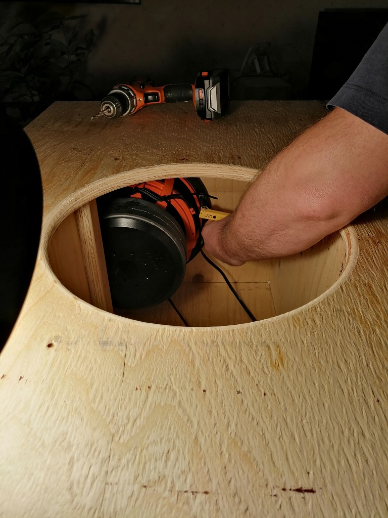

Our first impressions from just pushing the lid/top as tight as we could with our hands and body weight and powering this beast from a 10 watt 6 Dollar Ebay amp - is most promising. The radiator below the living room widows was rattling quite loudly and the bass was felt all throughout our house.

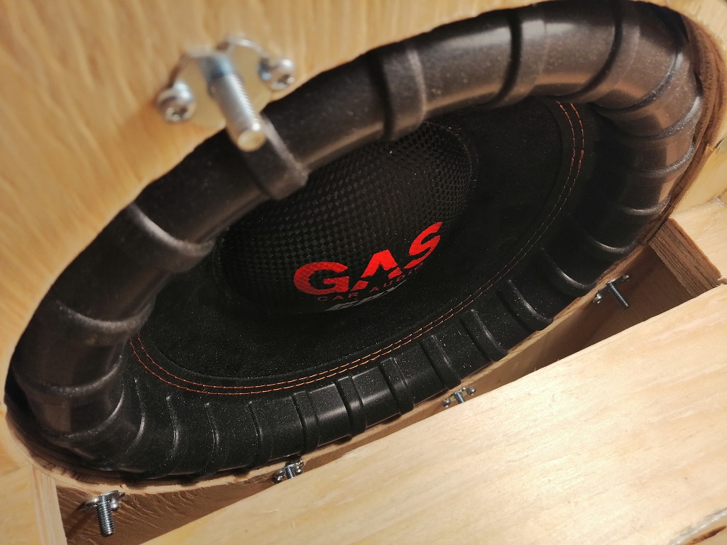

The port is large enough to mount the driver through. It is large enough for my arm as well. It might not be fun to change the driver through the port, but I hope it is manageable even though it might be a bit awkward.
This box is meant to be as simple to build as reasonable possible, and I want to avoid removable panels in the pipe section as this increases the risk of leaks substantially.
I suspect that those screws that are nearest to the side panel will be very difficult, if not impossible, to reach through the vent.
Having a removeable panel in a high compression area can result in some issues, yes. Leaks and higher losses due to panel flex. But these can be planned for, and are likely a more preferable option to having to break apart the box if the driver has to be checked or replaced.
It is easy to access the driver through the port for service or driver replacement. The port is large enough to lift the driver through if needed.
Not impossible, but somewhat awkward.
I hope we don´t need to service or replace the driver to often though... It is not very fun fighting with a heavy driver and hard to reach bolts way back in the dark corners of the front resonator of an HROAR. :irked: But it is doable if we need to.
