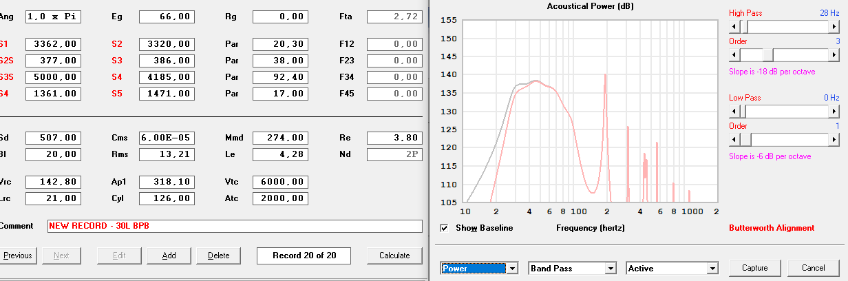

ROAR with Helmholtz front resonator

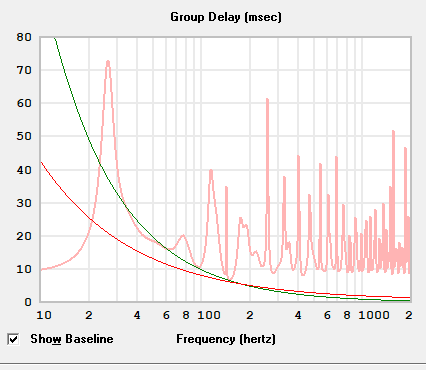

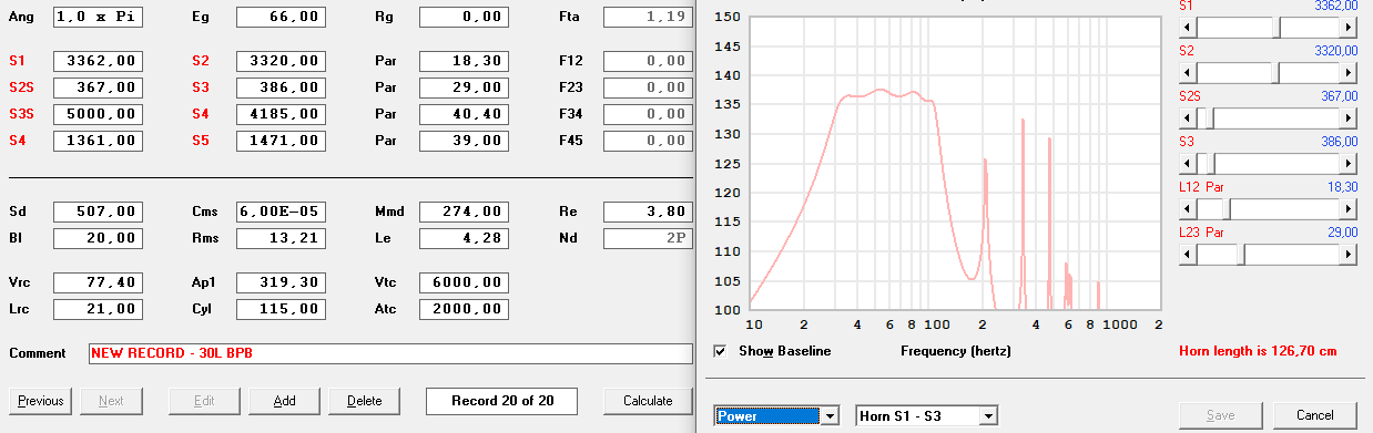

1443 liters...that is huge. And group delay. Response lag of nearly 15ms. Not at all for live music ^^. 5 impedance spikes, it' fun.
I’m Trying to get rid of anything above Fb(quickly sounds bad often)and try to get rid of the <30 hz or so low Fb and lots of group delay combo cause it’s heat in a voice coil and inductance and vent noise, and xmax, and .... everything I’m trying to avoid and give to bass reflex or MLTL instead, or keep it at Fb...

Group delay to bassheads = ya'll late to the party :crackup::rofl:
lol! but maybe we can accept some at the lowest frequencies if playing around?... i hate it in the midband or up top, its been a source of bad cabinets and funky sound for me in these. but a tall skinnny sliver of it at midband i can ignore. i thin. but i dont think i can otherwise... its ruined the delivery or seems the opposite of the avoided area if at lowest frequencies?

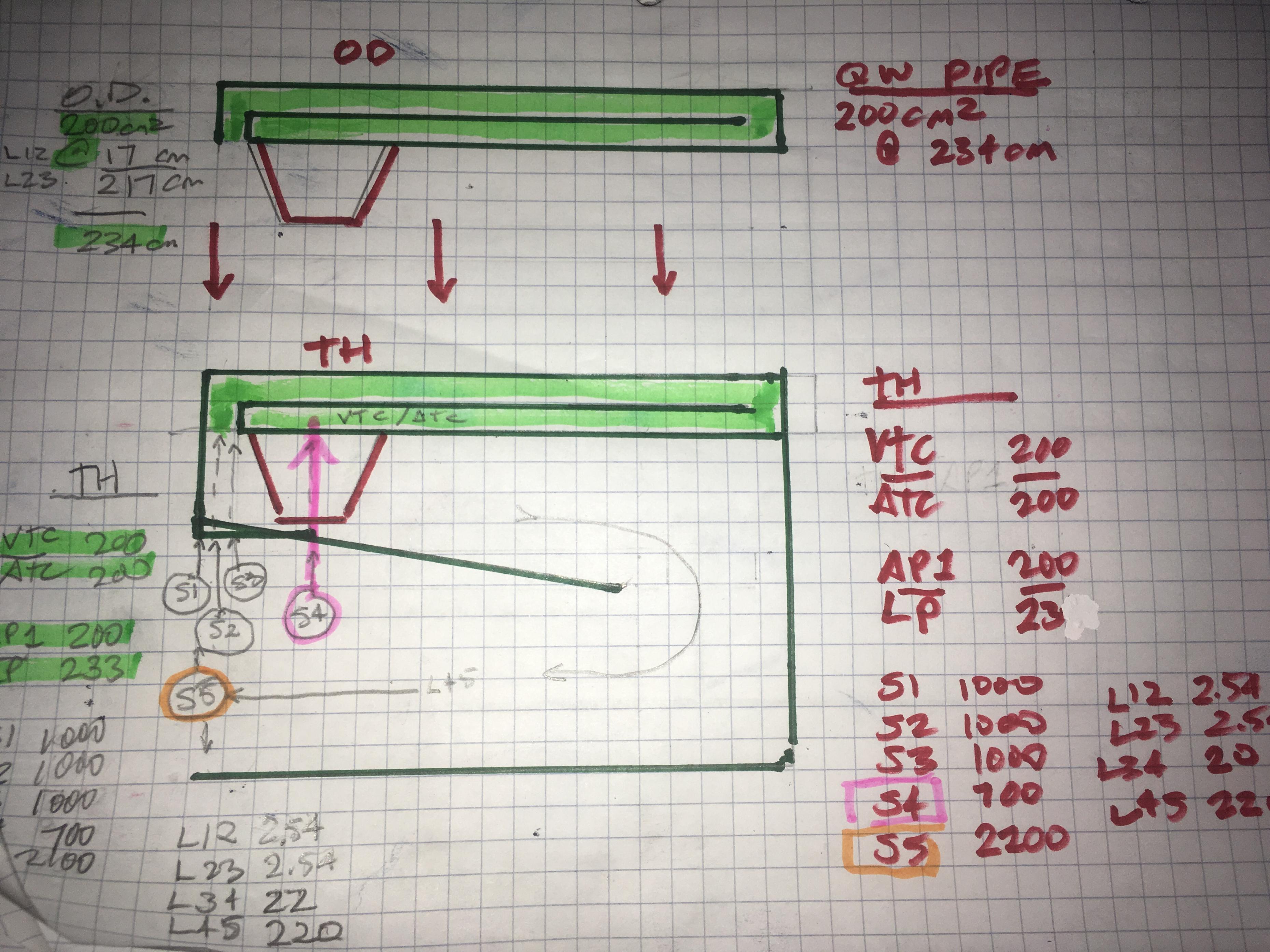

Sure, here’s random ideas as there’s nothing glued and screwed beyond s4. So L45 and also the L12 dont yet exist. If you can come up with anything that doesn’t exceed 15 mm in excursion using any L12 and L45 stuffed or open, mass loaded or expanding path, I’m Game to throw it in the mix ?
Along with accurate portrayal of the area between mouth tap entry (motorside) and exit of the 200cm2 237cm qw pipe(split path) s2... kinda sketchy as is...

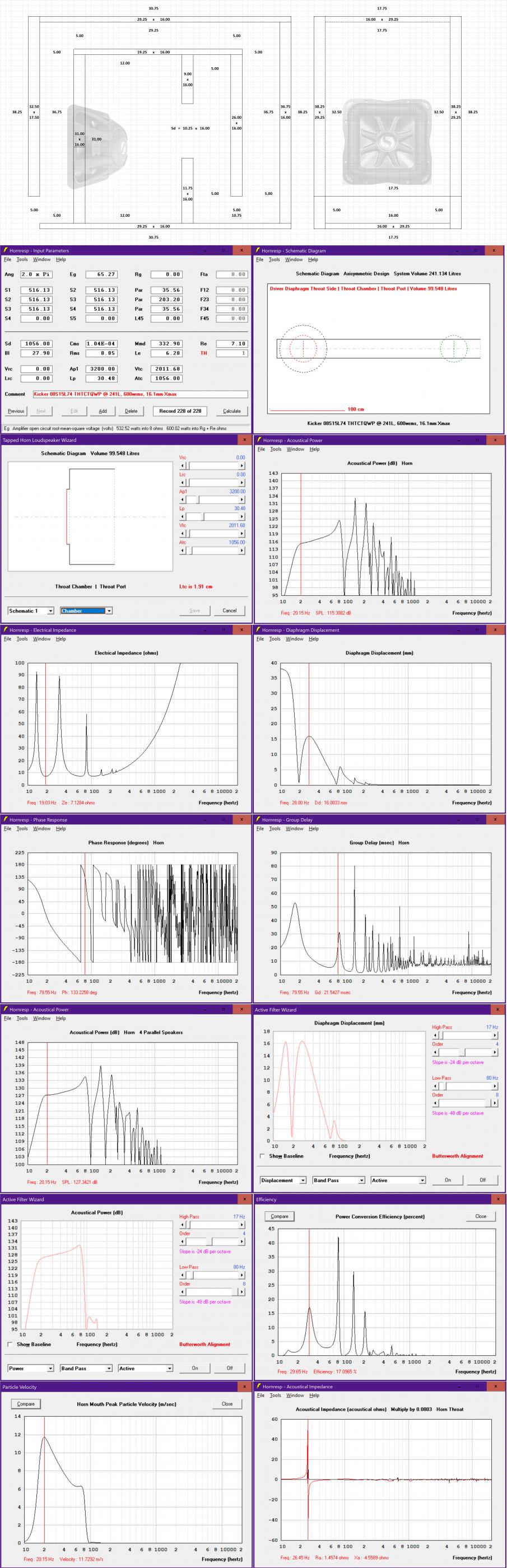

I've played with your drivers data. Sorry, as i play, i'm as always doing stuff my way 😀
Having fun with closed back triple front bandpass box, kind of 8th order closed back, lol

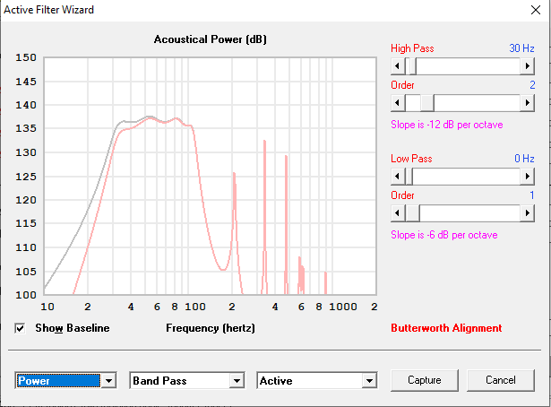

432 liters, first capture is input, second capture is max output with 3rd order HP@30hz for limiting excursion to +/-15mm

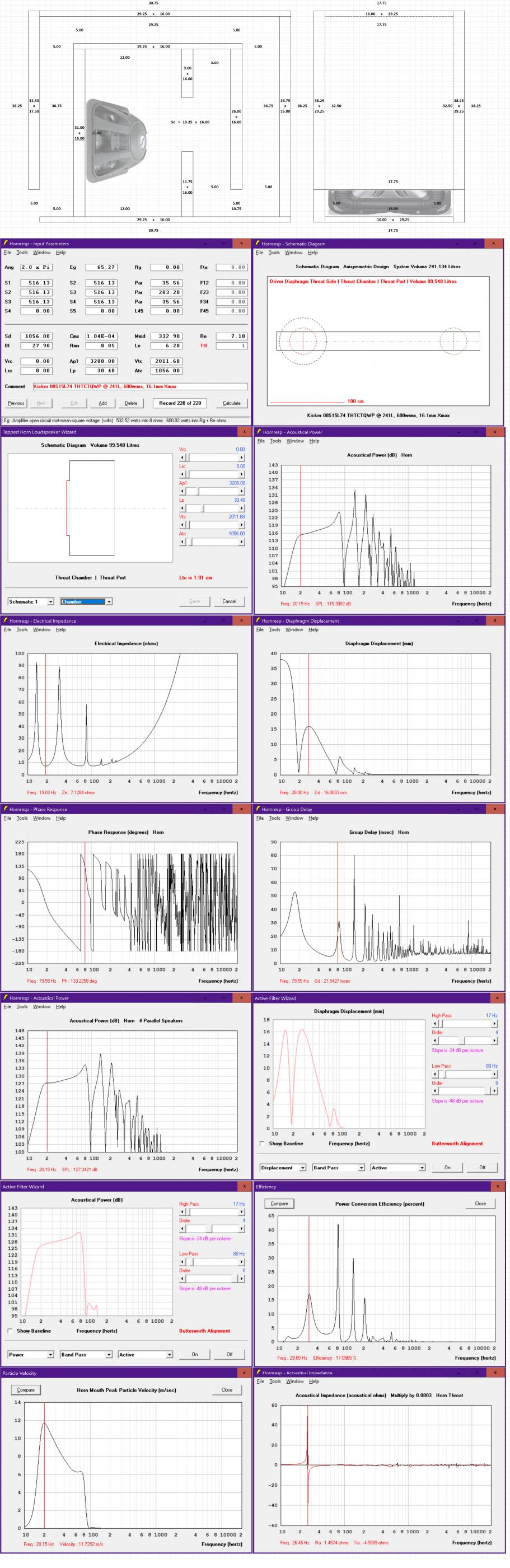

Third capture is another one, with smoother phase/response/GD, 720 liters

I’m not too scared of chuffing way upstream or in the high pressure end (within reason)but what I am after is the difference in delivery of sound or result in a real tapped pipe or horn shape that’s got a mouth entry tap far up into it but instead of sounding honky, nasally or awkward and not boomy, diluted etc either..
I guess there’s a name for it, or description but the taped motor side is giving a little more gitty up to the system and to the potentially droopy midband area result if a large area of mouth downstream can be a lot of things... but ‘snappy, and punchy’ is fair, not too far off? It gets downright violent with that driver in a paraflex.

This works, but I wanted a little more description of the expansion after the motorside tapped entty🙁 and of L12was to extend, it could simply be more length to the left and if polyfilled it has a long and thin version that really cleans up everything. I don’t know that it’s simmable that way or if swapping around some inputs, but this is tempting as it’s is .
