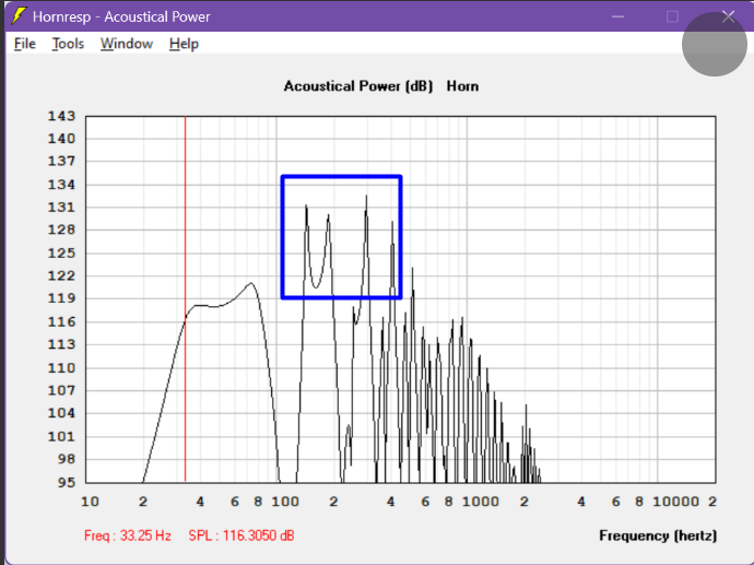

ROAR with Helmholtz front resonator
you will be stuck listening to this as motor/mechanical noises or spiders at xmax etc...... its weird!!
I think there’s more to it than that as well? Harmonic distortion from lower notes being played but exciting those other resonances?.? Things I don’t understand but can ‘hear’?
Are you hearing those resonances WITH a low pass filter?
If so, then what frequency are you using?
Remember, this a SUBwoofer (<80hz) not a bass bin (>50hz).
You will hear these noises (in multiple very strange ways) regardless of the input signal to the driver…. And the big open mouth( instead of a port) is night and day different if you compare similar tuned subwoofers at the same time.
Bassxreflex or tuned qw tubes sound entirely different and ‘filter’ out a lot of this noise it seems. It s very interesting, and I’m guessing why many people say horns honk or pipes ring or sealed boxes are the only good subwoofers?

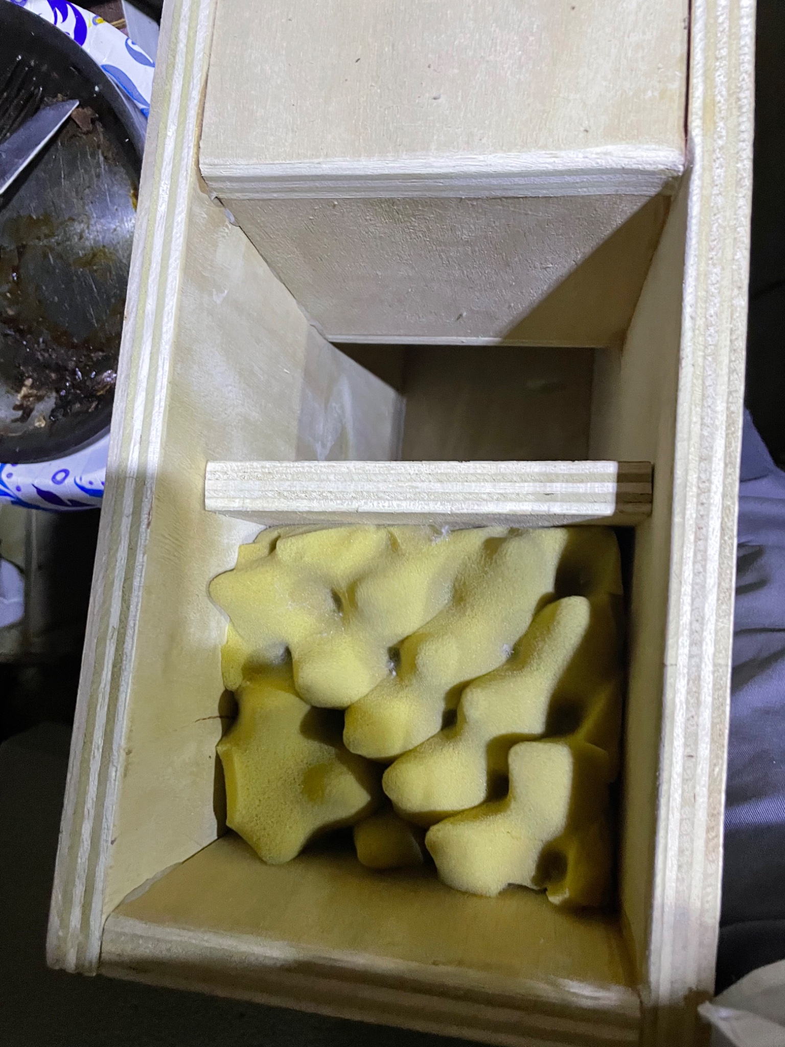

I lined mine with fleece blanket and sorta of clogged(damped) up the exit to find a decent compromise in what I was willing to tolerate
Maybe that type of stuff shows up in the various ways we can measure distortion and decay in REW? I measure and compare a bunch of my stuff this way, and have learned a ton of stuff beyond what my initial ignorant ears thought was happening, but my measurements aren’t calibrated to a certain voltage or out in a field on a ladder, etc so it’s not useful to anything other than comparing my my own junk and discovering what and where these weird sounds come from
Roar with Helmholtz resonator 😁

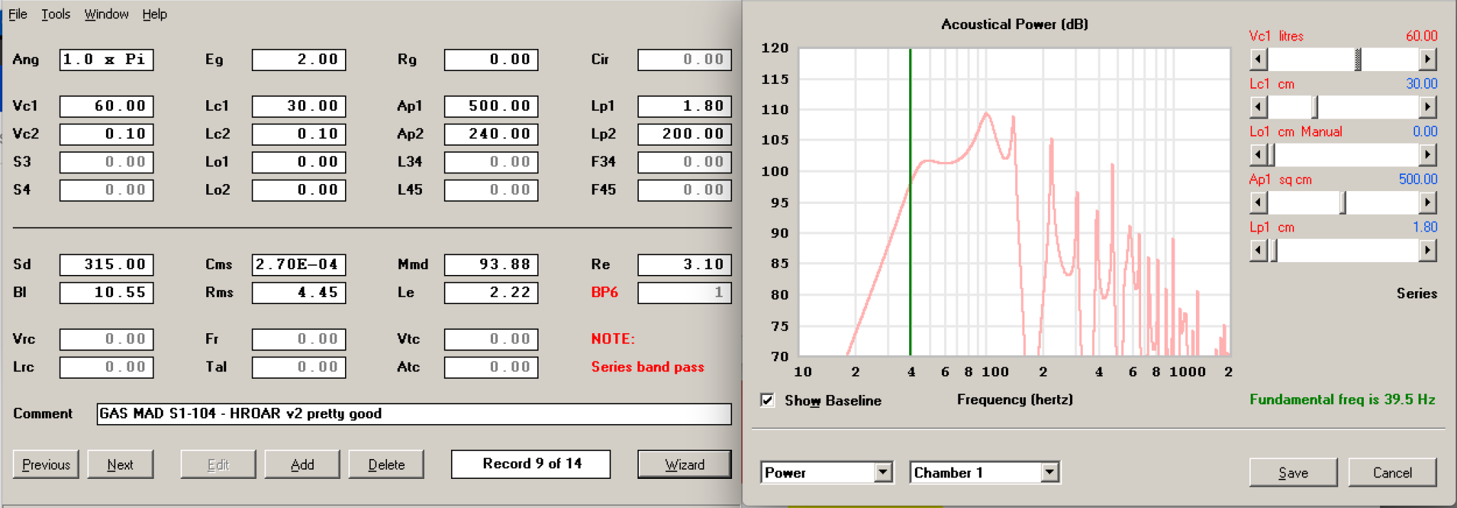

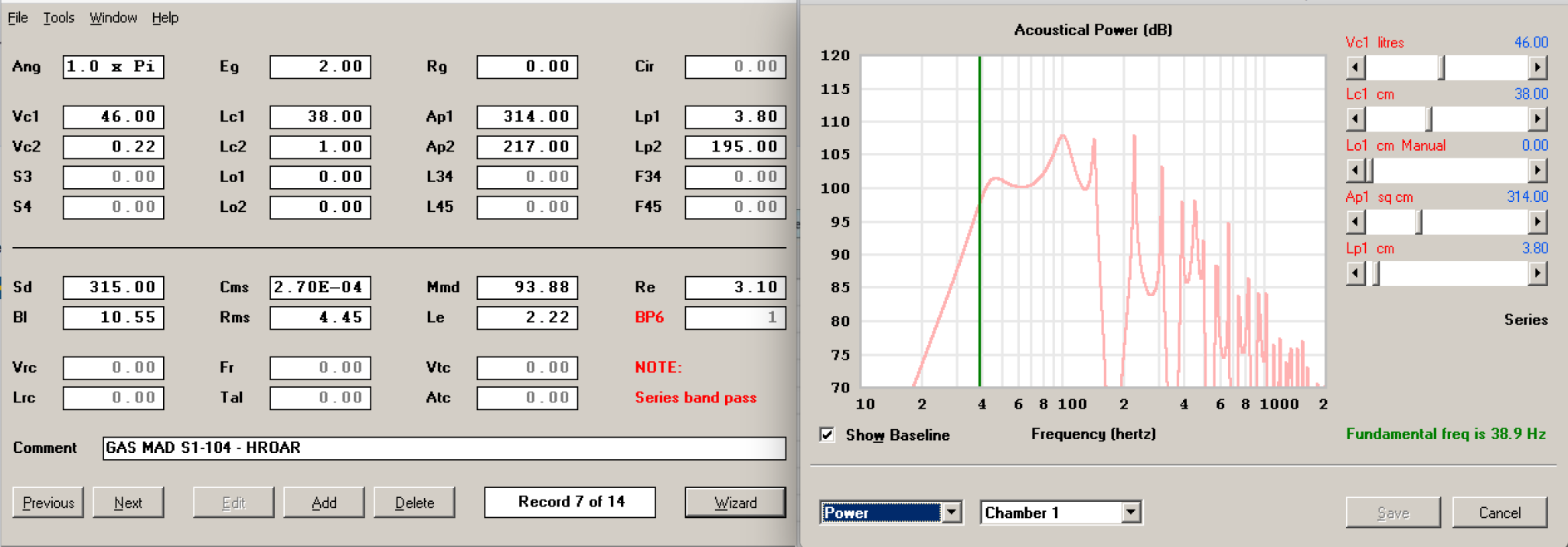

After reading this thread, I’ve become interested in building one myself to accompany a multiple entry horn I’m planning to build.
I tried a Hornresp simulation with the GAS MAD S1-104, 10", which is currently on sale in Sweden. The response is very similar to the driver in the first post. The driver’s SD isn’t specified, but I used 315, the same value as Circlomanen used in the first post.
I’ll probably adjust the dimensions so the enclosure has the same width as the MEHs. Here is a rough estimate for a 60x80x30 cm box.

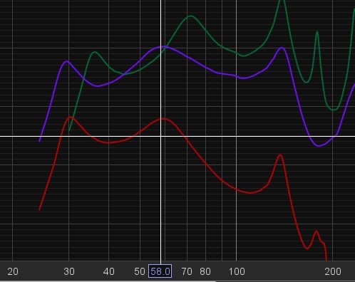

This Helmholtz exit thing is fun to play with . It’s like an adjustable sphincter for different fart sounds. I prefer the silent but deadly over the explosive high pitched 😝
This particular version (red) really attenuated the second resonance from the upstream TL . The level wasn’t set as high, sorry
Kinda cool how messing with the exit drags down the other tunings ?
