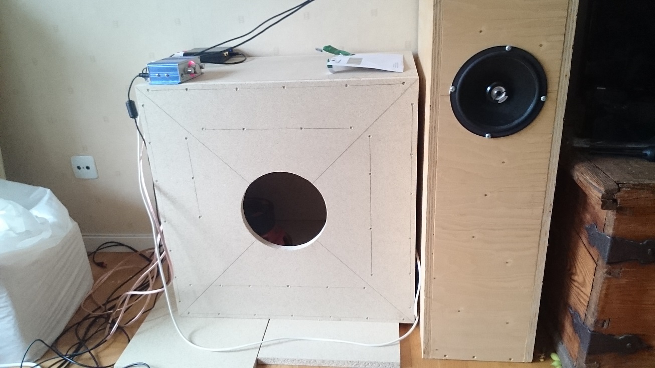

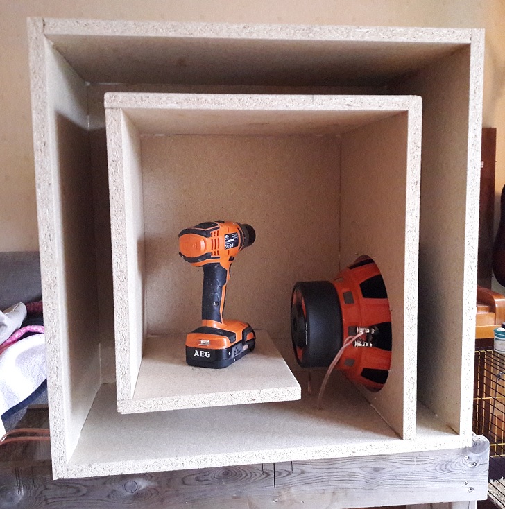

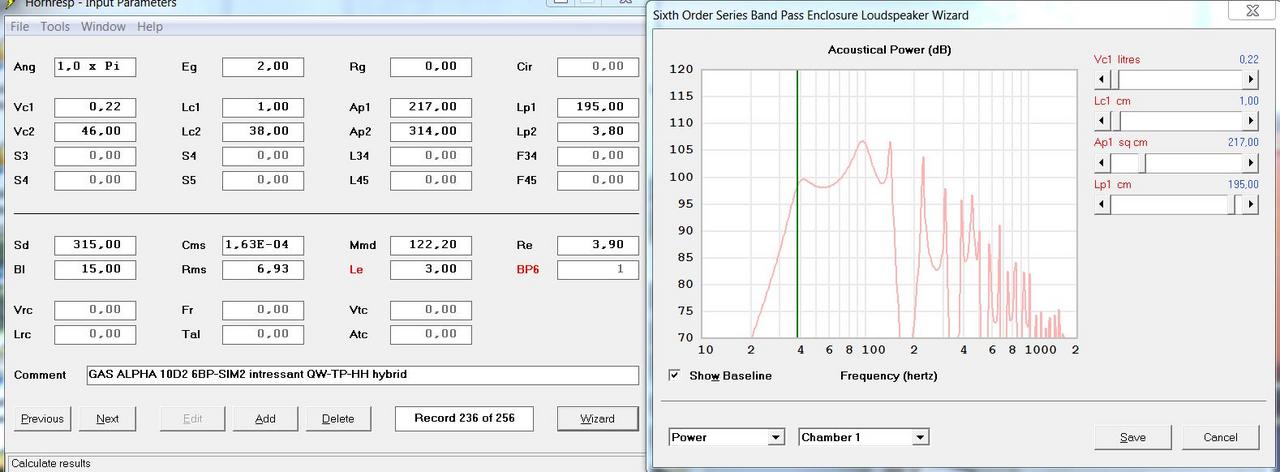

After reading this thread, I’ve become interested in building one myself to accompany a multiple entry horn I’m planning to build.
I tried a Hornresp simulation with the GAS MAD S1-104, 10", which is currently on sale in Sweden. The response is very similar to the driver in the first post. The driver’s SD isn’t specified, but I used 315, the same value as Circlomanen used in the first post.
I’ll probably adjust the dimensions so the enclosure has the same width as the MEHs. Here is a rough estimate for a 60x80x30 cm box.

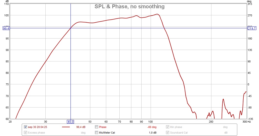

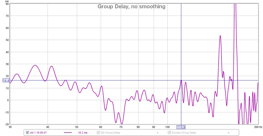

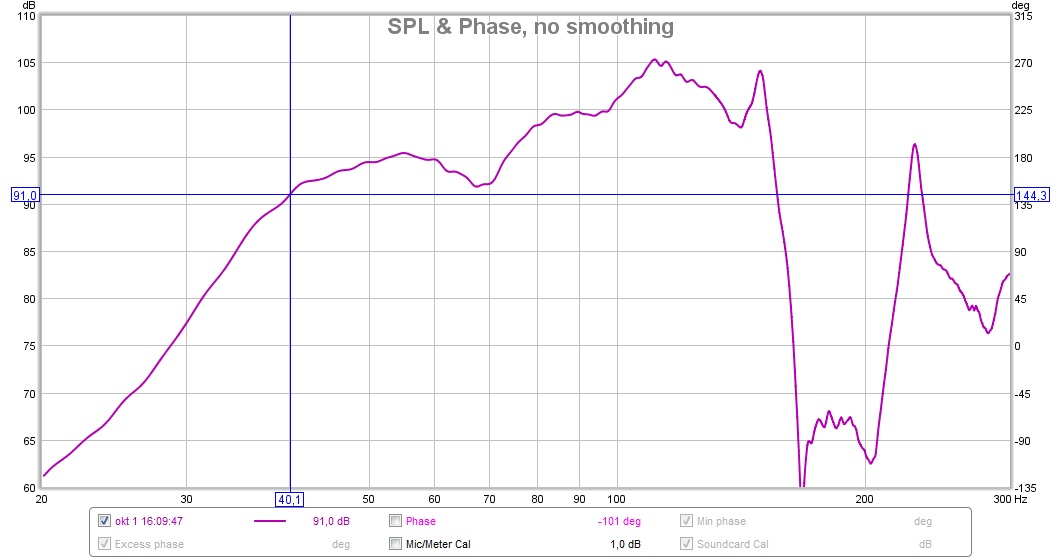

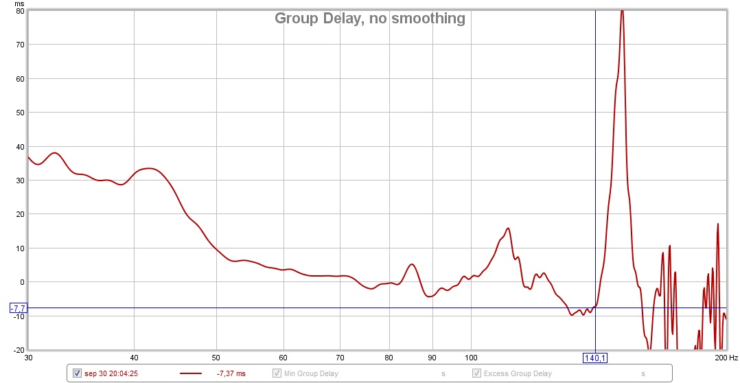

This Helmholtz exit thing is fun to play with . It’s like an adjustable sphincter for different fart sounds. I prefer the silent but deadly over the explosive high pitched 😝
This particular version (red) really attenuated the second resonance from the upstream TL . The level wasn’t set as high, sorry
Kinda cool how messing with the exit drags down the other tunings ?

I would not recomend this driver. It lacks Bl and xmax. I have heard a large 48x setup with those drivers and they did not impress me at all.with the GAS MAD S1-104, 10", which is currently on sale in Sweden
Thanks for the input. Do you have any driver recommendations for a similar build? What BL and Xmax values should I be looking for? The GAS MAD S1-104 has Xmax: 17 mm and Bl: 10.5I would not recomend this driver. It lacks Bl and xmax. I have heard a large 48x setup with those drivers and they did not impress me at all.
Anymore devlopments on these designs? I would love to build something like this but my understanding of hornresp is limited at best and these are complex. Seems difficult to get all compromises within reason. I modeled a dayton kraken yesterday in the 21" model you posted and the group delay was absolutely insane. Like over 100ms irrc. Still, i find merit in this.This is a Helmholtz version of the ROAR
