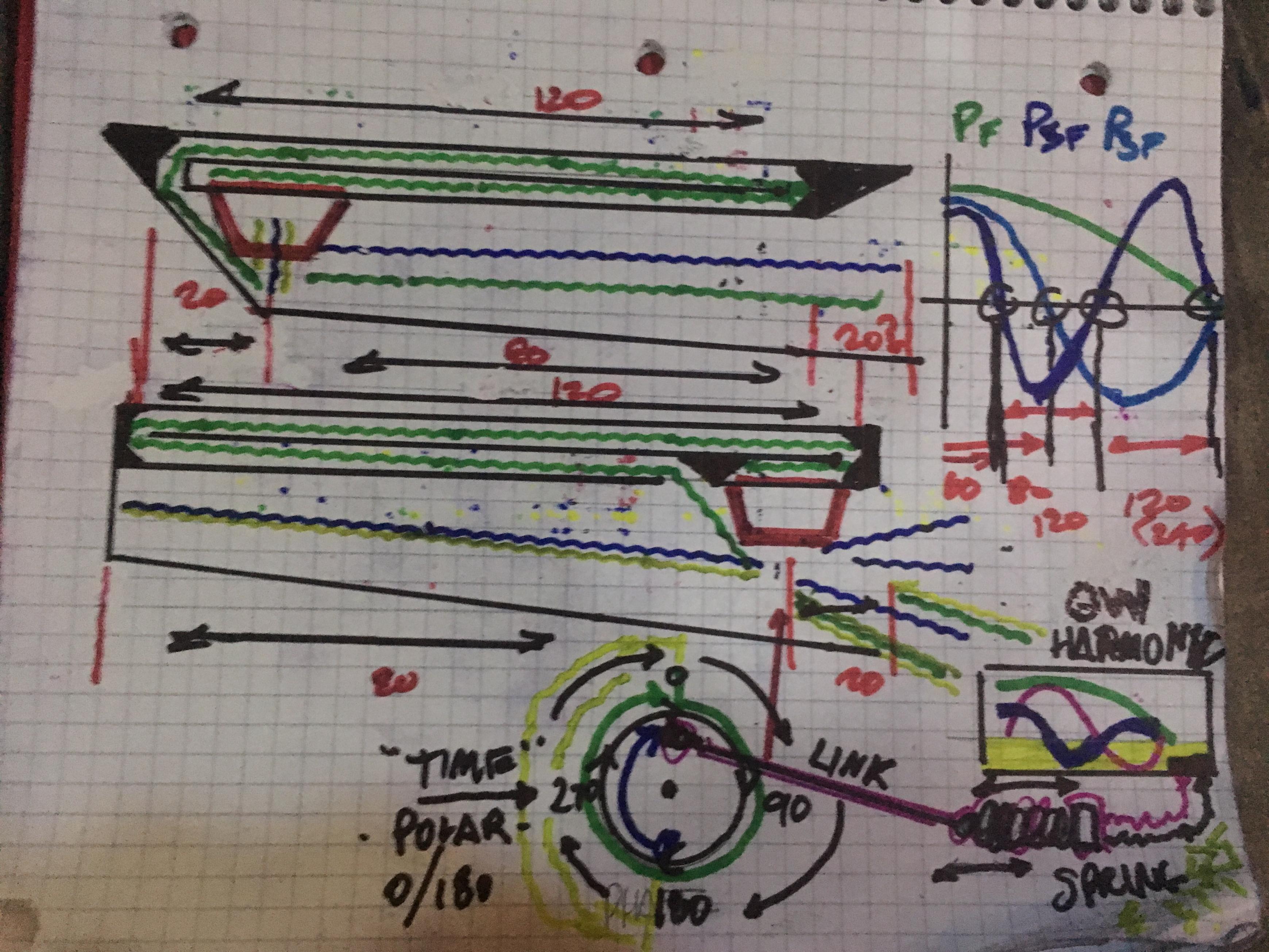

After making many complex higher order qw enclosures. It became increasingly difficult to pinpoint the exact reason why they all (while very different in detsals had a certain undeniable crack of a window to a slight sensation known as ‘punch’ by many folks.
after getting deep into many designs it became way too rabbit hole and i had half a dozen boxes stacked up in as many months and was nearly laying out Front loaded/ rear vented compound horns when it was obvious it had strayed into way too deep.
back up and a couple plain jane Qw TLs later. I decided paraflex was two closed pipes short and wide at 80 cm and long and skinny at 240cm.
That and a CSA split was a monster, but it was only the beginning. Because theres another pA’raflex. its chamber is offset. and lengthwise, not width. but at 90 degrees from the entry point( ????) what is it?
Its a sideways roar. The roar is the same but swapped that chamber to long and skinny inline, not offset and perpendicular. I didnt really notice driver position as much as chamber orientation. But i ended up with the top drawing and with a lot of help and questions that got me sent all over examples of higher order qw stuff like bose, olson, etc. i think i might see a trend??
Possible point being poorly drawn but its showing the two 5Fb and one 3Fb harmonic as Pressure wave nulls getting
Bonked by the lengths used here in CM? 80 /240 amd 120/240 and the interval of the offset position seems to be at (or technically just off) the point of removing those first two pressure ‘dumps’ by the lengths used in folds or to start/exit, or driver location.
Having used the same driver and multiple higher qw layouts with the same tuning objective and subsequently nearly the sane general CSA and legths span of distribution in at least 3 dozen simmed and 3 wooden. i think its time i get a second opinion, instead of ignorantly poking around guessing😀??
What(if anything ) do you see/hear/or notice in any of the roar or Hroar layouts or segmental lengths used? Is there higher order harmonics playing cooperatively, by chance? Or am i smoking the wrong stuff(again) 😱

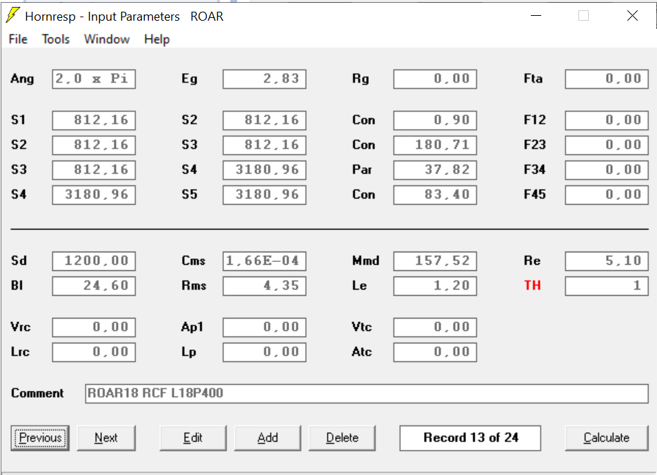

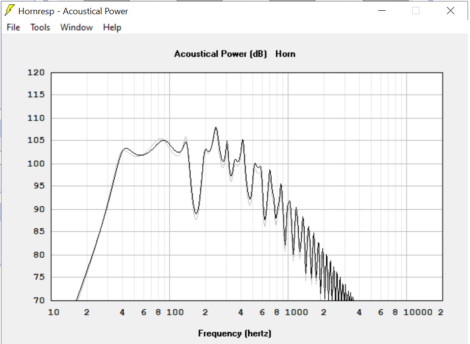

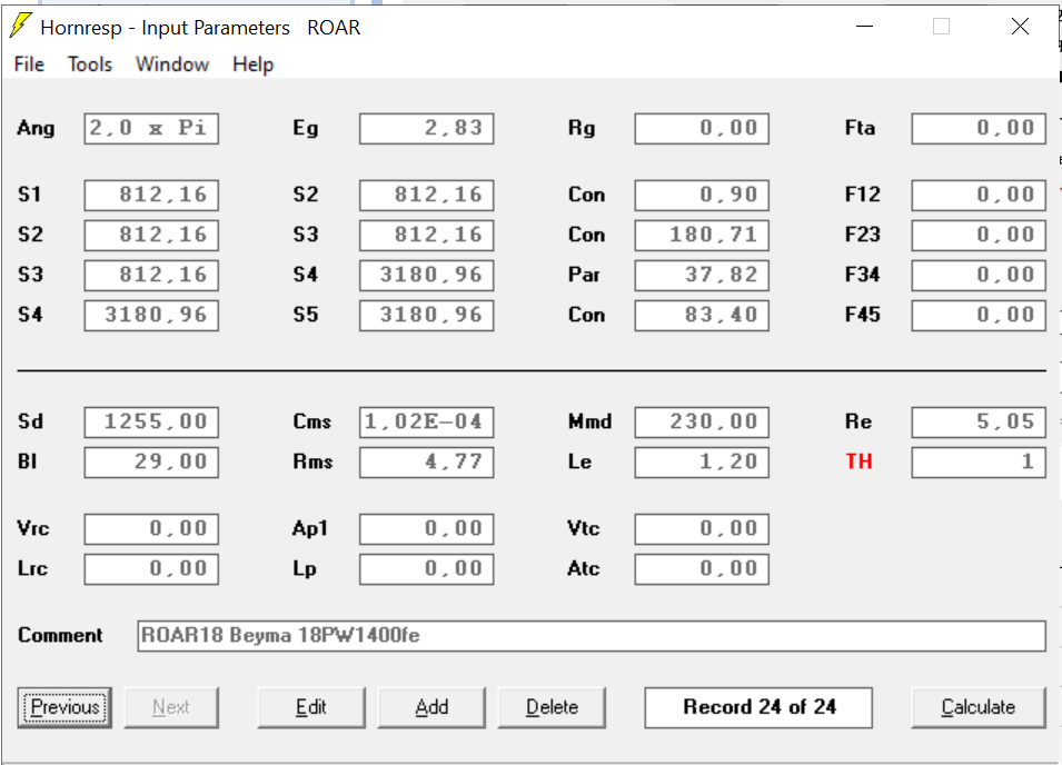

ROAR18 Hornresp RCF L18P400
I have simulated on hornresp. The result is no noticeable difference against the recommended driver Beyma 18PW1400fe. See attached file, Black = L18P400, Gray = 18PW1400fe.

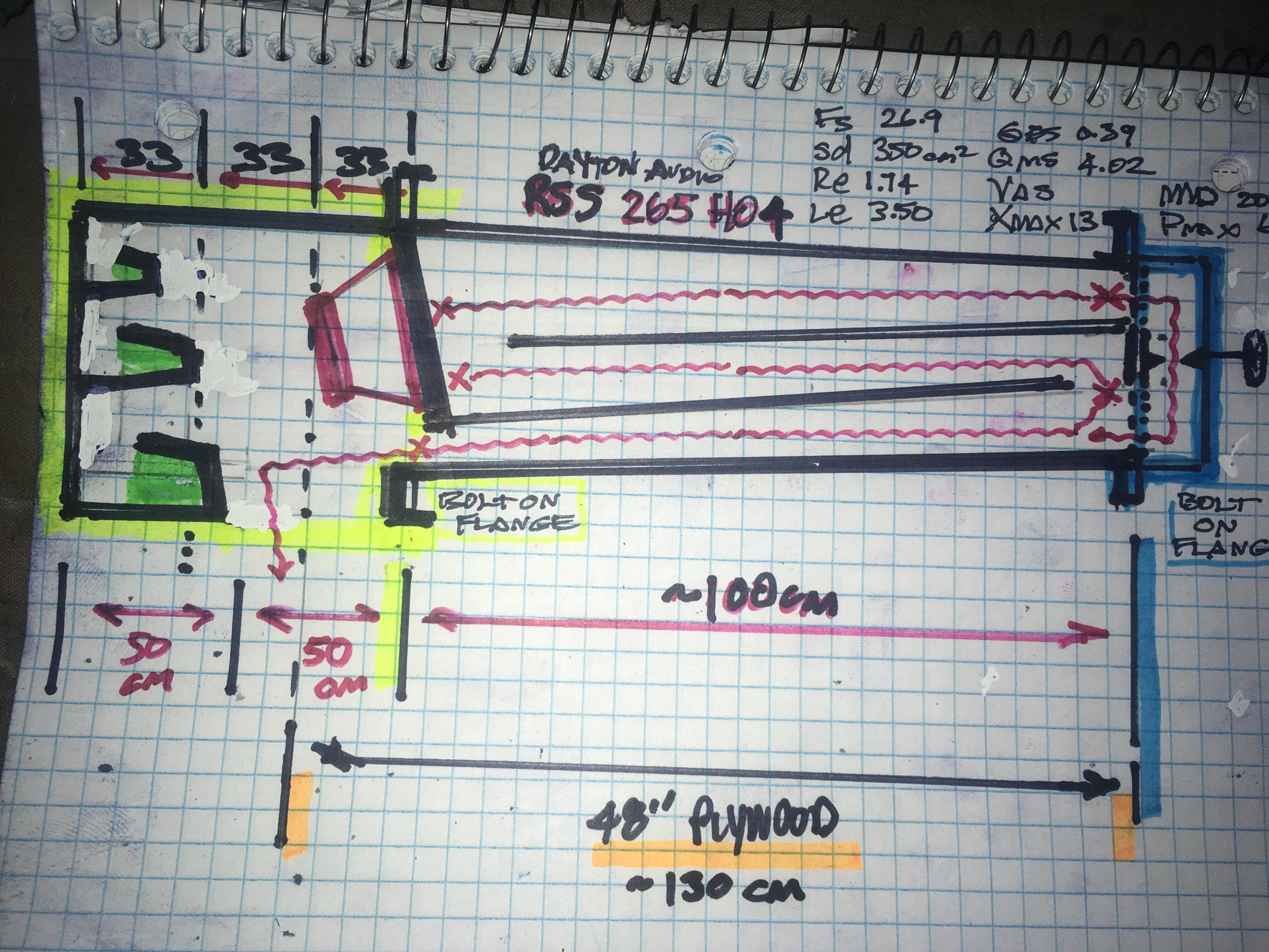

I dont know if i can blur that for us all, or if im just confusing. But its all in the name of high order qw pipes and how to approach them for a variety of needs? This is a 10” dayton audio rss265ho4 btw.
I decided to start with a simple 4th order ‘Offset driver TL’ this time and then get some baseline data to compare to the ‘bolt on’ flanges extras. previously ive been stuck trying to refer to a sim to explain ‘poorly’ what i was aiming at (and never knew what to reference or to help explain anything??) i hope this helps, instead of just contributing ‘confusion’, and not being helpful to paraflex, Roar, Hroar, altcon paraflex, big mouth tapped pipes and halfwave chambered phase gapping craziness...
Any ‘pointers’ or advice is 100% appreciated. 😀 this is a ‘mess’ but i wanted to show the offset position initially, because its significant in its length and of subsequent applications further on down the ‘pipe’ as we add higher orders(imho)?? ‘simple’ is best. But first i gotta find the chaos to avoid master🙂

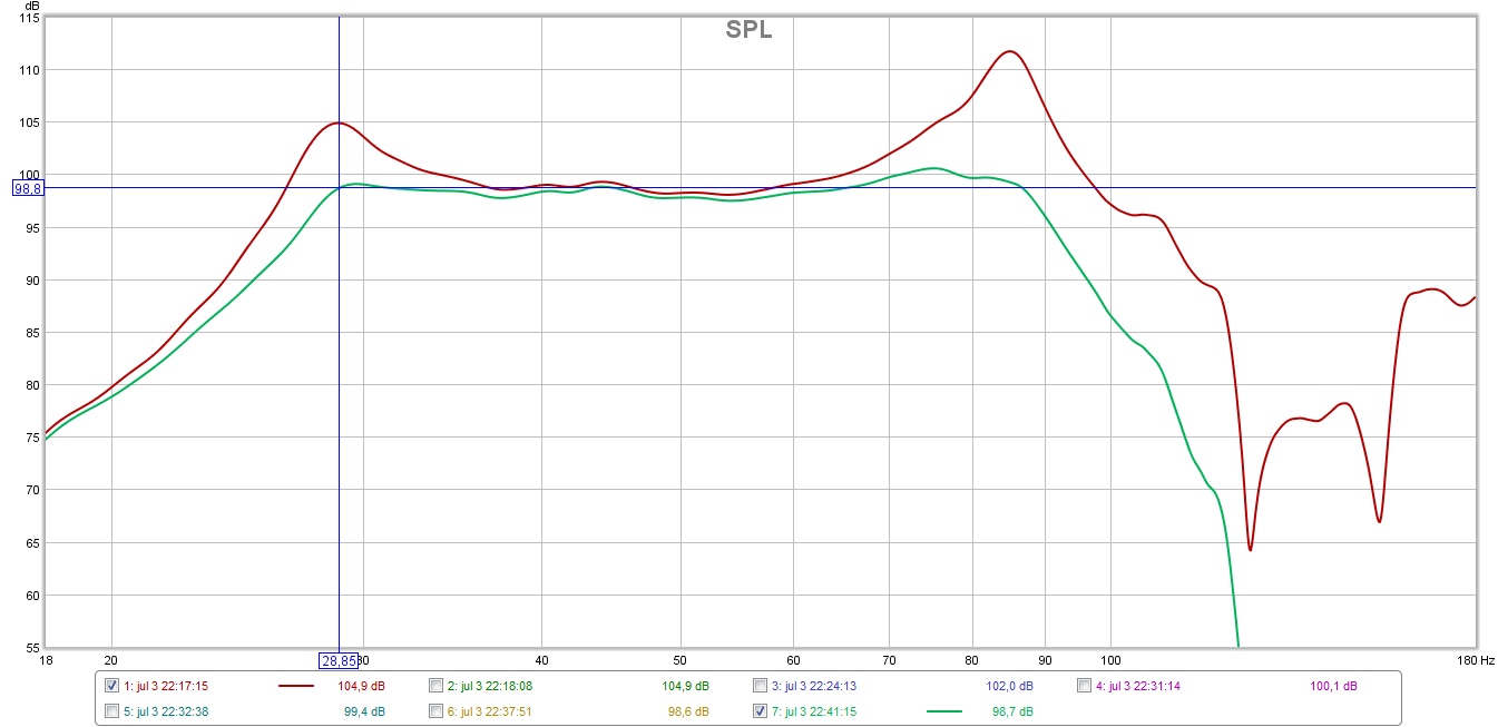

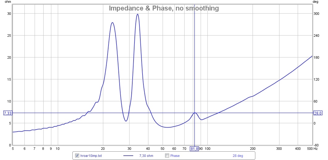

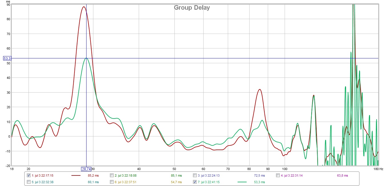

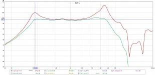

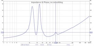

This wicked monster found its way into our living room again.
I did some measurements and some EQ plus crossover work to get it to behave reasonably well in our living room. I just want to share what can be achieved with a small amount of EQ and a 48 dB/octave crossover at 90 Hz.
Raw versus EQ plus Xover in both graphs.
Quite respectable objective performance coming from a dB-monster developed for car audio spl competition.
There is a long L34 section before the Helmholtz chamber to add a lot of acoustic positive feedback - which explains the ragged raw response. The driver will get an substantial virtual Bl-boost over part of the pass band.But the ragged raw response is just a indicator of a very strong motor system with a lot of power to drive the resonators in a quite heavy handed way. This translates into a very physical, tactile and vivid bass reproduction. It is felt throughout the load bearing structure in our house more then actually heard in our living room. It is totally useless for late night listening or HT use, but very fun once I am alone in our house. I watched the sci-fi movie Passenger yesterday and it adds an "live" realism to the sound track that is very addictive and enjoyable.

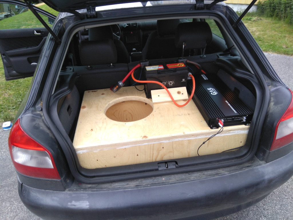

it's possible to have the plans?
Post 53 in this thread contains the only "plans" that was ever made of this design. It is a one off build for a specific car. I believe there is a Hornresp data picture somewhere below post 53.
But the driver is out of stock and was previously only available in Sweden. It was a rather odd driver with lots of Bl and quite low Qts.
