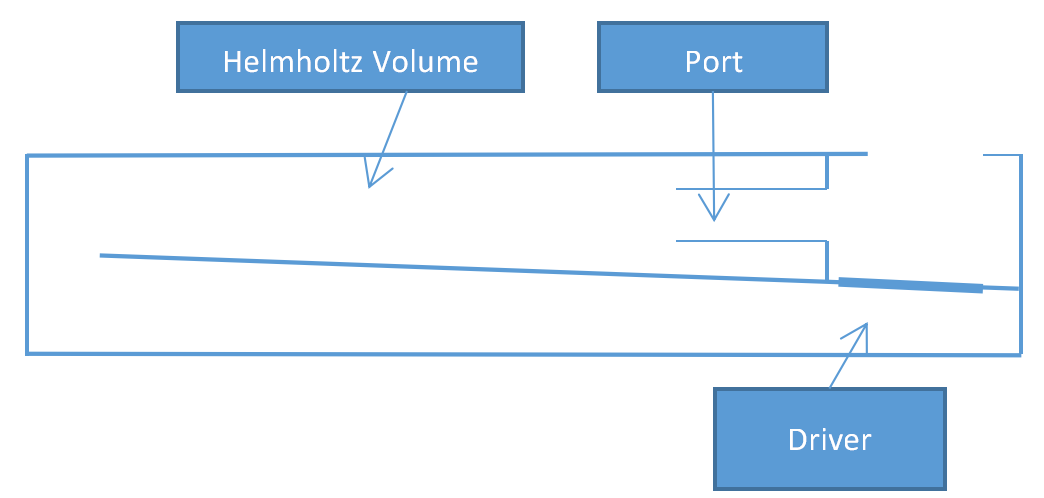

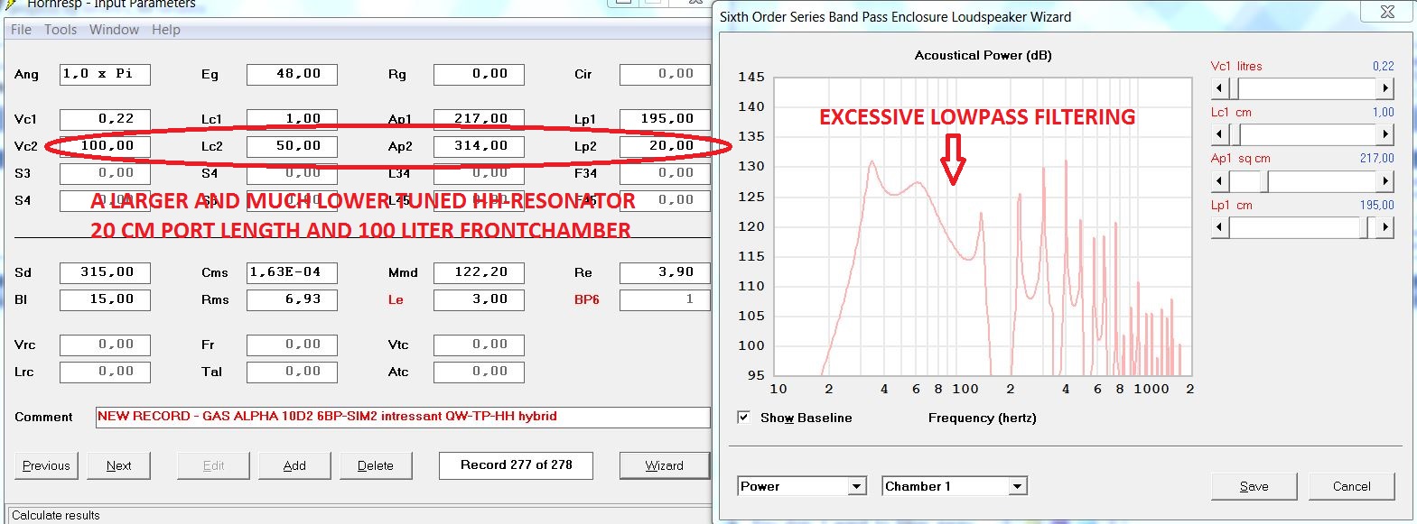

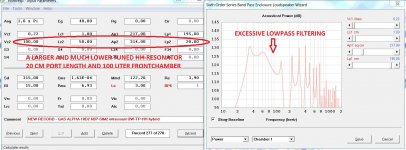

I know you already said that the overlaid graphs are only for understanding, but it looks like you tried to tune the Helmholtz so that the dip on the upper side could be filled, is it?
Also, do you think the Helmholtz could be tuned on the lower side of the pass band instead of the higher side?
No. The Helmholtz resonator is a low pass filter. You don´t want to filter away most of the passband.
See the simulation above. I substantially lowered the resonant frequency (low pass cut of frequency) of the front chamber + port in the second simulation.
Actually, A Hehlmholtz Resonator acts like a Bandpass.
Volume of the resonator, length of port and area of port are used to tune resonant frequency and Q of the Hehlmholtz.
In a simple Bandpass Cabinet (two adjanced volumes, driver in between, one volume closed, one with a port), the portet chamber is a Hehlmholz Resonator.
I assume you already knew 🙂
With a large and short port it will pass anything below its bandpass resonant peak - inclusive pure DC (steady airflow) without any problem. But you are right, the resonant part of the Helmholtz resonator is a bandpass function. Thanks for pointing this out.
It makes it easier to explain when viewed as a lowpass function in this design, since the port is extremely acoustically permeable below its passband.

What do you think of adding a low pass filter the following way, its an attempt to low pass only the throat side of the driver.
The idea is that a normal TH is limited in bandwidth because the upper freq range is dominated by constructive/destructive interference similar to comb filtering. So, if the TH can be modified such that the throat side is low passed then interference can be avoided. The rear of the driver (mouth side) can go higher in frequency without being interfered by the throat side which is low passed now. The throat side is like a high tuned MLTL.

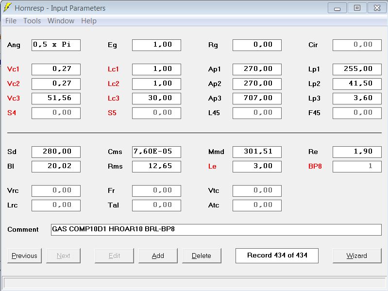

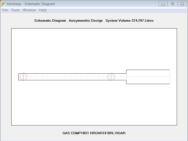

You'd emailed me about how to sim this.
It's fairly straightforward, you just sim it as a tapped horn.
You have to use the newer version of Hornresp which allows for segments that don't match the previous segment. That's been around for about six months iirc.
In all other regards, it's simply a mass loaded tapped horn.

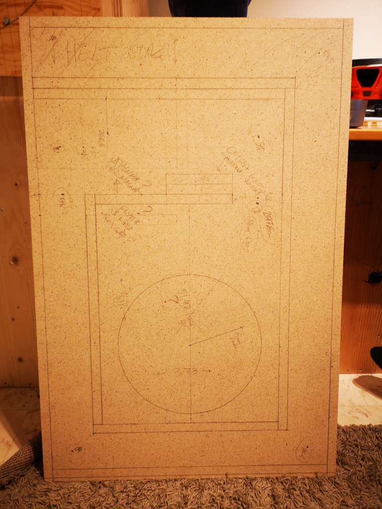

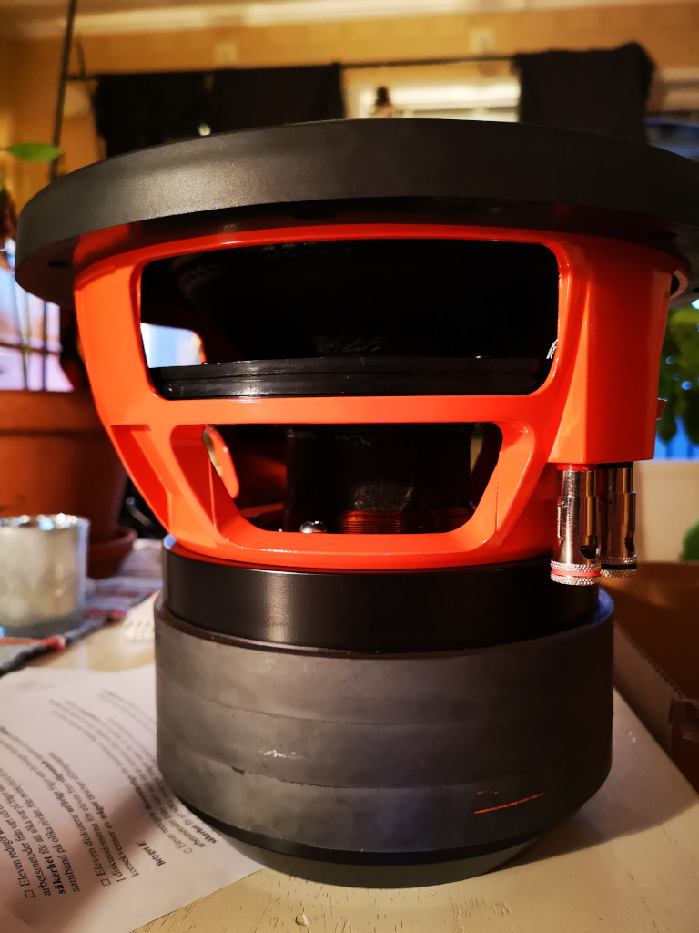

My oldest son has promised to help a friend with some nice punchy bass for his car.

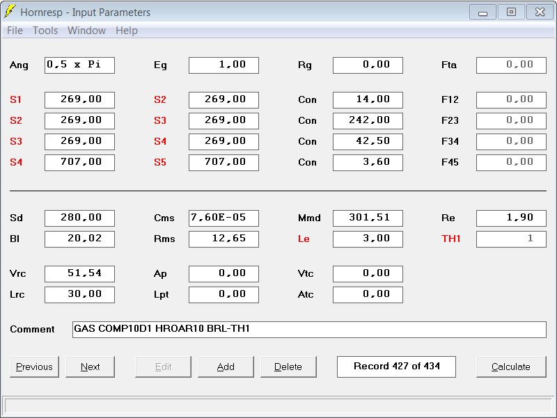

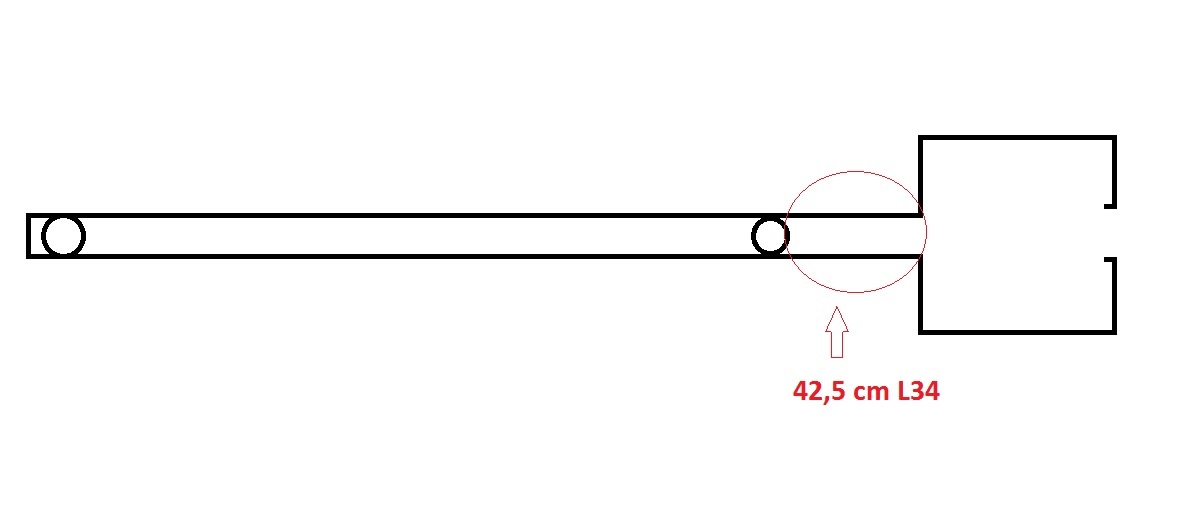

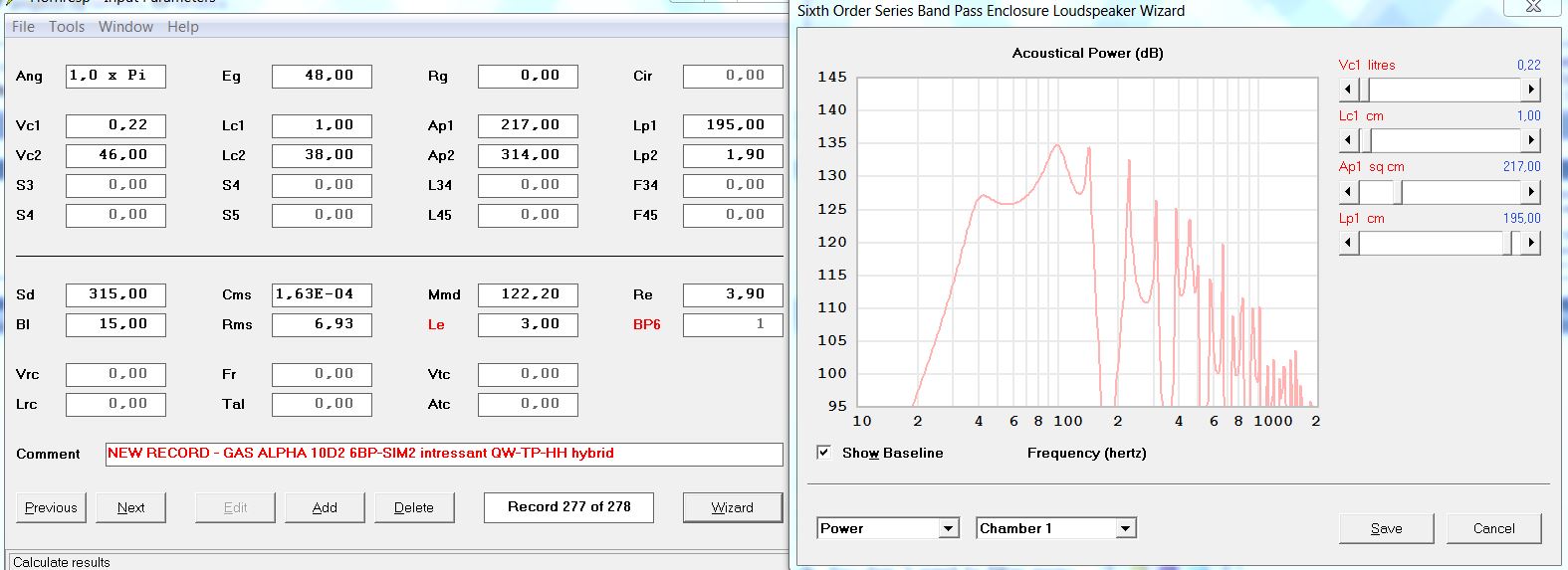

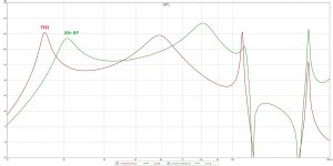

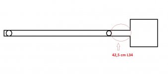

Yesterday we got the driver and I started to design the layout of the Helmholtz-frontresonator ROAR.

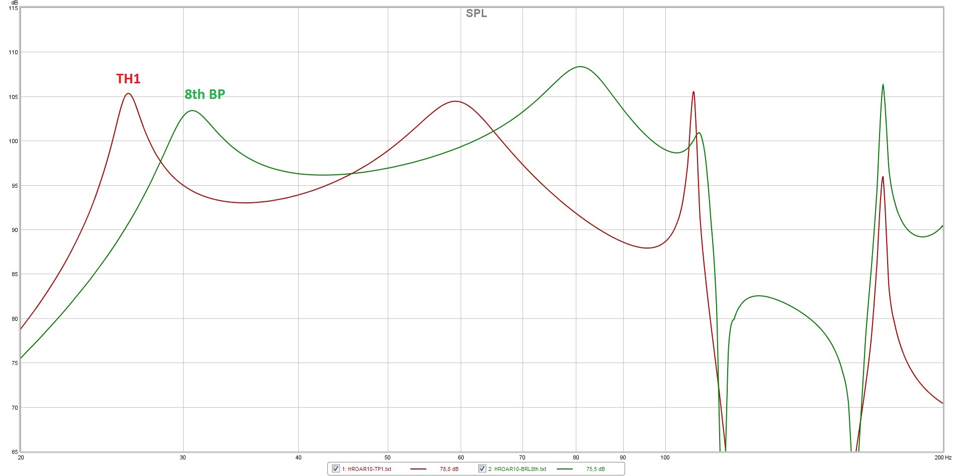

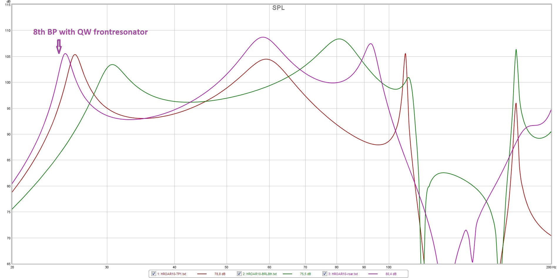

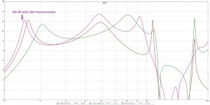

I will post some Hornresp sims later. I am trying out Clear Linux on my main workstation and I have not yet managed to get Hornresp working in Wine. The simulation does look awful with huge peaks and dips, but this driver needs some large cross section area in the pipe to help keep velocity down. The cabingain and some DSP will help keep the power response reasonably smooth.
The large circle is where the port will be. The cone of the driver will face where I have written "HELT STAG".

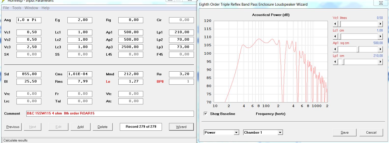

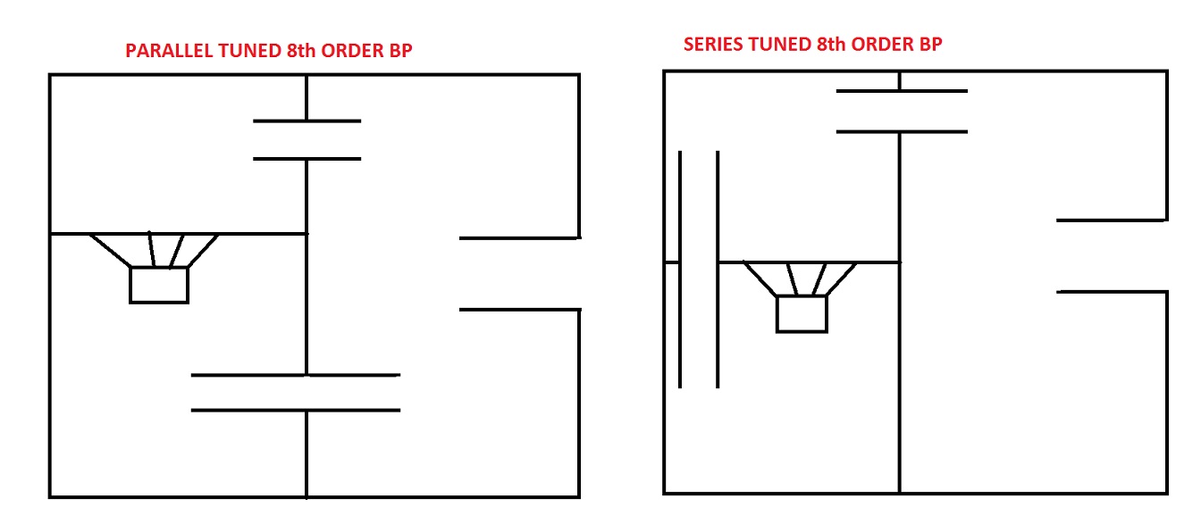

Since Hornresp can not simulate series tuned 8th order BP (yet?!) I have to work my way around this. I don´t even have reliable data on the driver and the car cabin will wreck havoc on the spl response anyway, this simulation is more of a indication of hitting the intended frequency range.
The TH1 simulation has the Helmholtz resonator chamber at the wrong place and the 8th parallel tuned BP has the 42 cm pipe section at the wrong place (and lack the tapped pipe positive feedback loop).
I guess the measured result will be somewhere between the green and red line with the uncertain TS-parameters, the cabin gain and the bass boost setting on the amp superimposed on top of it all.

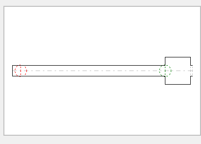

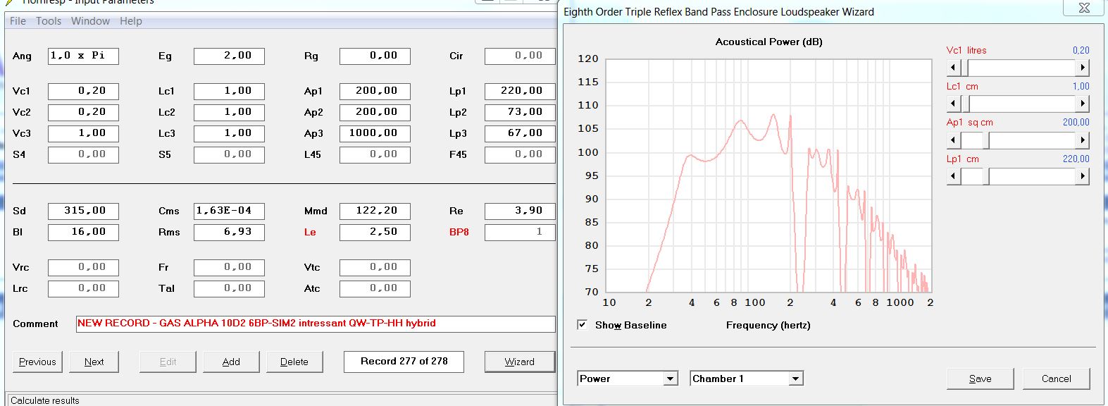

Can you draw us a hornresp like shematic of what your trying to achieve ???
Isn't it this ?
Isn't it this ?

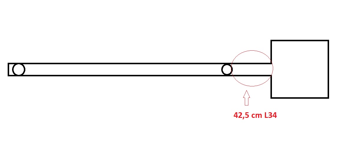

Here is the same comparison with a quarter wave front resonator added. With a QW front resonator it is possible to simulate a series tuned 8th order bandpass (a tapped pipe with a long L34 pipe section connecting to the front resonator).
The Helmholtz front resonator has a slightly shorter passband, but should behave quite similarly.
