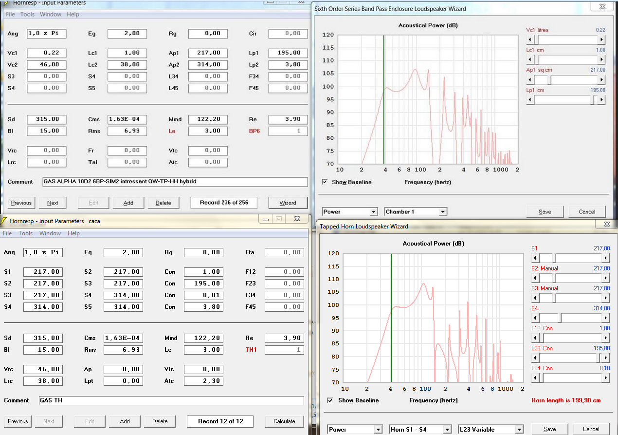

I am working on several variations of this design, and a 4 woofer version should be quite fun and capable.
With the BP6 simulation tool in Hornresp. You can see the way I simulate in post #3 above.

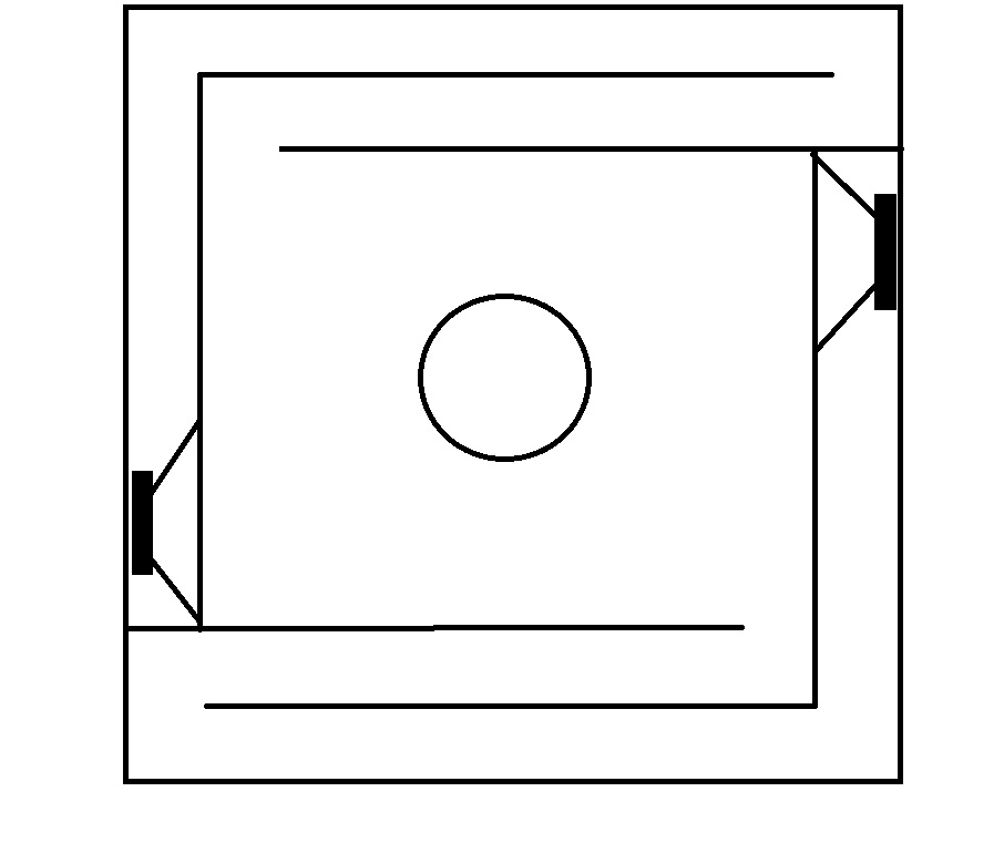

My apologies for not posing a clear question. I guess what I meant is "How would you model this design with 2 or 4 subwoofers and how would these simulations in Hornresp translate to an actual drawing of that design (with the 2, 4, or even 8 drivers)?" I am interested in this design and I have 2 JBL CS1214 that I am working with in Hornresp to create your design with 2 drivers. I will wait excitedly for your multi-driver models and simulations 😀
This is one reasonable simple layout of a two driver version. Much more complex then the single driver version, but it gets a more symmetrical loading of the front chamber instead, which should be a good thing. Since there is only straight non expanding sections, it should be a very simple and fast build despite the increased number of parts.
No Hornresp sim of this layout at the moment. It is a work in progress and I am not done evaluating the first single driver version yet.

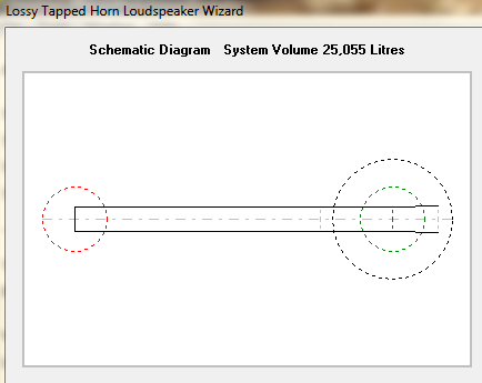

with the TH function, I can't see how you would calculate s3-s4 and s4-s5
I use the 6th order BP tool in Hornresp. See my simulation in the first few posts in this thread.

Adding a chamber to the TH
Playing like this i got more less same results as with 6th order wizard, but tweaking a final segment added from TH1 config can help taming high range of the bandpass.
NICE. Exactly what I imagined (and that's not typical) 😉 I think you're onto something here. Very curious if F3 is lowered a bit with 2 drivers.

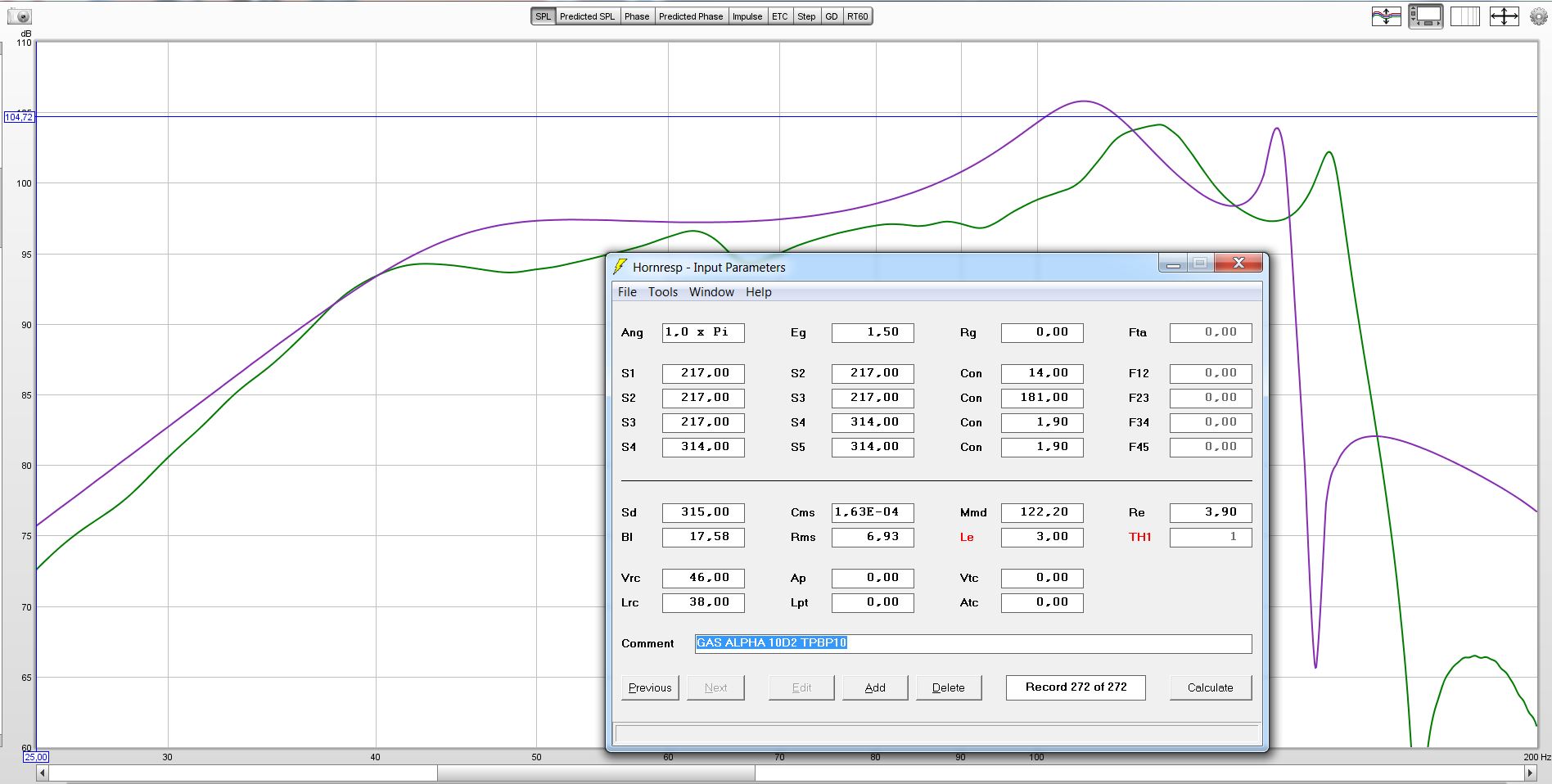

Thanks papasteack for the idea to simulate the TPBP10 as TH1 in Hornresp!
It makes it much easier to compare with actual measurements in REW.
This is how it compares with in mouth measurement indoors.
Nice car audio curve!

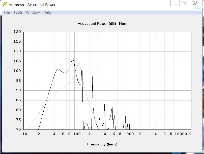

How is the port tuned? It looks like a big hole with no port length. It would be nice if one can explain how it works at two frequencies
a) At a frequency away from the Helmholtz's tuning frequency and
b) At the tuning frequency.

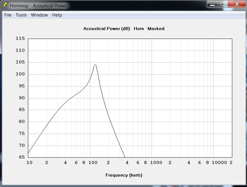

This is only the Helmholtz frontchamber simulated in Hornresp.
The Helmholtz frontchamber will act as high Q low pass filter, passing everything below its tuning frequency but adding its own resonant "gain" around the tuning frequency (upper part of the passband). The lower tuning frequency is from the tapped pipe that encircles and ends in the Helmholtz resonant chamber.
This simplified Hornresp simulation is not correct since the tapped pipe and the Helmholtz front chamber couples tightly to each other - which is not shown here.
Both curved overlaid. This is not really the correct way to simulate since the tapped pipe and the Helmholtz frontchamber couple to and effect each other.
