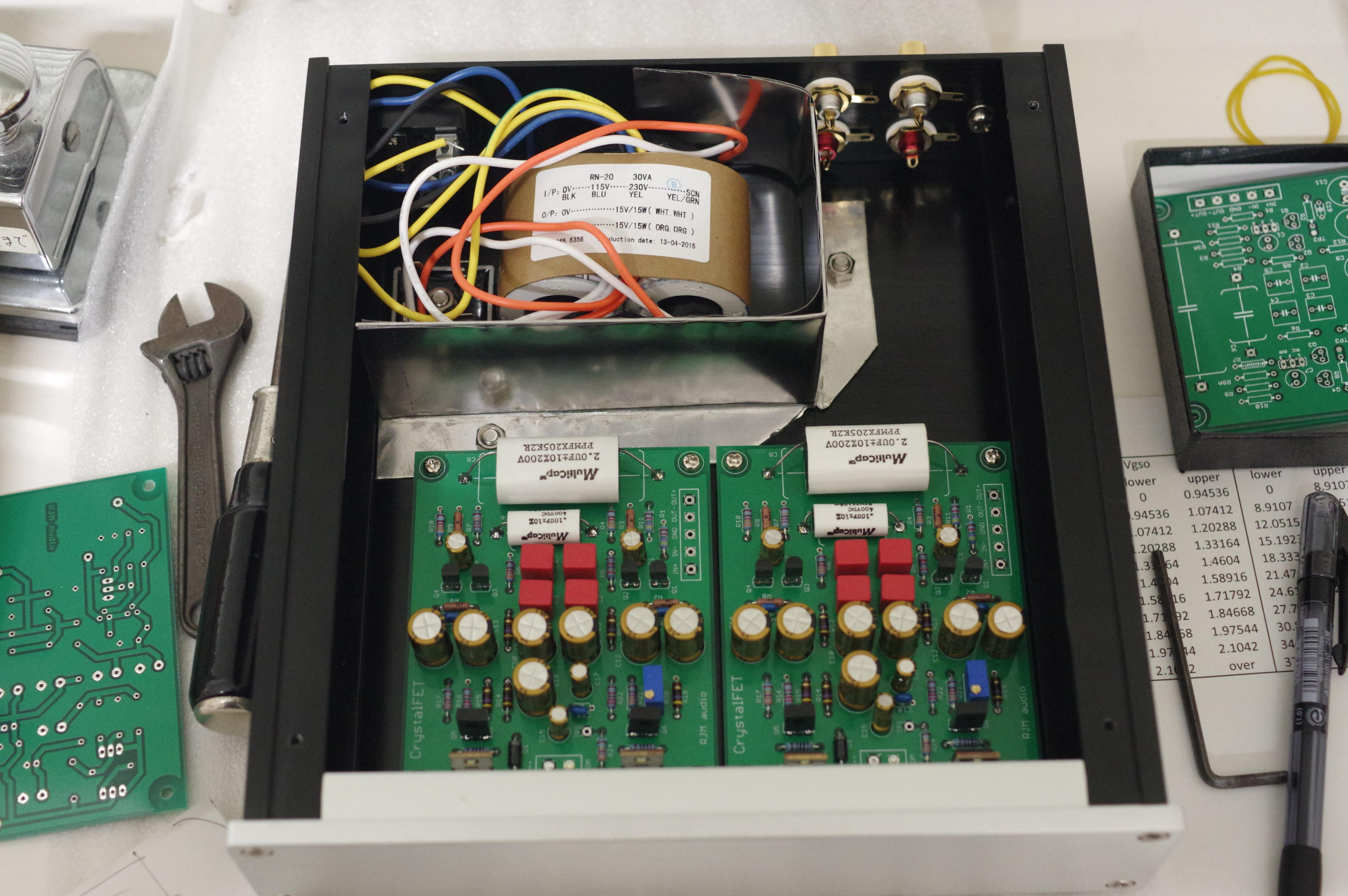

Speaking of which, here's another one of mine. This is 1.2a which I'm making for my Dad. He's got a DL-103 so it will be fixed gain, fixed load.
I needed it to have a convenient, small single chassis, which meant things got more crowded in there than I would like. There is a mu metal partition there enclosing the power supply. Hopefully that will be enough.
R-core is from ebay, China sourced. It has an electrostatic screen and the quality is quite reasonable.

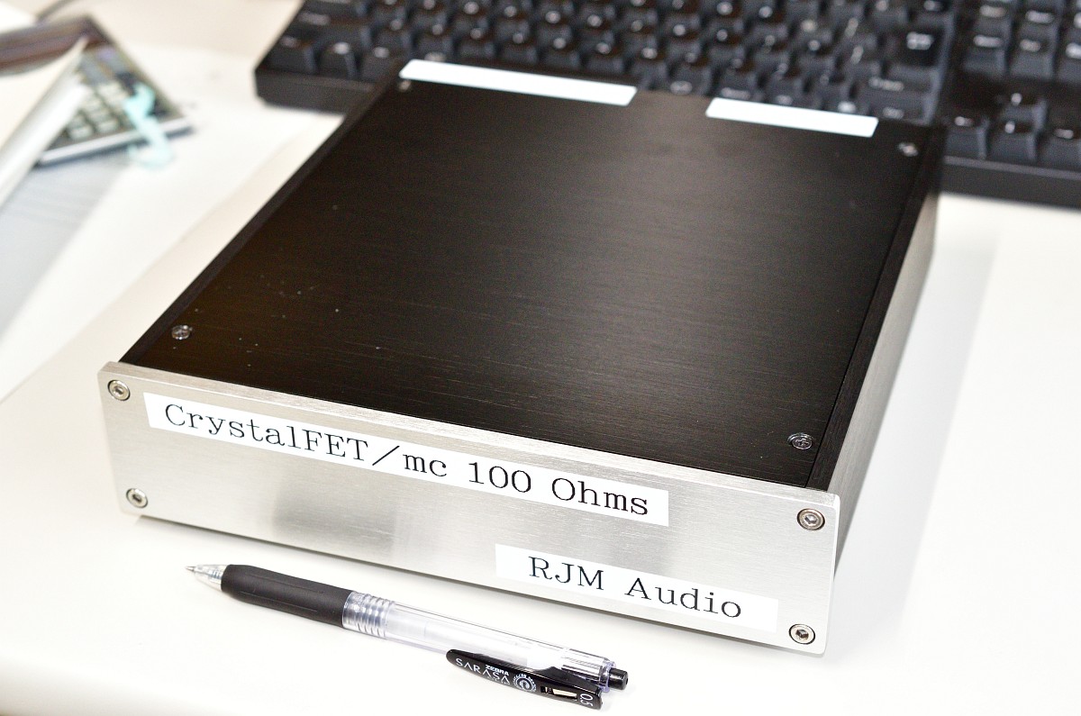

I finished my second. Pics for your reference.
I recommend a case that's 50% wider or deeper. Give yourself plenty of room to put the power supply well away from the boards. This one was way too cramped but it's what I had.

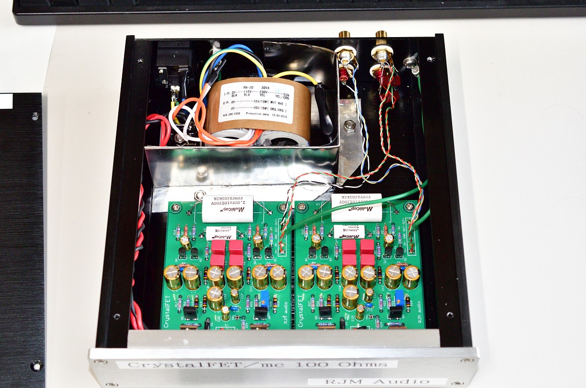

Managed to get some time to put this 1.2a into a box. Remote supply 2x15 secondaries, set to 35v on tp 1. Built with BOM parts, very clean😀.
I'm using a custom NWA cartridge output 0.1 mv so gain is a bit low. Suffering a problem with mains hum at present, maybe down to the small box.....I'll get to that later. It certainly holds some promise, thanks Richard.

Hi Greg, thanks for the report.
The cartridge output is a fair bit below what I was testing it with, but still the measured noise floor shows no harmonics above ~-100 dB so even with your cartridge the hum should be very very low.
You seem to have a couple of strange things going on.
First is the signal wires have what looks like a twisted pair both connected to IN+ and OUT+, and a separate (black) wire for the returns IN- OUT-. Actually you want IN+ and IN- connected as a tightly twisted pair, and OUT+ and OUT- also. Having a big loop of IN+ and IN- like that is going to cause a lot of noise pickup, especially as IN+ from the board runs over the power supply section of the other board.
Second, there seems to be a flying ground bus connecting GND on both boards to the ground lug on the chassis. This is fine, but there is also a rod running back to the third pin of the power connector. Actually, the CrystalFET chassis/GND does not connect to the power supply. There are only two connections, V++ and COM. I'd disconnect the flying bus from the power supply, just snip out that section with a pair of pliers.

One other thought: what are your measured DC voltages V++ and TP1?
(TP1 should be about 33-34 V, but how about V++?)

Hi Richard,
V++ 44v dc rectified from 2 x15v secondaries
TP1 34v dc
I'll find a larger case and spread things out more and get the signal away from the power on the board..

It looks good now, so far as I can tell from eye-balling it from here.
Did those changes not help at all? The power supply is already external. While there is some concern about the input signal wires being close to the regulation part of the boards, I wouldn't expect a large pickup, and I would expect it to be significantly improved by fixing the twisted pair as you have done.
I'm not convinced the problem is the crowding in the case, in other words.
1. You have no load resistor on the RCA input jacks, so I assume you have replaced R1 with the value appropriate for your cartridge.
2. Is the hum 60 Hz or 120 Hz? Worse or better when the phono leads are unplugged from the input? Worse or better when the TT ground is disconnected from the ground lug? How about with just one channel powered up?
3. Is there anything that seems to influence the magnitude of the hum?

1) load is 100 ohm
2) No difference for phono leads in or out or TT ground.
3) pre-amp volume settings
On the up side the reproduction on very low volume levels is really very good 😀

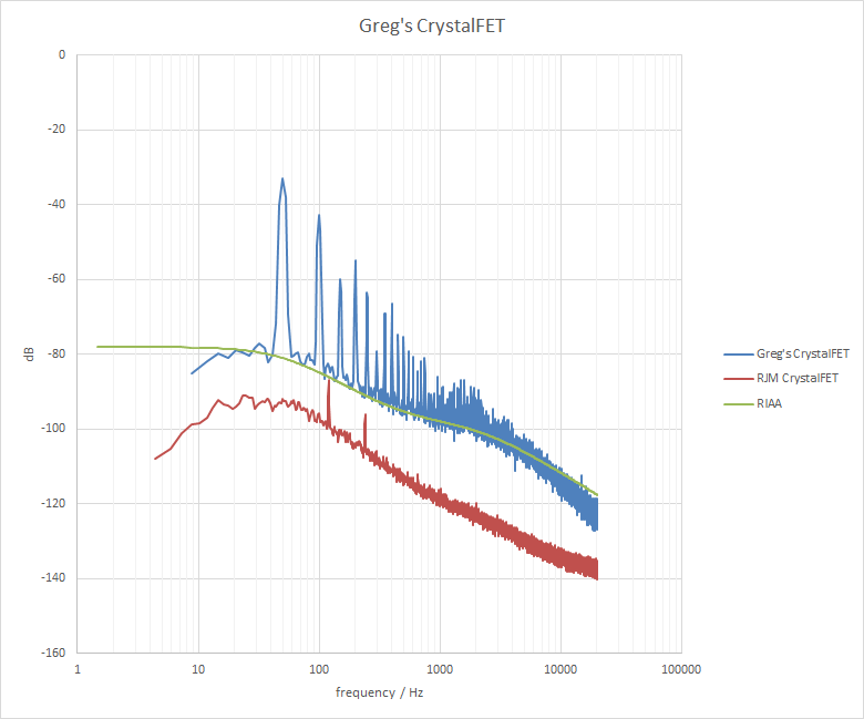

100uf in the power supply has reduced the noise. Putting the 'scope on the board input showed significant noise, cleaning that up should improve matters. I'll do a bit more on the supply.
From what you have told me I can infer three possible causes,
1. Systemic noise coupling of the power supply ripple into the signal at the board level. (unlikely since mine test fine)
2. Incorrect configuration of the voltage regulator and filtering elements.
(possible but unlikely since you can adjust to the correct output voltage without any problem, indicating that's its basically working. I assume here you have built it according to the BOM without modification)
3. Regulator running out of spec. (my gut feeling says this is the problem)
The CrystalFET uses a shunt regulator. It works by using CCS Q7 to send a fixed current to the phono stage and shunt element (Q8), and adjusting the current through the shunt element to keep the V+ voltage constant. The shunt current + the circuit current = the total current provided by Q7. If the circuit current draw is equal or greater to the total, there is no current left over to shunt and the regulator stops working.
The total current supply is controlled by R17. You can check the shunt current by measuring the voltage across R24 (I = V/R). If the shunt current is less than 5 mA you should decrease R17 until it's about 10 mA.
I can check for you against my simulation if you can provide me with a few key circuit values. Sometimes it might just be a simple matter of adjusting R20 to lower V+ a shade which lowers the circuit current and brings the system back into working shunt range. Last resort decreasing R17 will certainly kick it up into the working range.
PS. Since the noise is independent of the input connection, you could bring the phono stage over to a computer and record the output signal. An FFT of this data (using Audacity or Rightmark) would give us a quantitative look at the situation.

Hi Richard, I have checked the boards, there are no errors I can see regarding construction. The parts values are as supplied in the BOM you mailed me with the boards, (caps and resistors measured prior to fitting, I measured 200 J113 to get close tolerance parts) all parts from Farnell so should be no fakes, although the manufacturers may be different.
The shunt current across r24 is 8mA.
What other measurements do you need for further analysis?
I'll get the audacity plot sorted when I can (input will be through M-Audio delta 192 ), what length of sample would give you enough data ?

Thanks Greg! 8 mA indicates the shunt is all working like it's supposed to, so I'll wait until the FFT to comment further.
Sample length only needs to be a fraction of a second, a couple of seconds of data is more than enough.

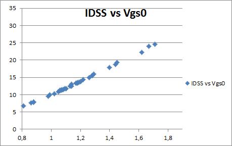

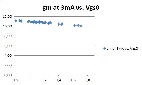

FET Matching
Hello
I started matching the J113 Fets I had at hand (Fairchild from Mouser ordered 2015). Most of them have Vgs0 arround 1-1.2V with IDSS arround 10-15. Only a few are higher at 1.4-1.6V Vgs0. Closest matches can be found at Vgs0 = 1.2V and gm@1mA=6.2 (+/-0.01).
I measured 40 out of ~100 and getting tired of the matching process so I'll start building my 1.02a Version now 😱
I'll do some measurements and post my results here. I'll also compare to the High Octane and some other phono-pre's.
kind regards, Daniel
Hello
I feel your pain. I measured 200 of the dang things.
Yours seem to be measuring a little lighter than mine, 1.2 V rather than the 1.4 V typical I got. That's actually good, in the sense that you want slightly lower values if possible to maximize the voltage gain of the amplifier stages. The follower is non-critical.
Match two pairs from around Vgs0 = 1.2 V and you'll be on your way. Drain resistors R2,8 will need to be about 24-26 kohms I expect.

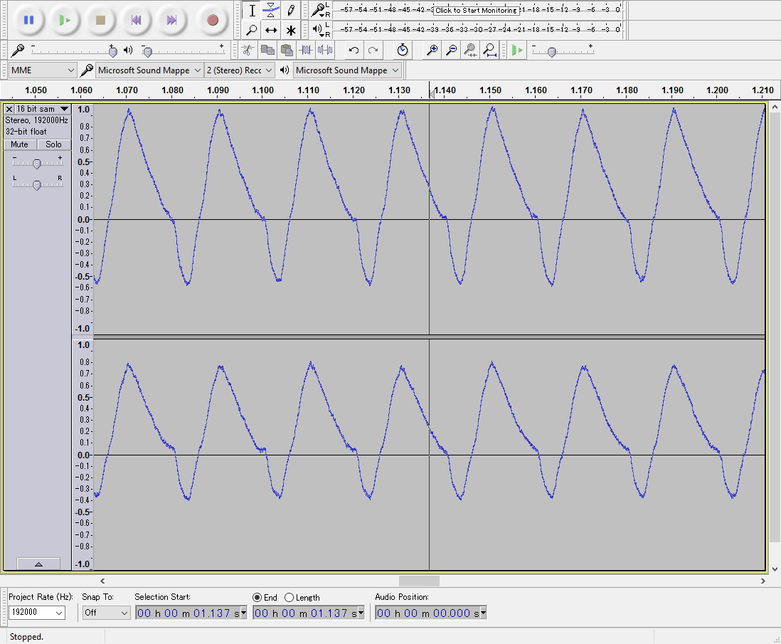

I'm at a loss to explain this one.
50 Hz sine wave with a chunk lopped off part of the peak. ~10 mV rms at the output of the CrystalFET. Such a waveform does not normally exist in the CrystalFET circuit, at any magnitude. If I had to guess : noise from a high current half-wave rectifier power supply (something big and nasty, not audio) polluting the AC line and earth and injected into the CrystalFET via some a ground loop.
