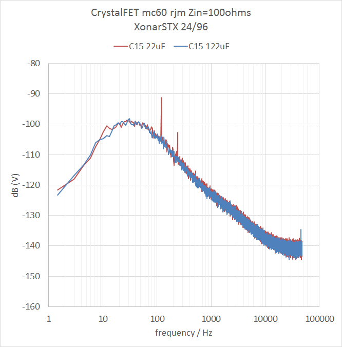

Increasing C15 from 22 uF to 122 uF suppressed the two power harmonics visible in the FFT but did not alter the broadband noise.
(C15 is the first cap after the diodes.)
So we can say the broadband noise has nothing to do with noise on the voltage rail per se, it is generated internally either at the amplifier or regulator stages. The amplifier seems most likely given that the output noise does not show any attenuation effect of the CR filter stages, which the regulator noise would be expected to carry over at the output.

correction: C15 is now 22 uF + 220 uF = 242 uF not 122 uF.

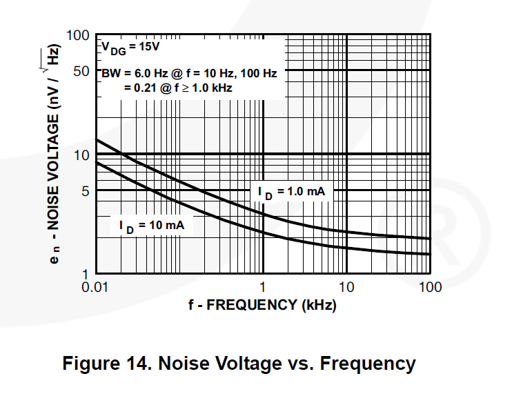

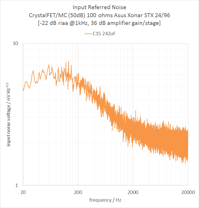

There are now no power line spikes, so we can look at what the broadband output noise translates to in terms of input-referred JFET noise.
This is a bit tricky since the second amplifier stage contributes most of the noise at high frequencies, while the first stage dominates at low frequencies. This is characteristic of a passive two stage RIAA design. What the plot below shows is the estimated noise characteristics of the first stage JFET amplifier.
I made the assumption that the high frequency noise of the second stage JFET is linear with frequency. Actually it has still has some residual curvature but this approximation does not affect the result much. I used the measured value, 50 dB, for the total circuit gain, and added 3 dB to the noise because, I remembered, audacity is averaging right and left channels so the uncorrelated noise is reduced 3 dB so I need to correct for that.
The long and short of it is the measured output noise is the value and shape predicted by the J113 datasheet. The roll off at low frequencies is due to the many bypass and coupling capacitors which are not accounted for here. The main point is there is no (or hardly any) additional noise from the power supply or external sources. It's just the JFET noise.
I still cannot explain why the noise decreased ~4-5 dB April->June however.

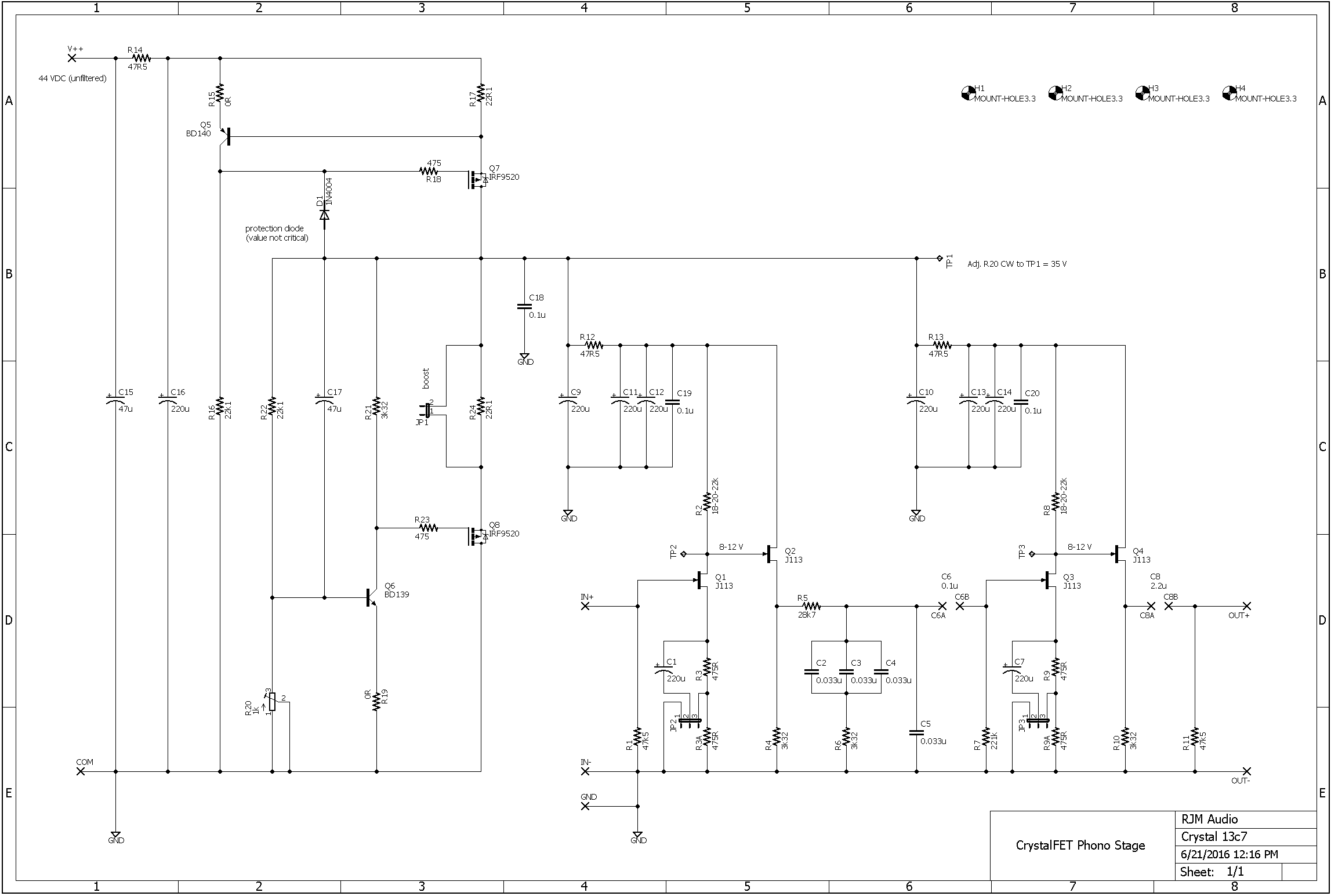

new 13c12 BOM for rev. 1.3c boards reflecting recent progress on the power supply front,
R15, 19 0R jumper (was 47.5 ohms)
R17, 24 22.1 ohms (was 33.2 ohms)
C15, C17 47 uF / 63 V (was 22 uF / 63 V)
Feel free to experiment making C15 even larger, but the BOM parts are chosen for what will fit in the existing board layout.

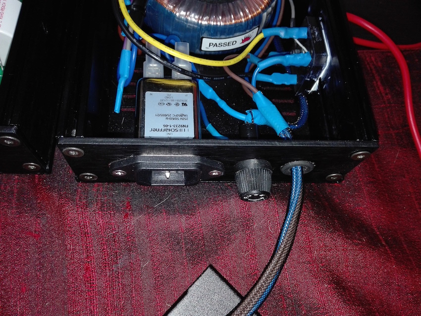

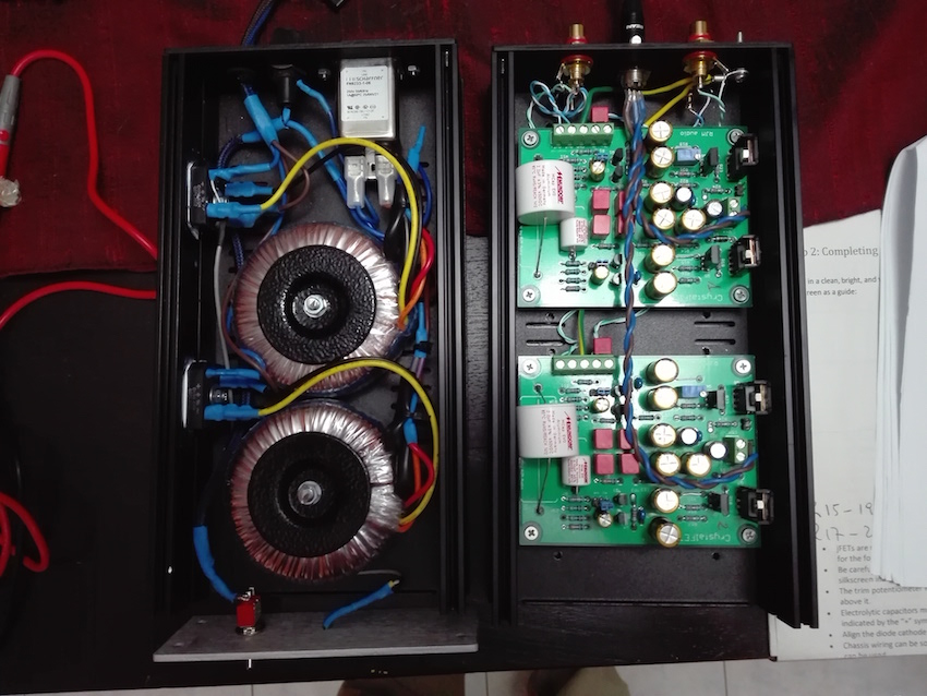

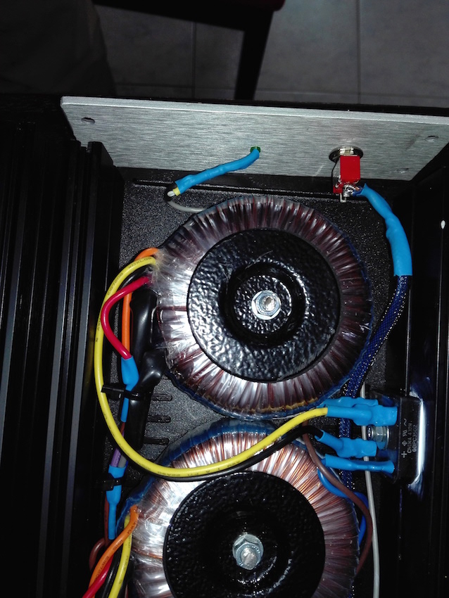

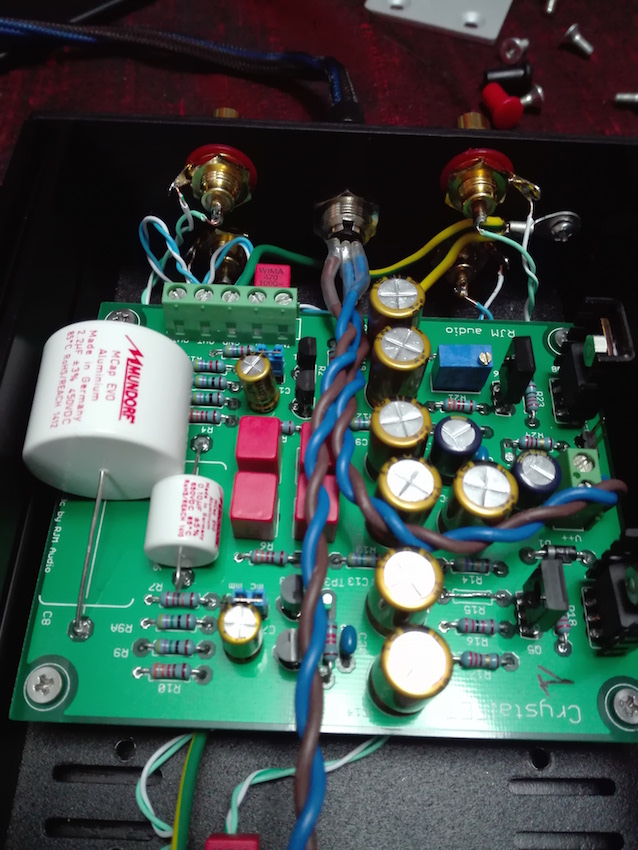

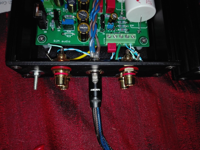

Dear Richard,
yesterday I did a big mistake!
The preamp is 99% ready, I did 2 chassis version, the power supply is working wit 2X toroidal transformer 2X18V 50VA and I will post photos in the next days.
I connect the power supply to the boards and c15 cup in one channel is exploded because i did a wrong connection of the power supply.
Newer mind for the C15 as I'm waiting for new one with the value you have suggest in one of you early post, but in your experience, what other controls do I do in the circuit to see if any other component is blown?
Visually only this capacitor is broken, partly because I immediately turned off the power but if you need I will post a photo.
Thank you in advance for your help.
That was unfortunate.
With a bit of luck though R14 (and sacrificially C15) should have protected the rest of the circuit from damage.
I would replace C15 and see if the voltages and currents look sensible, particularly the current through R14. If it is still 30-40 mA then it's probably all good. If it is much higher then there's a problem.
Hi Richard,
I think I'm very lucky, I did measurement on R14 and seems Ok, also I did the R20 adjustment and easy went to 33V +-0,02V without any blown components.
Tomorrow I will try to connect it to my turntable.
Thank you for all your support!

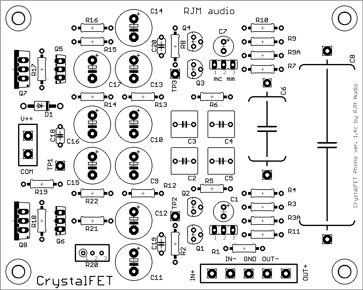

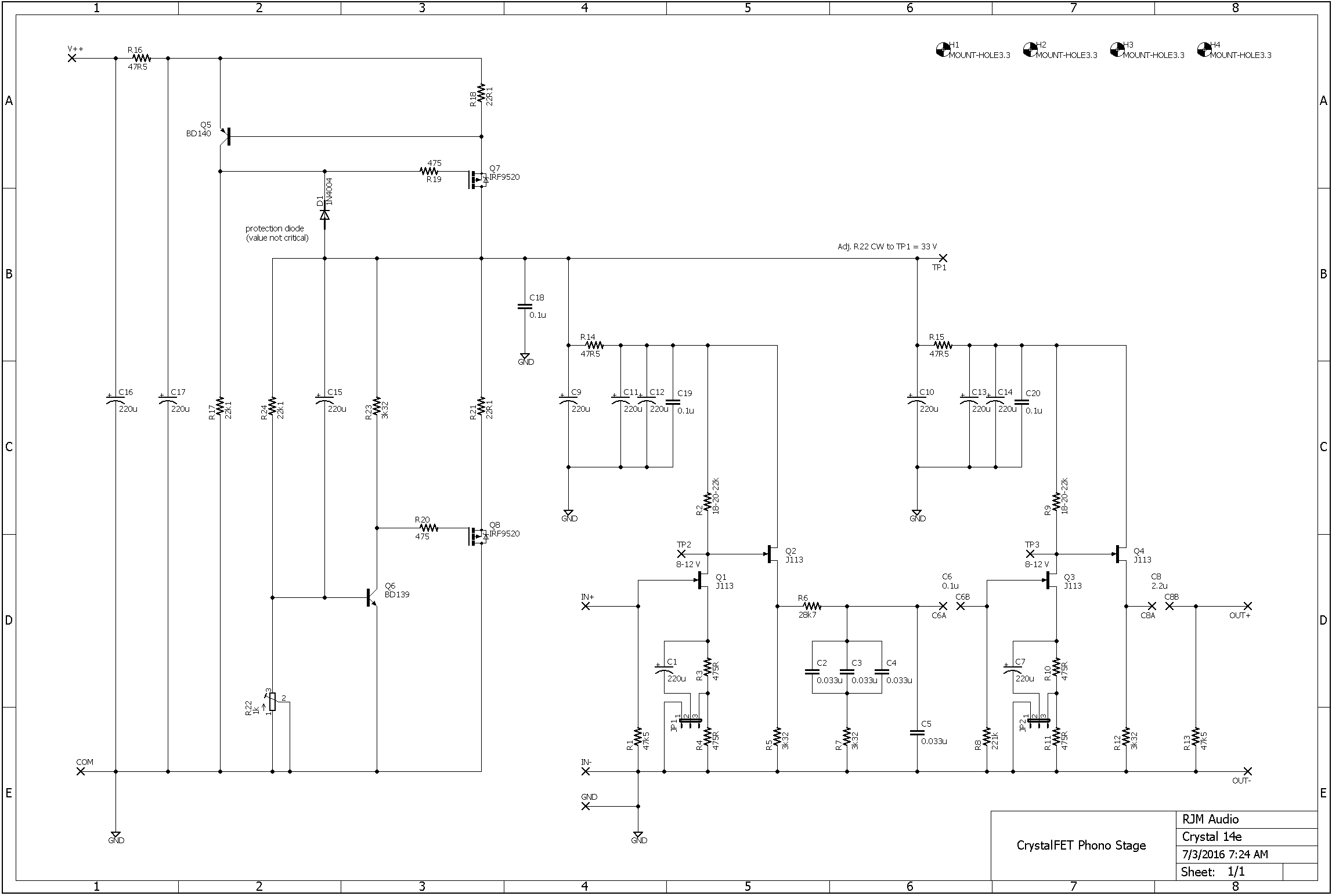

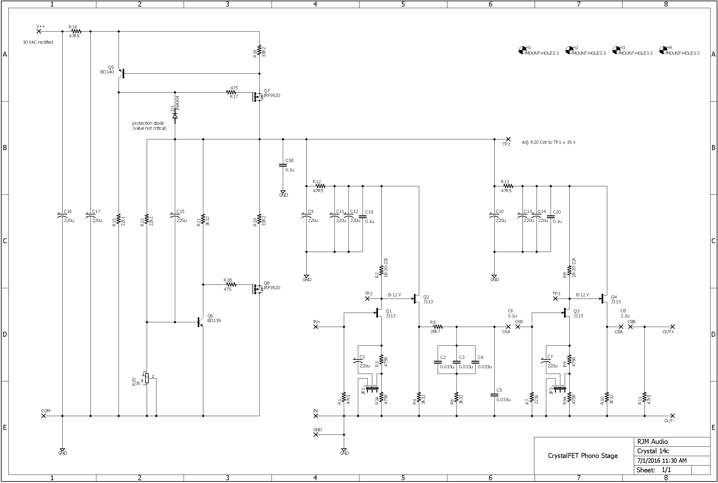

preview of next board revision, 14c
This is really just housekeeping, there are no major changes.
Schematic changes,
- boost switch is removed
- power supply emitter resistors removed
- 22 uF power supply caps increased to 220 uF
- power supply components renumbered
Board changes,
as above, and
- flat test pads replaced with wirepad test points, they are easier to use as probes don't slip so easily
- power supply layout compressed, moved left
- main circuit moved left, more space now for C8
- IN+ OUT+ labels moved to clear screw terminal package
If anyone has any requests, let me know. It'll be Monday before I send these to the fab.

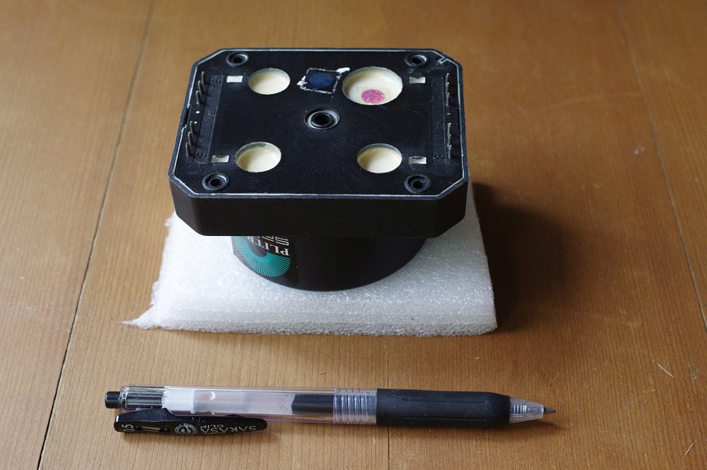

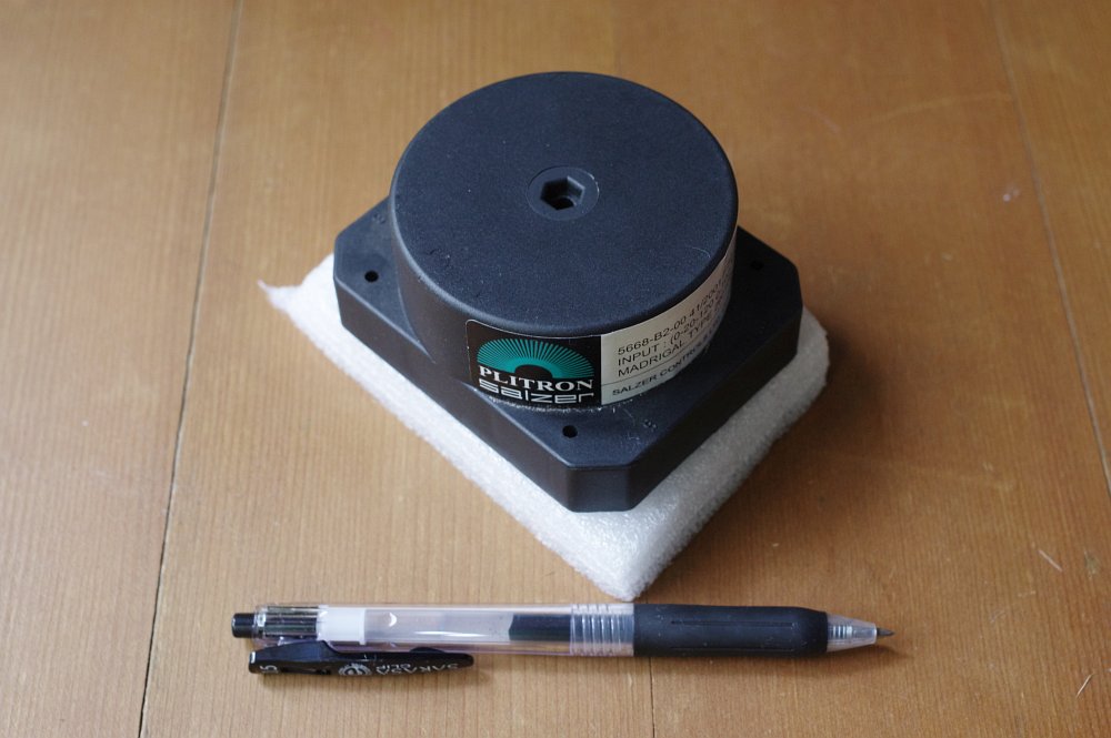

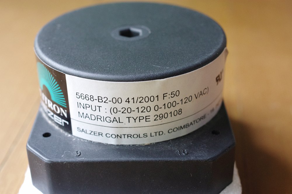

Speaking of housekeeping, I forgot to you show you guys the transformers I wrote about earlier.
The three brands on the label *Plitron*Salzer*Madrigal* should serve as a good indication of the quality we are dealing with here. For a 25VA part, they are enormous and extremely heavy. A steal at the asking price... but not the easiest to work with, as they of are designed to be fitted to a PCB rather than bolted directly to a chassis.
I'm thinking the best option is to knock up a quick layout and get some boards made at pcbway, just with the input and output connectivity and maybe the rectifier diodes. If anyone can provide the formal dimensions of the PC2 case these are potted in, it would be most helpful.

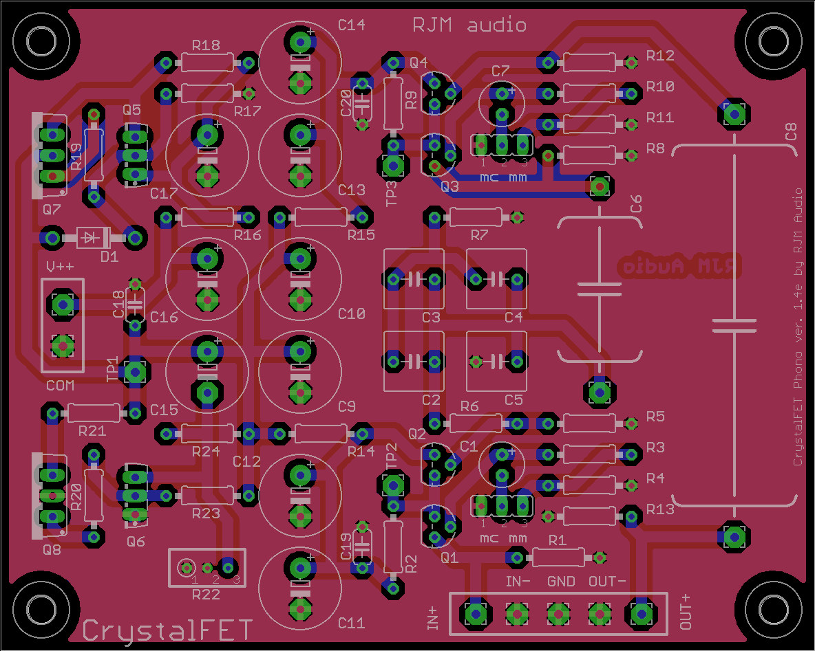

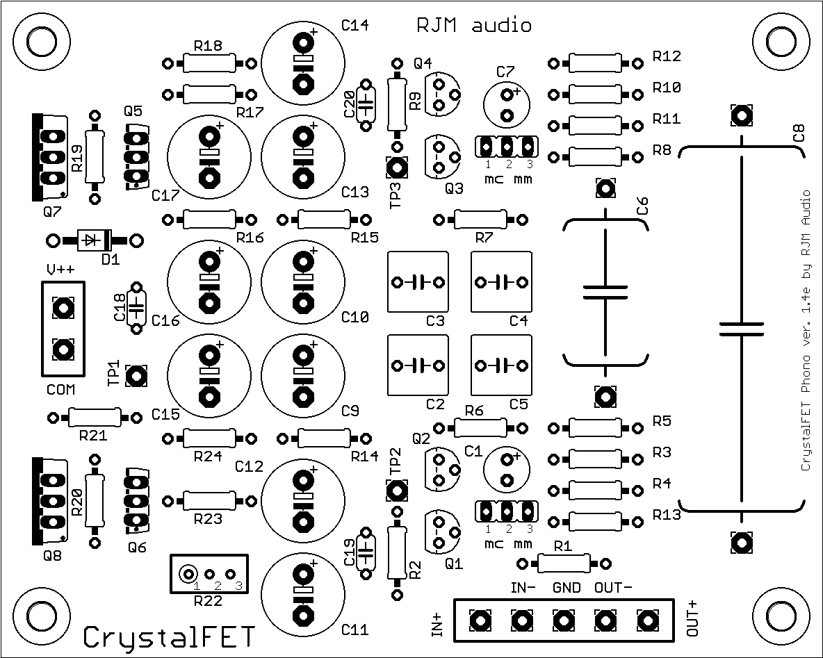

rev 1.4e
- renumbered resistors
- small adjustments of component layout and silkscreen to improve label visibility
