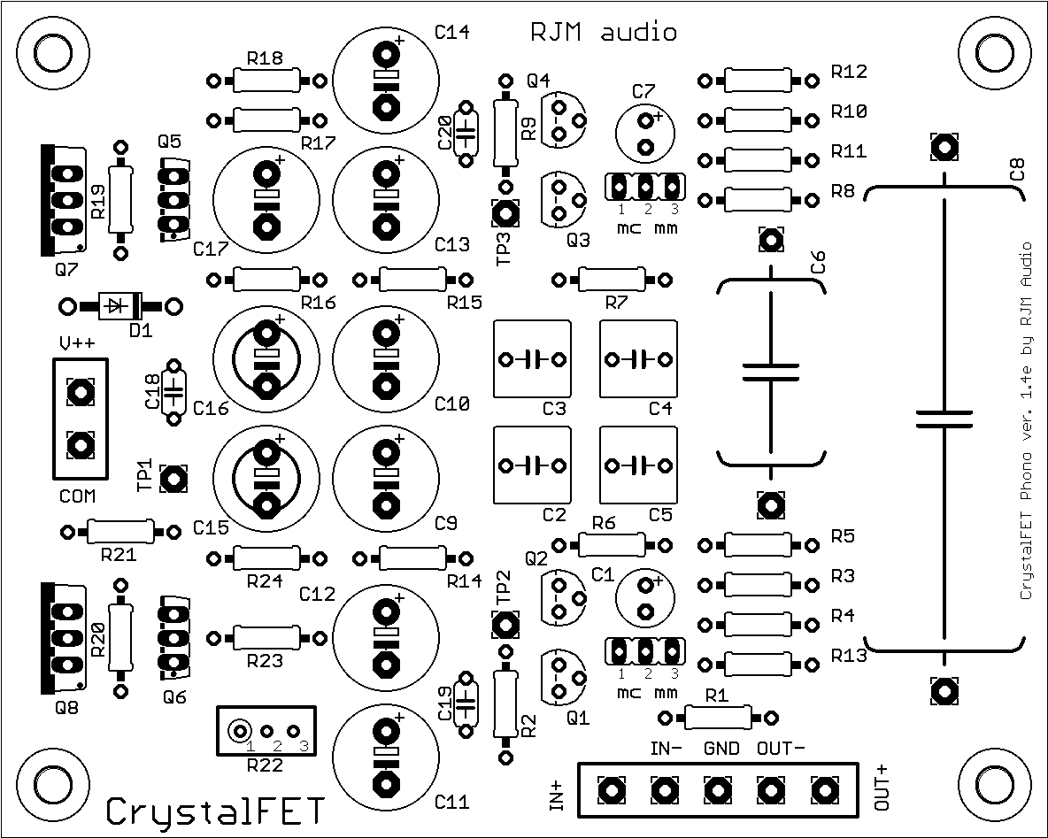

Please measure the voltage across R17 and R24 and let me know the result. (They are 22 ohms?)
One thing to try is adjust trim R20 to V+ / TP1 = 31 V instead of 33 V.
Also, after that, try increasing or adding more capacitance to C15.
Finally, disconnect V++ from one board and just use one channel to see if the hum is the same or better.

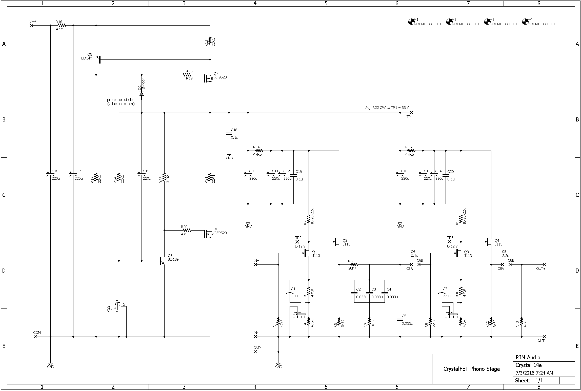

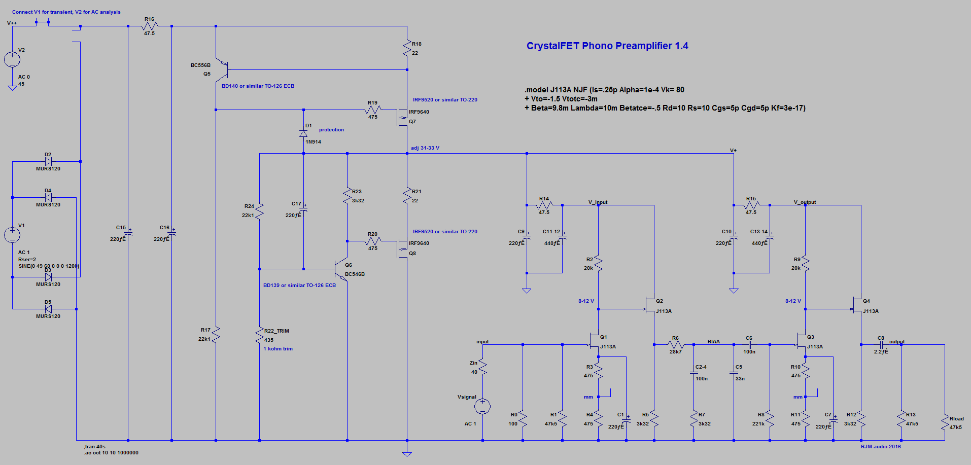

LTSpice file for CrystalFET14

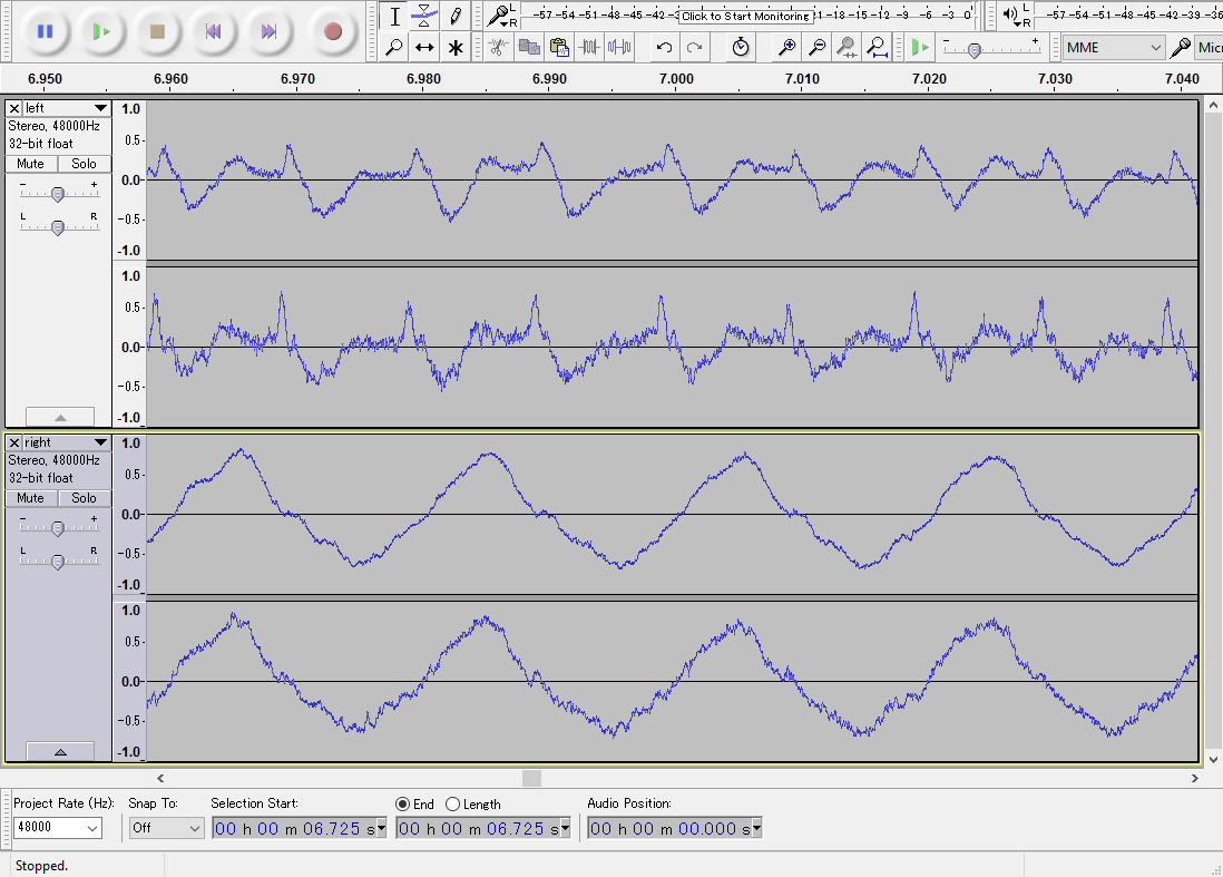

Dear Richard,
sorry for delay my answer but I was busy this week, anyway yesterday I have open he preamp case and I have try to understand if the noise i heard was made from the power line.
The good news is that your project is not so sensible to the power line, because to hear some 50Hz influence I have to have the power line really close to input line!
Enclose you will fine both channel audio file I have record with my mobile, I hope they are enough to verify if everything is right.
Again, thank you for all your support.

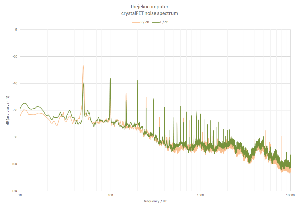

(Note: I assume we are looking at the stereo recording from a smartphone, held close to the left or right speakers. Correct me if I am mistaken.)
While visually the two signals look quite different, the noise spectrum tells us the only real difference is a large 50 Hz component in the right channel.
The rest is a solid "comb" of power line harmonics up to 2 kHz, seen equally on both channels. Some of it can be correlated to the charging current, some of it looks more like the rectified voltage.
So the "hum" problem in the right channel needs to be addressed, this is a noise pickup/shielding/grounding issue, while the "buzz" noise in both channels is also higher than expected (I don't know the absolute level of course, but given that it is clearly visible above the broadband noise means it is certainly higher than what I have.). This could be caused by faulty circuit components or, more likely given your voltages are all correct, is noise pickup due to ground loop or poor shielding.
I should say that looking at what you've built I would not think there to be a problem with grounding/shielding... so yes, I'm a bit confused as to why this is happening, though it is possible the reverse voltage blew out the mosfets I can't imagine the regulator still functioning if that was the case.

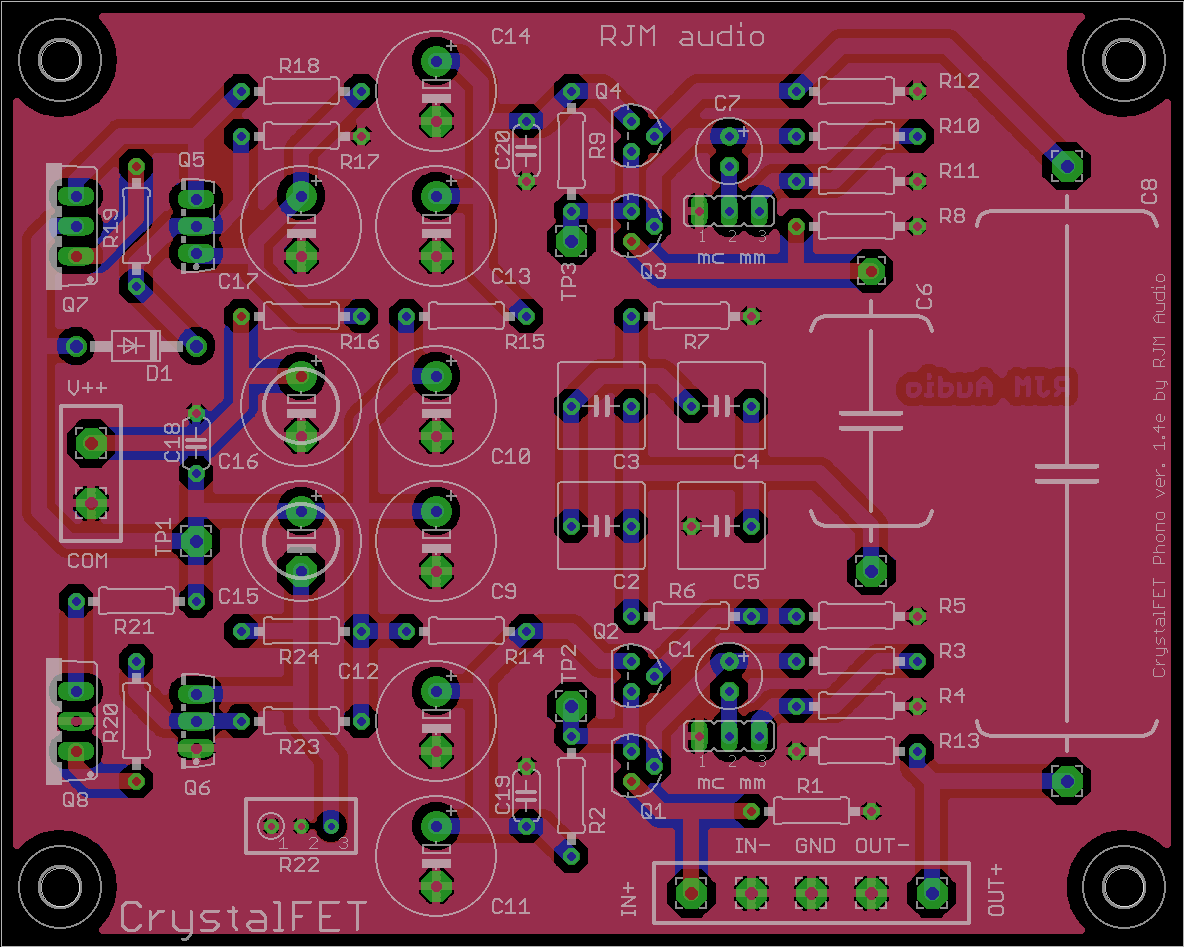

Another 1.2a (almost) finished

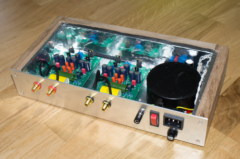

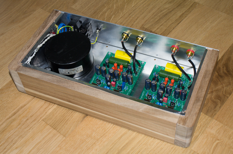

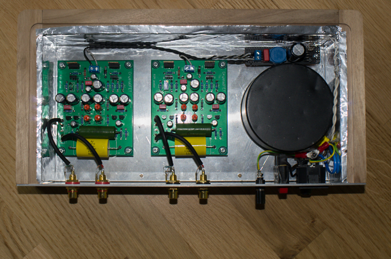

Hello
last weekend I managed to continue my build based on the 1.2a boards. First listening tests are very promising, full body, smooth highs. No audible hum (the mu-shielded transformer (originally Linn Pre) seems to do no harm although it is quite close to the board. No audible noise (still need to measure).
Configuration is currently still original BOM 1.2a, I crank'd up the CCS though to have some more margin (reminder: need to heatsink the TO220). I will modifiy the PSU according to RJMs last findings.
kind regards, Daniel

Looks good.
It seems like you have some extra filtering off-board, so you can ignore my previous remarks re. increasing C15.
Out of curiosity,
- by how much did you crank up the CCS?
- how do the boards connect to the chassis GND?
- where did you get those red axial capacitors for C2-5? They look neat.
/R

- current is ~29mA (R17 = 24Ohms), All the rest currently BOM 1.2a, emitter resistors still active
- currently signal ground is not connected to chassis ground. Don't have any hum. I'll test other configs though.
- Capacitors are Vishay K460 Series KP 63V 33n 1%. I bought them at a German distributor for quite a low price (they said 10% tolerance but they are 1% 🙂)
BTW: just measured an output noise voltage of ~160µV (DIN Audio 20-20k, 100 Ohm input resistor). This translates to -70dB re 0,5mV input referred (60dB gain, ignoring RIAA). I'll measure again after PSU mods.
Thanks for your reply.
The noise figure seems about what I would expect. The RIAA eq. complicates the relationship between broadband 20-20k noise and the FFT noise baseline : most of the contribution is <100 Hz due to the bass boost. That said, your build and mine appear to line up closely.
With a single box, earthed chassis, the connection between the board GND and chassis can be left out - and in rare cases this might be even preferable to avoid ground loops. This may be something other people might want to look at if they are having hum problems.
