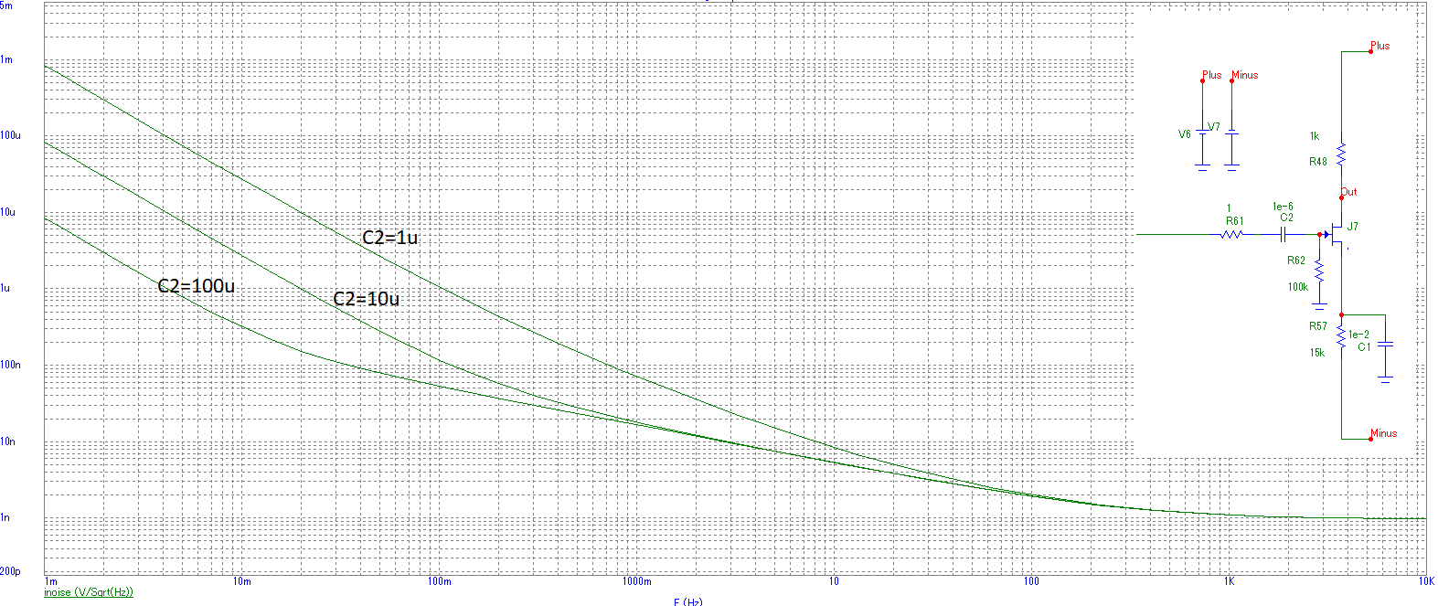

No, it does not amplify the noise of R11, it does short the noise of R11 through the
source impedance, the larger R11, the easier.
And the source impedance must be _very_ small, or else a 200 pV/rtHz amplifier
would be pearls before swine.
10 Meg delivers 406 nV/rt Hz, do you see any trace of it in the noise plot?
100 Meg would be even easier, not worse. Yes, that's against the belly feeling.
But it is mismatching at work.
The real problem is the time constant.
Input RC must not be selected for f-3dB. At f-3dB R and Xc have the same value.
Oh, really at ~ -6 dB.
For effective shorting, Xc must be _much_ smaller than R.
As in 10uF vs. 10 Meg.
The revenge is that it takes an eternal time to find a stable quiescent condition.
And if the input DC changes, you go back to start. I have a window comparator

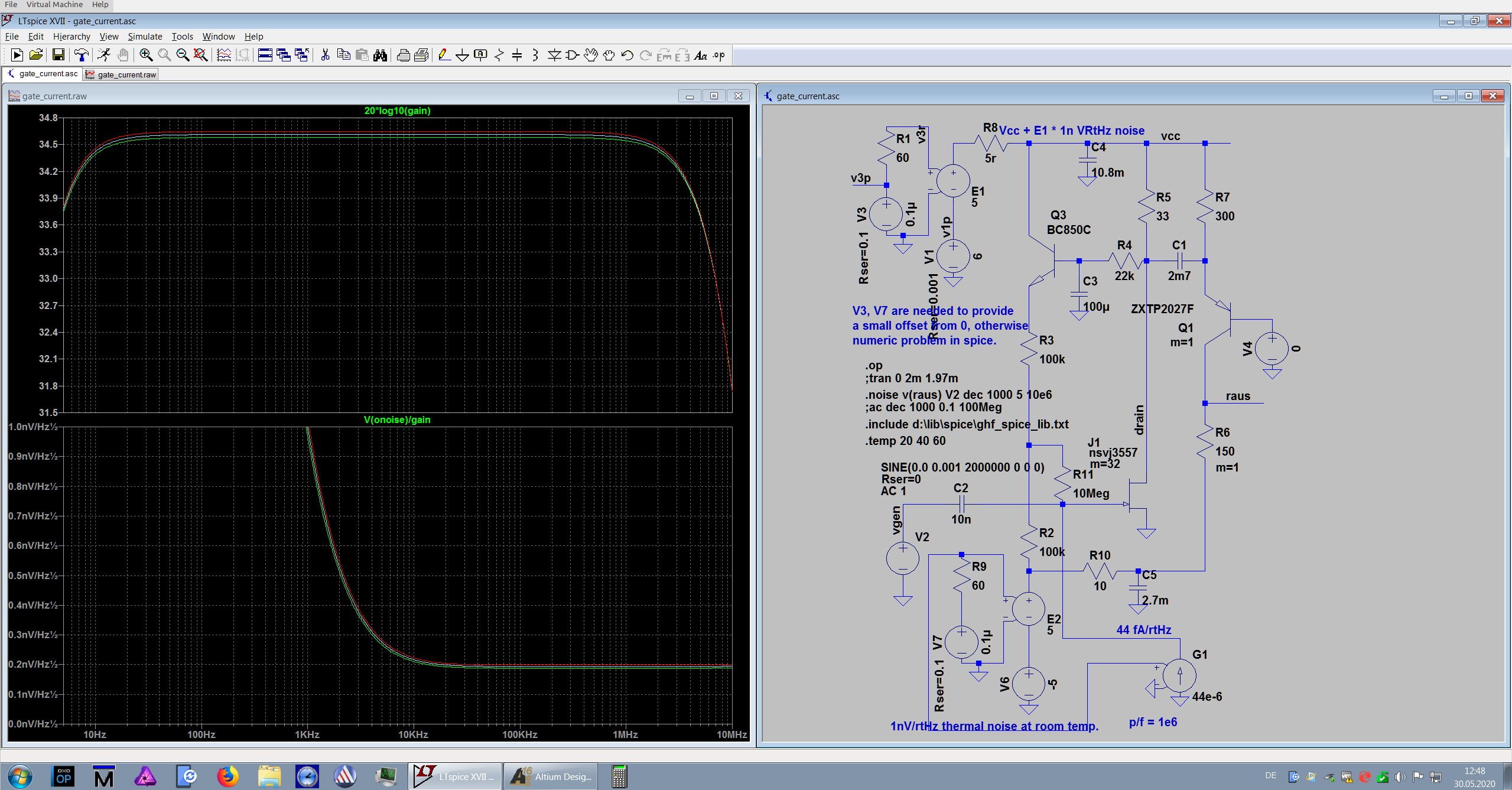

No, it's not goodbye. Not at all. 99.9999% of the shot current would not flow through
the 100 Meg but through the capacitor and the low generator impedance.
It would be shorted like the resistors own thermal noise.
To prove this, I have forced your 44 fA/rt Hz with a VCCS fed from the 1nV/rtHz thermal
noise of a 60 Ohm resistor. No effect.
I have also changed the 10u input capacitor to 10n to show why it is needed so large.
Noise explodes below 5 KHz, while the passband still starts at a few Hz, no change.
The comment in the picture should read "n/f = 1e6".

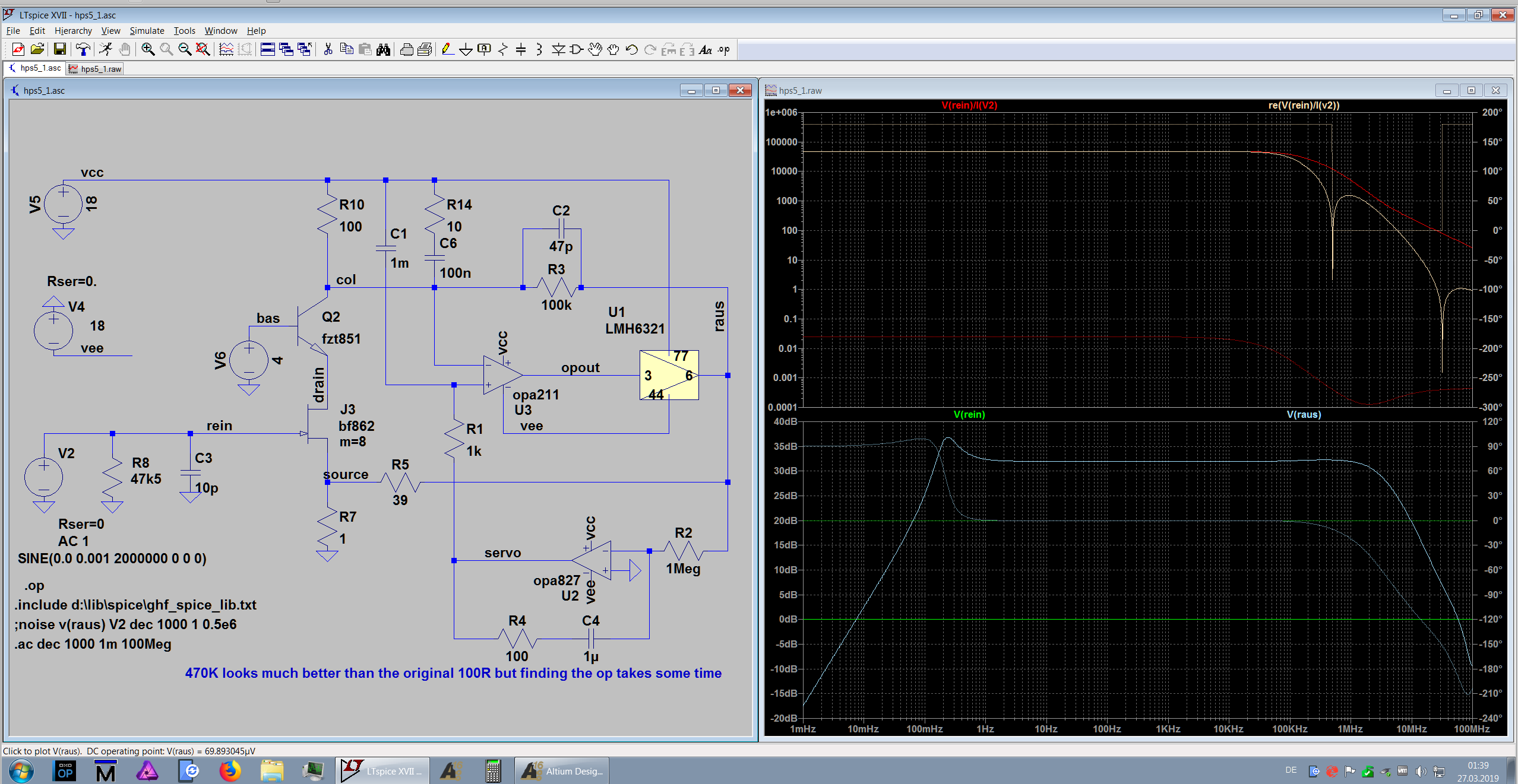

With raw Vcc = 5V3 and R5 as an excuse for a current source, there won't be much
voltage left for ionization current from the channel.

And that it does not happen to oscillate does not mean it cannot. The vector network
analyzer is cruel enough to uncover every such tendency. That's good.

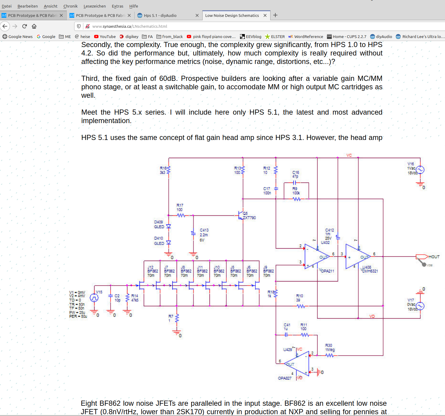

And your 64xBF862 is probably not a relative of HPS5.1? See the sim below. The phase
of the real part flips by 180° between 600 KHz and 60 MHz. And with series inductors
you cannot heal a negative real part, the best you can hope for is that the L decreases
the resonant frequency below the negative real part zone. Which says nothing about
peaking etc.
It's not that this is a esp. bad case, the amplifier from fig. 3.34 in Art Of Electronics
and some of mine behave exactly the same way as soon as the fb loop is closed.
For a measurement tool, I cannot accept that.
As Frank'nfurther said: I'll remove the cause, and not the symptom.

No, it is not HPS5.1, more like HPS 1.0 (which is pretty much the Dennis Collin approach) and a rather low closed loop bandwidth of about 100KHz (at x1000 closed loop gain). You would of course know that the JFET models in Spice are extremely crude, both in the small and large signal domains, lots of phenomena are simply not modeled (subthreshold conduction, noise other than channel conduction, Cgd variation, short channel effects, etc...). So as much as I don't trust the regular free models for any semi device including op amps macro models, I trust JFET models even less that the average.
Otherwise, you appear to have changed your goals quite a bit; some time ago you were looking at something to measure battery noise, therefore you did the 20x ADA4898; at that time, I mentioned the input current noise but you said it did not matter for the application you had in mind (true). I suggested a FET approach (to support higher source impedances) and you rejected the idea on the same grounds of stability. Nevertheless, for battery noise measurements, you would not need more than say 10KHz bandwidth, which even for x1000 gain would allow you to compensate the loop well under any critical frequencies where oscillations may occur (worst case). Of course, 100MHz closed loop bandwidth for a feedback amplifier with high closed loop gain (>100) is impossible, so your "no feedback" approach has ultimately no competitor, anyway.
One last thing, you really don't care about the gain precision and drift? A no feedback approach can obviously not have much of gain stability. You cannot design for a precise gain, it's all about trimming (or measuring it and using the value as is, until you may need to replace a JFET).

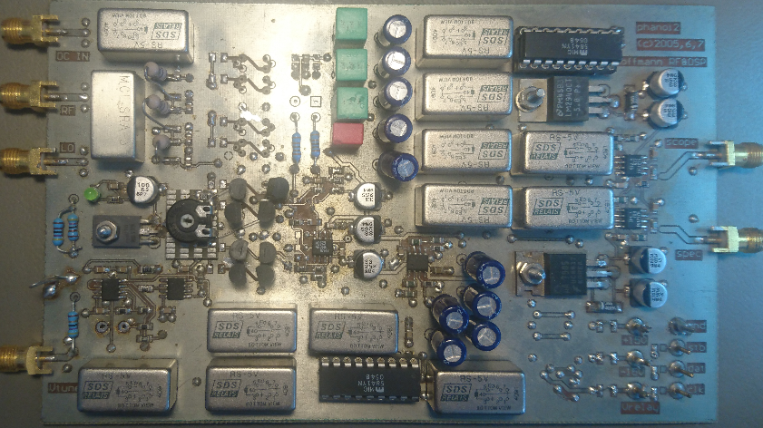

The really interesting thing for me is phase noise of oscillators and geophysics.
Pic below is a phase noise mix down head, PLL controller and FET amplifier with
8 FETs and space for some more. OK, it's differential, so it only performs as 2 pcs.
2SK389. It's inspired by a design from Charles Wenzel, the king of crystal oscillators.
Two-sided Eurocard 160*100mm, home etched.

I can get the FET amp stable with 1 MHz BW at least in simulation, but that is
no final success as the ultra fast op amps wreck the 1/f behaviour. The 30 dB gain
of the JFETs are quickly used up and do not mask the op amp 1/f noise at low
frequencies.

I am the one with ".temp 20 40 60" in his simulations. The pos. and the neg. TC
of the JFET seem to cancel nicely for the small signal FETs. Interfet IF3602 with its
different operating points/environment has a gain error of 0.5 dB / 10°C, not so nice.
But I have a heater controller to keep it at 40°C.
frequencies.
