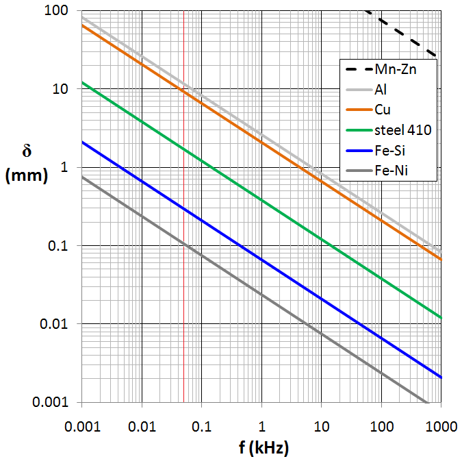

From a consideration of skin-depth a few mm of steel is better than several cm of aluminium for screening, particularly if mains frequencies are the issue.
Set aside the machining issues, I wish it were that easy/simple; regular carbon steel has a permeability of only 100 and OTOH the resistivity of carbon steel is 5x the resistivity of aluminum. Since the skin depth varies with square root of the ratio of these, the improvement in skin depth of steel over aluminum is only 4x. That is, if 2cm of aluminum are required, then the carbon steel equivalent will need 5mm.
Pure iron is so much better, but impossible to source. The ideal magnetic shielding would be a double box of mumetal, but those are expensive hence reserved for professional use. Plus the required annealing, not something one can do at home.
Ah, yes I think I was assuming generic steel was as good as iron or laminations. Still its better than aluminium or copper for screening at audio, but at RF you also have to think of lossiness which is why its seldom used for that (skin depths are tiny anyway then).

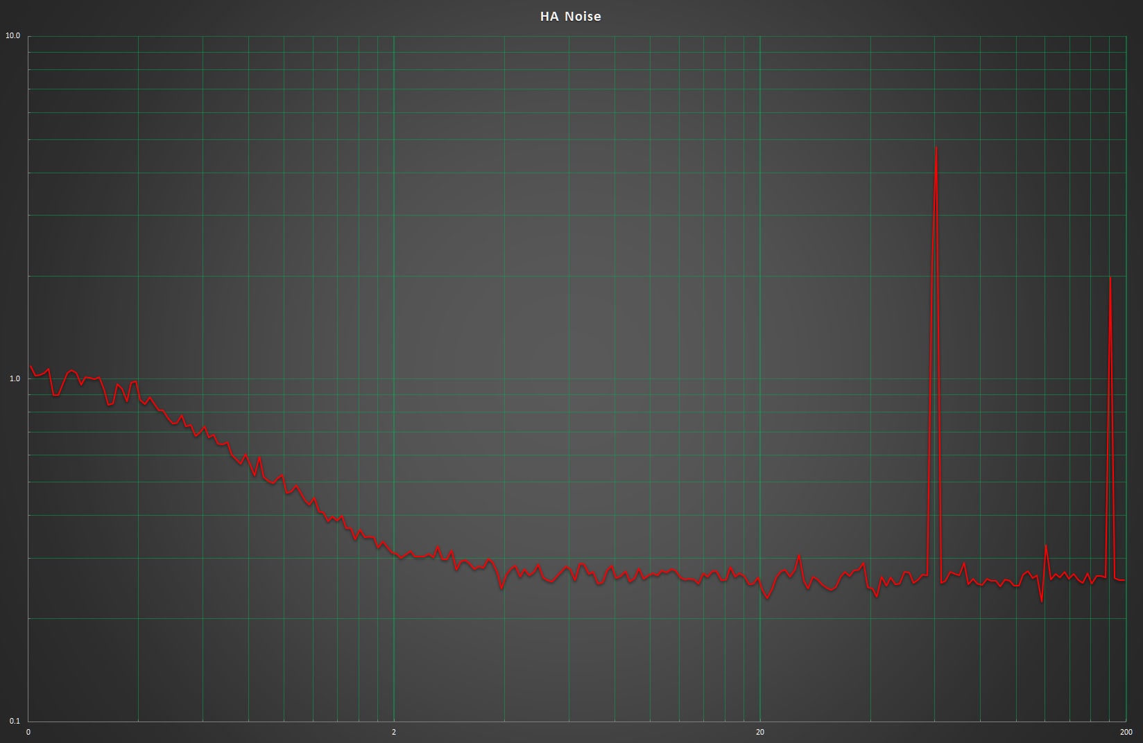

The head amp in post #375 very low frequency noise (0.2Hz-200Hz), now measured with both the head amp and the measurement amp fed from the same lead acid batteries. Overall gain is 86.8dB.
The 60Hz mains frequency component is now 5nV equivalent at the input, a sharp increase from the well shielded measurement amp (1.5nV, see the previous post). That's to be expected, since the head amp is virtually unshielded at these low frequencies. Third harmonic is also clearly visible (it is totally absent in the measurement amp, so this is coming purely from the head amp). Only 50 averages were taken, since it takes about 5 minutes per sweep (due to the time required for the A/D filter to settle, at these low frequencies).
Flat noise (input shorted) is the same 0.26-0.28nV/rtHz as measured before, but now the 1/f noise region is clearly visible. It is very encouraging that the very low frequency noise is almost purely 1/f (slope is about 12dB/decade, compared to the theoretical 10dB/decade), this is a certain plus over low noise JFETs. Also, the noise corner frequency is 2.5-3Hz, again an excellent value, much superior to JFETs (100-150Hz). The left side slight drop is due to reaching the measurement amp LF bandwidth limit (0.3Hz, as mentioned above).
Now, if we could only combine the LF noise performance of bipolars with the low input current noise of JFETs... not going to happen, so it will remain a pick your poison game.
I’m really surprised about the rather huge differences in mains radiation between our locations. I have no idea which of the two can be called exceptional, but I think that I must be quite happy getting a flat noise spectrum with an unshielded Head Amp producing just 0.32nV/rtHz.

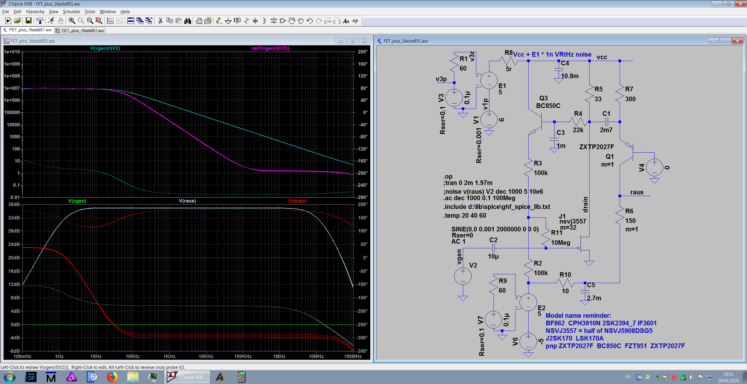

I must come back to the stability issue of these composite FET amplifiers.
I tried to launch a discussion in usenet sci.electronics design but there were no
takers, so I simply cut & paste it here:
Let there be an amplifier consisting of one or more CS input JFETs,
an optional cascode, an op amp for plenty loop gain and feedback
into the source. Everybody and his dog does this, but it has
a drawback: it is not stable.
If you measure into the input, you see a capacitance in series with
a resistance. Unfortunately, the resistance may be negative over
a large range of frequencies. That means that with a suitable
inductance at the input, one gets a undamped RLC series circuit,
aka oscillator.
The usual remedy would be a gate/base stopper. Just insert a resistor
into the gate that is more positive than the worst negative value
and you're done. But bandwidth and noise performance are gone.
The next step is that people insert ferrite beads into the gates
and claim victory. But that's Pyrrhus@work or worse.
The beads don't provide a loss resistance at, say, 100 KHz. And
if they did, they would also provide the thermal noise that belongs
to it, so a real resistor is just as good with less guesswork.
Below a MHz, these beads can be inductors with excellent Q, I have
put them on the bridge.
This circuit is fig. 3.34 from Art Of Electronics V3 with a little
different biasing that doesn't matter, I used sth. different as
a starting point.

Some observations:
1. I used 16 pcs. CPH3910 in parallel. Sources must be RF grounded
with a distributed array of capacitors or one finds 2V at 500 MHz
there. This is a parasitic loop in the loop, Spice cannot see it
because it cannot see the parasitics. Even 2 nF has no impact on
the global loop dynamics.
2. For the feedback, the FETs are common gate. The gates being
the fb reference, they must have known potential. The 1 Meg
does not provide that at RF. There must be some capacitance
from gate to GND.
3. R25 C11 are from experiments to save as much input impedance
as possible while providing the RF gate-gnd connection.
4 The FET sources are a low impedance input. That may change
the feedback factor / overall gain by loading the fb divider slightly.
5. AOE3 mentions a slight overshoot that is easily tamed. But
really, the circuit is not stable. I have checked this with
a lot of published circuits of this architecture and none of them
was blameless, including mine.
6. V(vin) / I(v4) is the input impedance, as seen from the signal
source. re() is the real part of this, the yellow trace in the
upper plotting pane. The real part turns negative between 100 KHz
and 20 MHz, as indicated by the 180° phase flip. The negative
resistance is up to 500 Ohms. (yellow trace)
7. It does not only happen in simulation but also in real life:
< Bildschirmfoto vom 2020-05-22 04-34-59 | Gerhard Hoffmann | Flickr >
is the behavior of a similar circuit ( with BFT93 folded cascode
and 2 lower gain op amps as an attempt to minimize phase shift).
8. It looks somewhat confusing, but the red line gets outside the
unity circle of the Smith diagram for S11 and that means unstable.
9. In cartesian coordinates, the return loss S11 is actually 1.5 dB
gain, i.e. we get more energy from the input port than we send into it.
(blue)
10. The pink trace is the real part of Zin as computed from S11, and
it is negative over some of the frequency range.
11. I can recommend the DG8SAQ VNWA, you get a lot of capabilities
for a limited amount of money. In fact, it is much less user hostile
than my ZVB8.

Didn't convince in hardware, maybe the dead bug patches go too far
for the existing board.
So I decided to drop the feedback for the input stage. Gone are all
the problems, gain stability vs. temperature is much better than I feared.
It takes a fat PNP with enough emitter current in the folded cascode to
suppress the voltage gain from gate to drain. (Miller killer)
With a BFT93 and low source impedance you can push this to 100 MHz
bandwidth easily. No more op amp influence on 1/f.
The simulation includes 5nV/rtHz of noise on the unfiltered Vcc and Vee,
a requirement that LT3042 or batteries can easily do. The noise contributions
of Vcc and Vee are the red and blue traces in the bottom plot pane, as they
would spoil the input signals.
The ON semi JFET model has no 1/f noise. From the data sheet plots,
the 1/f corner could be down to 30 Hz.
If nobody sees a show stopper, I'll send this to JLCPCB this weekend.
Cheers, Gerhard
