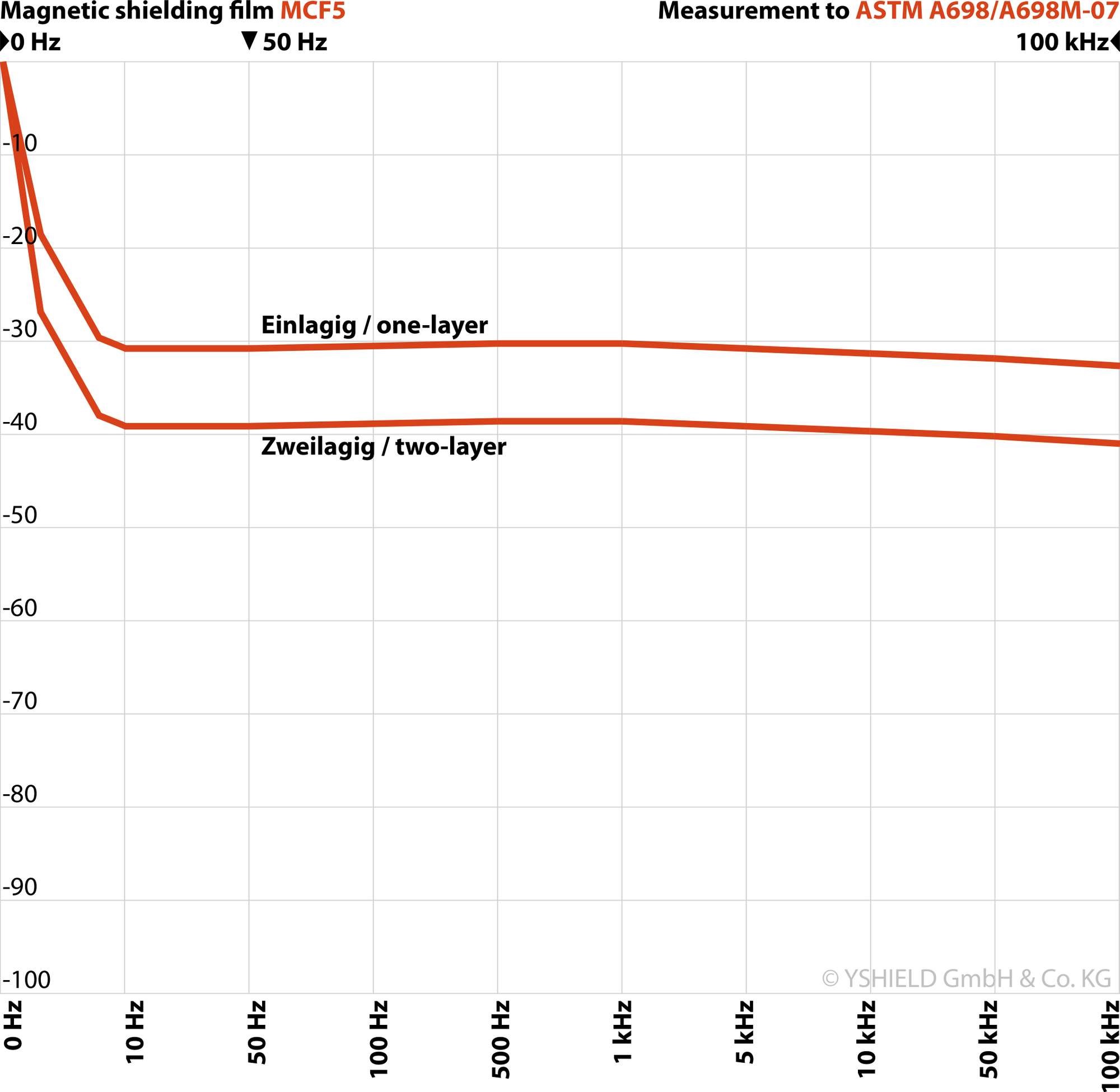

I've only now read the posts re. shielding against mains hum, and thought that the experience I gained with a possibly not widely known material might be interesting.
I've built two RIAA units by Hans Polak (Linear Audio Vol. 12), each with a gain of 60dB@1kHz. Both were built into the same kind of housing - 1.5mm aluminium all around, only the front plate was 6mm thick. The individual PCBs (two per unit) were fastened on a copper-clad PCB material that extends over the entire area of the housing.
Both RIAA units had audible mains hum when placed on top of their respective preamps.
By chance, I ran across a material that in the end solved the problem:
YSHIELD(R) Magnetic field shielding film MCF5 | MF | Width 5 cm | 1 meter | YSHIELD(R) | YTHERM(R)
I covered the inside of the bottom housing plate with the foil, and repeated it on the copper side of the plate that holds the RIAA PCBs. The hum is now not audible in the loudspeakers (85dB sensitivity) after being additionally amplified by 32dB, and with the cartridge connected.
Unfortunately, I didn't make any measurements, so I can't quantify the effects. But the fact is, two layers of a 0.02mm foil solved my problem.

Yes, amorphous cobalt based materials are very good for magnetic shielding. They may have some practical disadvantages, though, I don't think it's solderable (hence needs a mechanical setup for grounding) also it is much harder that mumetal. But I see it's not that expensive, which makes it a good option for DIYers. I'll try to get some locally, without the outrageous shipping and importing fees.

Does this stuff really do anything at 50Hz or 60Hz? More than 1.5mm Alu?
Jan
It seems to be working: my problem was the 50Hz induction from a transformer in the unit beneath the RIAA preamp, so there were two 1.5mm Al plates between this transformer and the RIAA electronics. Separating the two units by about 50cm eliminated the hum, i.e. produced the same effect as the two foils placed into the RIAA housing.
There is a diagram on the page with the foil that shows 30dB attenuation at low frequencies. This diagram prompted my bying the stuff.
Braca
Looks pretty good to me.
1.5mm of aluminum @60Hz does virtually nothing, since it is not thick enough to rely on the eddy currents cancelling the inbound magnetic field.

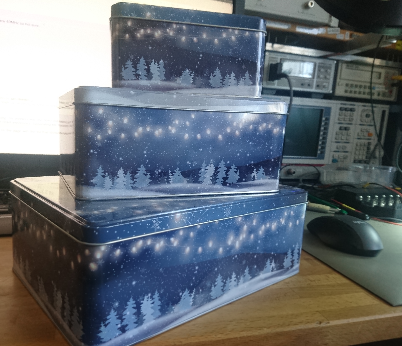

In the last xmas season, I scored these tin boxes, intended to
package presents. They were just €2, together.
Probably much better in dB/€ than most everything else.

In the last xmas season, I scored these tin boxes, intended to package presents. They were just €2, together.
Welcome to Richard's Duraglit world.

Tested just for fun: My cell phone does not ring if I put it into the triple box.

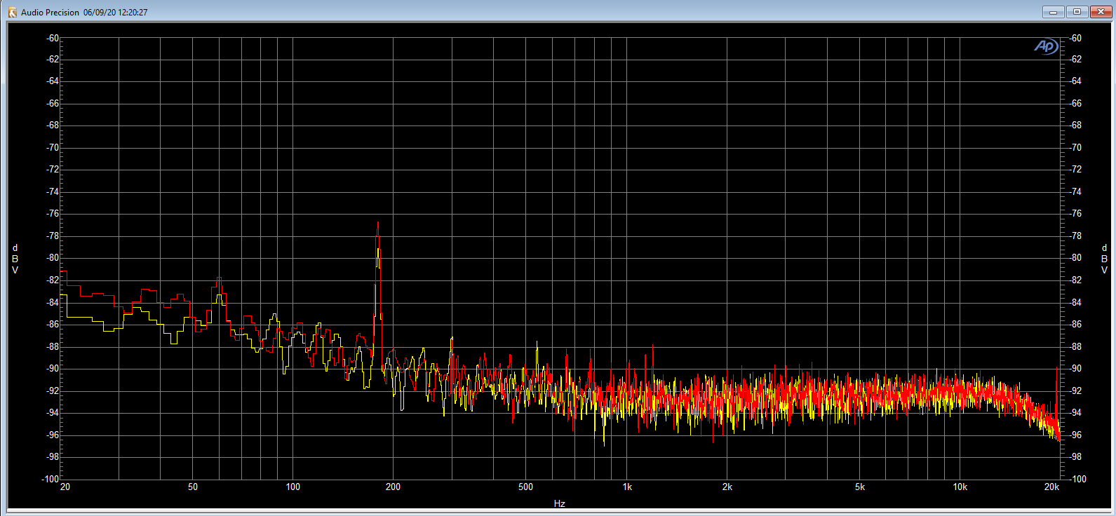

What's the circuit?for those about to use high-value caps
here are Nichicon UVK 33000uF (red trace) and AVX Bestcap (yellow trace) 100000uF in 8xBF862 feedback network
