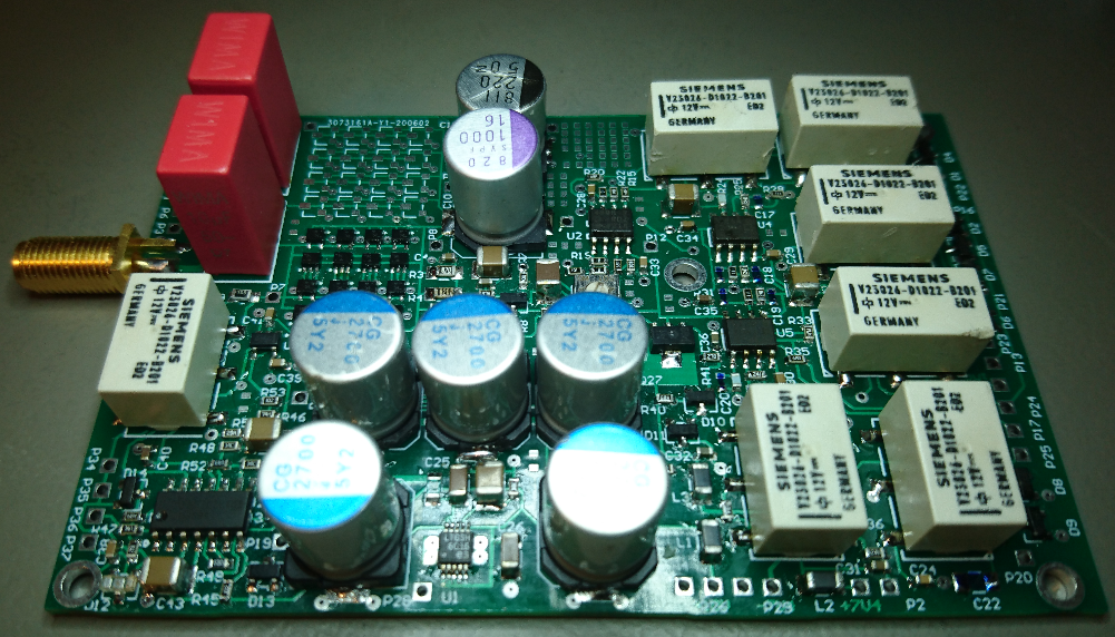

Yesterday, the boards came from JLCPCB for the amp with
the feedback-free input stage from #1750. Couldn't help
but solder over this rainy weekend.
Either 16*BF862-SOT23-like or 16* NSVJ5908DSG5 dual FETs.
Gain & 1 lowpass frequency are cold switchable with reed relays.
40/50/60/70 dB + 0/3/6/9 fine steps.
In a previous version I had used analog switches, mixed blessing.
Runs on 2*2 Lithium cells.
The operating point is monitored with a window comparator.
If out of range, the gate resistor is reduced from 10 Meg
to 100K to speed up the process of finding back.
Takes much too long otherwise. For noise reasons input RC
must be much larger than needed for f-3dB.
The WIMAs and the relays seem to magically attract
the soldering iron. :-(
Testing will have to wait at least to next weekend.

I have not done much with it in the mean time.
Did some very short tests and noted that the NSVJ5908DSG5
dual FETs seem to have a lot of leakage current @ 3V Vds.
Normally the data sheet value of the gate current is assumed
to be limited only by the wafer tester time, but these seem
really to have that much current. For 4 pairs, i get half a Volt
drop across the 10 Meg gate resistor. No way to parallel
16 dual devices, it messes up my bias loop. I'll try the
alternate solution with 16 BF862 next, the board can use both
solutions.
The NSVJ has a nice density on the board and a low 1/f
frequency according to the data sheet. The workaround
would be a smaller gate resistor, to be paid for with more
foil capacitors in the input.
That won't be soon probably, paid design jobs are precious in
this Corona time and I scored one with high time pressure.
Involves a a lot of 10 GHz stuff and relearning ADS.
Cheers, Gerhard

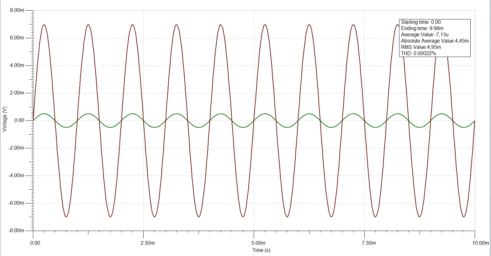

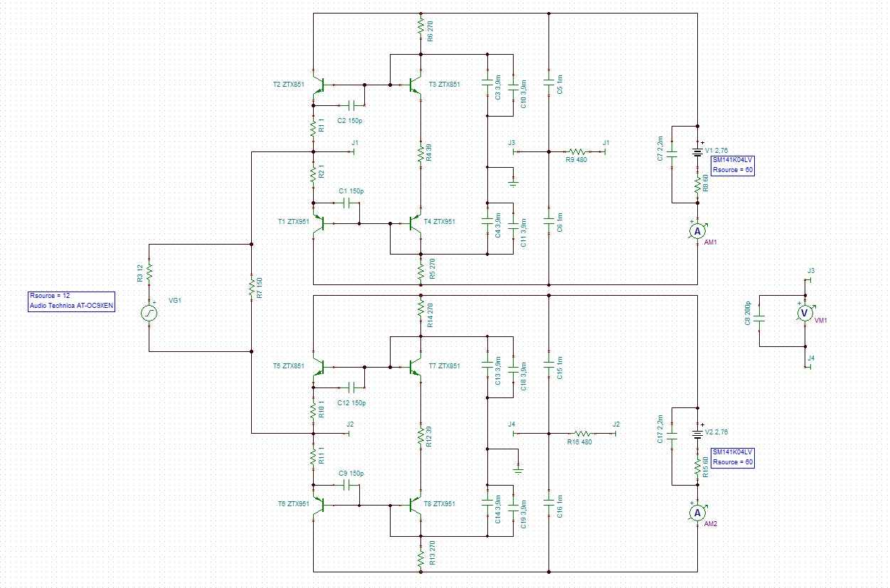

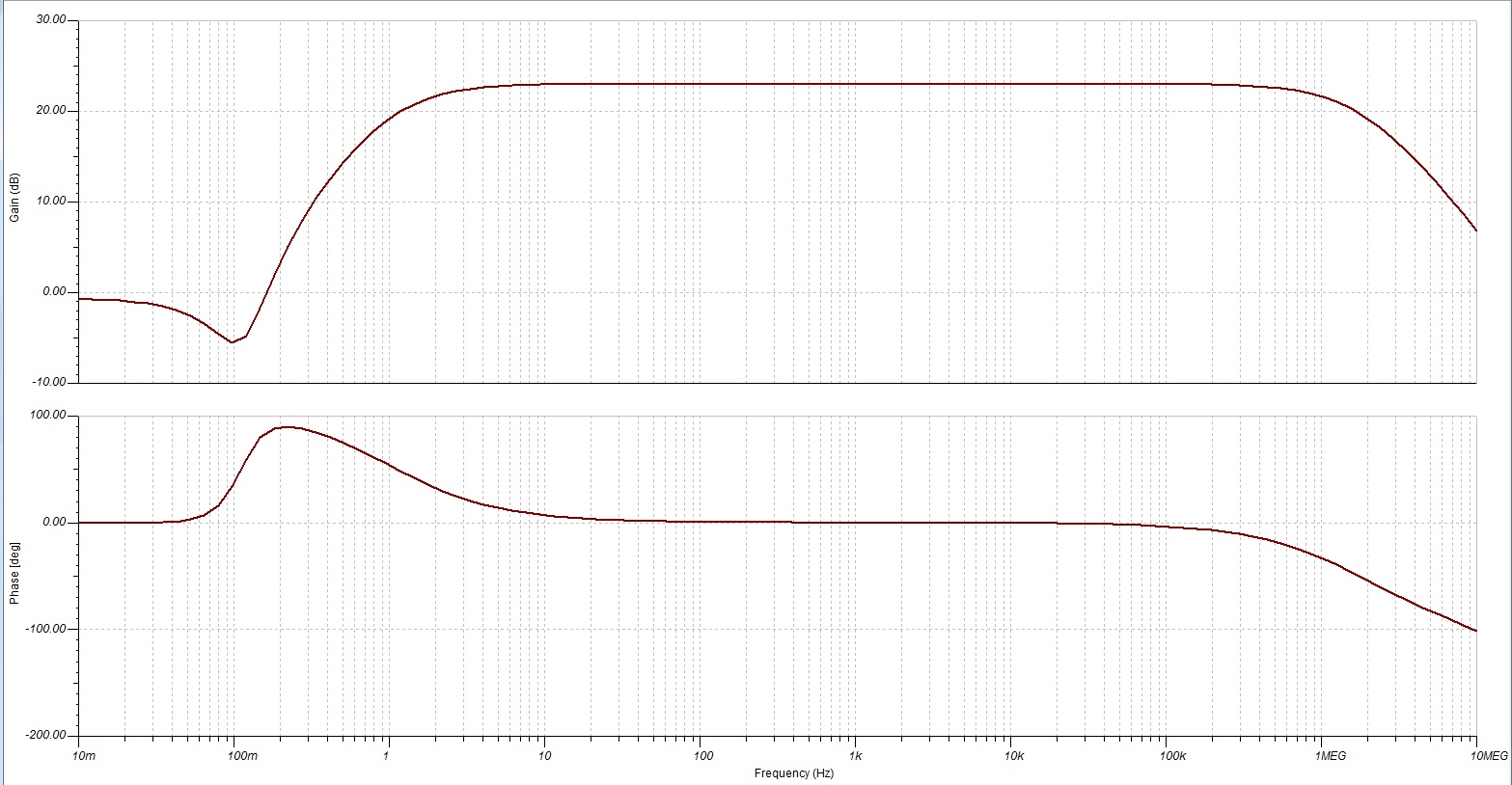

Hi guys,
I've read this whole thread, very very interesting stuff! I'm especially intrigued by the design in post #375 by syn08. No batteries is a major plus! Actually I used the gerbers provided to order some boards. Hopefully they will arrive in a couple of weeks.
I've modified the design slightly to provide more gain (23dB) and make it balanced, see attached schemetic.
The sims I did look promising, do you think it will work in real life this way?
Many thanks!
