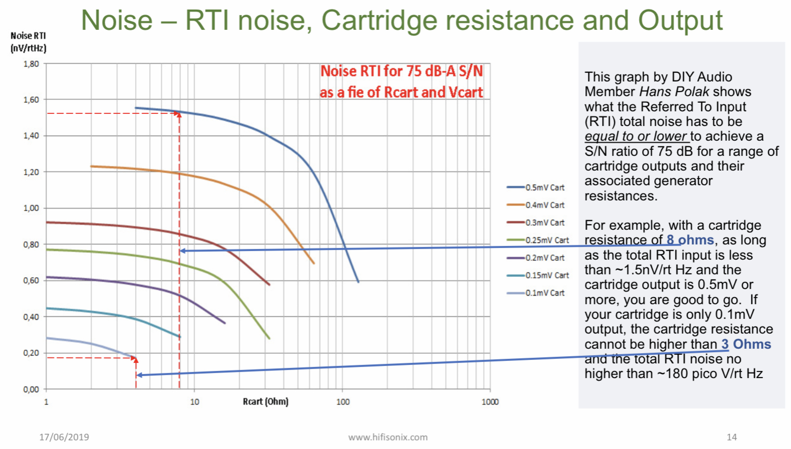

brianco's Kondo Io has a coil resistance of 1 ohm - in which case the 1 ohm tone arm wire resistance degrades the source noise by 6dB.
However, with an output voltage of 0.12mV there is certainly a discussion to be had about the best method of amplifying such a small output from a 1 ohm source R.
There is no argument that as the cartridge R increases, the 1 ohm wiring resistance becomes rapidly less of an issue.
Hans’ graph below gives a good overview

I'm not sure if this has been pointed out already in the depths of this thread, but for low coil resistance MC cartridges such as many of the the 2 ohm Ortofon SPU's, the tonearm wiring can be a significant additional source of noise.
On the assumption that the internal wiring of a typical 9" arm is 0.4 metres (measured from an old set of SME wires), and using published data, the loop resistance is:
Old SME leads, measured 1.1 ohms
VDH MSS7, from spec 1.07 ohms
VDH MC300S silver, from spec 0.19 ohms
Cardas 34AWG, from spec 0.68 ohms
Cardas 33AWG, from spec 0.54 ohms
Audio Note silver, from spec 2.3 ohms
Connections, if clean, should add about 10 milliohms per connection, adding maybe a further 40 milliohms loop resistance which should be added to the above numbers.
So for anything other than the VDH pure silver single strand, which is seriously not cheap, it is prudent to add roughly an ohm for the arm wiring and connections. The only affordable (whatever the definition of that is) sub-ohm tone arm wire is the Cardas AWG33 at 0.54 ohms loop R.
Craig
If a connection only adds 10 mOhm, why not use a thicker wire inside the armtube and graft on a proper thin wire just before the exit?
Using Cardas 33 guage only adds about half an ohm loop resistance, so even with a 1 ohm cartridge only adds 1.75dB to the source noise.
There is a secondary effect. If such a 1 ohm cartridge is feeding a typical 10 ohm load, the half ohm lead resistance leads to a potential divider effect, reducing the signal voltage at the input by -0.4dB. Under those specific conditions the effective source noise is degraded by 1.75 + 0.4, or ~2.1dB
Whether that is worth a hill of beans in a practical context is debateable. However fakeall's concept of thicker wires in the arm tub transitioning to much thinner ones in the region of the arm pivot is not at all a bad idea, in the admittedly extreme example of a ~1 ohm cartridge.
