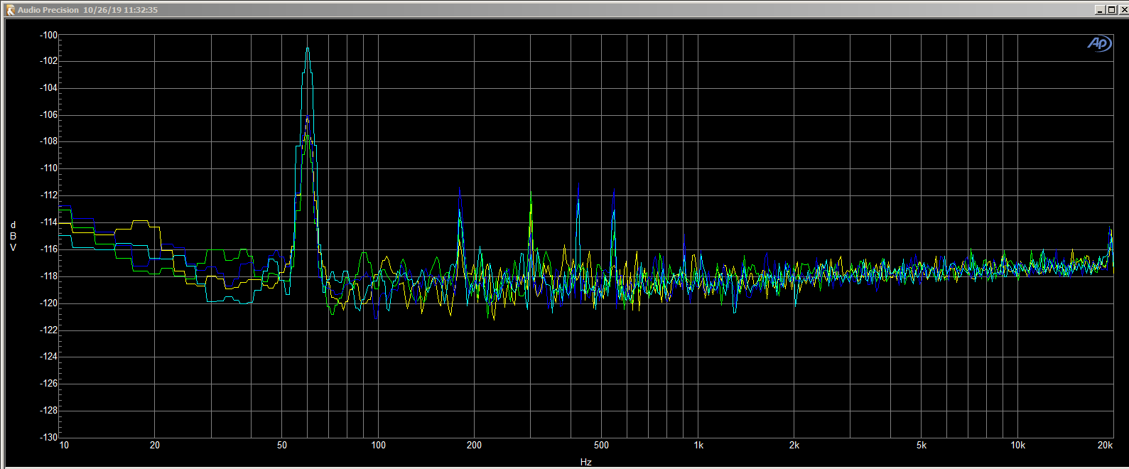

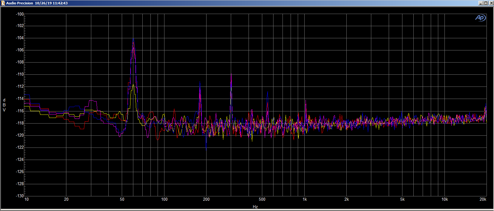

Dimitri, this is what I meant.

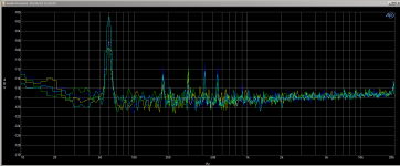

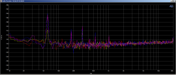

First set is for balanced connection, second set is for balanced connection with pin 1 lifted (measurement amp box is connected with PE). Scans were made within couple hours time period (fuse box and power entry to the house in 10 feet, heating system, washer/dryer switched on and off), cables and measurement box were fixed in the same position with 3M tape.
Sorry Hans, no improvement
Thank you for trying, this helps in building experience on the subject.
There is a slight improvement in the 60Hz component, but I agree this is not the sort of improvement that makes the difference I was hoping for.
Obviously you suffer from the same sort of magnetic induction as Syn08, so hopefully the mumetal box you have planned to use will make a difference.
Hans

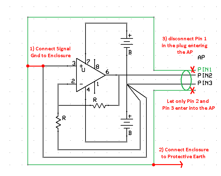

P.s. you did not mention it, but may I assume that you had the signal gnd connected to the enclosure ?
yes, i have
Thank you.
This brings me again to the question, in how far a true differential setup will make the difference.
With two equal halves, both equally oriented, magnetic induction will cause pollution of the same polarity and magnitude in those halves that can be removed in the Diff to SE conversion.
This must be one of the reasons why my spectra are so much cleaner.
Hans

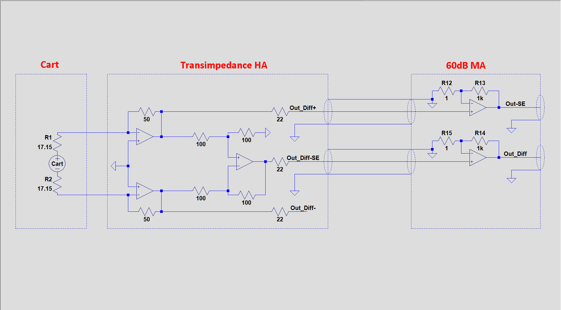

Wanting to satisfy my curiosity to what extent a Differential topology has the ability to suppress EMF radiation, I used the set-up in the image below with my MC cart connected, but also with a 1R short instead of the Cart.
The upper line is full SE and the other line fully Differential before being converted to SE.
The Diff to SE converter with high precision resistors has ca. 60dB CMRR.
Connection from HA to MA was through a RCA interlink cut in two 45cm halves, both open ends soldered to the HA.
RCA connectors at the other side plugged into the MA, thus giving exactly the same conditions for both lines.
MA connected to the scope with 2 equal 50R coax cables.
Now spectra generated through both topologies could be recorded simultaneously, taking into account that the SE line has 6dB less gain.
Electro Magnetic pollution was generated with a Power Drilling machine at relatively close distance to the to the HA. When increasing the distance to the HA, pollution decreased, showing that it was indeed EMF pollution.
What I measured with this relatively simple test, was a rejection of pollution of between 10dB and 15dB in favour of the Differential setup.
Hans

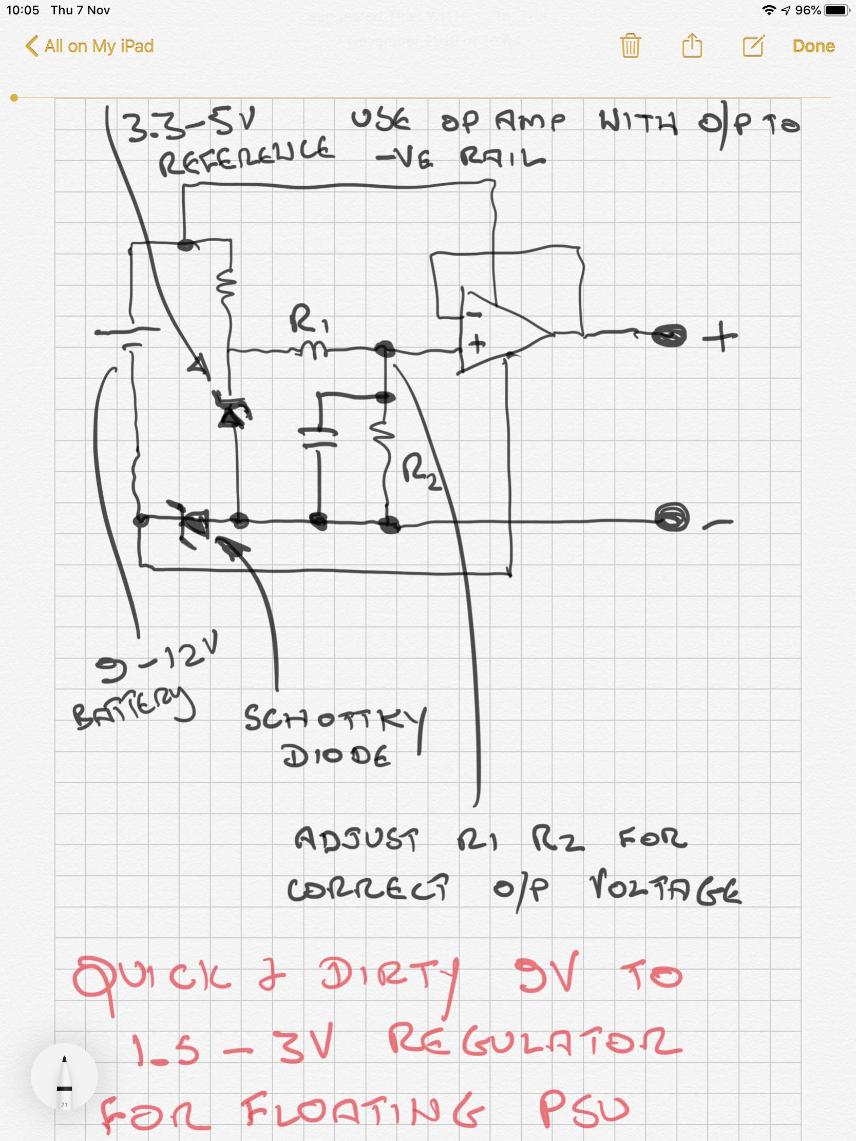

I’ve had one or two messages about powering the battery versions of the head amps off other than a 1.5 or 3 V battery.
Here is a circuit concept you can try. No details - you will need to do that yourself but I’m sure there are others here who can help with that.
Use an opamp with a common mode input range that includes the -ve rail. If not, use a Schottky diode in the opamp -ve rail as shown.
Make sure you mount the PSU and the battery in a shielded box to prevent capacitive coupling getting onto the PSU rails. Importantly, when the head amp is active, the battery charging circuit must be completely disconnected from the battery - use a switch that can break both the -ve and +ve rails between the charger and the battery (DPDT type).

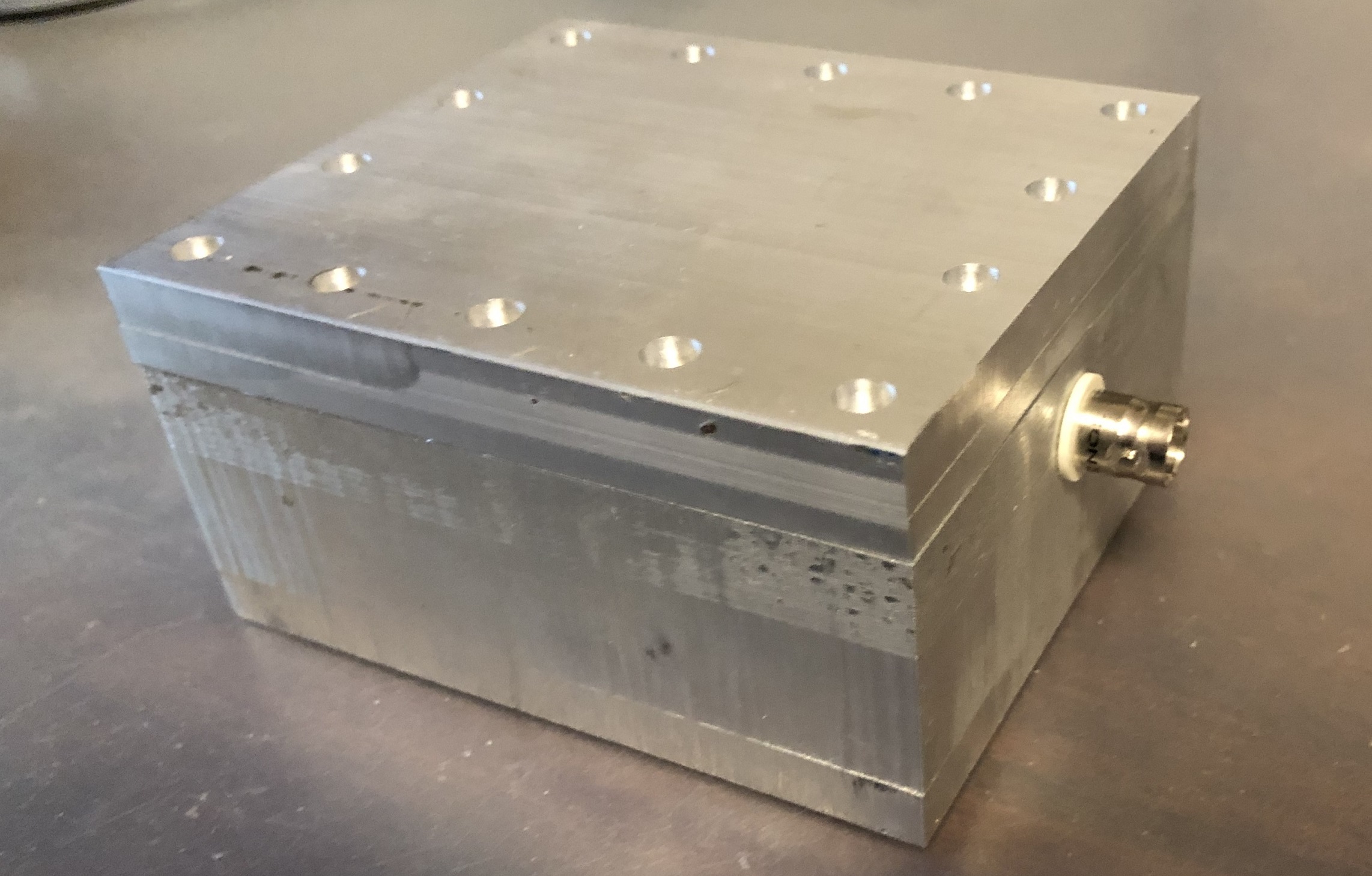

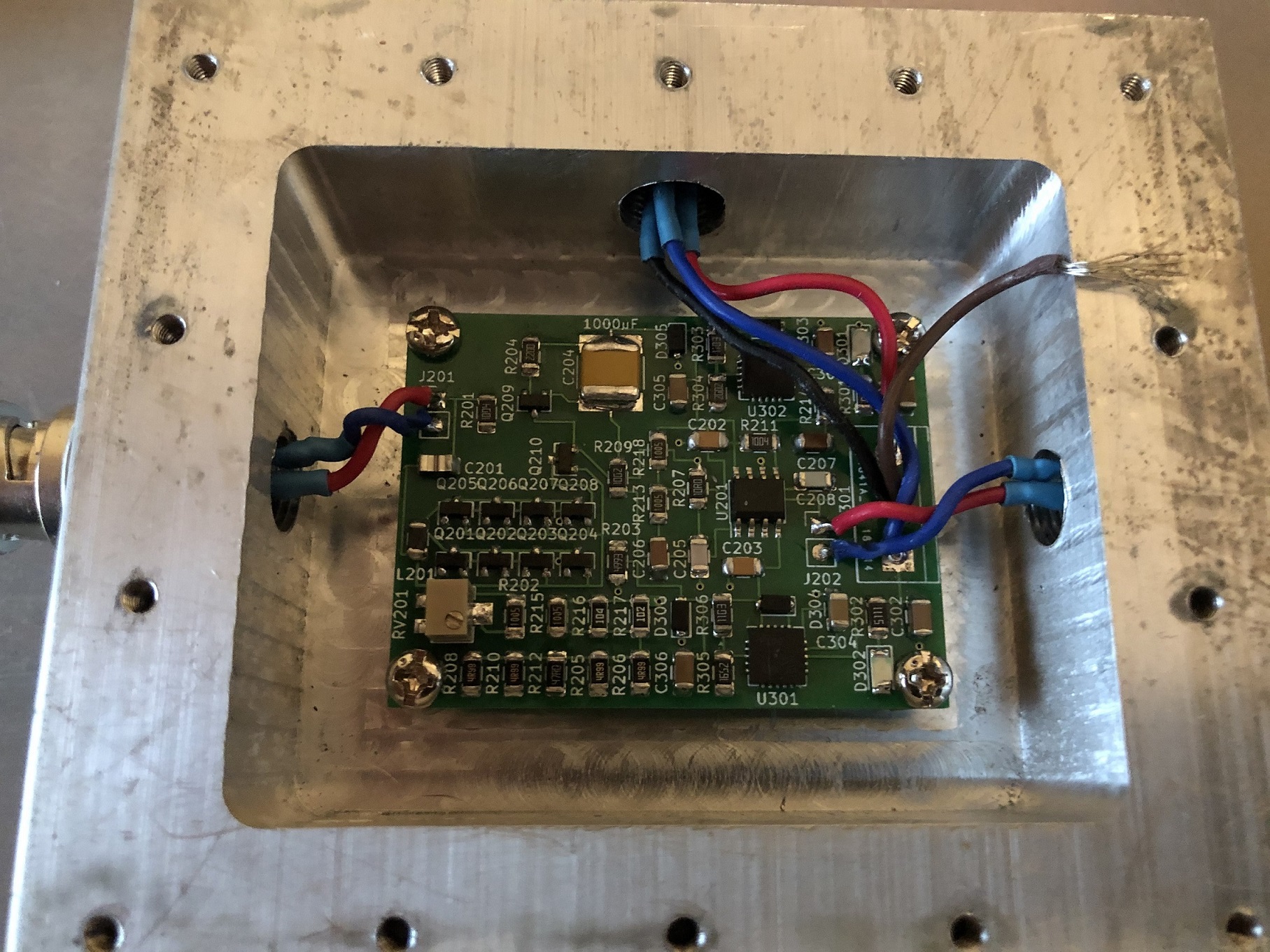

My latest low noise instrumentation amplifier.
- JFET based (8 in parallel, yes Gerhard, is rock solid stable :D)
- 0.3Hz to 1.8MHz 3dB bandwidth
- 60.02dB gain
- 0.42nV/rtHz
- 1/f noise corner frequency is 100-150Hz
- needs +/-12V, takes 16mA/10mA so can use batteries
- Onboard ultra low noise LDO regulators
- encased in an aluminum block, 20mm thick walls, 15mm thick lid, about half a kilo of metal
Noise plot is attached, Y scale is in nV/rtHz, X axis in Hz. Noise is higher than the previous version (0.32nV/rtHz) but this can be fed by 2 1.3Ah lead-acid cells. The 60Hz harmonic component is now at 1.5nV equivalent at the input, intermodulation products are still visible.
Can't do better in my allegedly EM polluted environment. Note that a cell phone or drill has absolutely no effect, the thick aluminum block shields perfectly everything that goes over 100Hz.
