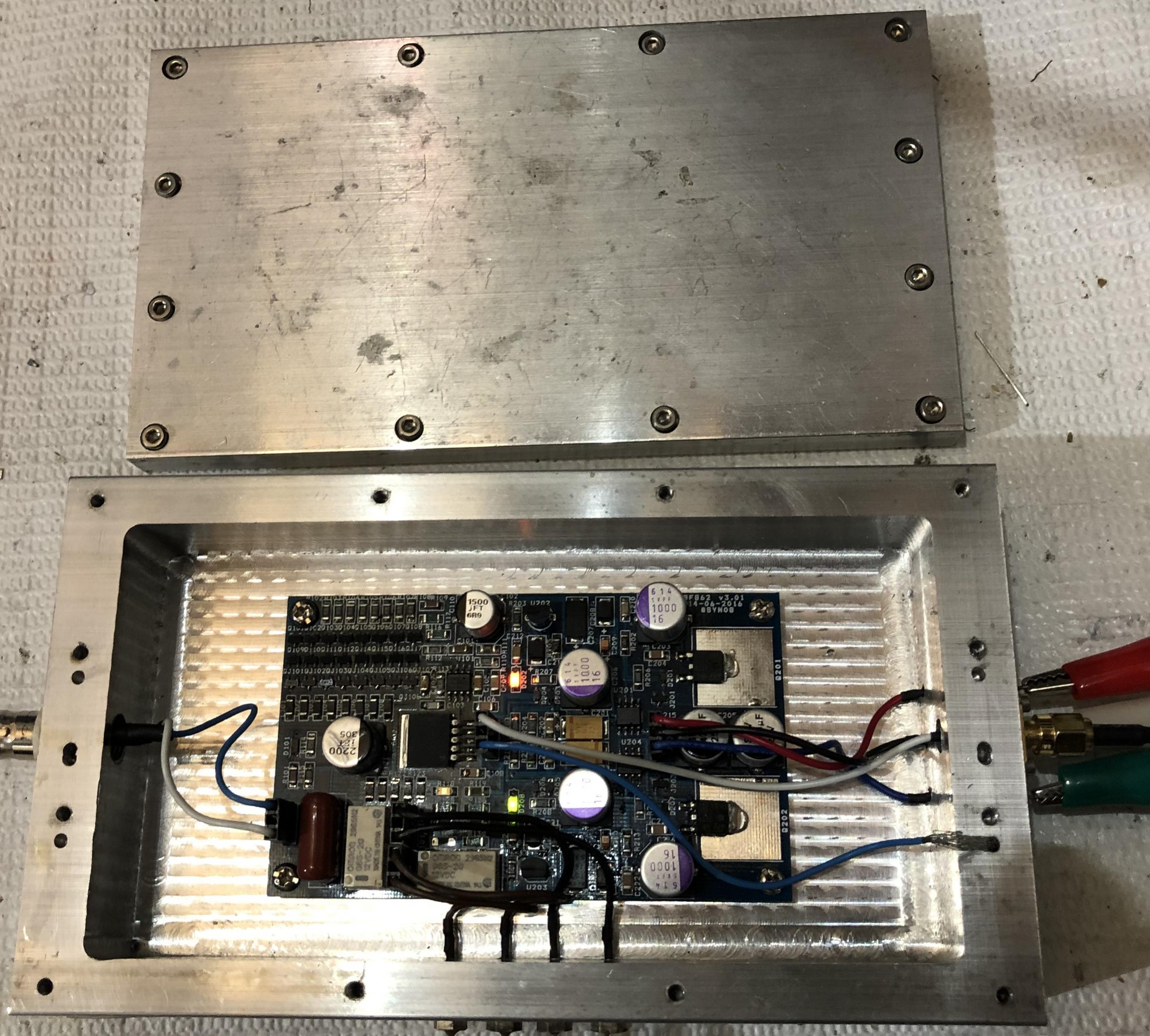

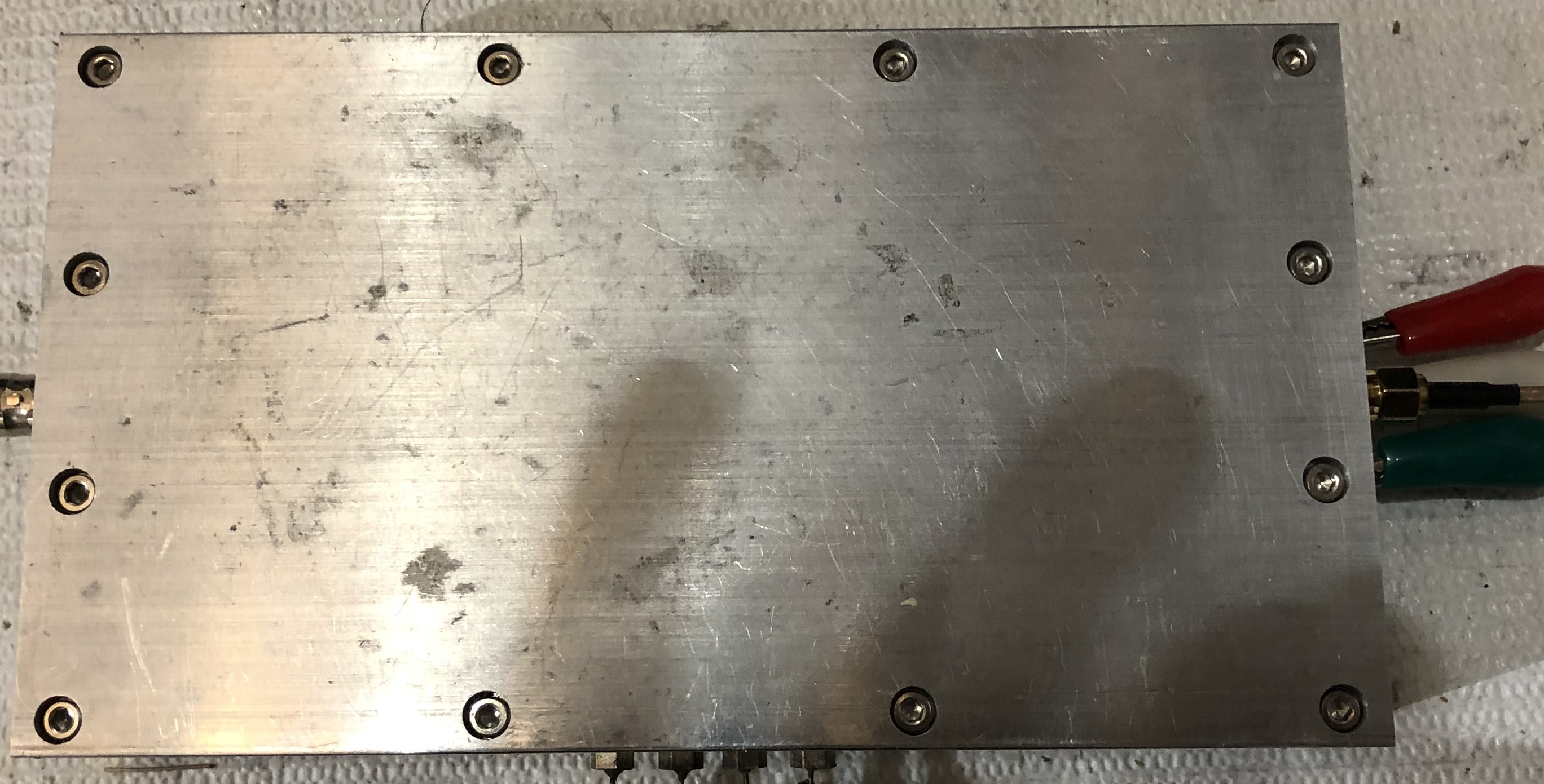

Aluminum is helpful for shielding the magnetic field, if you do like myself and mill a 12mm thick walls case out of a 2" thick of 6061 aluminum plate. That was the only way (called Faraday shielding) I was able to lower the mains harmonics to 2uV output, with a gain of 60dB (2nV input equivalent). With an identical SE setup (but with batteries), Hans and Groner got much less mains harmonics (invisible on the spectra) practically without any magnetic filed shielding to speak of.

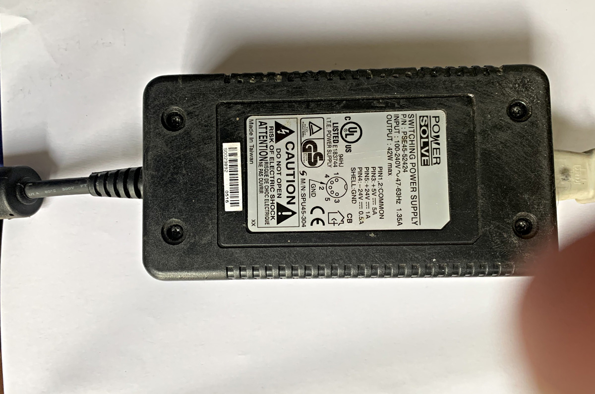

For what it's worth, here the noise spectrum of my MA when powered with a +/-24V SMPS, taken under exactly the same conditions as before:

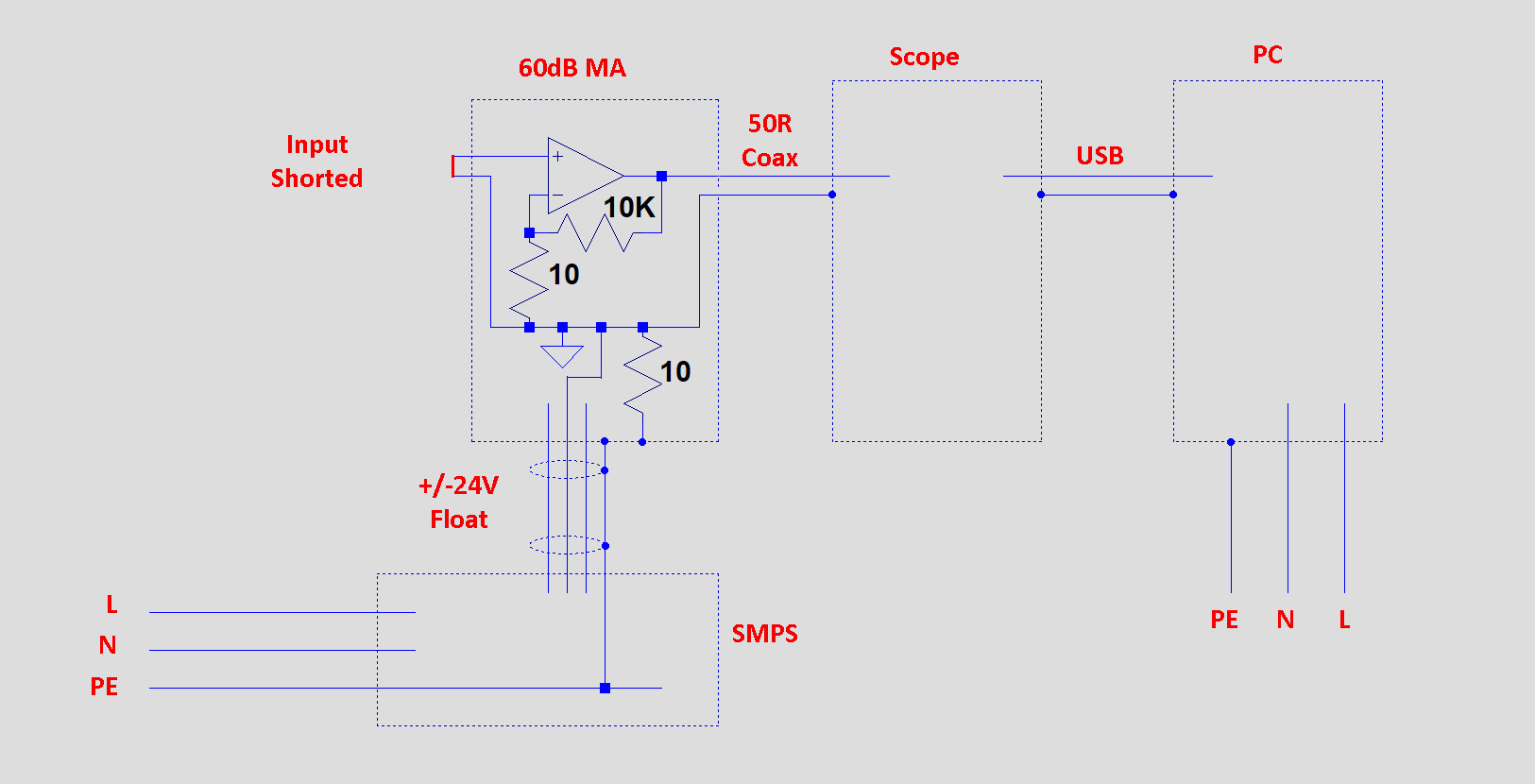

It might be even a bit more complex.Most probably, the SMPS creates a common mode hum signal on the power supply ground line. This ground is going into the MA and from there over the coax cable shield to the scope / spectrum analyzer. The resulting hum current creates the signal visible in the spectrum. This signal is independant from the regulators used - they do exactly what they should do by keeping V+ and V- rock solid referenced to the ground line. But it is the ground line which causes the hum problem. As soon as the amp is battery suplied, no hum current coming from mains is injected into the ground line and the resulting spectra are hum free.
On the primary side, the SMPS box is connected to PE.
Looking at the picture shows that the cable shielding and connector shell on the secondary side are also connected to PE, but the produced voltages are all floating.
This PE is connected to the MA's enclosure and to prevent gnd loops through a 10R resistor to the signal gnd.
The shield of the coax cable going to the scope is also directly connected to PE through the PC and in effect ties the MA's signal gnd to PE.
Since a picture tells more than a thousand words, I made the sketch below.

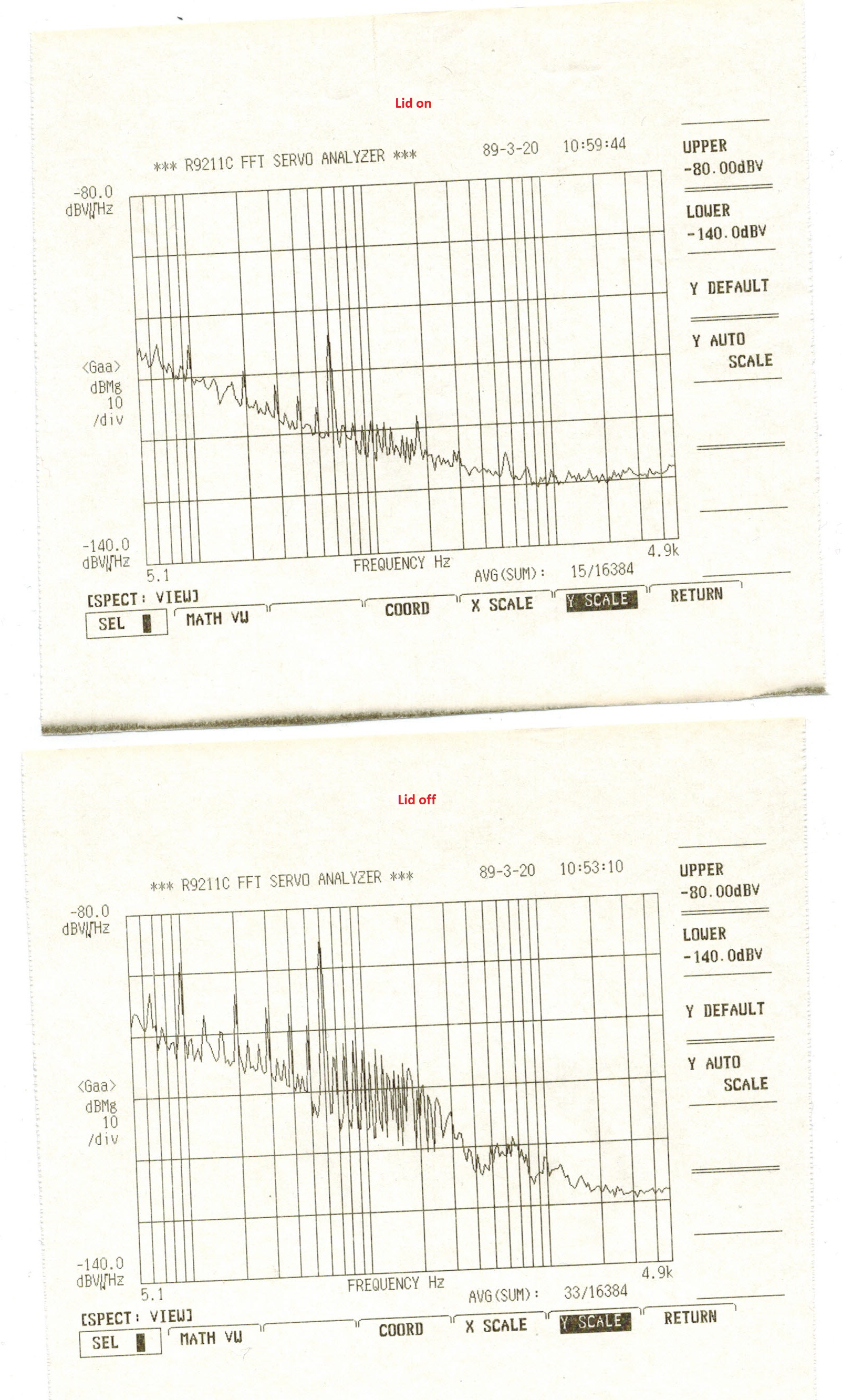

Below is the output of my MA (input shorted) with and without the lid to the heavy (12mm) shielding lid (photos also attached). Everything is exactly the same, measurements takes 5 minutes apart.
60Hz is 20dB higher with the lid off, plus tons of LF grass (likely mains harmonics intermodulation products).
Definitely a magnetic field effect. It's either my place is heavily polluted, or Hans and Groner live in one of those mumetal enclosures. I hope it is clear now why I believe batteries won't help.

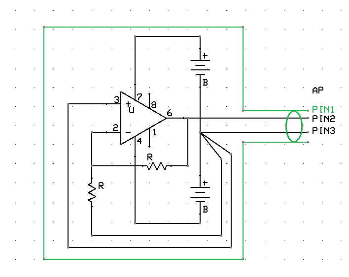

The input and output are SE, input shorted, balanced pair to AP comes from the preamp output and preamp ground. Enclosure is connected to pin 1 and has no connection to preamp ground. I made measurements with preamp ground connected to pin 1 and without - no difference.

At last some convincing facts for an SE MA amp that pollution in your case comes from the outside world.Below is the output of my MA (input shorted) with and without the lid to the heavy (12mm) shielding lid (photos also attached). Everything is exactly the same, measurements takes 5 minutes apart.
Since I am not living in a mumetal enclosure, conclusion can only be that you are living in a highly polluted area.
I'm living in a former farmhouse where the 5 nearest houses are 50 meters or more from my place with central electricity provision all around coming from under the ground.
No windmills or GSM transmitters nearby, so yes I can very well imagine that my place is relatively free from radiation.
Hans

With your battery powered MA, the enclosure is connected to PE via your cable's pin 1 on both sides through the AP chassis.
Not making a connection to signal gnd means that your MA is in fact floating.
I would prefer a situation where:
1) The MA's signal gnd is connected to the enclosure
2) The enclosure has its own connection to PE
3) And to prevent gnd loops, that the cable shielding starting at pin 1 from the MA, goes all the way to the AP, but is disconnected from pin 1 at the receiving side. Only the two balanced lines should enter the AP balanced input and nothing else.
That gave me the best possible reduction in mains pollution.

Made it myself, I have a CNC milling machine.
What loops, Hans? Are you suggesting to keep cable shield and MA box float?
That would be a very, very bad idea. Probably worse than no shielding at all.
