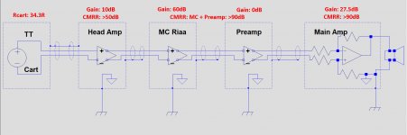

1) When first testing everything, isolated from my audio set, just Head Amp (HA) and 60dB measurement amp (MA), set up was as follows:
The 60dB SE MA was battery powered and driven from the HA's SE output.
The MA's output went to Scope+PC, the latter being connected to mains gnd.
(The MA powered from a wall wart gave lots of mains harmonics in the noise spectrum, most likely because the MA is not differential. That made the choice for batteries an easy one.)
So in effect, starting from the PC and through the Scope all signal grounds became connected to mains gnd with no possible gnd loop.
However when trying to additionally connecting the HA's signal gnd to mains gnd, the mains harmonics popped almost out of the screen, confirming the damage a gnd loop can do.
With the used setup, spectra from the 34dB Gain HA where clean with a 1R input resistor simulating the cart, for the Diff Current as well as for the Diff Voltage modules.
The spectra were clean with the Power Bank Battery and also with 2 different 5Watt USB mains adapters, and the Head Amp was not even encapsulated in an enclosure !
However with a 10Watt mains adapter several mains harmonics became visible.

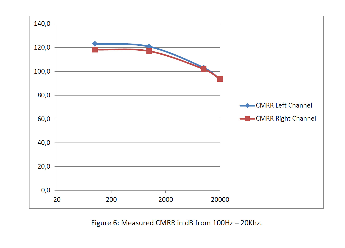

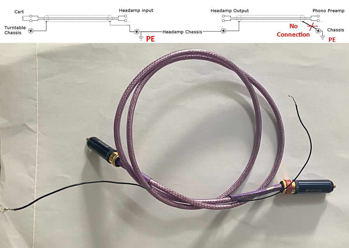

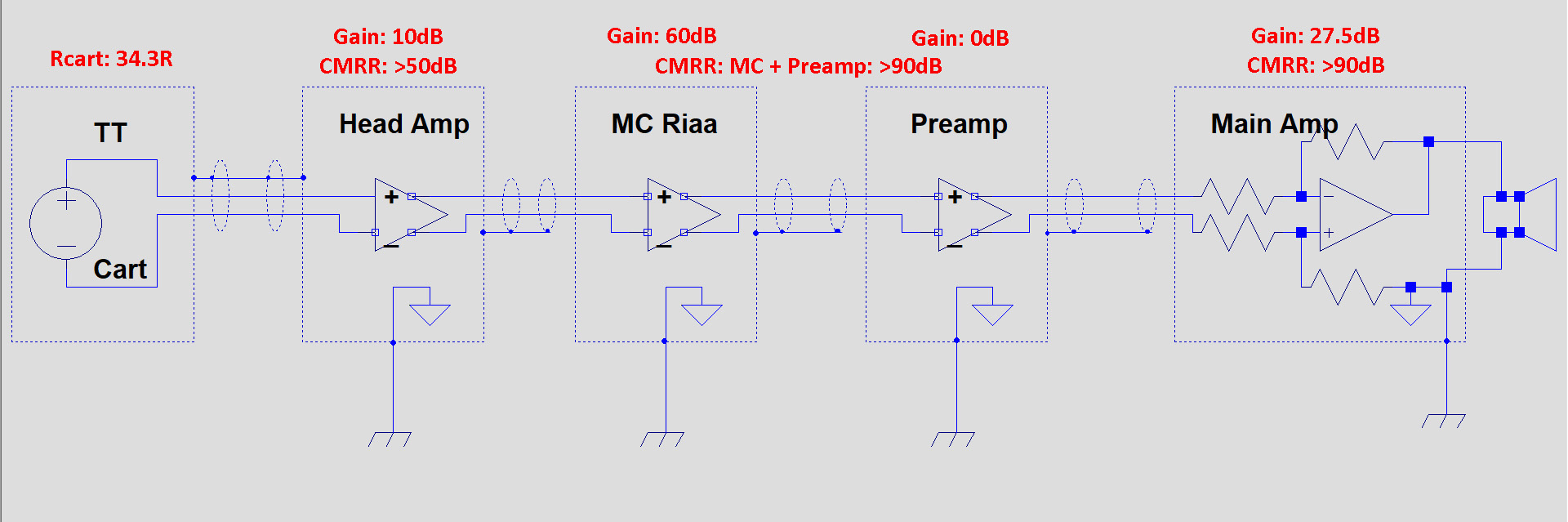

2) The next step whith HA tested as part of the Audio set, this time being differential/balanced from start to end and with the cart connected, I was already quite happy with the results, bus as shown a few postings before, I had forgotten to connect a cable shield that even completely removed the remaining 50Hz component after connection.
For convenience to keep things universal, I have used RCA interconnects between Cart/ HA and HA/MC phono amp, but in both cases with a shield that is detached from the connector, with separate wires to be connected to an enclosure.
See the first and second image below.
Some CMRR measurement results all three made from 20Hz to 20Khz.
- The HA's measured CMRR with closely selected components is above 50dB
- The third image below shows the CMRR of my diff MC phono amp in combination with the preamp behind.
- The Main Amps have a measured >90dB CMRR in the Audio band.
If you want some more details, I'll be happy to provide them.
Hans
P.S. Just as additional info: When not connecting the HA's signal gnd to PE makes no difference at all when using the Power Bank, but with the USB mains adapter mains harmonics are all over the place.
So the PE completely neutralises these mains harmonics.

I did not mention PSRR but CMRR.How did you cleanly measure 120dB of PSRR? I'm aware of the usual PSRR measurement techniques, but in practice that's another thing that I was never able to do.
Testing the CMRR was done the “simple way” by connecting a signal generator’s signal between the short-circuited inputs and signal gnd.
Measured results do conform perfectly well to fig 12 in the AD797’s specs.
Scott did an excellent job with the design of this op-amp.
Hans

-Unshielded HA on mouse pad, powered from 5W USB adapter having no direct connection with signal gnd (called Null here), see second image below.
-HA diff input terminated with 1R resistor, no cable connected at this side
-connection between HA and MA with 60cm Siltech FTM4 Gold cable with WBT RCA connectors, driven from HA's Diff to SE converter.
-Connection between MA and scope a 60cm 50R coax cable.
Picture is still with the Nichicons that were later replaced by Panasonics FM.

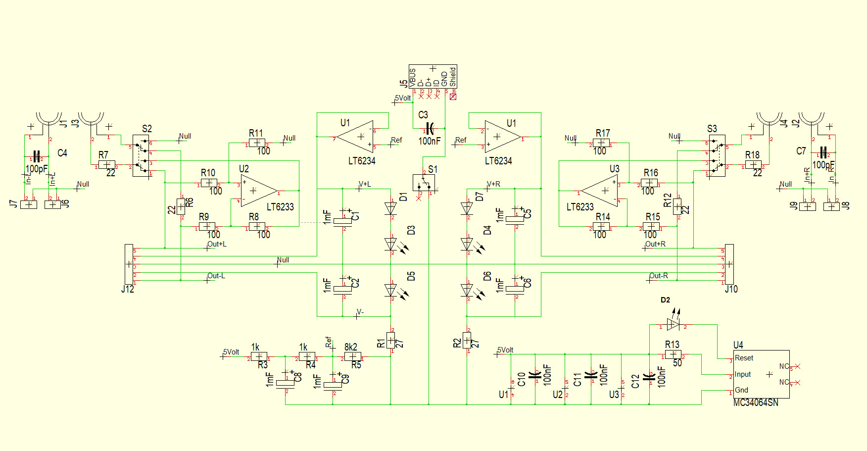

- Analogue Source
- Richard Lee's Ultra low Noise MC Head Amp
