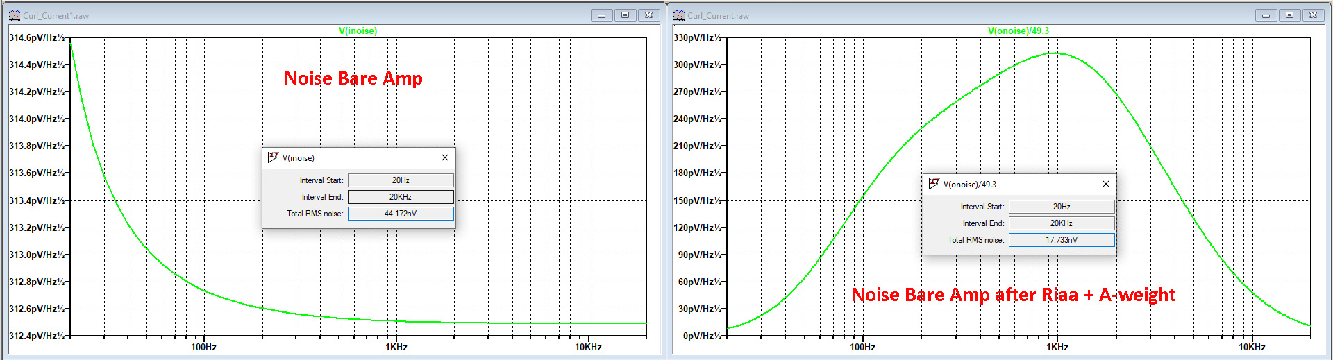

in posting #1576, Richard Lee's Ultra low Noise MC Head Amp, I calculated the equivalent input resistance to be 3.5R based on a measured noise of -191,2dBV.
The calculation itself was correct, but the measurement can't be correct, because this is beyond what's physically possible.
When measuring a sine wave of known amplitude, the FFT is exact, but for noise, for whatever reason, the outcome is too optimistic.
Could this be the averaging proces or the used window, I have no idea.
But careful calculating gave -189.4dBV as the noise level for the ZTX devices with an Rb of resp 1.2R & 1.5R, or 1.8dB above my measurement.
That would result in a noise for the Bare Amp module of 312pV/rtHz.
The equivalent input resistance in that case would be 5.8R instead of 3.5R.
On the other hand, the more important figure is input noise after Riaa and after A-Weighting.
So without taking into account the noise contribution of the equipment behind the Head Amp, this 312pV/rtHz becomes 126pV/rtHz after Riaa and A-weighting, see images below.
This 126pV/rtHz equivalent input noise, is an equivalent input resistor of 0.95R when using the Amp for LP playback!!

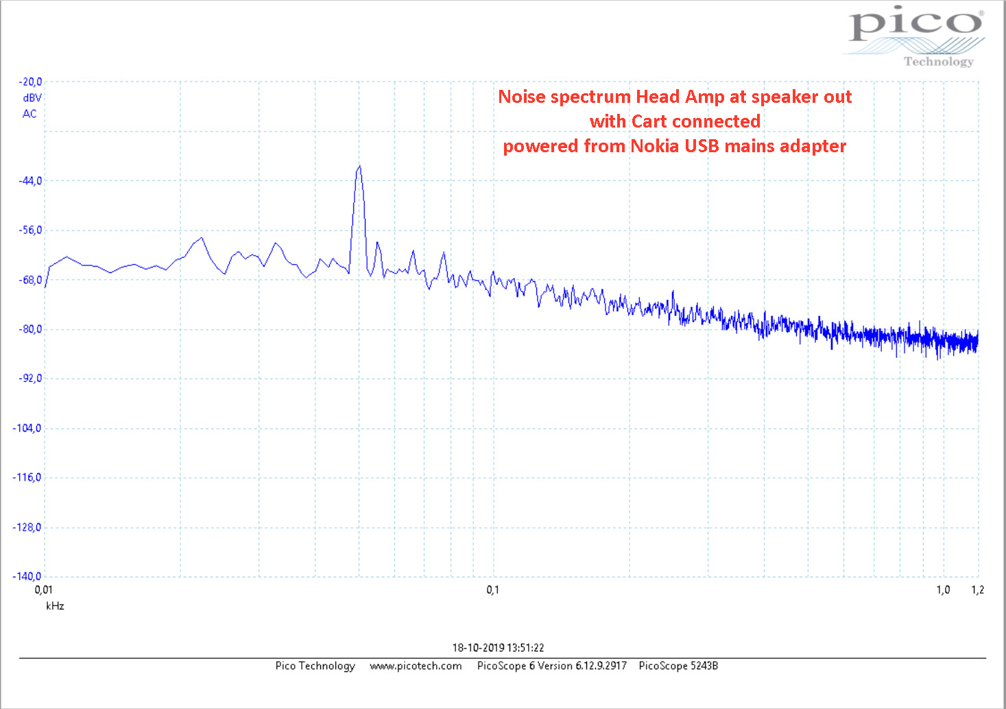

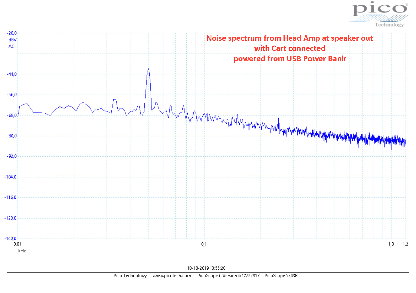

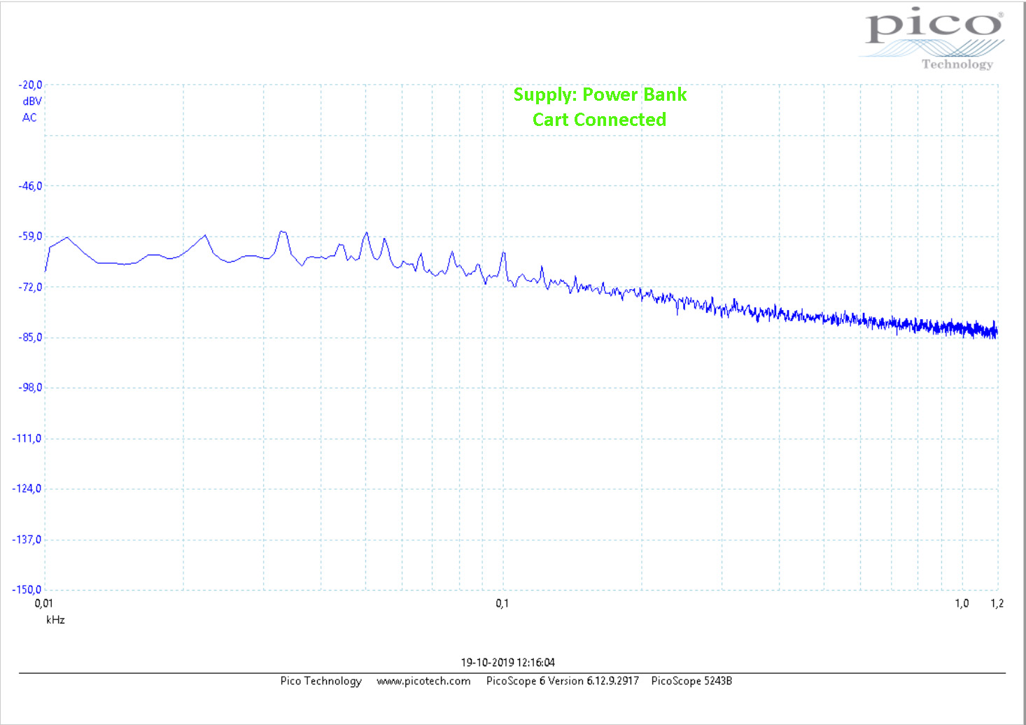

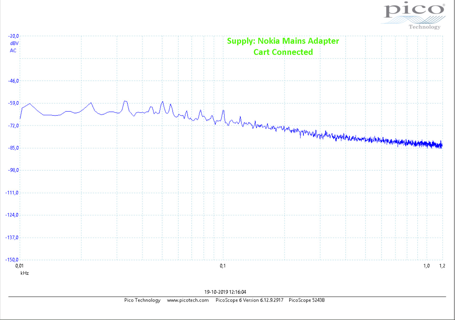

This time the Head Amp as being part of the whole audio chain, I was curious what difference it made to the noise spectrum when powering the Head Amp from either a Power Bank or from a USB mains adapter.
The two images below show the results of the measurements, with absolutely no significant difference.

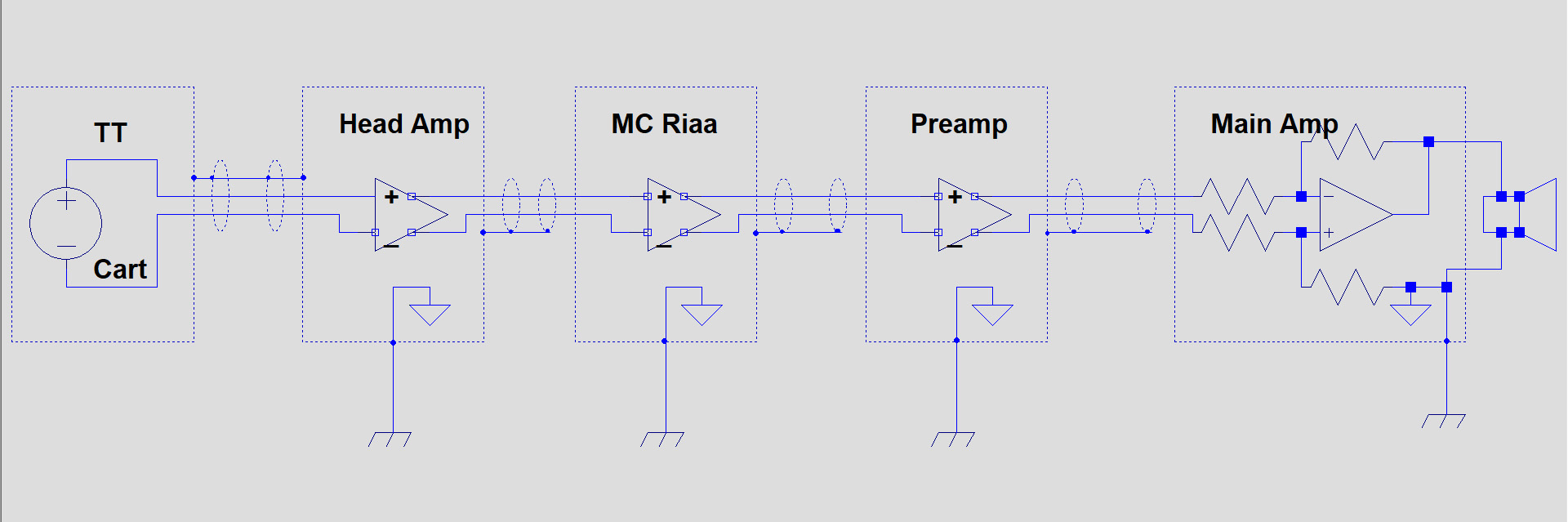

Inter connections of equipment shown in the third image.
Hans
Hans
I was so euphoric yesterday by the nice results of the noise spectra with the cart connected, that I forgot to check all connections.
This morning I realised that I had forgotten to connect one (isolated) cable shield going to mains gnd.
After having corrected this, I did the spectra again, and this time even the 50Hz pollution is no longer there.
Hans

You get the voltage noise density like this:
e_n = 1 V * 10^(dBV_displayed/20) / √(bin_width)
For -191.2 dBV in 0.9313 Hz, this gives me 0.285 nV/sqrt(Hz).
Assuming, of course, the machine isn't so smartelligent that it already performs this calculation - playing with FFT length while observing noise floor should clear that up.
Anyway, this voltage noise density gives me pretty much exactly 5 ohms @ 295 K, so it looks like your calculation was off after all.
Thank you for your respons and I fully agree.The only thing that could cause such an issue would be an effective FFT length that is higher than displayed, maybe by a factor of 2. Sure enough, they've got 2097148 samples but 1048576 bins, so #bins = N/2.
I got 4.5R instead of 4.9R because I didn't care to correct for the slightly smaller bin width.
The -191.2 nV/rtHz was measured including a 1R resistor simulating Rcart, so this value had still to be subtracted from my calculated 4.5R to get the noise for the Bare Amp giving the 3.5R.Anyway, this voltage noise density gives me pretty much exactly 5 ohms @ 295 K, so it looks like your calculation was off after all.
One other thing that was also taken into account: without a bandwidth limiting filter, noise may fold back when Fs is too low, resulting in an incorrect higher noise reading.
The 60dB flat amplifier that was used between Head Amp and Scope, has a -3dB bandwidth of 1Mhz. That was exactly the reason to use a 2Mhz sampling rate to prevent any possible folding back.
But as said, when offering a pure Sine wave, reading on my scope is correct, but for some reason noise is too low even when correcting the 0.3dB for the 0.93Hz bin width.
To check my results, I simulated the circuit with 1) generic noise free transistors, 2) with ZTX transistors having an Rb of only resp. 0.12R & 0.15R and 3) with the 1.2R & 1.5R that H&H has measured.
Noise for the Bare Amp in these 3 cases was resp. calculated as:
1) 268nV/rtHz
2) 277nV/rtHz
3) 312nV/rtHz
Using the above correctly calculated (4.9-1)=3.9R would have been 255nV/rtHz, below the 268nV/rtHz of noise-free NPN and NPN transistors, which is of course impossible.
That's why I corrected to 312nV/rtHz or 5.8R for the Bare Amp.

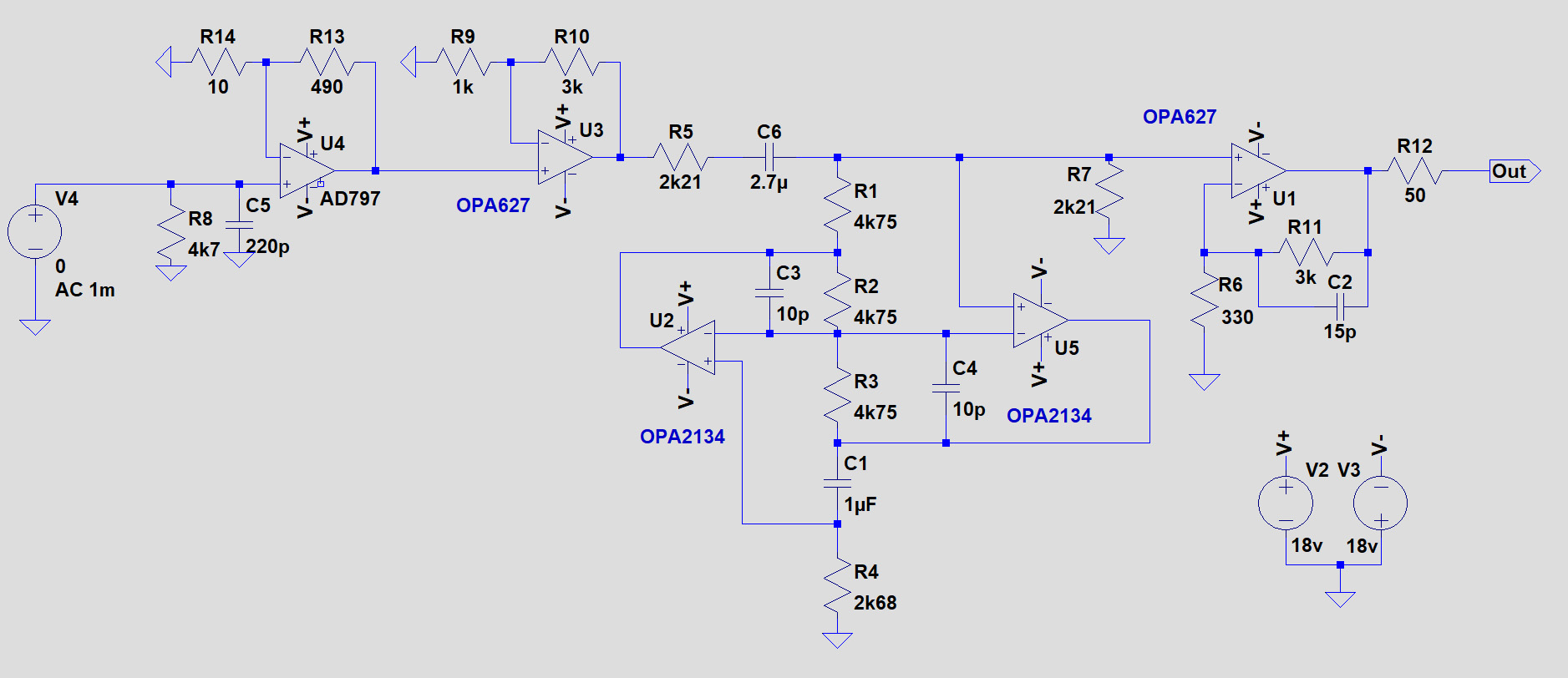

What LNA is this? With 1GHz GBW, it looks like a very impressive implementation. My best 60dB +/-0.2dB LNA with 0.35nV/rtHz never went over 200MHz GBW (-3dB @ 200KHz)
This one has 1nV/rtHz, a -3dB BW from 20Hz to 1Mhz and 1Ghz GBW.What LNA is this? With 1GHz GBW, it looks like a very impressive implementation. My best 60dB +/-0.2dB LNA with 0.35nV/rtHz never went over 200MHz GBW (-3dB @ 200KHz)
In #1549 I have shown the measured spectrum up to 1Khz, in this case divided by 34dB to show how much its noise contribution was below the 34dB Head Amp under development.
Also shown in this link is the transfer curve as measured with my VNA.

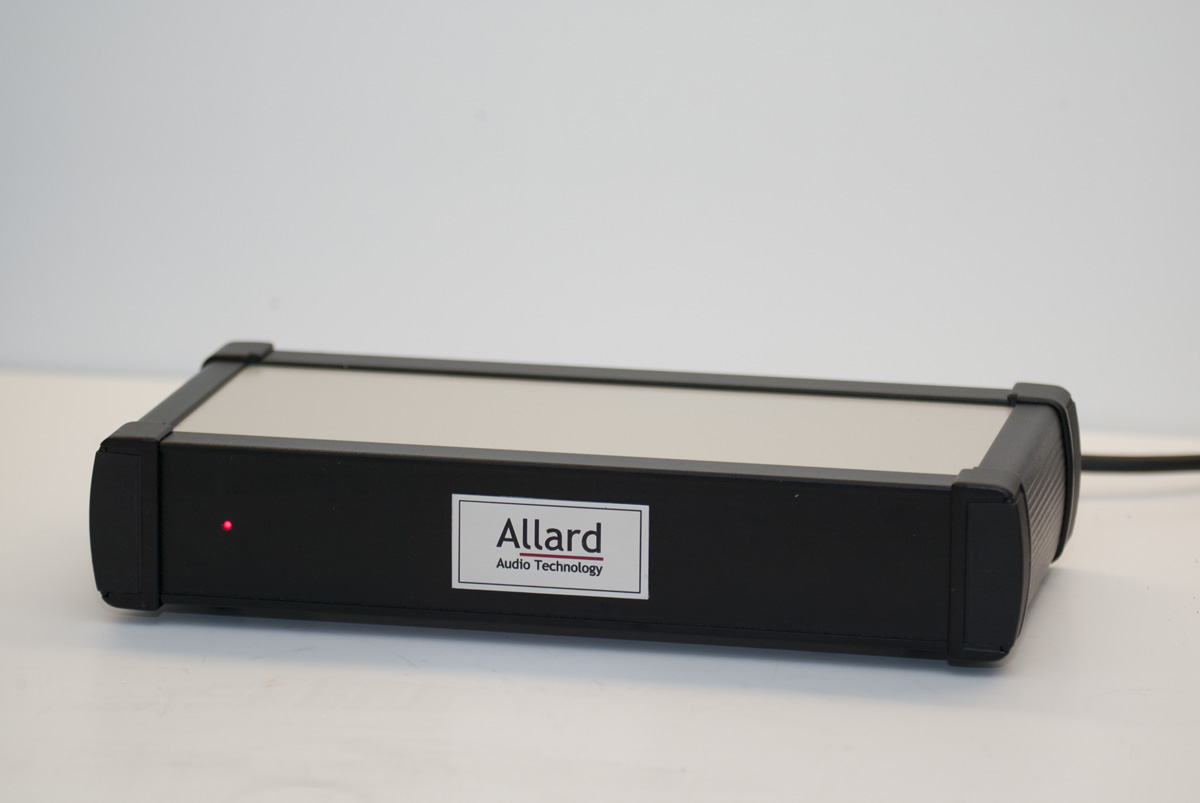

Schematic diagram and picture below.
Allard is my second forename, that's where Allard Audio comes from.
Hans

Ah, three gain stages, 60dB gain is distributed, so it is not really a 1GHz GBW since halving the gain doesn’t double the BW (and unity gain bandwidth is far from 1GHz, more like 16MHz the OPA627 GBW).

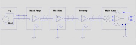

I've hesitated asking this question as I know I'm missing something obvious I used to know and will feel even more of an idiot than usual when I am told. Your interconnection scheme is basically as advocated by Whitlock, but he uses an RF coupling capacitor between shield far end and chassis. And I understand this for the case of mains powered equipment with PE connection. But for when the headamp is either battery or DI wall wart connected is this actually a benefit over just grounding at the far end?
Let me give it a try.
When both enclosures are connected to PE, a coupling capacitor at the far end may be used to suppress RF because the shield could act as an antenna. Although quite possible, I have never experienced any problem without this cap with a GSM or radio transmitter near the cable, so I never apply this somewhat complex cap.
Now for equipment fed from Battery or a wall wart, the interconnect shielding could very well be connected at both ends to the the enclosures, but in case of the very sensible Head Amp, I have chosen not to do, but to give it its own direct PE connection because the wall wart is producing quite some pollution that I didn’t want it to be injected in the next stage.
Without this PE connection to the Head Amp, the wall wart causes an enormous amount of very strong mains harmonics in the spectrum, so these guys are producing quite some dirt. But as shown in the above spectra, with the PE connected to the Head Amp’s analog gnd, in this very case the noise spectrum is as clean as with a battery (Power Bank)
Hans
