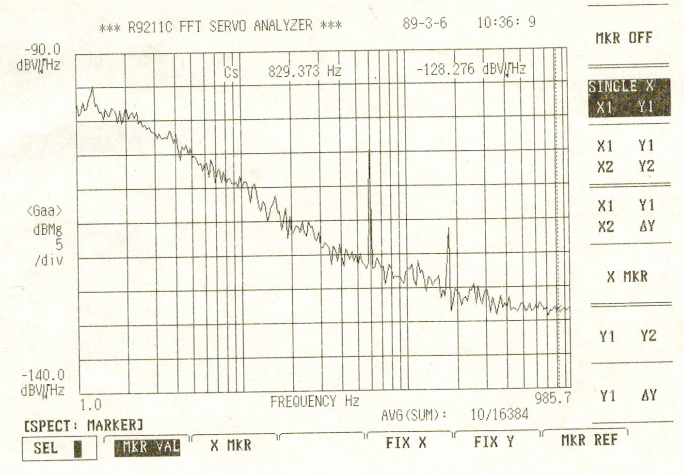

I have some ZTX from the same purchase batch that have the noise corner frequencies of 60-70Hz (I can post the measurements if anybody is interested), that is 5 times of what seems to be the best (12-15Hz). Not that for low noise audio it matters... but when you are selling "low noise transistors" that doesn't mean "low noise for audio transistors". There's a low noise world beyond audio applications, seismology comes to mind.

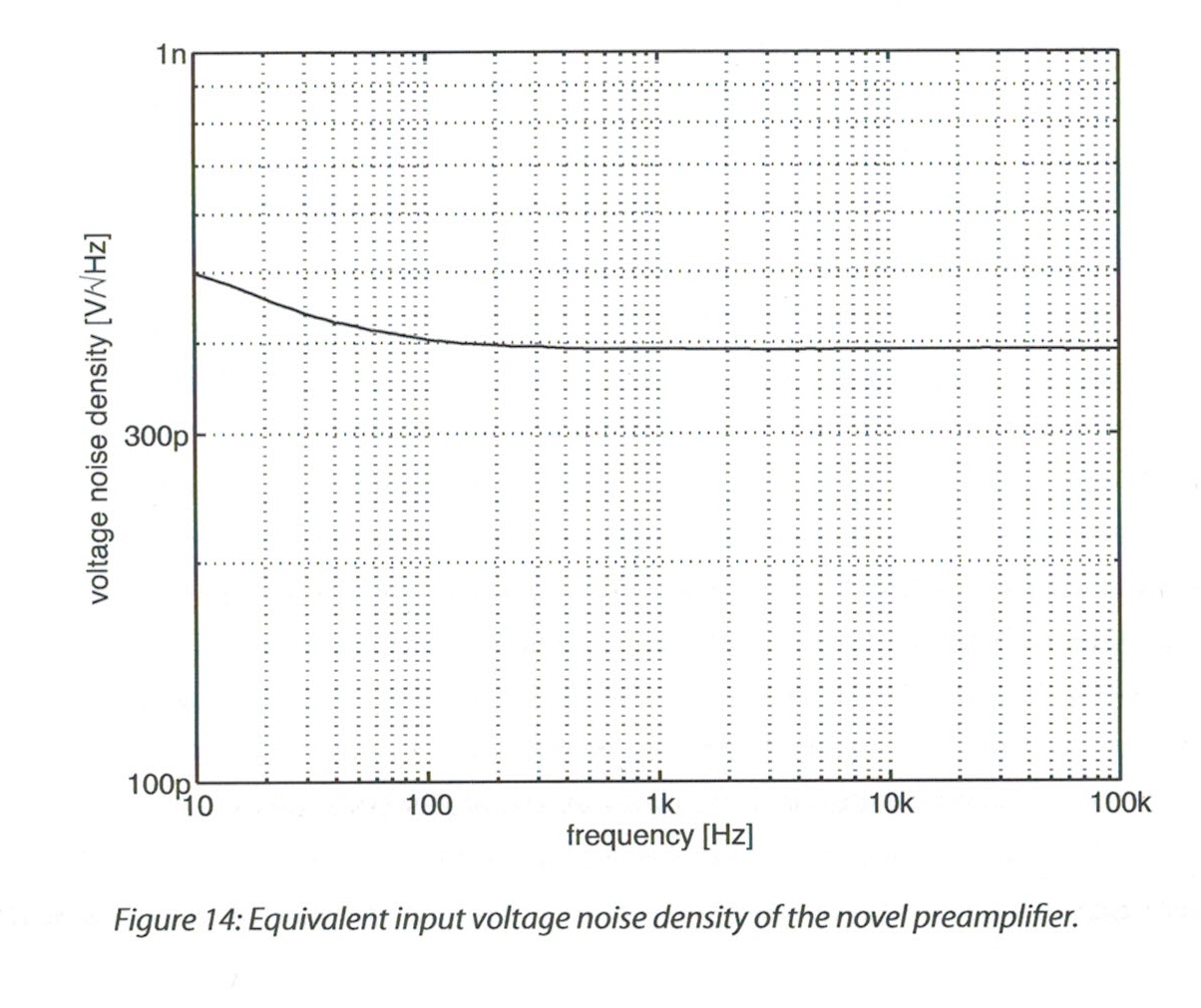

For reference, here's my measurement amp noise used all along here. 8xjfet (those that Gerhard assumes are oscillating 😛) deliver 0.36nV/rtHz flat, with a noise corner frequency of 150-200Hz and 3.5nV/rtHz @10Hz. LF noise has about 17dB/decade, suggesting the LF noise is 1/f plus some GR noise (and possible other LF noise mechanisms). Gain is selectable between 40dB and 60dB (measured 39.8dB and 60.2dB), 60dB shown below. After shielding in half an inch of aluminum, the 60Hz hum at the output is about 6uV, or about 6nV input referred.
I am still waiting (without holding my breath) for Samuel Groner to explain how he got 0.5nV/rtHz @10Hz with the same 8 jfets, and a noise corner frequency of 50-60Hz, without a trace of hum contamination (attached). And that without even sorting the jfets.

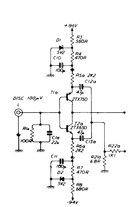

QUAD used the zetex transistors in their model 34 and 44 preamplifier MC amps, so I would assume they had good noise performance.

Looking at the datasheets, the mentioned ZTX690/790 seem to be similar to 650/750 (same current capability-medium power), but with remarkably higher Beta.
Has anyone tested those wrt noise/rbb?
And they were not scared of a little cartridge DC current.
