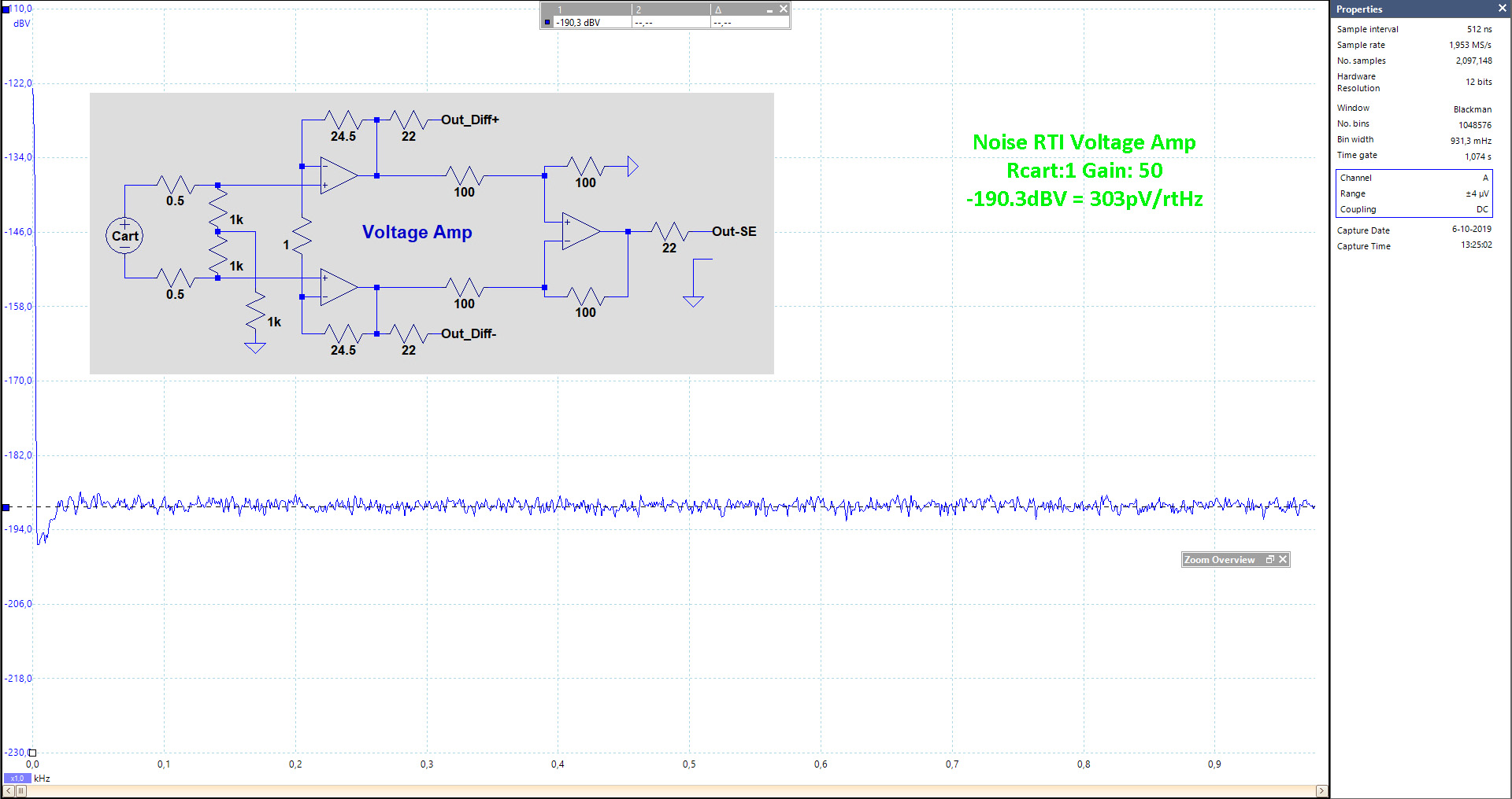

In posting #1569 the Voltage Amp's noise spectrum was shown, supplied by a Power Bank Battery. This time the image below is showing the noise spectrum of the Current Amp, while fed by a 5Watt Nokia USB mains adapter. To my feeling this probably shows quite well the effectiveness of the used on board supply regulator around the LT6203.
When subtracting the noise produced by Rcart=1R from the total noise of 275pV/rtHz, this results in 242pV/rtHz = (275^2 - 129^2), for the bare Amp Module. This is the equivalent to a 3.5R resistor.
When doing the same calculation for the Voltage Amp in #1569 with Rcart=1R, Rs=1R and a total noise of 303pV/rtHz, the result is the same 242pV/rtHz = (303^2 - 2*129^2) for the bare Amp Module, confirming the consistency of the results.

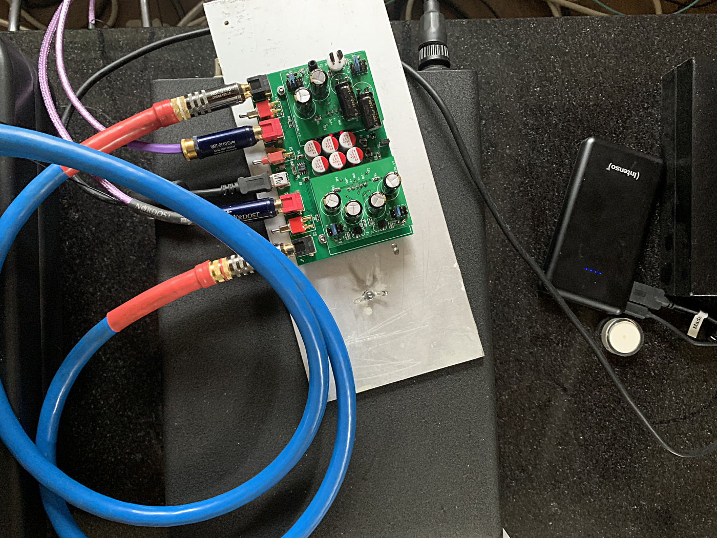

At last the thing is playing and is dead silent as expected. Will soon report if any differences can be heard between the Current and Voltage topology.
Hans

The Head Amp set to a gain of 15dB is between my TT and the MC preamp having a gain of 60dB.
Compared to my CD player the PU was producing quite a bit less output.
Now they are about equal.
Hans
