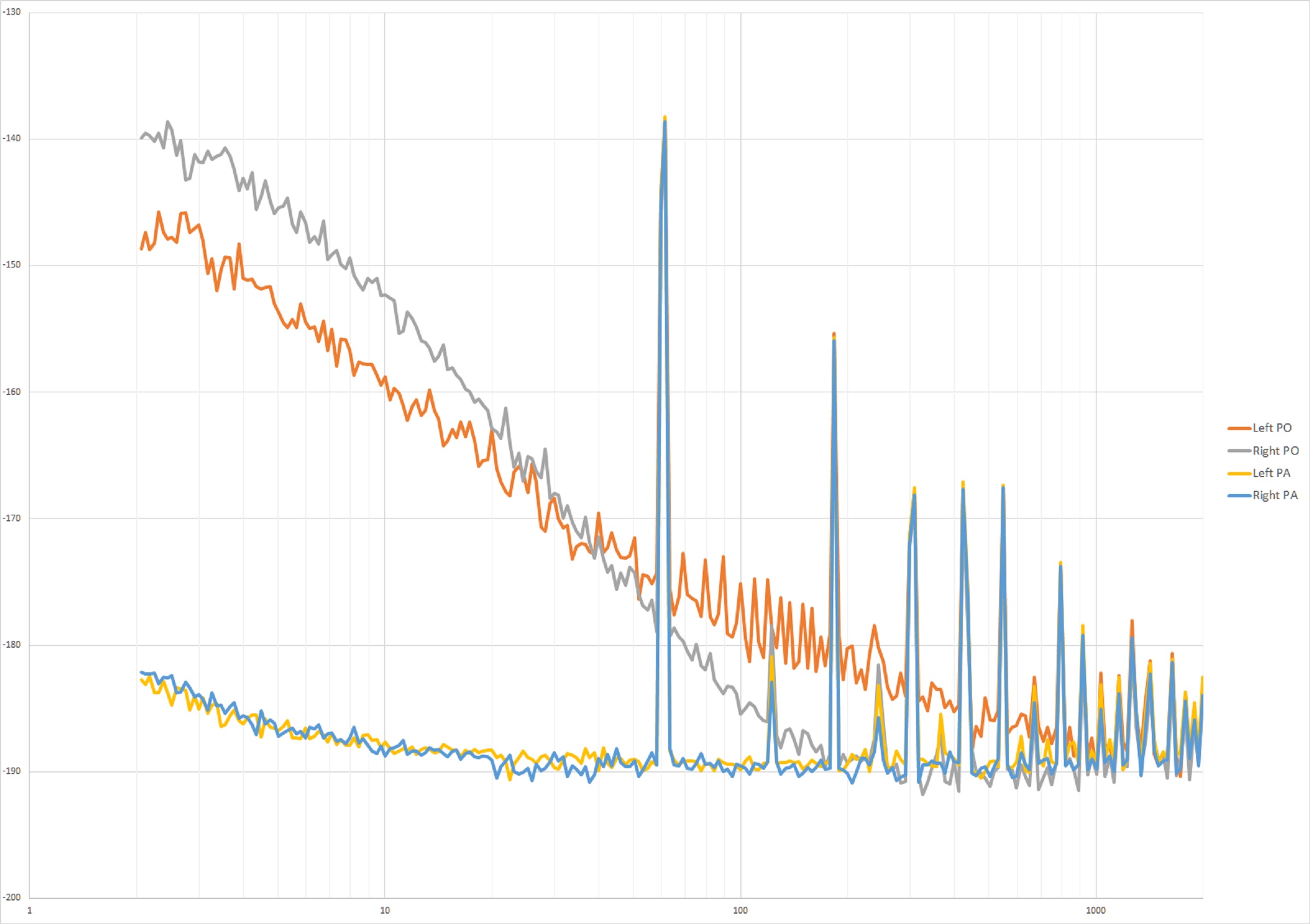

Indeed, the Aluminum Polymer caps are worse than regular, good quality electrolytics.
I took a #375, installed sockets for the 7 caps and swapped lots of Al polymer and electrolytics, measured the noise input shorted. Attached is the result, the regular electrolytics (type below) and the worst of the Al polymer devices I was able to get. These Al polymer are all over the place regarding noise (both in noise level and corner frequency), they can be as good as the regular electrolytics, but are certainly much worse on average.
Fortunately regular Panasonic electrolytics are available to replace directly the Al polymer in the $375 layout:
4xdecoupling: 3300uF/6.3V ECA-0JHG332 DigiKey P5511-ND
1xpower supply: 2200uF/6.3V ECA-0JHG222 DigiKey P5510-ND
2xoutput 1000uF/6.3V ECA-0JHG102 DigiKey P5509-ND
However, this is an interesting engineering exercise only, the excess LF noise was not audible (I tried hard).
The ZTX devices have a noise corner frequency around 12-15Hz, which makes sense.
With the Panasonic electrolytics, the noise of #375 (input shorted) is around 0.3nV/rtHz, down to 20Hz.

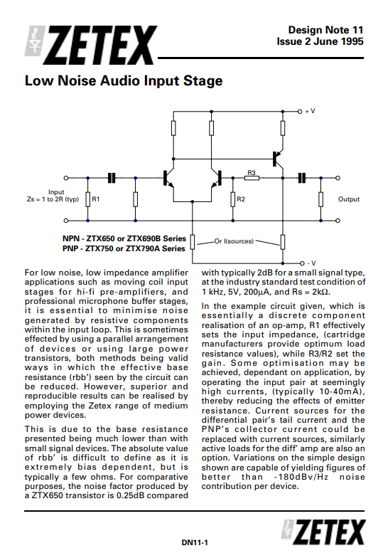

It was Horowitz and Hill who shined a spotlight on the very low measured noise of the Zetex transistors. Zetex themselves, and their new corporate owners (Diodes Inc) just call it a medium power high current transistor. There's no mention of noise anywhere on the datasheet. There's no guarantee its noise will be the same from unit to unit, or from week to week, or from fab to fab.
Skiers who venture "off piste", away from the marked trails, are on their own.
Medical doctors who prescribe medications "off label", to treat conditions other than the ones the FDA has approved the drug for, are similarly on their own.
It may also be true that designers who use a transistor (or its vendor supplied .MODEL) "off datasheet", are similarly their own.
For a larruping good time, telephone Zetex's application engineers and ask them for a better SPICE model which is less inaccurate when modeling noise. Expect to be asked about the volume of Zetex parts you have purchased this year & will purchase next year. That's how they prioritize their time.
H&H may have widely publicised the low-noise performance of some of the Zetex transistors, but the firm have tried to draw attention to it, at least in their home territory (here in the UK) for many years. The attached Design Note on Moving Coil amplifiers is from their Application Book in the 1990s. Note in particular the adjective 'reproducible' on low Rbb.
The Zetex medium power transistors have low Rbb by design, and actually they have been remarkably consistent over decades of production. I suppose that Diodes could radically change the process to suit another fab, but the designs as they are give outstanding combinations of high Hfe and saturation performance at high current, and if they spoil this, the relatively high price points of Zetex parts would no longer be tolerated.
It's not just the types tested by H&H that have super low noise - many parts in the 7-series (ZTX7xx and FZT7xx) PNP and 6-series NPN have good performance too.
I can't speak for the Zetex that is now run by Diodes, Inc., but I can say that the Ferranti (who designed the first ZTXs) of the 1980s and Zetex PLC of the 1990s had staff who were remarkably helpful, and I learned many arcane points about transistors from them.
I liked the old firm so much at that time that I designed a CCFL backlight converter for our Handheld PCs with and all-Zetex semiconductor BoM, as a tribute.

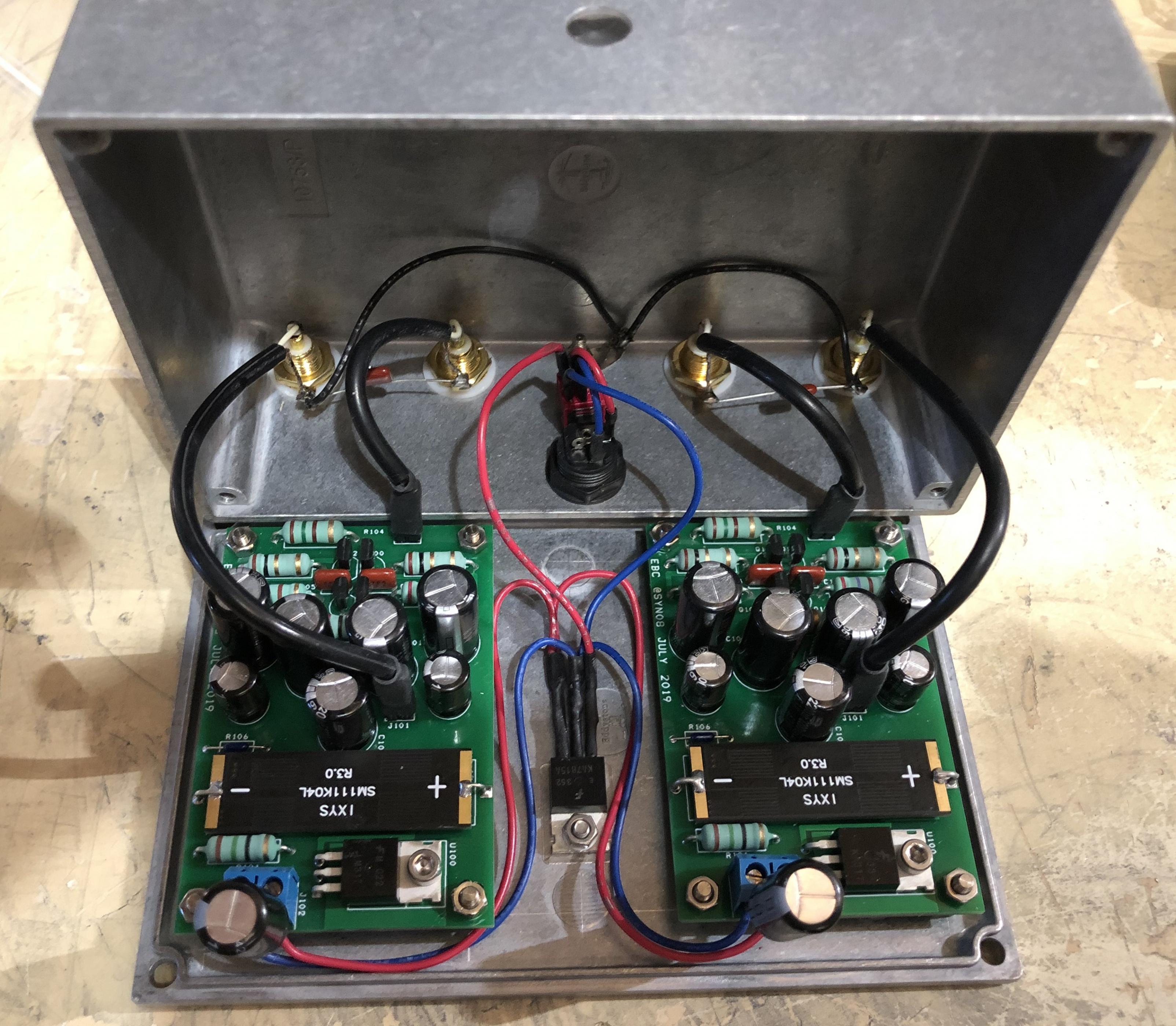

I will be interested to see if you leave the head amp in there after the tests...
Overload margin of my MC phonoamp is 30dB over the audio frequency range.
This is now reduced by 15dB with the inserted Head Amp.
Not sure if this step back is something to disregard.
Hans
