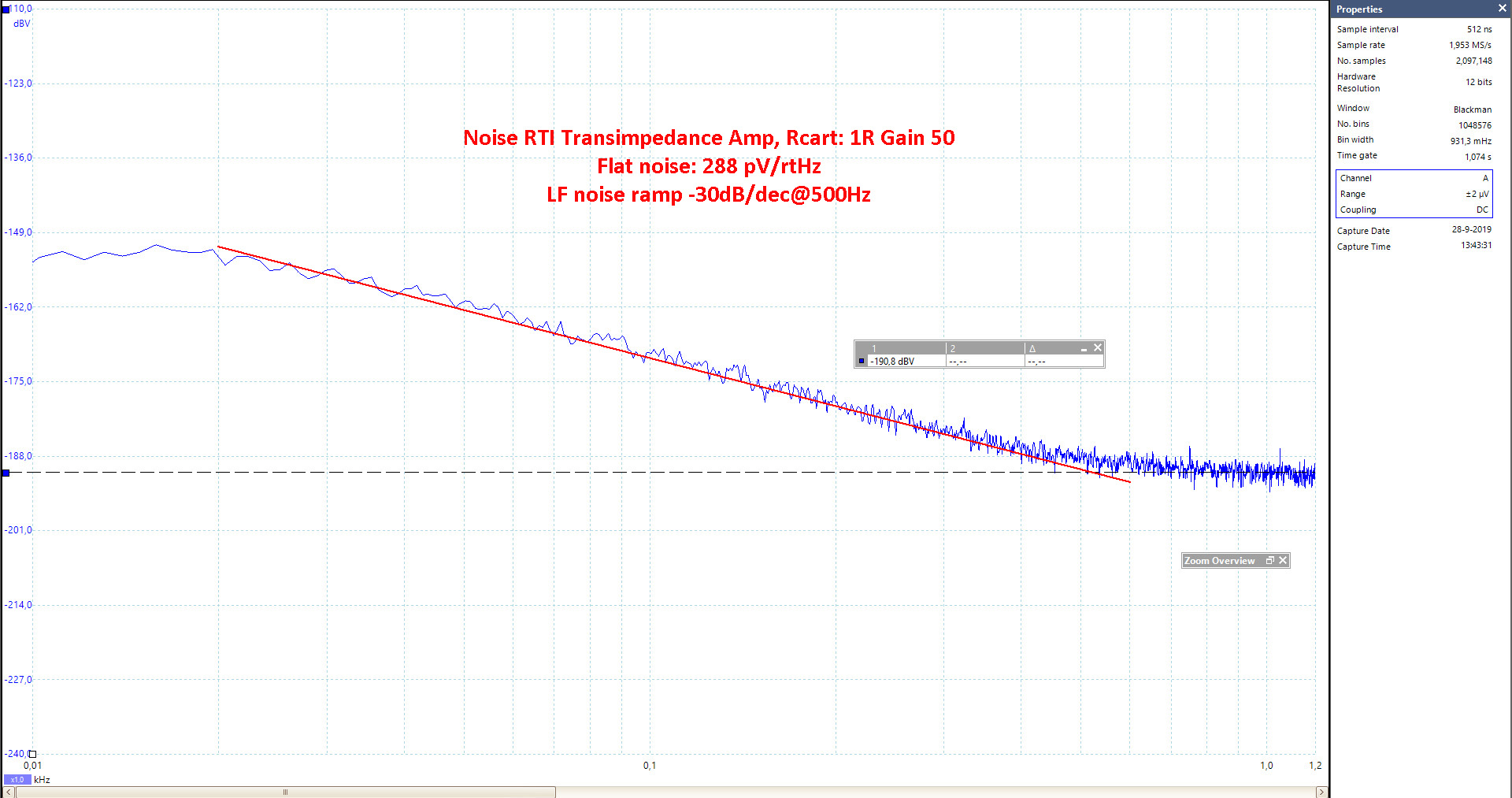

Gerhard, Interesting observation. There are two different circuits being used here, a variation on Richard Lee's design and one based on a John Curl design. An example of the first design with ca. -30dB/dec is Syn08's realisation, see here. htps://www.diyaudio.com/forums/analogue-source/339246-richard-lees-ultra-low-noise-mc-head-amp-post5842585.html.
An example of the second design with ca -30dB/dec is two pages back in posting #1504. This one, the transimpedance version, has ZTX transistors with a high LF knee frequency. The Voltage amp however, using the same amp module, happened to have ZTX transistors with much lower knee frequencies, making the -30dB/dec LF noise drown into the flat noise. See also posting #1517 what spread there is in the knee frequency between these ZTX transistors.
And yes, what is drawn as an amp is of course not an op-amp, but as mentioned a circuit based upon John Curl's original 2 transistor patented MC circuit. See below for the transimpedance version. Supply voltage is -1.5V / +2.1V, causing an Ic of 3.1mA through the transistors,

I still have no idea where these 30 dB/decade come from. Even telegraph noise (catching/releasing carriers) is only 1/f. < https://www.nii.ac.jp/qis/first-quantum/forStudents/lecture/pdf/noise/chapter9.pdf >
For 30 dB/decade, I guestimate that some energy collection must take place: the longer the events are apart, the higher is their amplitude. Much like earthquakes: the longer we have to wait for the big one in SF, the worse it will be.
But collecting energy is a typical capacitor thing, I can't think of such an effect in a semiconductor junction, more than maybe the plasma blobs in an Avalanche diode (not a true Zener).
But that is just some speculation from my side.
Cheers! (lifting a cup of fennel tea) Gerhard
PS Maybe one should swap parts to see if the effect wanders with the part.

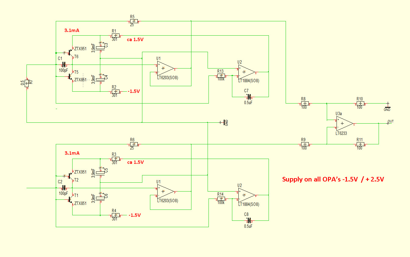

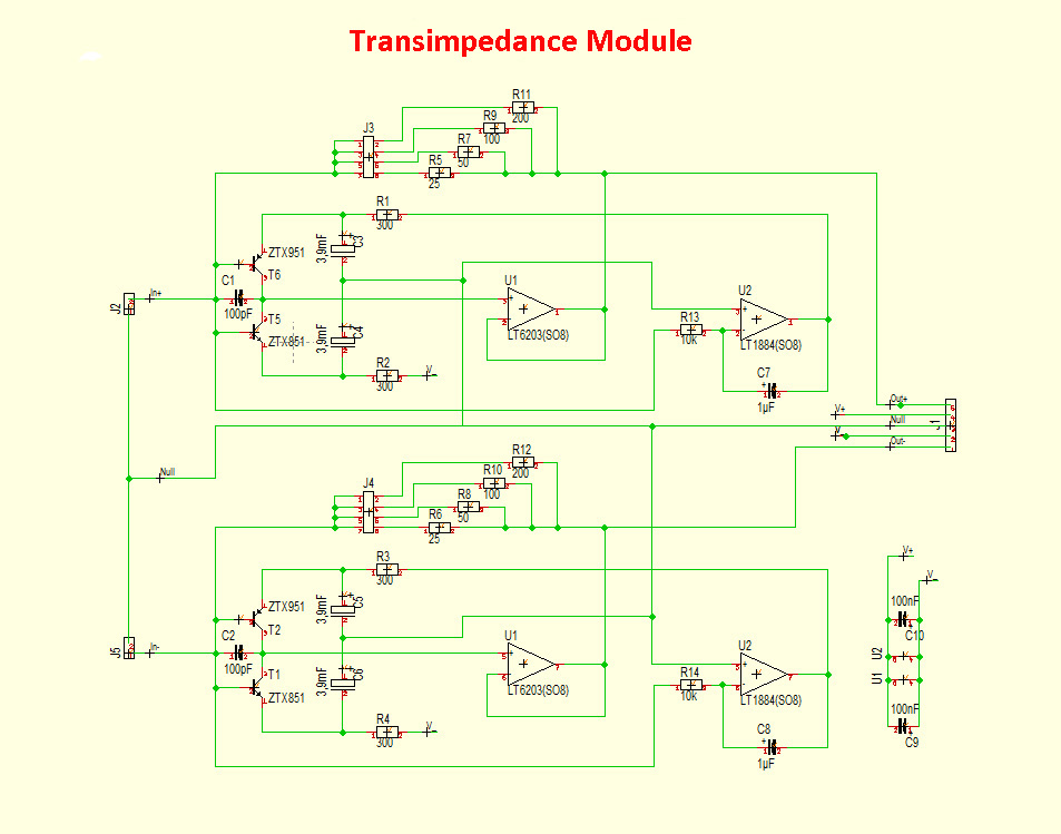

Is there somewhere a better schematic drawing? I am having troubles following what is posted above, and I am too lazy to re-draw myself.

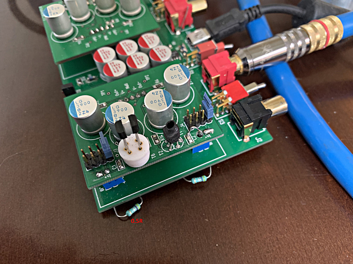

Here is a complete schematic drawing of the used differential transimpedance amp. Upper half has a gain of 50 and lower half a gain of 1. The 0.5R resistor at the input can also be moved to the lower part, to give the upper half a gain of 1 and the lower half a gain of 50. Noise from the output should be the same in both cases, but the measured LF noise differed very much, see posting #1517.
I replaced both transistors in the noisy upper half by a socket, so I could easily replace transistors without soldering. The result as mentioned in #1526 was disappointing .
Hans .

Correct, #1508 doesn't show the 30dB/decade, this is the better behaving Voltage Amp, where the -30dB/dec is probably submerged in the flat noise and therefore invisible. But the much worse Transimpedance Amp has the ca 30dB/dec clearly visible, see image below, here measured with both halves having the full gain of 50. That was the reason why I started to test the separate halves, to find out that only one half was to blame for the high LF noise.
More and more the thought forces to my mind that the ZTX transistors are probably not at all responsible for the LF noise, but that the Nichicons are to blame. That would explain why Wayne with ZTZ851's and no caps at all measures a flat noise spectrum up to 20 Hz. See the middle imgage here: Richard Lee's Ultra low Noise MC Head Amp
Unfortunately I have no spare caps to exchange, but tomorrow I will finalise a second Transimpedance board, with caps already mounted.

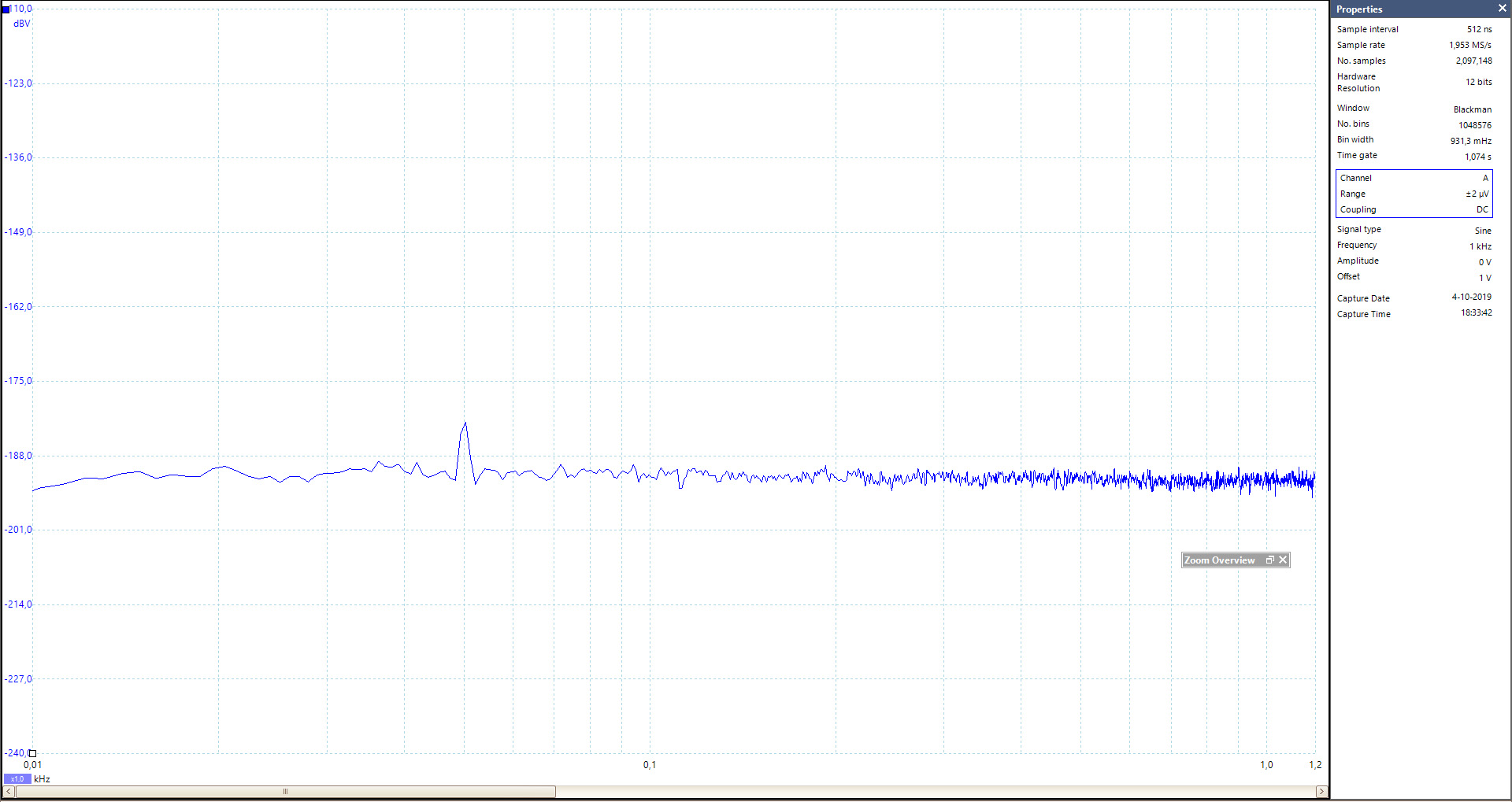

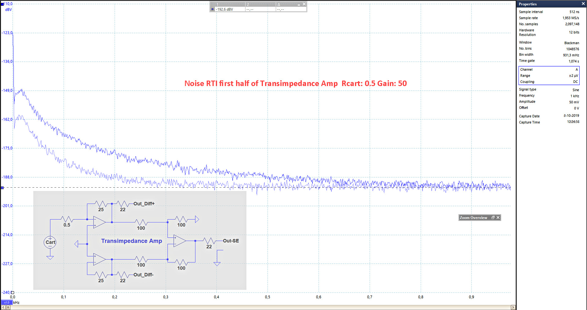

But I left the Head amp under power the whole night. Noise in the good half stayed the same, but went down by more then 10dB in the other bad half, see image below. Could it be that the caps needs some forming ?? However, since there is still 10dB difference in LF noise between both halves, I will see what I can do in replacing the caps.
Hans .

Powering from batteries or mains makes no measurable difference.
It get weirder and weirder. Could you check your measurement setup by replacing the amp with a known resistor? Then the noise drift should not appear.
Blimey. This has been a fascinating learning experience. And thumbs up to Gerhard for spotting it. That certainly looks a lot better.
To my experience, the Nichicon capacitors are excellent. See all the noise measurements I posted in this thread. Perhaps I was lucky or you had bad luck.How much more prove do we need that the Nichicons are bad news.

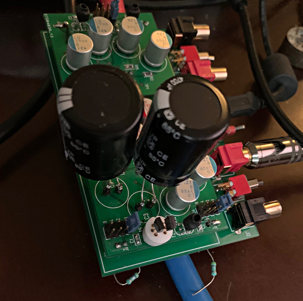

See image below with two 35Volt 4.7mF alu caps. And this is with the transistors that where originally soldered on the PCB. What a difference !
Hans
Indeed big difference. I don't understand your last noise measurement, I see no 1/f noise at all. That's a physical impossibility. Unless the noise corner frequency is much under 10Hz, which I would find very hard to believe. I have never seen a discrete bipolar with such a low corner noise frequency. Some ICs (LT1028) are claiming a typical value under 5-10Hz noise corner frequency, but even such low should be visible on your plot. AD797 seem to have about 50Hz for voltage noise and about 100Hz for the current noise, according to the data sheet. OPA211 has about 20Hz according to the data sheet, and that's a SiGe device.
P.S. You could easily set up a measurement jig for these caps, biased @3V. That's probably too much to ask, I'll do it myself when I'll have the time.
When we have a 1/f corner at 10 Hz and a -3 dB corner at 10 Hz(after the input stage), then we should see a slight decrease below that frequency. The plot would support that. There are bipolar op amps with 1/f corners lower than 10 Hz.Indeed big difference. I don't understand your last noise measurement, I see no 1/f noise at all. That's a physical impossibility.
