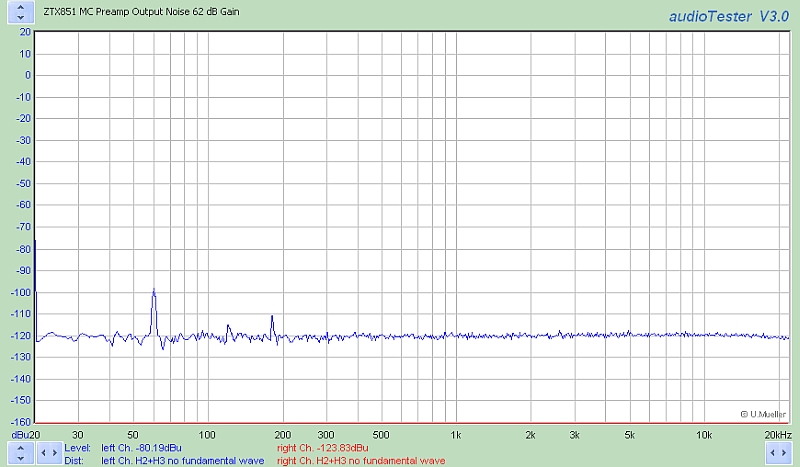

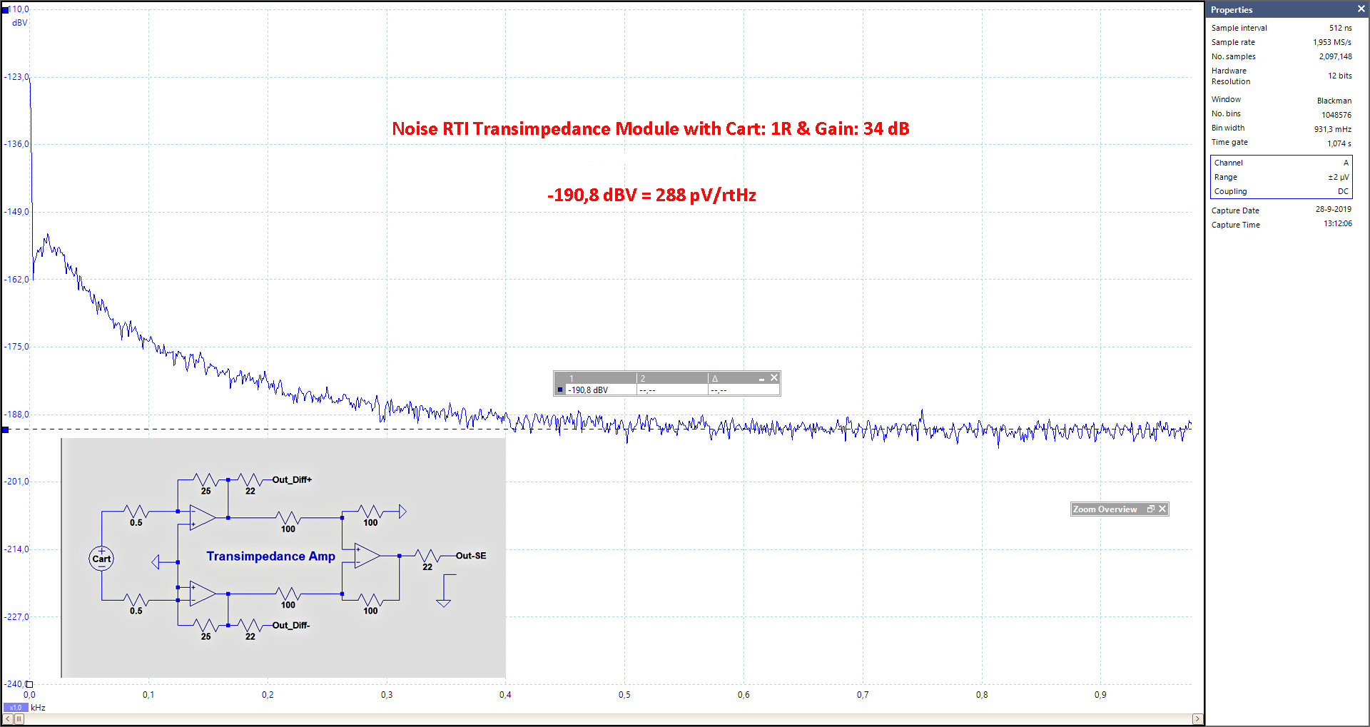

Here some results with the transimpedance module of my universal Diff in _ Diff/SE out Head Amp. I used a 1R input resistance simulating the Cart and with a Gain of 50 or 34 dB. Below the noise spectrum when fed with a 5W Nokia USB Wall Wart. No signs of Mains Harmonics are visible. Since the Bin Width is practically 1Hz, the Y axis can be read as dBV.
Noise RTI above 600Hz is -190.7dBV or 292pV/rtHz. When correcting for the 1R input resistance, noise for the bare transimpedance module calculates as 262pV/rtHz.
More detailed explanation to see at: Designing a universal diff-in/diff-out Head Amp

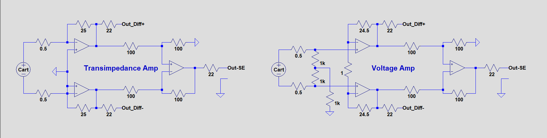

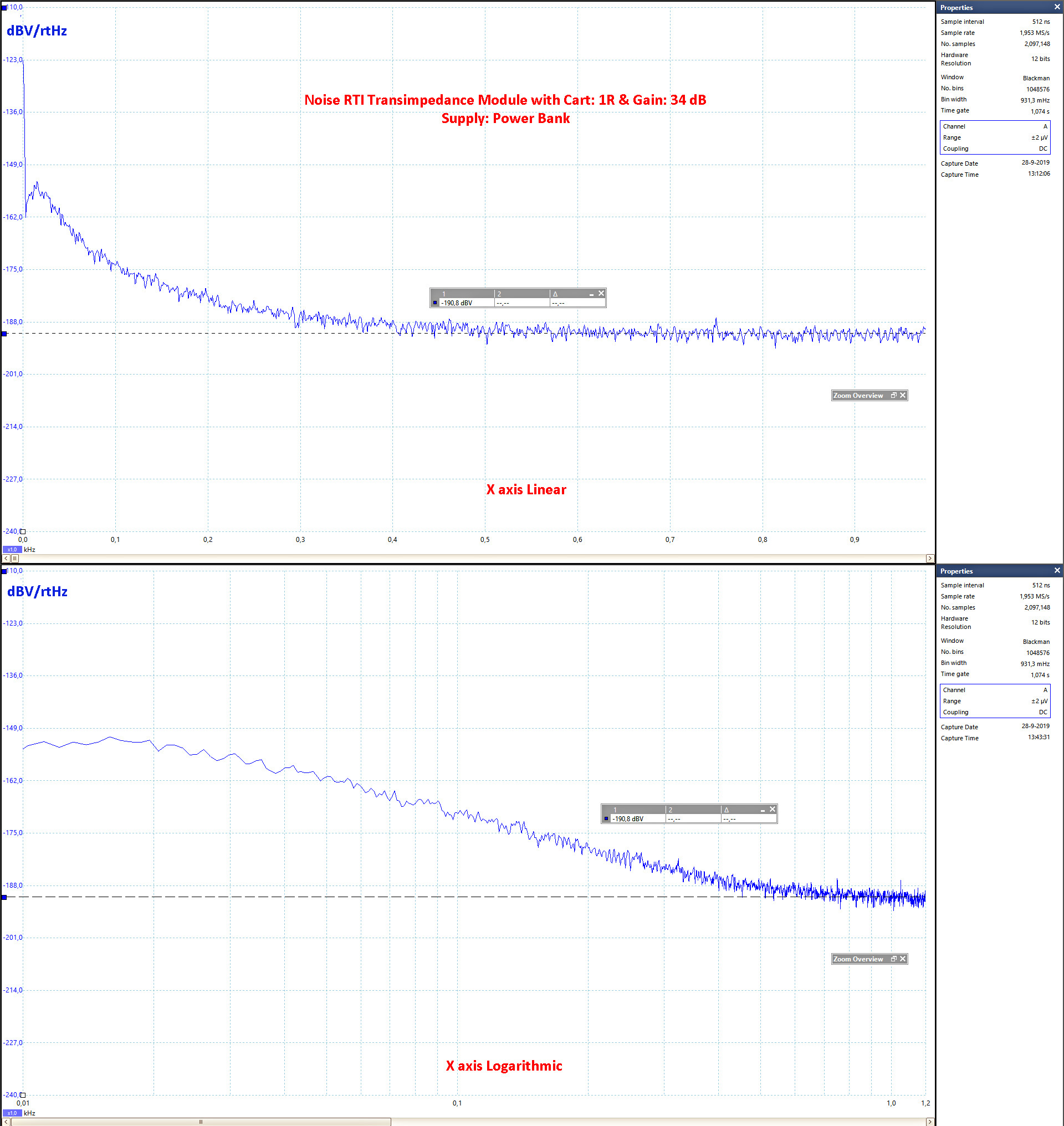

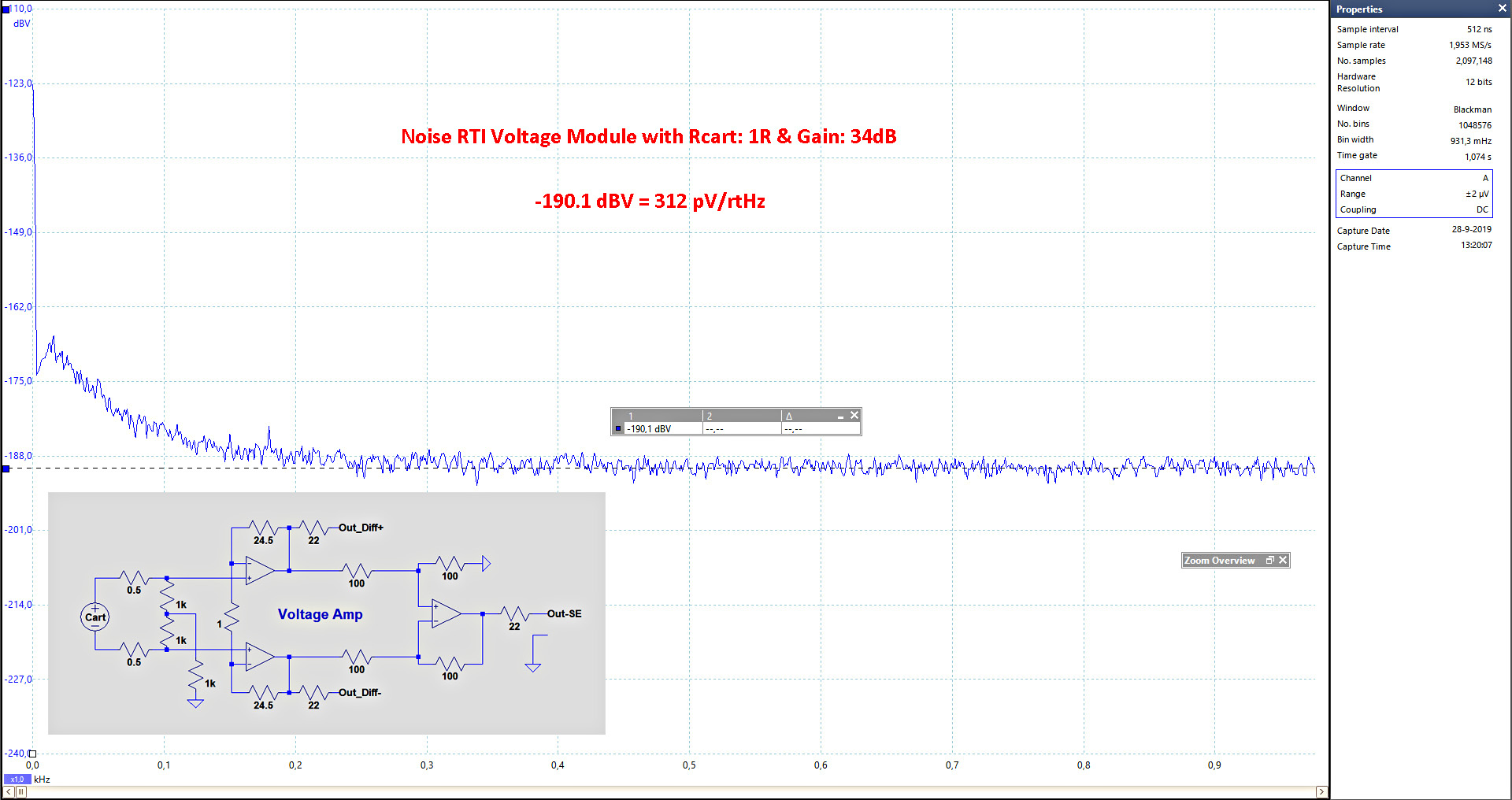

Having now also measured the noise RTI of the voltage amp, something peculiar is visible between the transimpedance and the voltage topologies.

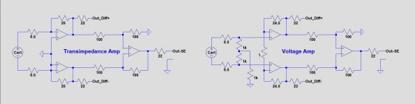

For a clear understanding of what I did, the first image below shows the two topologies, both using the same amp module.

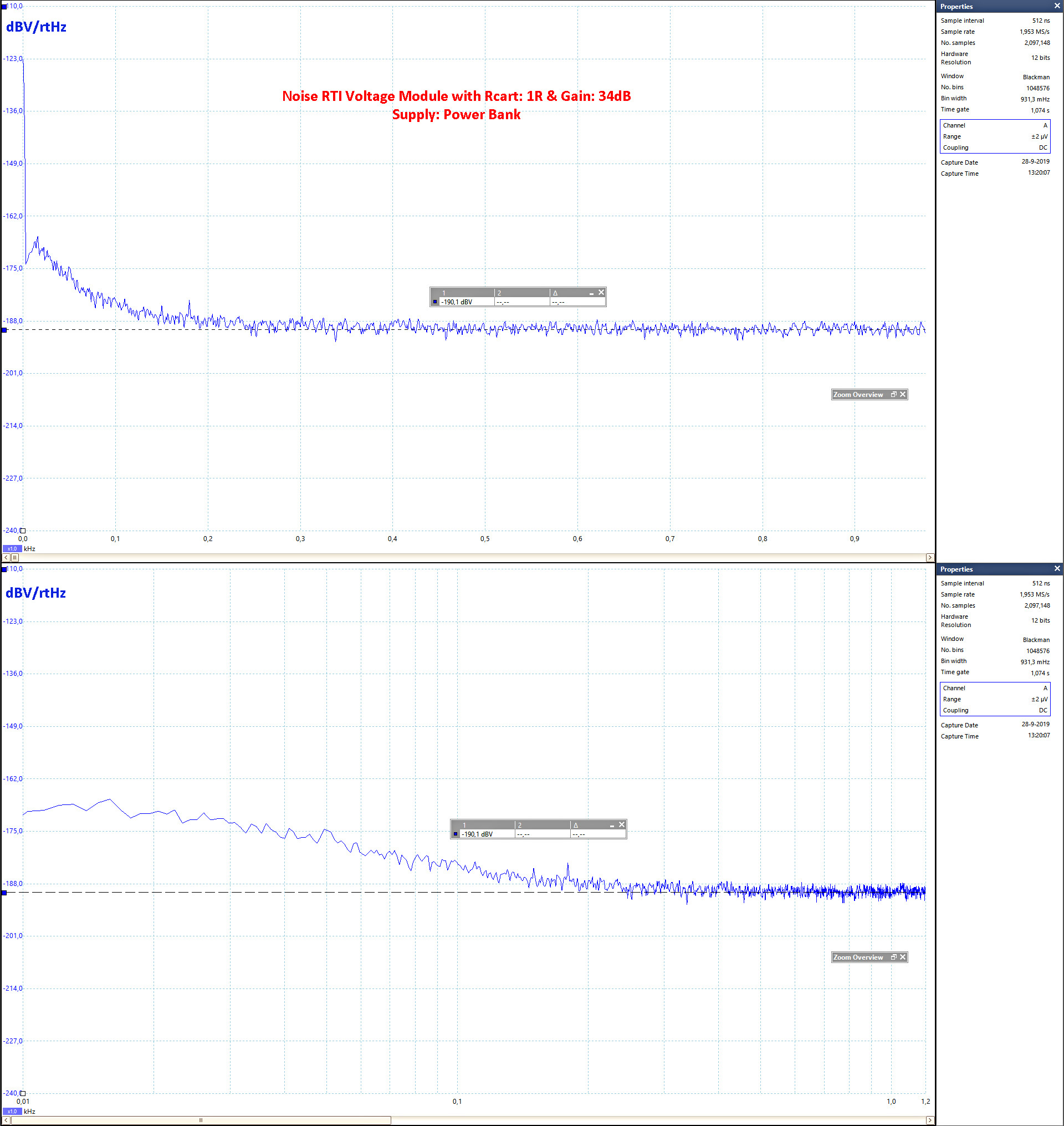

Second image shows the Transimpedance Amp's noise spectrum with a linear horizontal scale as well as with a logarithmic scale.
On the logarithmic version, noise below 600 Hz can be seen to have a slope of ca. -30dB/decade.
Exactly this same slope is visible in Syn08 image in #403, see here Richard Lee's Ultra low Noise MC Head Amp.
However for the voltage Amp, using the same amplifier module, the raised LF noise spectrum stops at a much lower frequency of ca 200Hz and has a slope of ca. -20dB/dec, see the third image for that.
I practice this has probably hardly any impact, but from a technical point of view I wonder why a virtual gnd topology produces a different pattern as a voltage amp.
In this case LT Spice is of no help, because both topologies show the same noise spectrum.
Hans

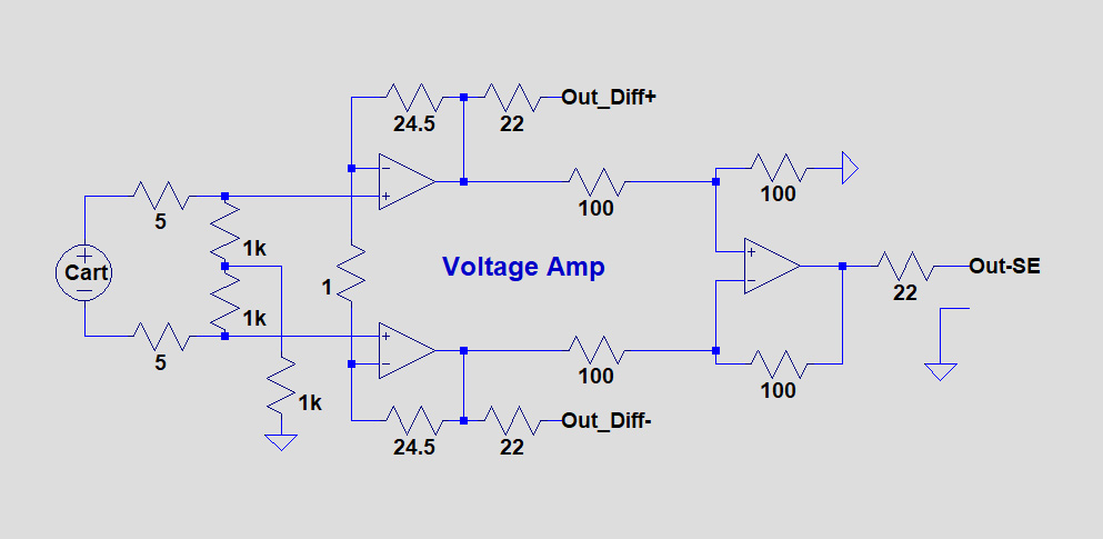

There's a short circuit in the circuit diagram of the above posting between both inputs of the lower transimpedance amp. This is not meant to be there.
Contrary to other projects where LT Spice was close to the measured results, in this very case the difference is large. Measured noise above 1kHz for Transimpedance and Voltage Amp, is >10% LOWER as simulated But LF noise is way above what LT Spice predicts.
The most likely component to my feeling causing this deviation with respect to the simulation are the ZTX851 and ZTX951 transistors, in this case all carrying 3.1mA.
On one hand the Rb seems therefore lower than the resp. 1.5R and 1.2R as used for both models, on the other hand 1/f, G-R or whatever noise is either not included in the ZTX models or completely wrong. The big difference between both Modules in LF noise seems only to be declared by a large spread in the knee point of said LF noise.

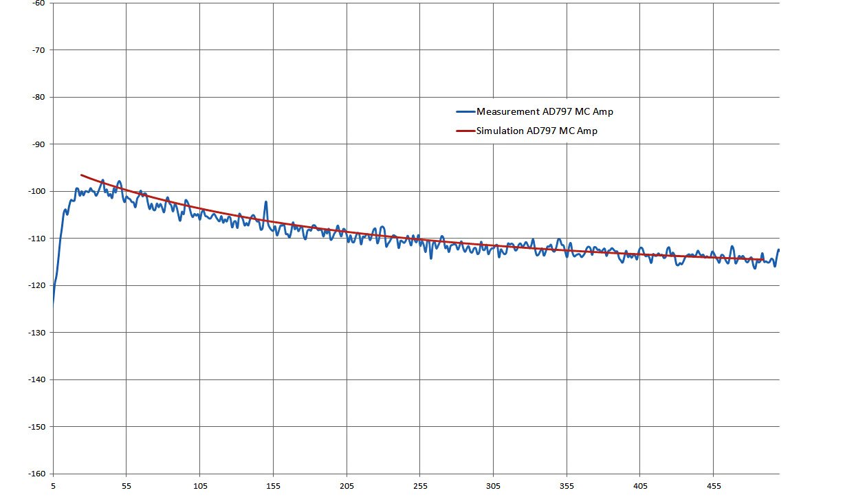

Hi Bill, Sorry, but I can't share your view on “simulation science fiction”. LT Spice is extremely accurate in predicting noise performance as long as the models are correct, see f.i. image below for a AD797 MC preamp.
And that's exactly what's the issue here. Wayne's model and my two different versions measure noise above 1kHz that's 10% less as what LT Spice predicts with the 1.5R resp 1.2R values for Rb. However when using the seemingly very low numbers in the original model, measured and simulated results are spot on, conclusion ?? But at the end 10% is less then a 1dB, so no big deal, but nevertheless.

I didn't mean there was a problem with LTspice, just that, as far as noise parameters are concerned I don't think Zetex even bothered to try and measure that let alone make an accurate model.

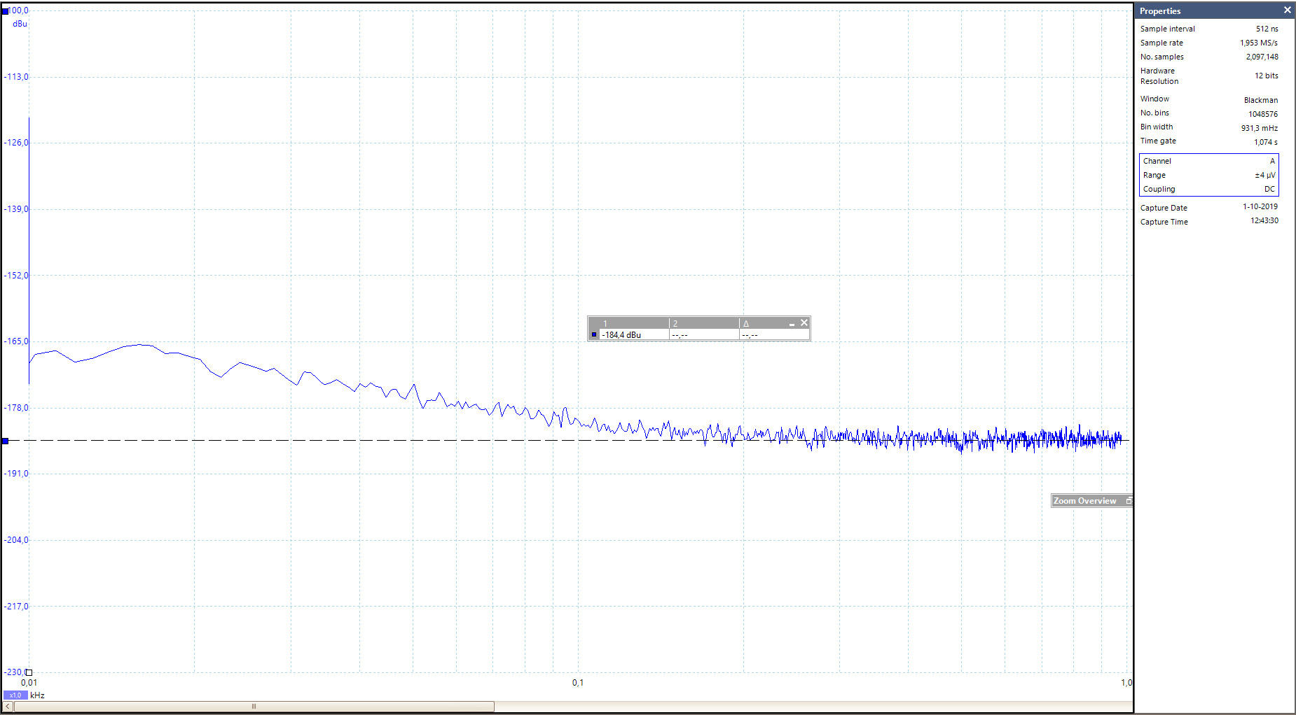

Bill,
Not sure if I understand what you are asking for. Are you referring to the last image with a 10R cart in comparance with Wayne's meaurement ? In that case, it's still the same voltage board as before but now with a 10R Cart. See below.

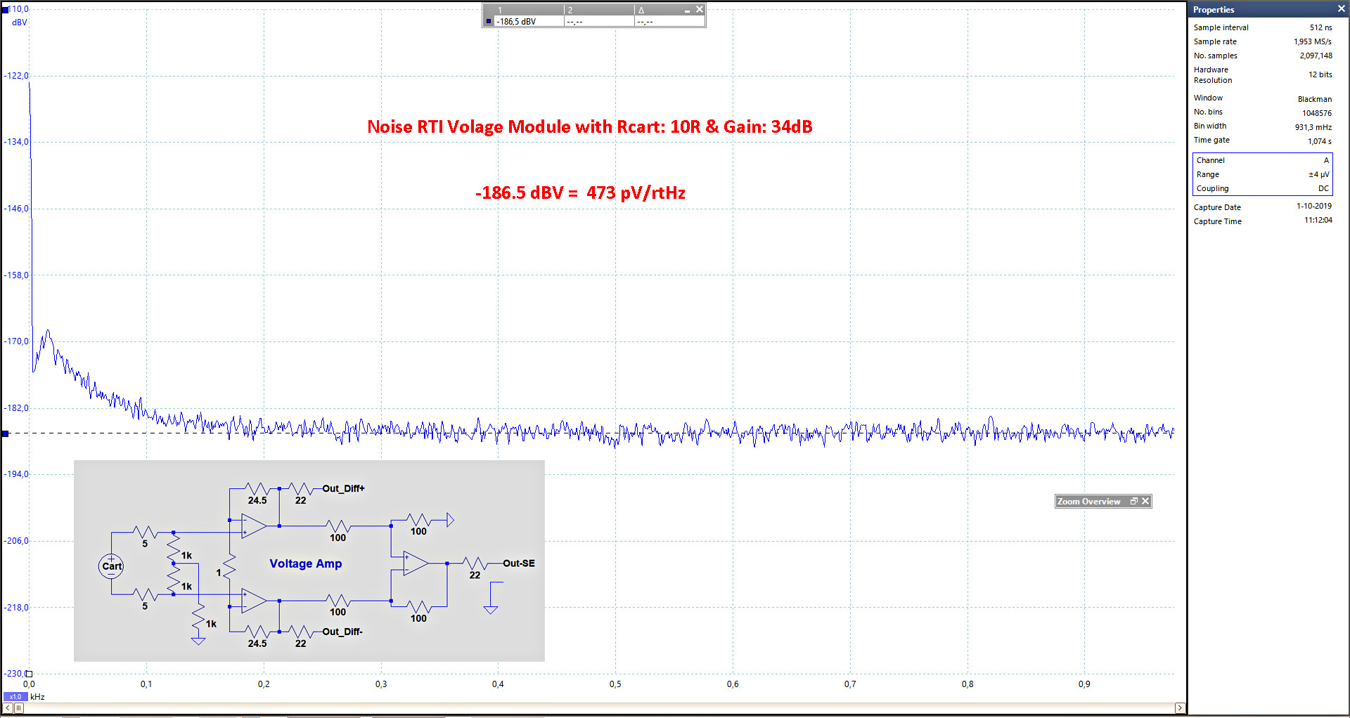

With Rcart = 10R, noise above the knee point was 467nV/rtHz with the voltage amp. To compare: with Rcart =1R, the transimpedance amp measured 288nV/rtHz and the voltage amp 312nV/rtHz (posting #1504) The noise of the voltage amp is always a bit higher because of the extra resististor Rs, in this case 1R, that is there to set the gain. Gain = 1+(2x24.5R)/1R = 50x
If this is not what you asked for, please let me know.
Hans
Hans
Here you have the three together. All measurements are taken from the SE output.
Hans
P.S. the Diff to SE converter is a LT6233
Hans

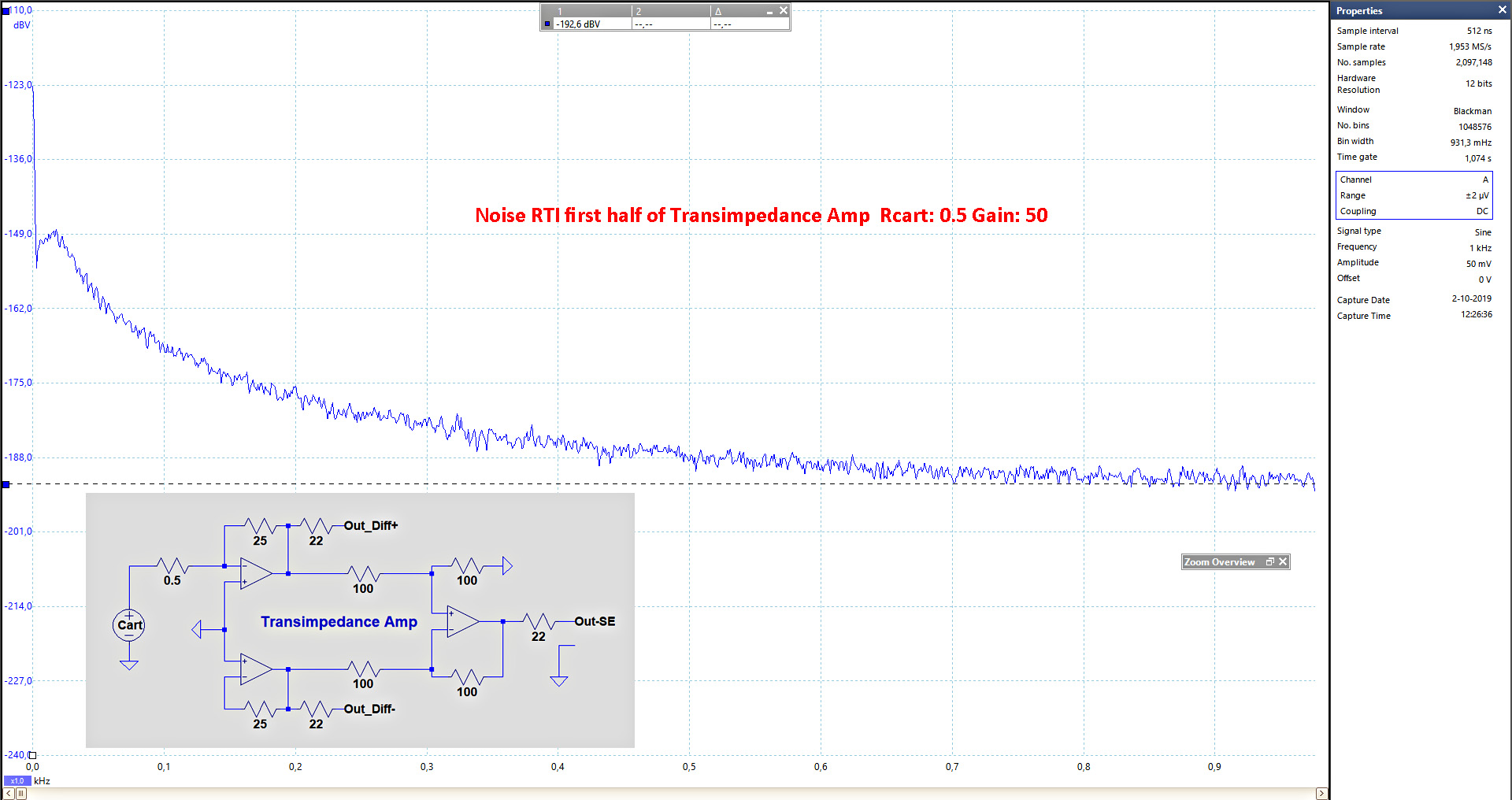

The very strong suspicion that the ZTX 851&951 transistors are having a large spread in their LF noise behaviour, was easily confirmed with my differential Transimpedance Amp.
One half could be set to an insignificant gain of 1 and the other half to a dominant gain of 50 and VV.
The two images below do indeed show a huge difference between the two halves of 25dB@20Hz, almost a factor 20 !
When using ZTX transistors, it makes absolute sense to test them in advance in a socket.
Hans
Hans
