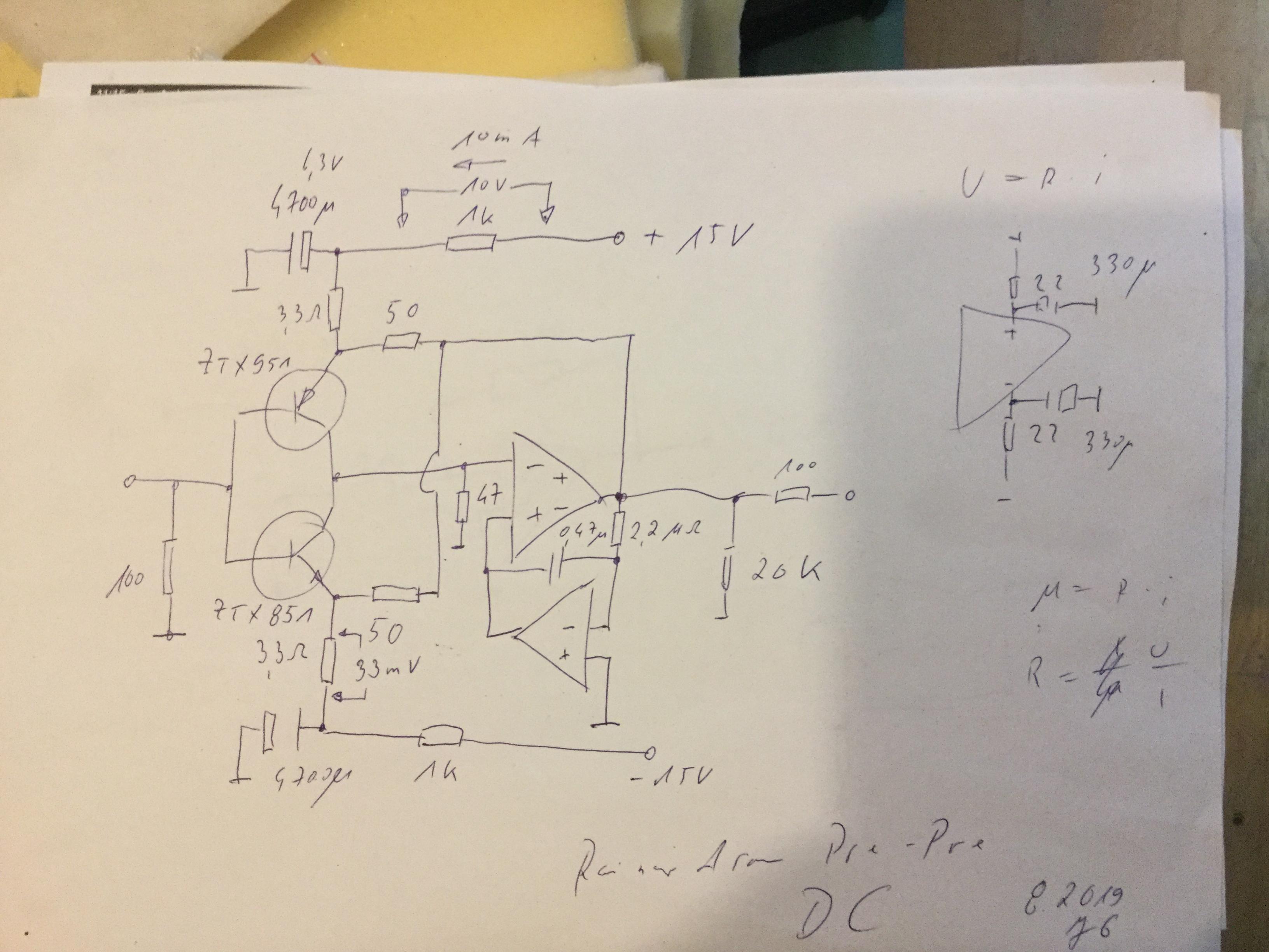

Herve, is the blue S/R trace in #1449 your 20kHz 'fundamental' and the red dist trace distortion?
Which circuit is this?
Richard, yes, blue is a fraction of the output signal, red is the distortion which is almost H2.
The circuit is a duraglit with 2 pairs at 10mA total, input is 500µV 20kHz.

BTW, this, w/o servo, is sorta how Great Guru Baxandall did the QUAD 44 & 34 preamps. Part of the RIAA network 'replaced' the '2x50R' feedback resistorsI plan to build this pre-pre. It is a Renardson design. I just added the servo.
