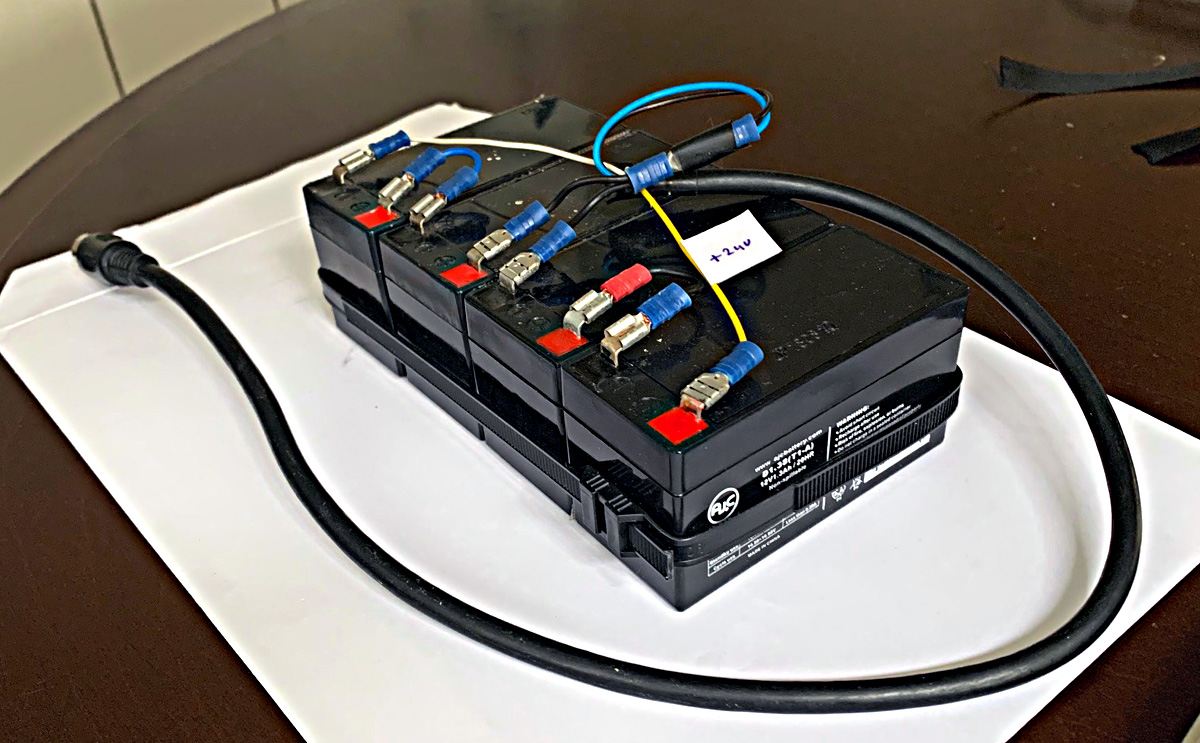

There is no mystery, it's just a matter of not giving up until you have what you aim for.
I've given you as many details as possible and now as a last step I show you my MA battery solution.
Four 12V/1.3Ah batteries are tied together to give me +/-24 Volt, simple as it can be, also perfectly suited for your MA so it seems.
Give it a try and I'm sure you will make a big step forward.
Succes,
Hans
I'm not necessary interested for a solution for an otherwise non existent problem (no big deal to have 2nV input referred mains harmonics) but more like identifying the root cause for the observed behavior in my lab. That's the mistery. You (and others) appear not to have this problem (for unclear reasons), good for you, others seem to have the same problem (for unclear reasons as well).
Just buy 4 batteries as shown if you want to switch from the pollution troubled camp into the flat noise camp.
I would be disappointed if you didn’t, after having answered in much detail so many of your questions.

I agree feeding the MA from betteries won't harm. But before investing $100 in 4 x 12V rechargeable batteries I need to understand what is happening, since no ground loops exist.

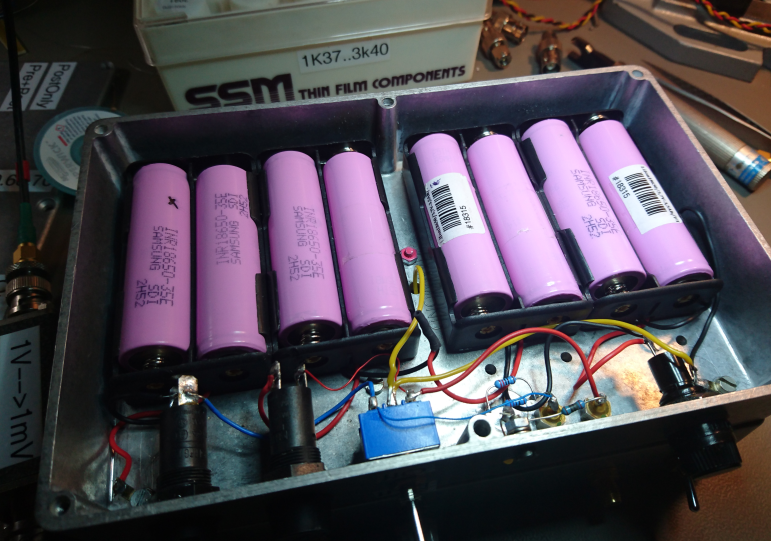

I do my spectrum measurements mostly with batteries. Both the DUT and the preamp have built-in batteries, and I put both of them into an aluminium cargo box that has only 4 BNC-BNC feedthoughs. That enforces an equipotential GND for the few signals that go in/out. Probably I could improve that cargo box with finger stock on the lid.
DUT and preamp are in the cargo box, isolated by rubber feet. Usually there is only 1 connection, implemented with SMA connectors and semi-rigid coax cable. I'm a RF guy, so SMA is natural. The semi rigid cable is very short, but when there is any additional connection between the DUT and preamp boxes, even direct box-box contact, the hum pickup gets 10 or 15 dB worse. That is clearly magnetic. The aluminium does not help against this, but I was not hurt enough up to now to buy Mu-metal. Alone that mess with red heat for 2h in a hydrogen environment after bending...
It's also interesting: with a coaxial SMA short on the amplifier input, I see more hum than with a 60 Ohm termination ( 1nV/rtHz). I approximate that 60R with a 12 db SMA attenuator with the other side open. That is maybe a 5mm difference, or the damping??
In the upcoming xmas season I'll watch out for "tin" boxes made from soft iron that they use for Nuremberg Lebkuchen now & then. I was not successful last year. Missed those family boxes.
I'm moving now to Lithium batteries. One cell has 3.7V nominally and the best promise sth. like 3Ah. If they promise more, they probably won't work at all. One cell is thus equivalent to 3 NiMH in series. That keeps the number of cells down. The drawback is that the voltage is 4V2 fully charged and may be discharged down to 2V5. I limited myself to 3V5, so I don't get the full stored energy. But once you are down to 3V5, you are quickly down to 2V5, so the loss is not too much. Nevertheless, there is a lot of stored energy. No comparison to NiMH and Pb. I did not have much fun with Pb. Usually empty when I needed them or even sulfated.
I use to bolt two Hammond alu boxes together, one for the amplifier/DUT and one for the batteries, see pic.
The other side is the dual amplifier, in statu nascendi.
