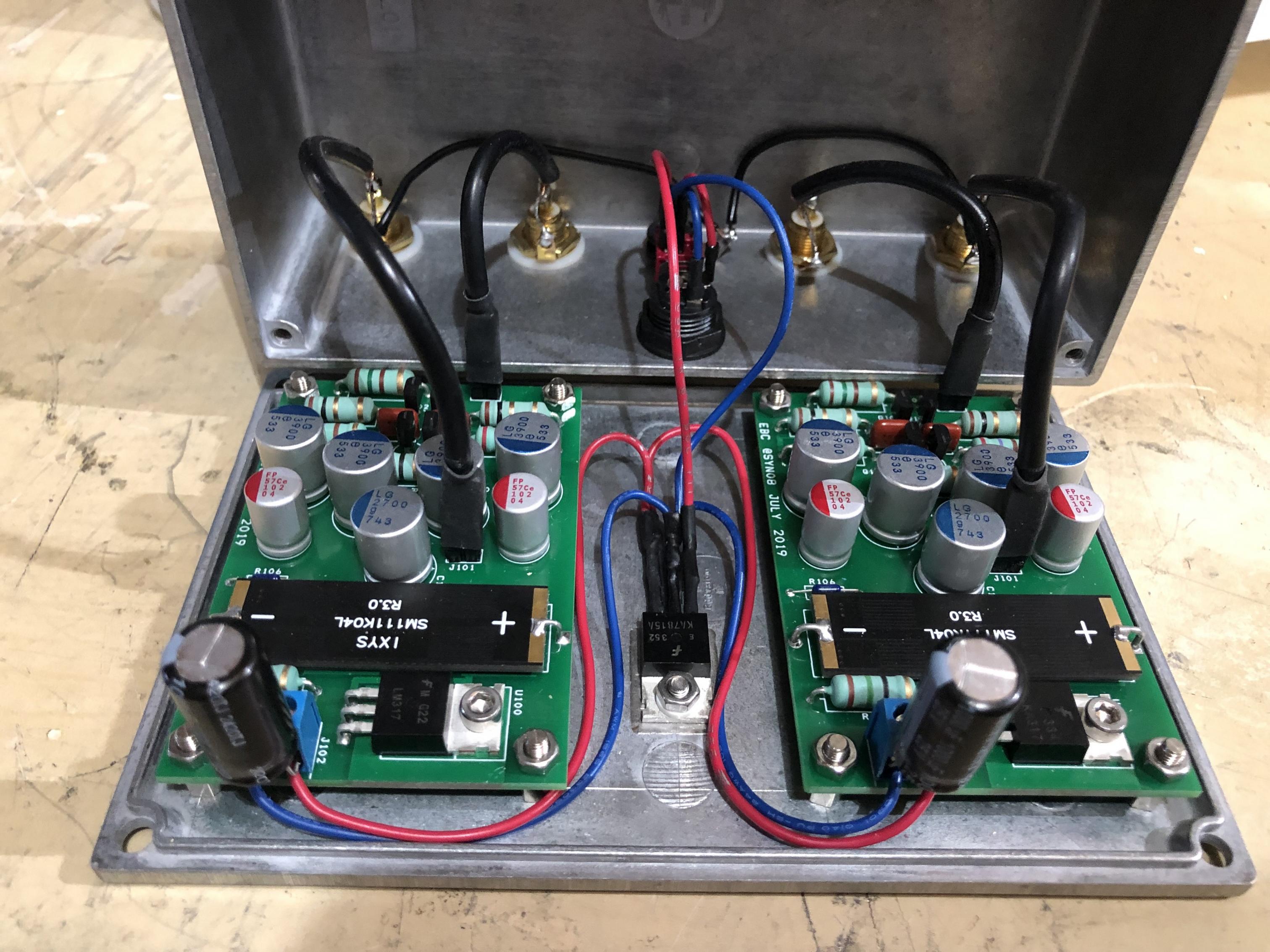

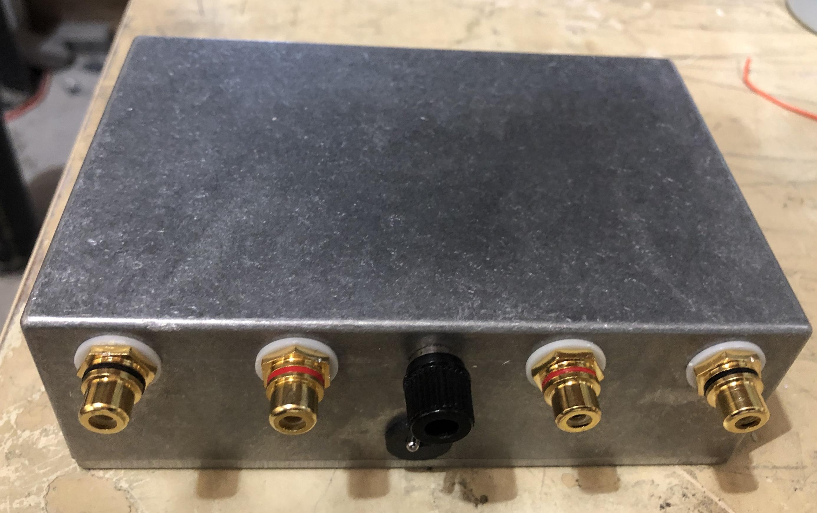

Ok, back to the topic 😀. Did I mention I hate transformers?
P.S. The 15V regulator in the middle is to allow a garden variety of wall warts to feed this baby, without overheating the on board current sources. Currently running on a 24V model.
