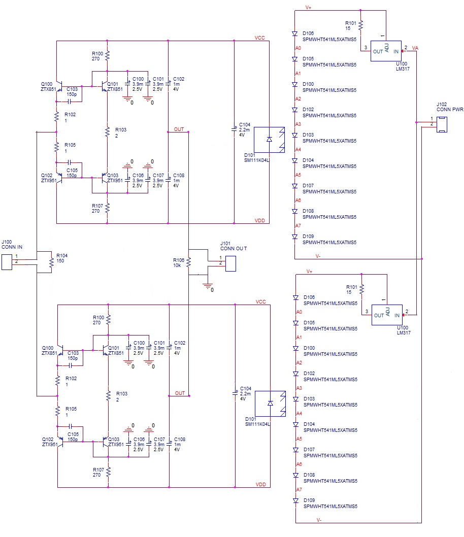

And there you have it, the only solar powered current mode headamp currently in captivity (well bar the other one in your lab). 🙂

You think I can sell it to a Golden Ear for $2413 plus shipping plus 4% PayPal fee
Hell yes. I bet you could even get it reviewed. Add an external solar battery charger for an upgrade!

I installed the thing in my system, feeding my latest HPS 6.2 on low gain (~60dB), total gain is about 76dB for my Benz Micro Gold 12ohm 0.4mV @5cm/s.
Did a quick comparison with HPS 6.2 on high gain (~72dB gain) and, as usual, can't hear a damn of a difference, so I guess it's settled: reading a MC in a virtual ground (this one has about 5ohm) is as good as any other method.
Therefore, to hell with the "recommended" load of 100ohm it's yet another BS perpetrated by the audio industry. I'd bet the MC manufacturers didn't even bother to figure out what's happening in high/low impedances, they just copied the 100ohm spec, to stay aligned with the fashion and most of the available MC preamps.

Someone mentioned a few posts bs k that an MC cart puts out about 100 uA. I don’t think there’s a problem.
I tend to fully agree. The only thing that can be said for sure is that, if you go significantly lower than 100R with a voltage input amp (and 99% of commercial MC amps are voltage input), signal level will get attenuated and thus reduces output level and worsens SN. For cartridges with Rs > 30R the 100R already have an audible effect while for an Rs of 3R, one can go lower before this attenuation gets significant. As the majority of cartridges today are in the 5 to 15R range, the 100R recommendation or the rule of thumb to use 10*Rs fits the bill for most cases.Therefore, to hell with the "recommended" load of 100ohm it's yet another BS perpetrated by the audio industry. I'd bet the MC manufacturers didn't even bother to figure out what's happening in high/low impedances, they just copied the 100ohm spec, to stay aligned with the fashion and most of the available MC preamps.
And if output level is not adjusted when listening and comparing different input resistor values, the louder setting will in most cases be preferred. And the majority of people do not realize that when playing with the DIP switches on their MC preamp, they change output level.
100 µA signal current are still 1.6x10**10 electrons per 25 µs (time of pos. or neg. part of a 20 kHz signal). And even if it is only 1µA, one electron more or less at 1.6x10**8 signal electrons ist still -160dB of quantization noise.
Based on what few measurements I have seen too high a load R is the thing to avoid. Even though a square wave response doesn't show additional ringing the sound gets, for want of a better term 'splashy'.
Yes - I don't know why people raise this in audio - its a non-issue.
