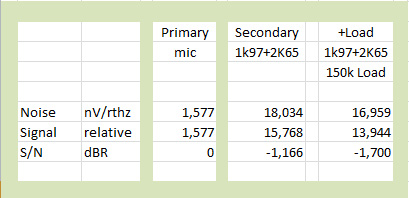

The most important spec for this transformer isn't specified in da datasheet but only implied. The transformer is designed for 150R microphones and this is represented by their 2x75R in TEST CIRCUIT 1 & 2. This affects practically all aspects of its design & performance.
A transformer N x Voltage step up ratio also steps up Impedances by N^2 x
We can transform every Impedance on the primary side to the secondary side by N^2. In our case, the voltage step up is 10x so we step up impedances by 10^2 = 100.
The primary side has Rs + DC resistance = 150R + 19R7 and this is multiplied by 100x to give 15K + 1k97 equivalent on the secondary side.
The secondary also has 2K65 DC resistance so we see 15K 'active' generator resistance and 1K97 + 2K65 = 4K62 evil parasitic transformer losses on the secondary. (Iron losses are very small for LN transformers like these so just looking at resistive Cu losses is good. You need to consider the 'iron' for LF. Good transformer design also attempts to share the losses on both primary & secondary (ie transformed 'DC should be the same on both primary & secondary) .. but this is often kiboshed by existing wire sizes.)
Because only the generates 15K generates signal, the transformer has lost 15K / (4k62 + 15K) = 0.7645 which is 10log(0.7645) = -1.166dB S/N cos the parasitic resistance of the windings.
But ignoring the following LNA, this feeds their 150K resistor which is a potential divider of 150K / (15K + 4k62 + 150K) = 0.884 which is -0.533dB.
So the transformer causes a S/N loss of 1.166 + 0.533 = 1.699dB which I hope Guru Wurcer will pass for someone hu kunt reed rite en kunt 😱

Because only the 15K generates signal, the transformer has lost 15K / (4k62 + 15K) = 0.7645 which is 10log(0.7645) = -1.166dB S/N cos the parasitic resistance of the windings.
Mea culpa, mea culpa, mea maxima culpa! My excuse is that this is a beach bum's pre-morning coffee effort. It is only half right.0.7645 and 0.884 above are voltage ratio, why are you then taking 10log() to get to dB? 10log() is for power, or V^2 ratios. S/N is by definition a power ratio so using a voltage ratio to get the S/N is incorrect?
"15K / (4k62 + 15K) = 0.7645 which is 10log(0.7645) = -1.166dB S/N" is correct. It is just the ratio of resistors and we are looking at noise contributions. It's the same process that determines doubling resistance increases voltage noise by 3dB.
"150K / (15K + 4K62 + 150K) = 0.884 which is -0.533dB" is wrong. Here we are looking at loss of signal voltage so it should be 20log(0.884) = -1.07dB S/N
So the Jensen transformer causes a S/N loss of either -1.166dB or -2.236dB (NF of either 1.166dB or 2.236dB) depending on whether you use a Zobel or an EVIL 150K resistor. Please don't hit me for being so far from the Jensen spec, Guru Wurcer.😱

Richard,Mea culpa, mea culpa, mea maxima culpa! My excuse is that this is a beach bum's pre-morning coffee effort. It is only half right.
Your original calculation was correct, because the 150K load is not only attenuating the signal, but also the noise. See below.
Hans

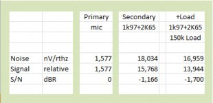

Richard,
See below.
This is still mix and match. When you use an ideal or near ideal voltage amplifier you want SNR in dBV not dBW. Taking 10*log of a simple voltage divider ratio just makes for unnecessary interpretation. If you put a divide by two attenuator in front of a voltage amplifier driving a load the load gets 1/4 the power i.e. -6dB.
Scott,
Did you look at my table?
I used 20*log(signal/noise) and not the 10*log
Hans

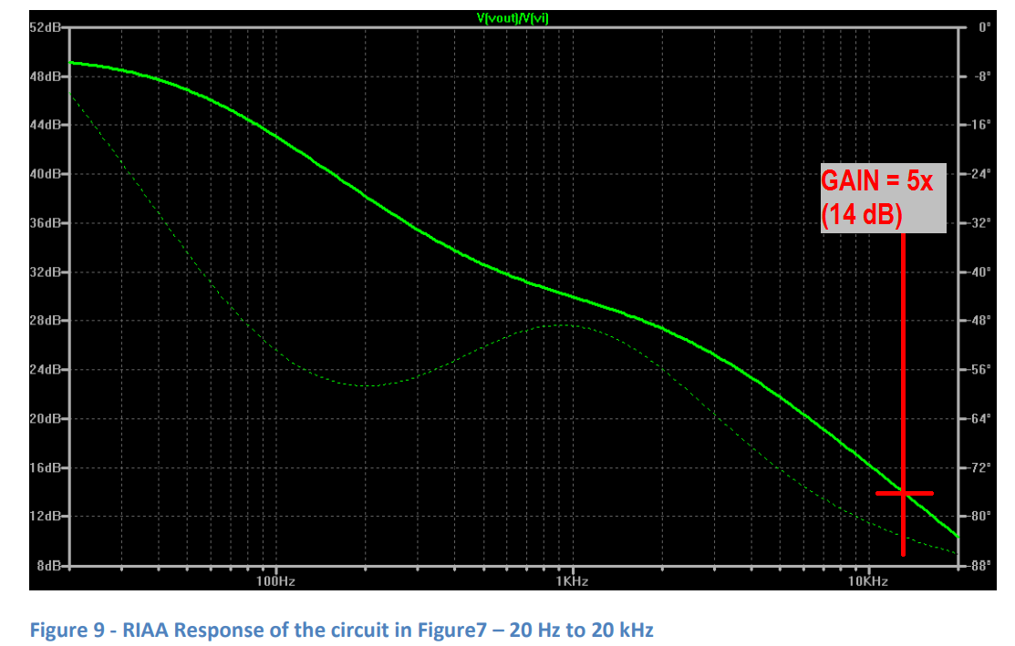

This looks like a pretty fine step-up replacement for the NE5534 in a standard MM RIAA amp - the noise from ~1k to about 40k looks to be that of a pure resistor. I'll have to get a few and play with them.
