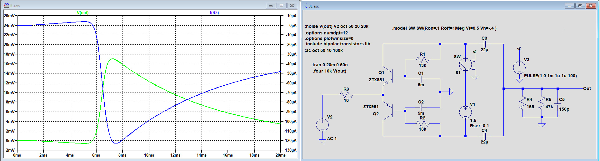

More than once is referred to trying to prevent too large currents flowing through the Cart at switch on.
Just working on my inverting and non-inverting "Phantom" design, I noticed that Cart currents at switch-on are not the thing to watch but much more the switch-off currents.
Even the Duraglit, having exceptionally low switch-on currents in the nA range, shows a switch-off current of around 100uA, see image below.
Although the discharge waveform may differ, this current max is almost independent of Rcart and the size of the caps.
This seems to confirm "rumours" that short lasting currents in the hundreds of uA are causing no problem to an MC Cart.
Hans
Currents in the 100 µA range should be no problem. When running the cartridge in 'current mode', such currents could be the normal operating condition: e.g. many Ortofon MC cartridges have source resistances in the 5R range and output voltages of 500µV (5cm/s @ 1kHz). This will result in 100µA rms signal current.
That's with the cartridge in short; for the commonly recommended input impedance (100ohm) the current is much smaller.
Not saying that it matters, anyway, only that there's a large population out there that will freak about 100uA current through the cartridge.
The input impedance of the Duraglit (and #375 as well) is about 1/2gm that is (for Ic=2.5mA) about 5ohm so yes, it is reading a regular MC (Rs=10...20ohm) almost in short.
