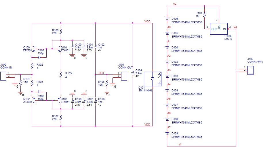

I got some private requests about the Gerbers for #375. Attached is the latest version for Zetex devices pinout. It's a mono board so one needs two boards for stereo. White LEDs are the much cheaper DigiKey 1510-1552-1-ND devices.
No further development is expected with #375. Use the attached for your own MC pre development.
Sorry, the schematic shows 9 LEDs; the attached board requires only 4 LEDs of the indicated type. The schematic is for a version fed by a 5V solar cell, that project was abandoned before creating a PCB.

I've experimented a little with all kind of solar cells; large area cells have a significant issue for this particular project: they need a more or less uniform illumination to deliver the required current. This means either lots of LEDs to cover the surface, or placing the cell far enough from the LEDs, otherwise the short circuit current is a dismal (and strongly relative position dependent, needing adjustment). Also, most of the available cells don't have an antireflective layer that would "trap" the light inside.
I think these IXYS cells covers it pretty well: small area (also saves PCB area) so they need only four LEDS, one for each quadrand, antireflective layer, 2.8V open voltage, >50mA short current. They are also not expensive. Unfortunately they don't seem to manufacture any smaller model with the same voltage but lower short circuit current (20mA would be enough).
I think the IXYS cells are already belonging to the most optimal group of cells. Beside the pros you already mentioned, the fact that they are also monocrystaline may also have a positive effect for noise. The majority of cells today are of the poly type (cheaper to produce for large areas) and I can imagine that noisewise these are not as good.
I don't know much about solar cells, other than the basic (physics) plot, therefore the first attempt for illumination was with four power white LEDs @600mA. The IXYS solar cell wideband output noise was horrific, I suppose of the GR type. @50-100mA through the same LEDs, with the same cell, they are completely silent. Hence I switched from high power LEDs to medium power LEDs @75mA (50mA also works fine) and didn't look back since.
