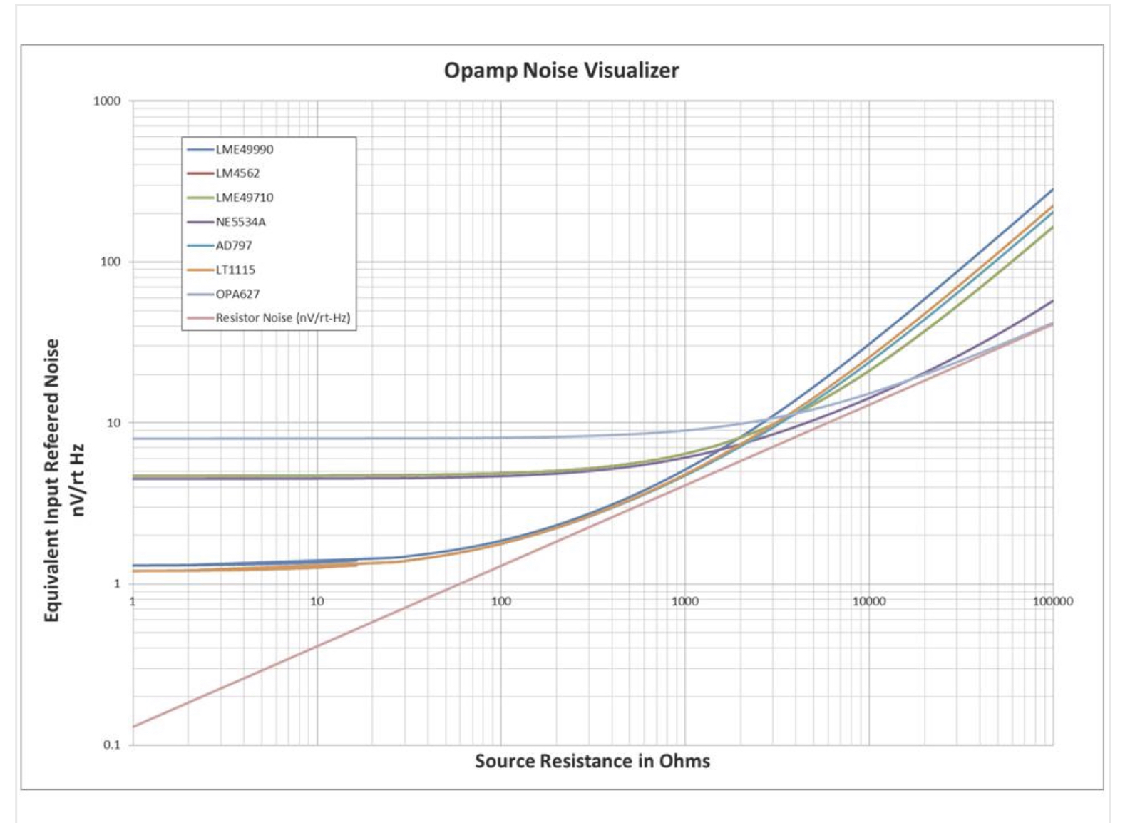

It's used to transform the 200R source to Ropt = rt(Rnv x Rni) the optimum source resistance for the 'OPA'. This is about 7K1 for 5534 and 450R for AD797 (from the datasheet). These are the source resistances where the 'OPA' gives the best NF. The Jensen website has a couple of practical examples of this 'matching' for AD797 and 5534, IIRC. The ultimate NF at Ropt is also a measure of the range of source resistances with 'good' noise performance.
If the 'OPA' sees a source resistance lower than Ropt, its voltage noise 'dominates'. If it sees higher, its current noise 'dominates'. That's why the LN FET i/p OPAs can give very good NF .. provided you can wind a transformer to match their very high Ropt without crummy HF.

The confusion here might be because the best noise performance is seen at occurring at Ropt. In the attached graphic, that would be where the total equivalent noise line most closely approaches that of an ideal resistor wrt thermal noise.
All Ropt is telling you is that below it’s value the amplifier noise dominates and above it the source resistance dominates. In any amplifier system with Ropt < c. 0.75 that of Rgen, Rgen will dominate (cf we can just perceive c 1.5 dB power ie 10 log)
Here’s a link to the tool that will plot these graphs Opamp Noise Visualizer

The Ropt concept gets a little silly for FET amps. If you take a 0.5nV composite FET amp virtually any source impedance works.
If you do the plot for a JFET amp it does not perform as well as a bipolar amp at low Rgen (JFET noise voltage dominates) but at higher source resistances, it tracks the pure resistance line very closely to very high values before deviating and going more vertical - see the OPA627 plot in the graph. Of course this all makes sense because current noise in a JFET is very low but noise voltage is higher that bip types.
I am not saying this how to ‘match’ Rsource to Rin - simply if you follow the 1.5 noise guideline you’ll be ok. So any Rsource below Ropt and your amp is then the bigger noise contributor. Importantly, there’s no point in spending money to take equivalent amplifier noise lower than 1.5 x Rgen. Anyway this is audio so everything will be driven to extremes . . .
