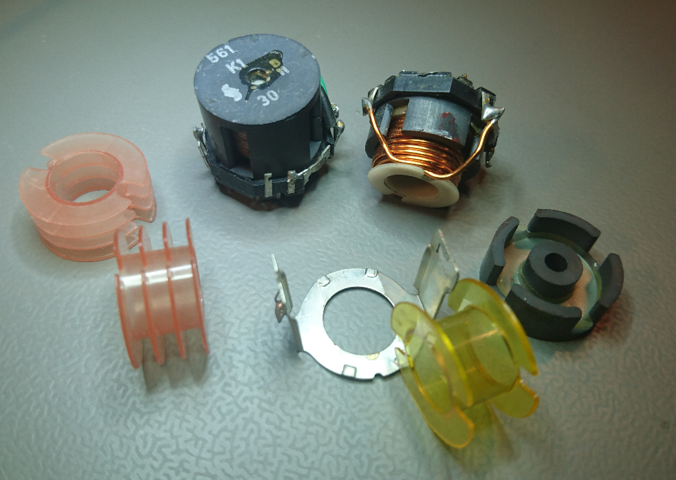

@Gerhard. How hard is winding one of those pot cores?
Folks have been fascinated with paralleling devices forever. In fact we won a best design idea ($150) from EDN (>25 yr. ago) for stacking two instrumentation amplifiers for 3dB noise improvement.
Nothing stopping you from paralleling the input side of two or more SUT's and seriesing the output sides the same way. Think of the possibilities. :D I always thought using the step down transformers from ribbon tweeters backwards could be interesting because they typically have copper ribbon secondary coils that have extremely low Rs. I have used valve amp output transformers backwards in a Schumann resonance detector.
BTW you will find the AD845's in the article unobtainium but there are plenty of choices for the IC's today.
Easy. But at 300 turns boring.
There is a coil former made from plastic, you just wind the wire on it and then clip everything together.
The empty coil formers in the picture are not made by Siemens, they
are former GDR production.
This Siemens core is K1 material (3-15 MHz) and smaller, with a Q of 400-500
ideal for a shortwave preselector filter.
N48 material must be 50 years old, there must be newer ones with higher ur and less losses.
Lepaysant e.a. noted that they increased ur by machining; probably they had a type
with an air gap in the middle of the core and they removed that. If one is careful, sand paper should work. Or bying a core w/o air gap.

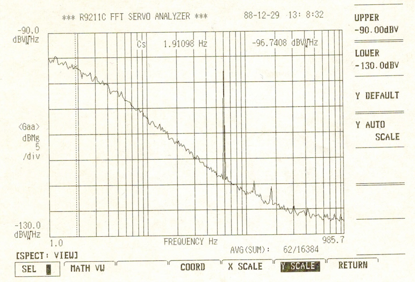

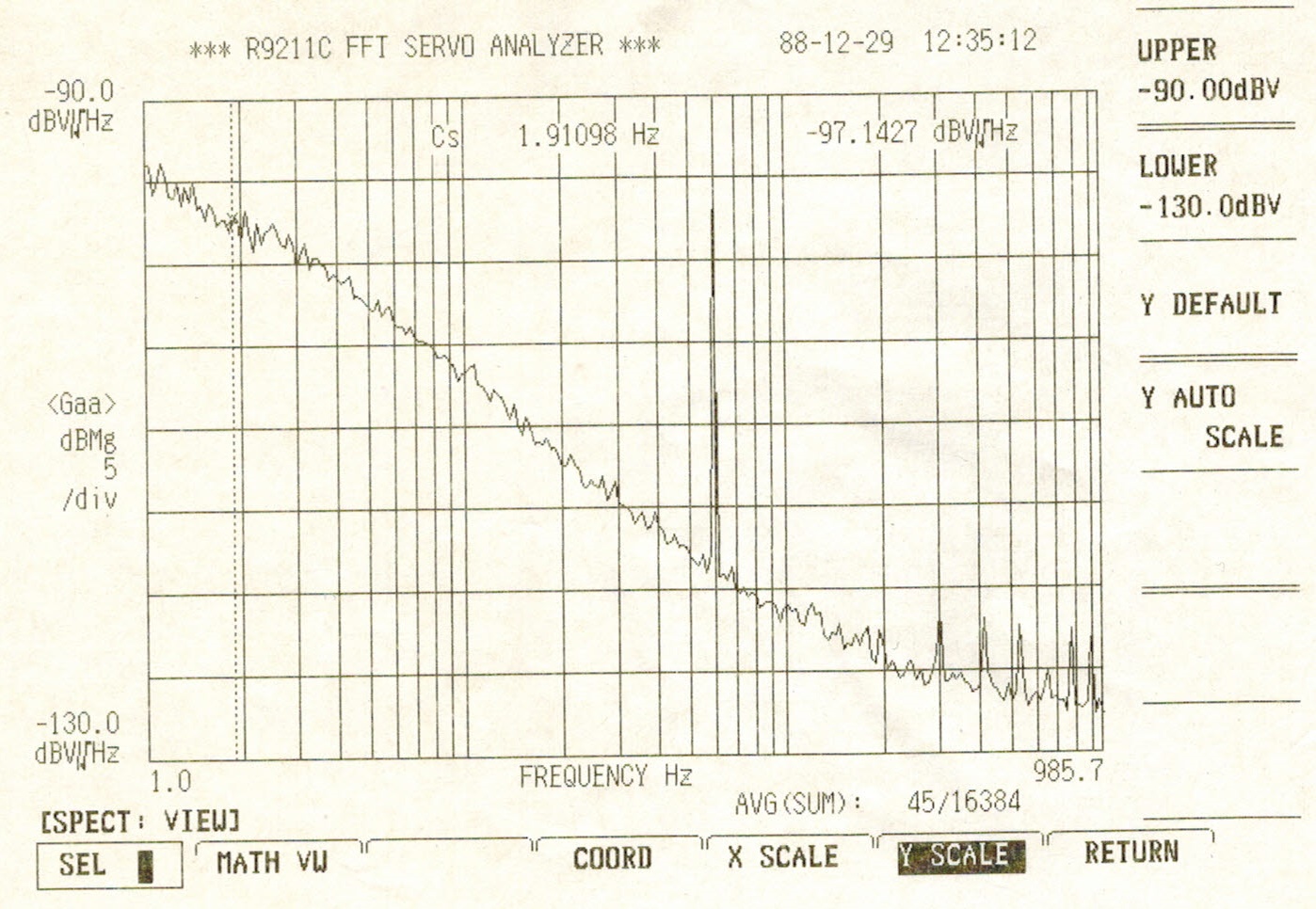

There is also news from the electrolytics front.
The better cap is the DK 1189-1056-nd, already used above.
The one with the worse 1/f is DigiKey P15324CT-ND, although it is mechanically bigger and has "better" data. It was meant to be an improvement :-(
It seems to be just a matter of luck. At least, they are not as bad as the organic polymer ones.
I have not yet changed them back and tested if this is the only reason because the 2 amplifiers have a lot of wiring around them and I would not like to rip it apart too often.
I have Syn08's caps on my list for the next order, along with some ECP2037 / EPC2038 GaN FETs to be used as switches in my chopper amp. If they don't kill the charge injection, then I don't know what would.
This is for the 493-3103-ND 3900uF/2.5V aluminum polymer, from 1Hz to 1KHz. First is measuring preamp input shorted, second is with the input shorted by the cap. No noise difference that I can tell. The 1/f noise drops a little under 2Hz since the measurement preamp has the LF pole somewhere around 1Hz. Measurement preamp has 60dB gain (59.88dB, actually), a noise of 0.4nV/rtHz flat @ 5KHz and above, and a bandwidth of about 400KHz, it's BF862 JFET based, self made.
