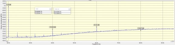

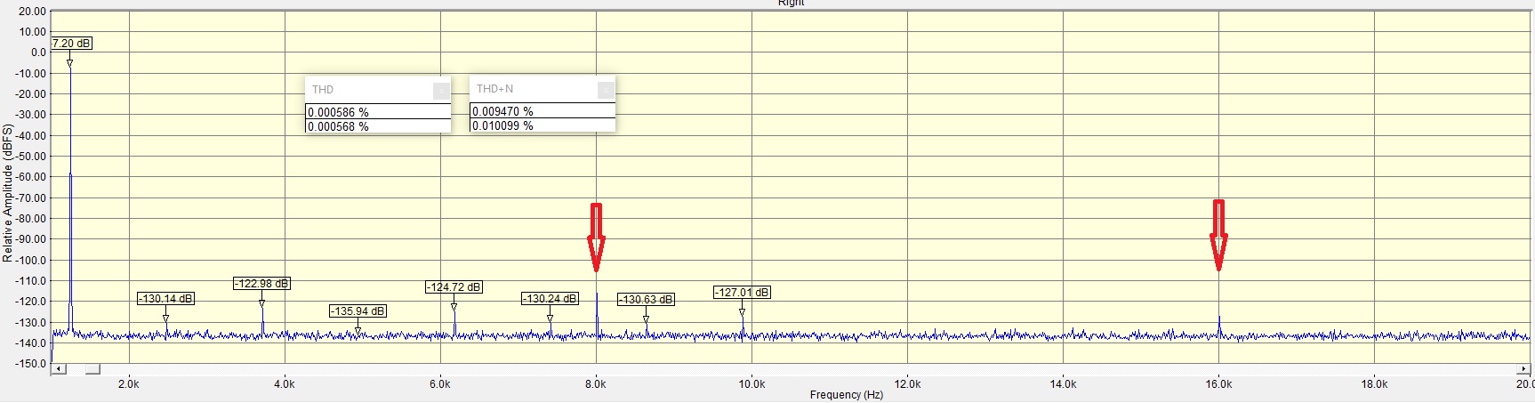

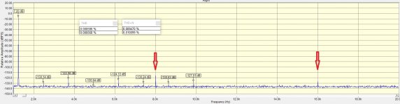

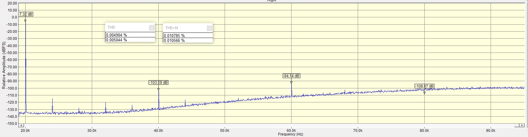

Because you mentioned it, I just received yesterday a brand new FocusRite 2i2 3rd generation (couldn't resist having one of these 🙂. It is indeed outstanding what the FocusRite engineers were able to pull out of a rather mediocre D/A + A/D chip (CS4272, same along all FocusRite USB interfaces generations). -140dB noise floor (192KHz, 1M samples, Hanning window), 0.0004% THD @1KHz and 0.0020% THD @20KHz. I'll open the case and get rid of those NJM op amps ASAP and see where this goes (in particular @20KHz). The performance is about twice as good compared with the 2nd generation 2i2. The only annoying issues is the same as in previous generations, an ugly 8KHz (and harmonics) residual that forces you to set the output frequency at 1131Hz instead of 1000Hz, otherwise the THD measurements are affected. THD+N measurements are affected by the same residual.
Ah, and the (only) 2ft. USB cable. Why are people so cheap? Reminds me of my kitchen mixer that came with a 40cm long power cord. A quick snapshot is attached.
Because you mentioned it, I just received yesterday a brand new FocusRite 2i2 3rd generation (couldn't resist having one of these 🙂. It is indeed outstanding what the FocusRite engineers were able to pull out of a rather mediocre D/A + A/D chip (CS4272, same along all FocusRite USB interfaces generations). -140dB noise floor (1M samples), 0.0004% THD @1KHz and 0.0020% THD @20KHz. I'll open the case and get rid of those NJM op amps ASAP as soon as I have a chance and see where this goes (in particular @20KHz). The performance is about twice as good compared with the 2nd generation 2i2.
I have asked Focusrite for the bandwidth of this interface (hopefully above the quoted 20KHz), have you tested it yet to determine such as I would interested in the results? Focusrite mentioned such info may be restricted...sigh!
I will slum it with a 2nd gen 6i6 for the time being. It's good enough for vinyl experiments and I have a TI PCM4222 EVM coming my way at some point. For VFM its hard to beat!
Not sure what you mean by "bandwidth" in this context? 20KHz loopback quick snapshot is attached, exactly what I would expect, minus the annoying 8KHz harmonic pips. For for $250 canadian tax included you cannot beat this (www.amazon.ca has them in stock, BTW, with free 1 day delivery for Prime members)

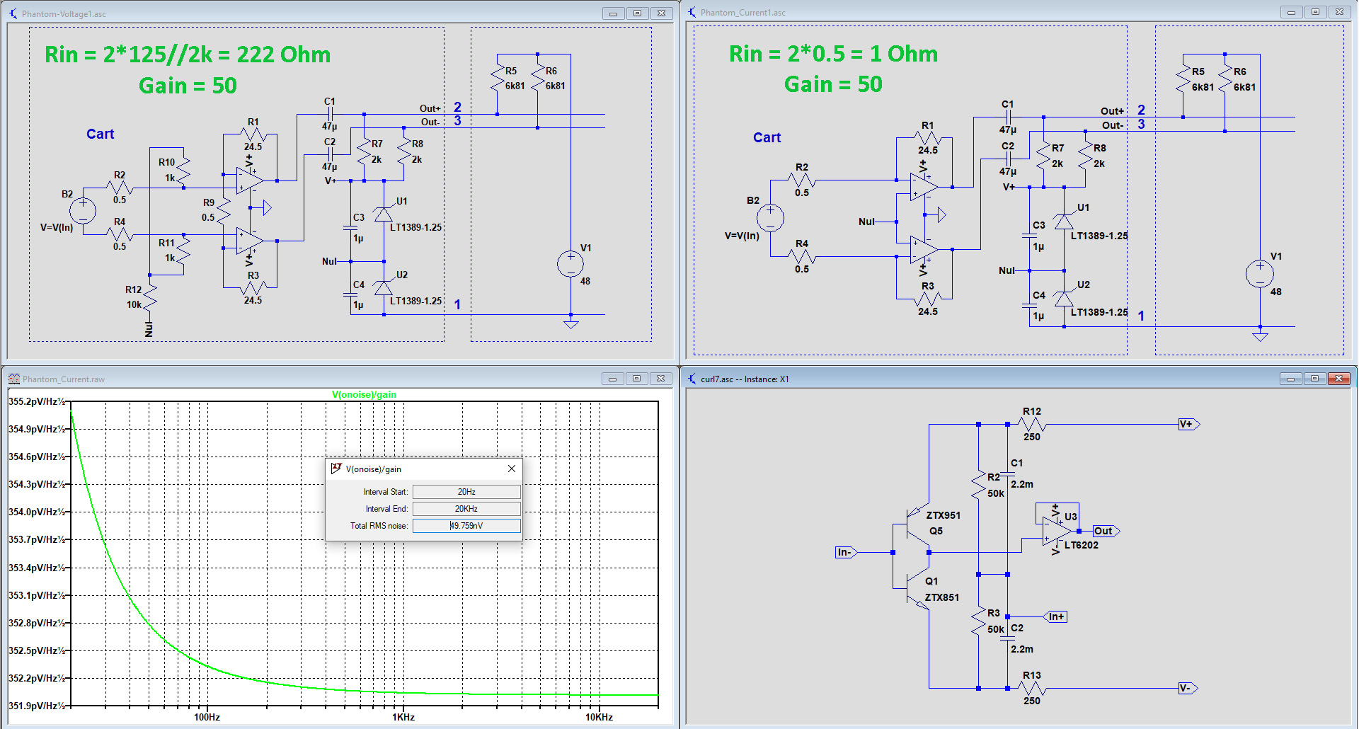

Here is the new design for the Phantom powered Head Amp's sub-circuit.
Same as before two versions, a voltage input and a current input.
What is shown is meant for a 0.1mV 1 Ohm cart, needing a Gain of 50.
In this example, simulated noise is 350pV/rtHz.
Because it is a diff-in circuit (yes I know, not everybodies first choice), there is a 3dB noise penalty.
In a SE version this translates to 250pV/rtHz, which is the same as the simulated Duraglit at 2.75mA collector current.
This 2.75mA is the maximum current for a diff version fed by Phantom power.
Input impedance is 125 Ohm per amp (R12//R13), two in series resulting in 250 Ohm.
For a Cart with a higher output voltage, these 250 Ohm resistors can easily be enlarged in value if needed, thereby reducing the collector currents.
Building these amps as intended will enable to do measurements for verification of the Sims, without any further intention ever to sell.
But after having tested, everybody can have the Gerbers for free.
Hans
P.S. R1 and R3 in the current input version should be 25 Ohm instead of 24.5 Ohm.
