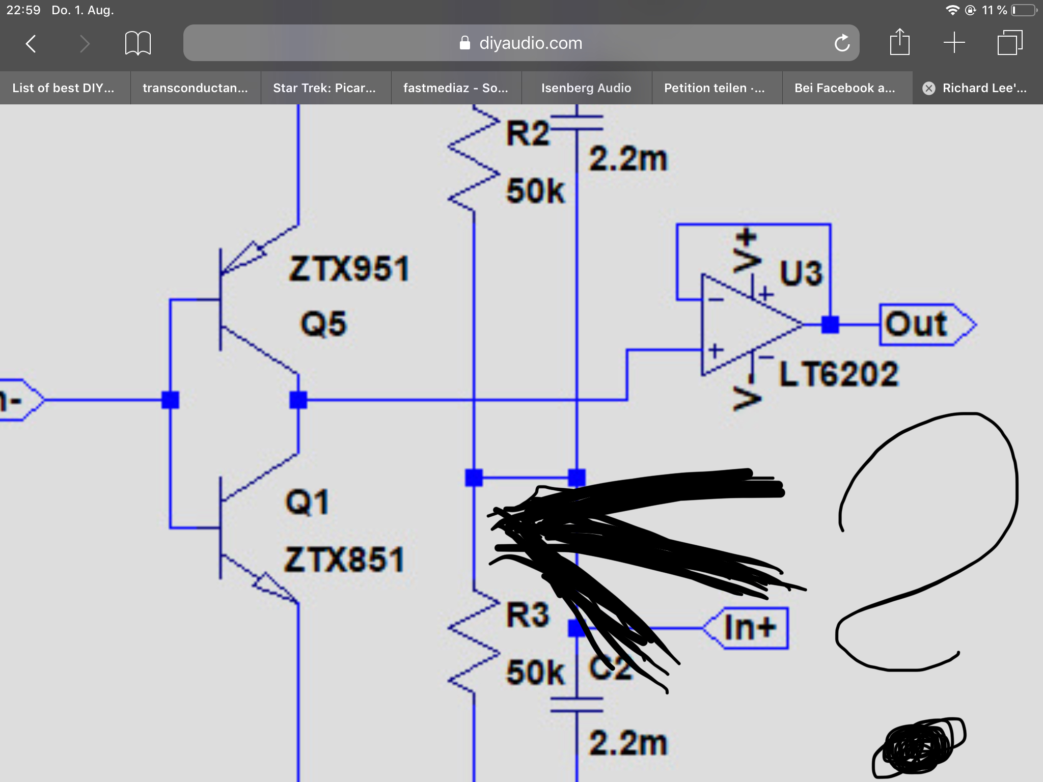

Hi Hans.
I have seen simelar circuit like your Curl7.asc.
with only 1Vpp headroom between XTX851 and 951, the smallest offset on the collector point will give rise to 2.order harmonics very fast. order 0.1% to 0.5% with a few hundred mV.
But when i look closer on your design i can see that you use negative feedback... So it will stay in the middle.
The design i refer to did not use feedback and had a resistor to ground. .... Very badly designed. With bias current ic of 20mA

Hans i would if i may suggest anything... But a series damping resistor on the capacitor C1 and C2 of 10ohm. It does not matter a lot for the total gain. Noise will go up a little but it could prevent oscillation.
Thank you for making me aware.
The Non Inverting version is almost insensitive to such Vbe offset voltages, and only needs accurate 50k resistors.
The Inverting version is indeed very sensitive to Vbe differences.

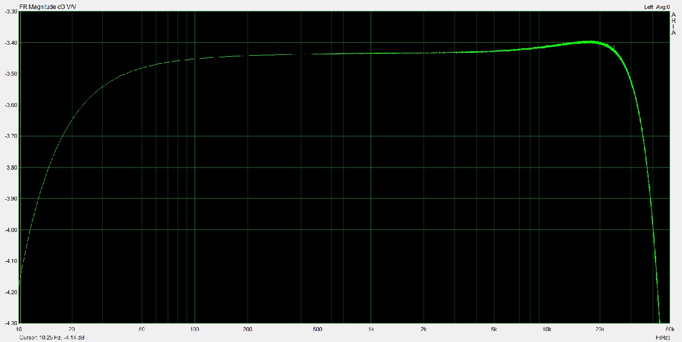

Not sure what you mean by "bandwidth" in this context? 20KHz loopback quick snapshot is attached, exactly what I would expect, minus the annoying 8KHz harmonic pips. For for $250 canadian tax included you cannot beat this (www.amazon.ca has them in stock, BTW, with free 1 day delivery for Prime members)
Thanks for that. I did really want the frequency response, I have enclosed the results for my Scarlett 2i4 Mk 1 for clarity - apologies if I was not clear enough in my request!
I'm hoping that with the higher sampling rate of the Mk 3 versions of the Scarlett's (192Khz), the upper frequency response will be higher. And the noise floor results you recorded look impressive, am I correct to assume from your enthusiasm that such is about as good as it gets from a USB Sound Interface?
Attached. High frequency response is IMO superb, LF could be better, but it's only a matter of replacing a few caps (if one really thinks it's worth of).
Yes, this is as good as an USB sound card could be, I've never seen anything better (although it could exist, I don't claim I've seen them all). All for 150 of your pounds.
